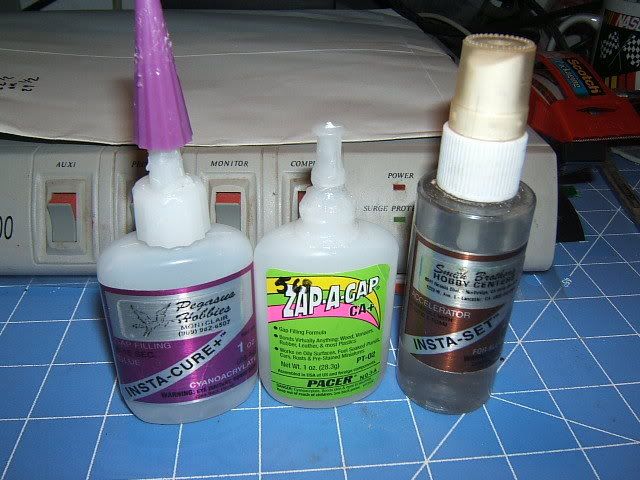

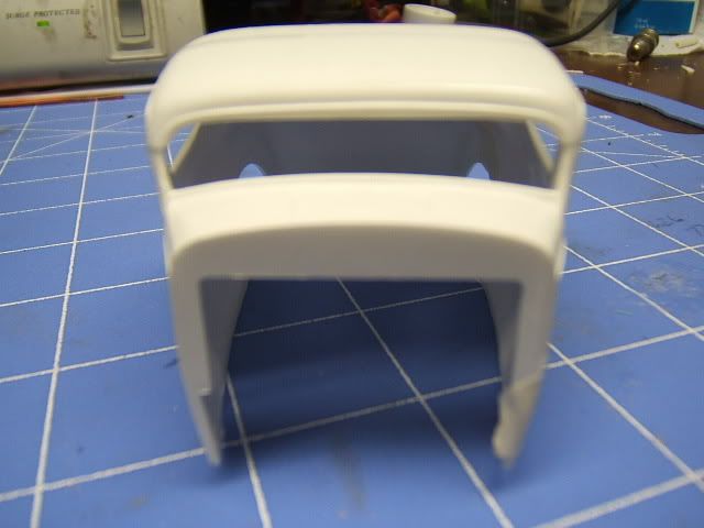

MR BIGGS Posted May 2, 2008 Posted May 2, 2008 Stupid Question #1, you'll get alot from me. What is zap-a-gap... Zap-a-gap is just another type of super glue that bond's almost anything. I use it to glue all my model's part's together all of the time, but I also use it for gap filling along with the accelerator witch make's it dry in second's. The reason I like it so much is that it dry's hard in second's and you dont have to wait min or hrs before you can start to sand you project. and here is a 32 I just made 5 min ago to show you how fast it work's and there is no wait time for the bondo to dry. this is all done with Zap-a-gap and styrene and it"s strong and I can paint right over it.
billd64 Posted May 2, 2008 Posted May 2, 2008 dave i wash all my models down diligently with dawn dish detergent, ive never had a problem with anything afterwards, Ive been stripping wih brake fluid, havent been able to find the engine degreaser locally from castrolthat people rave about. I also have been postponing the inevitable with either using nitrostan, or another form of bondo, so reading what you guys are doing is inciteful. I once masked with wax paper, but the body paint tore it up, no idea what bondo wiill do what about the old glue we used to use as kids from elmers early in school, i know armour guys that using it for masking areas, and then rub it off bill d. Nothing personal anybody, but I'd be leery of the clean-up after putting Vaseline or cooking oil on a model......even if it's a car getting a flat finish, contamination could be a real issue.
