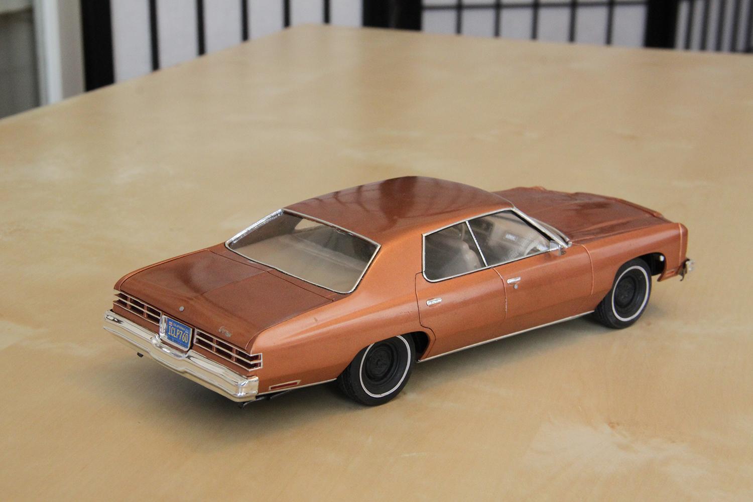

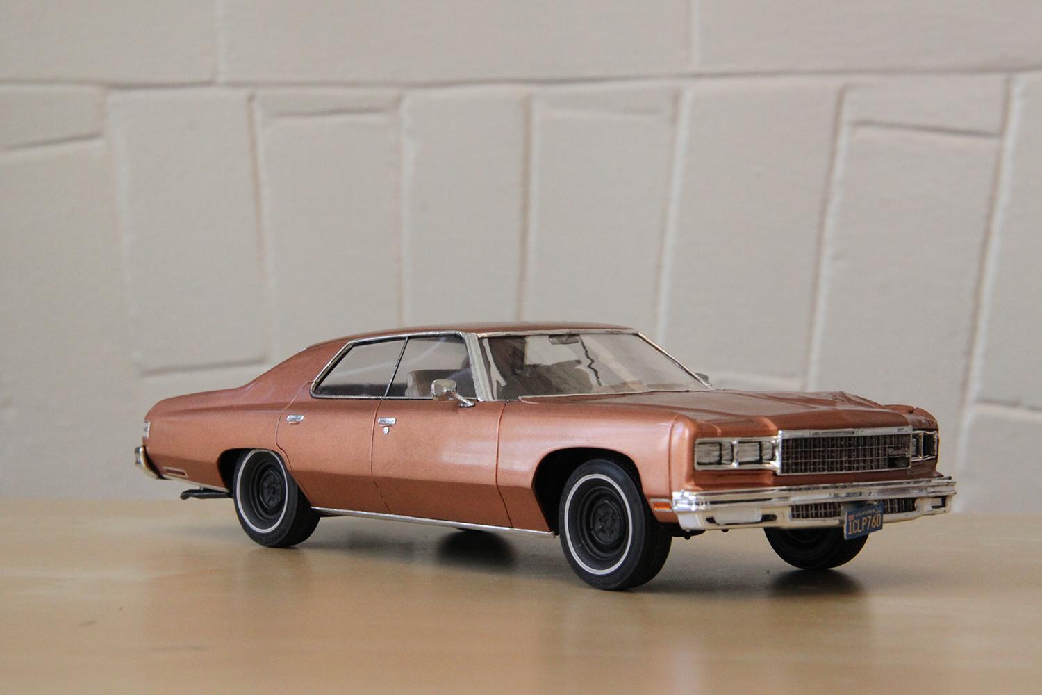

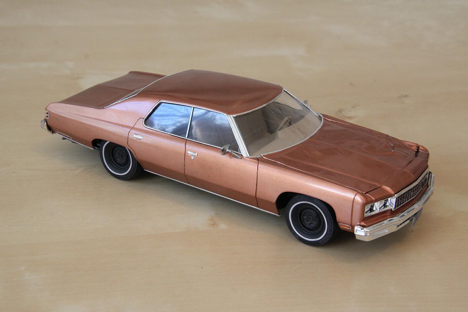

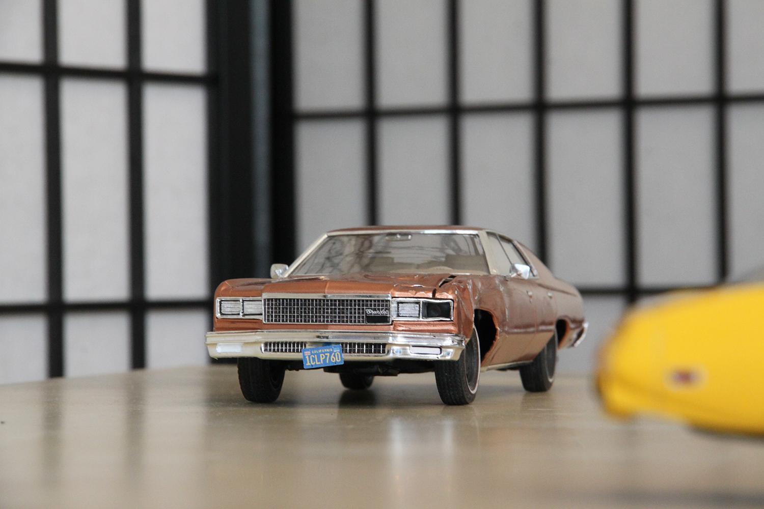

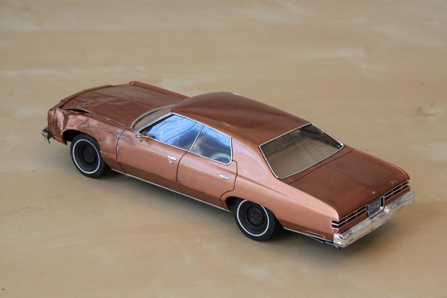

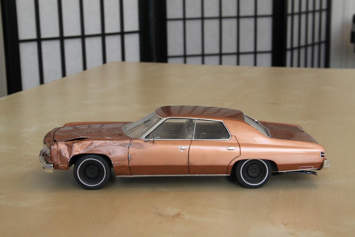

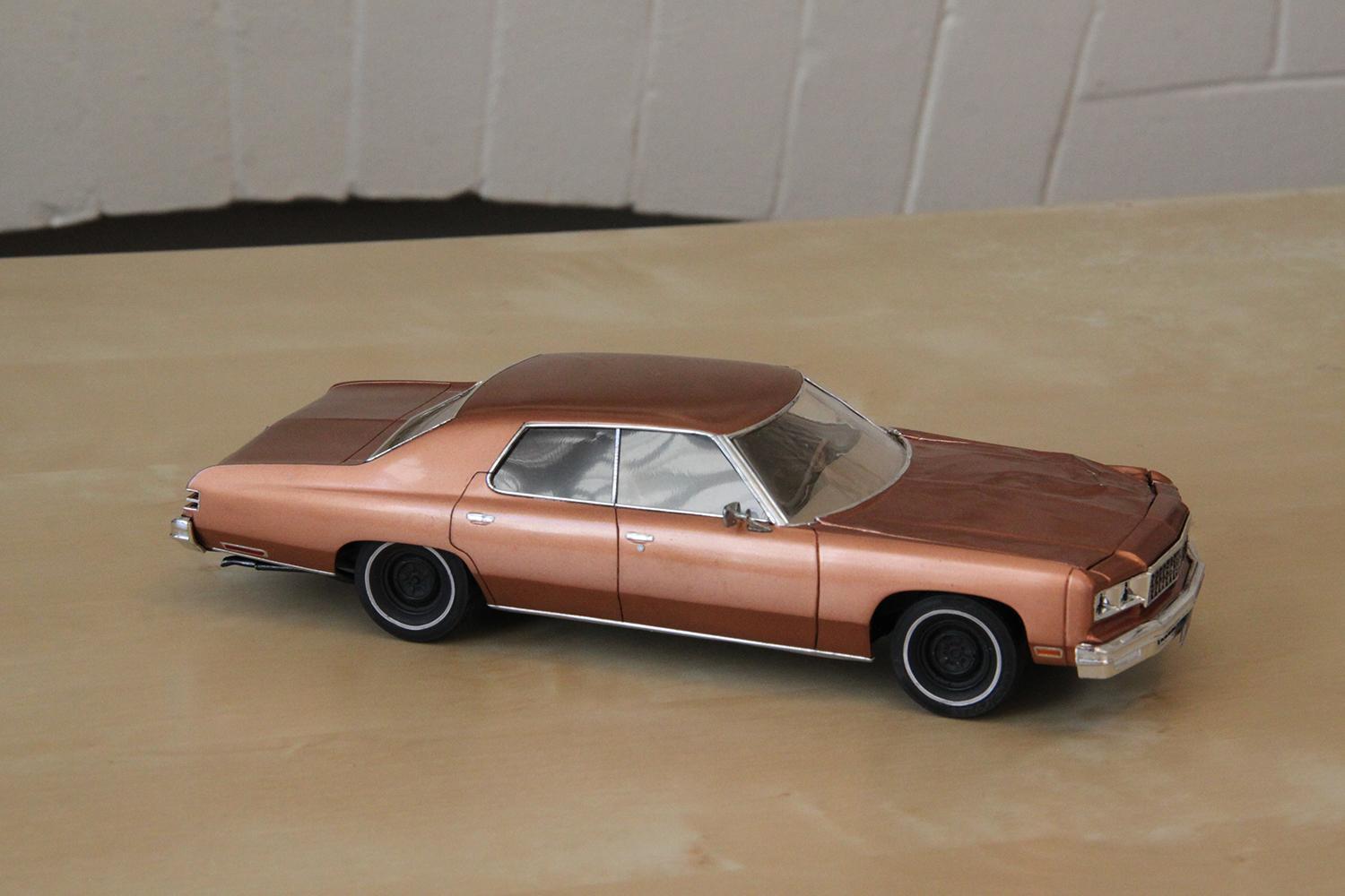

Cosmo_Song Posted September 23, 2016 Posted September 23, 2016 I just finished a conversion project that started from a MPC `76 Chevy Caprice 2-door. For some reason the body part was not molded well when I received the model and I think it`s beyond repairable. So I decieded to chop the damaged A-pillar and fender section and replace it with epoxy-bounded Foil material and gave it a damaged appearance. I always have a fetish for the big, full-size american 4 door sedan in the 60`s and 70`s. So I converted the MPC 2-door coupe version to a 4-door sedan. I cut the B-pillar and fill the quarter window because I prefer a more traditional and thicker C-pillar which is different from the actual `76 Caprice sedan, but personally I prefer the look. I also rescribed the door panel lines and trunk. I used sterene sheet to reform the roof section and I sanded off the side trim to give the Caprice a more "base model" appearance. Thanks for viewing! The progress page:

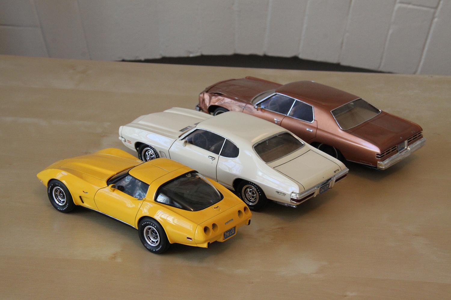

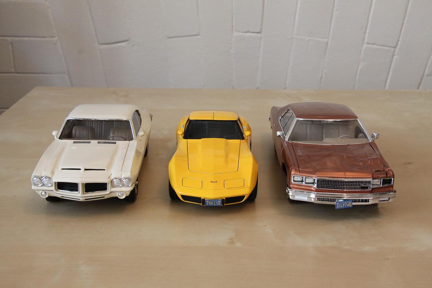

Cosmo_Song Posted September 23, 2016 Author Posted September 23, 2016 Check out my other 1970`s Malaise era cars builds:

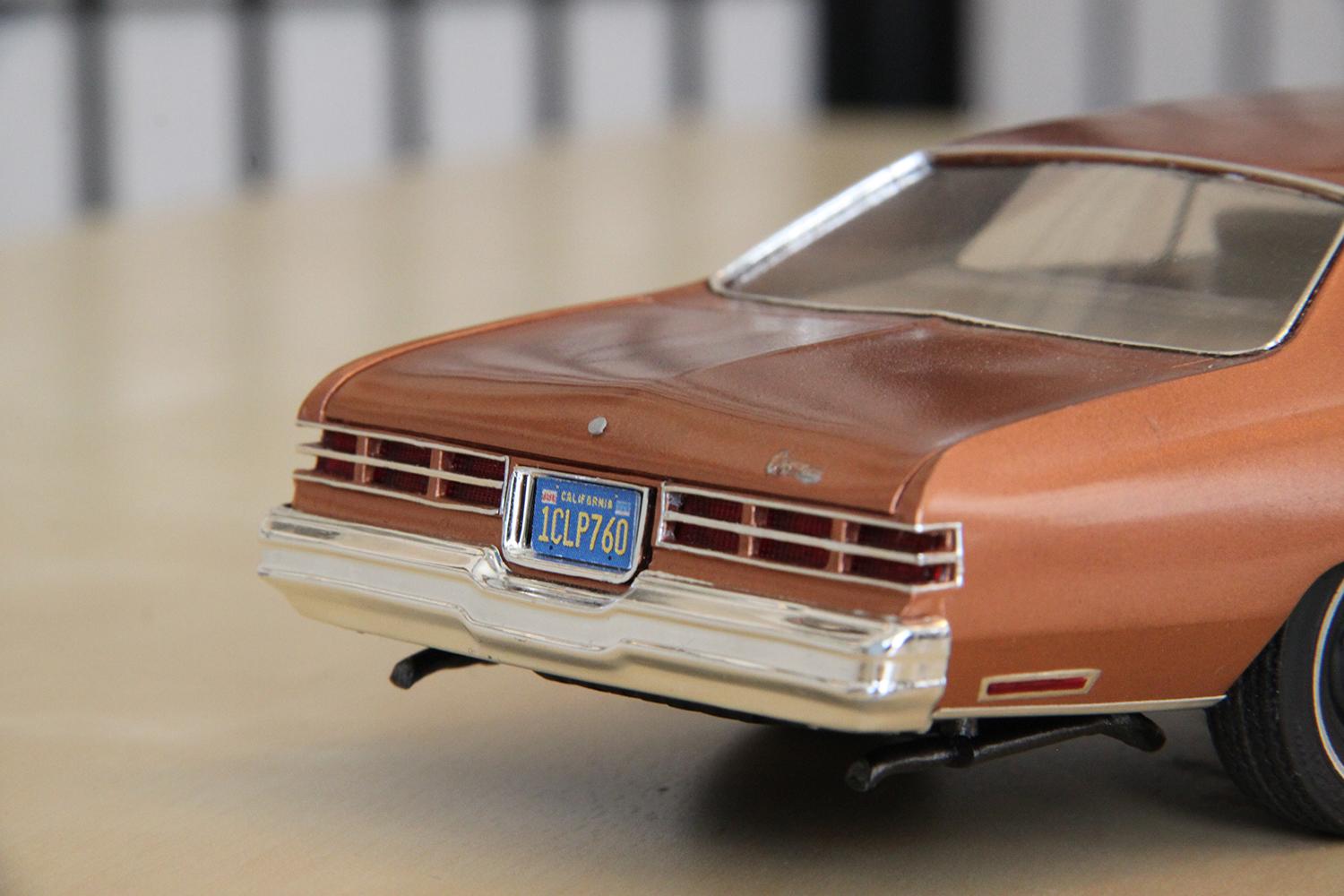

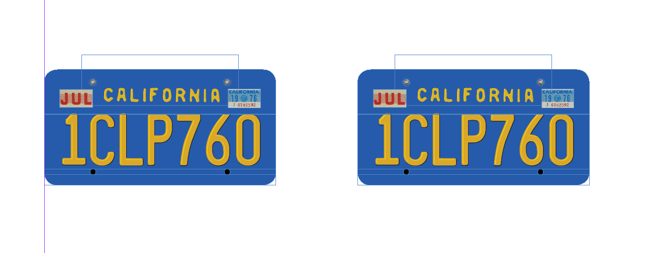

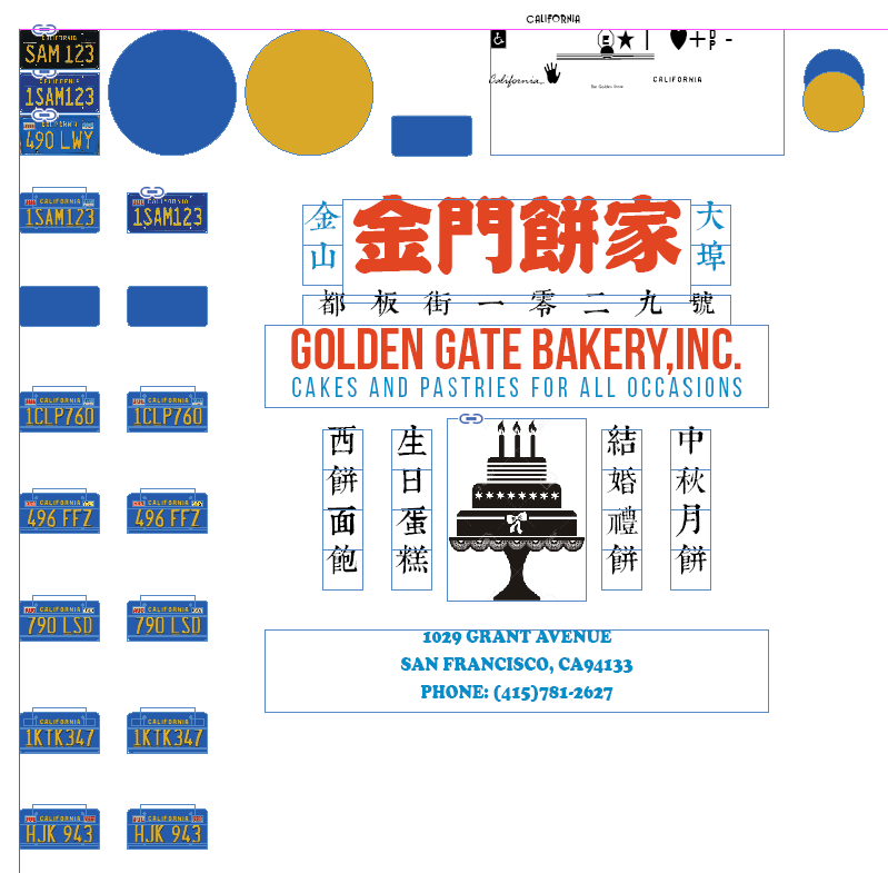

ChrisBcritter Posted September 24, 2016 Posted September 24, 2016 Very impressive, Cosmo - looks like it could be on the set of CHIPs, about to do a rollover from a hidden ramp while disco music blares! I like your license plates too; with correct fonts and registration stickers. How are you making them?

Cosmo_Song Posted September 26, 2016 Author Posted September 26, 2016 Very impressive, Cosmo - looks like it could be on the set of CHIPs, about to do a rollover from a hidden ramp while disco music blares! I like your license plates too; with correct fonts and registration stickers. How are you making them? Thank you very much. I found the correct fonts and sticker images online, and then I used Adobe illustrator for the graphic design and print it out with tin can glued to the back.
