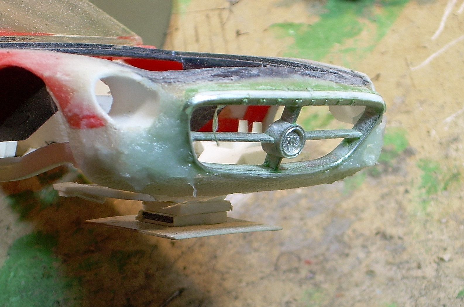

aurfalien Posted September 29, 2016 Posted September 29, 2016 (edited) Hi Mark,You bring up good points.A few things I've done on my Chaparral CanAm car that is still on the bench in chronological order;1) Built up fenders with Bondo Spot Putty.2) Too much Bondo started eating styrene plus the Bondo started to crack.3) Used super glue to re enforce styrene and stop the melt.4) Started doing thinner layers of Bondo to build up fenders.5) Top coat of Tamiya Putty as it sanded smoother then Bondo.* I noticed that the Tamiya Putty was much friendlier on styrene then Bondo.The pics of my Chap CanAm Spyder are on this forum some where. I built up its fenders by about a 1/4" on each panel. That's a lot of filler. Edited September 29, 2016 by aurfalien
