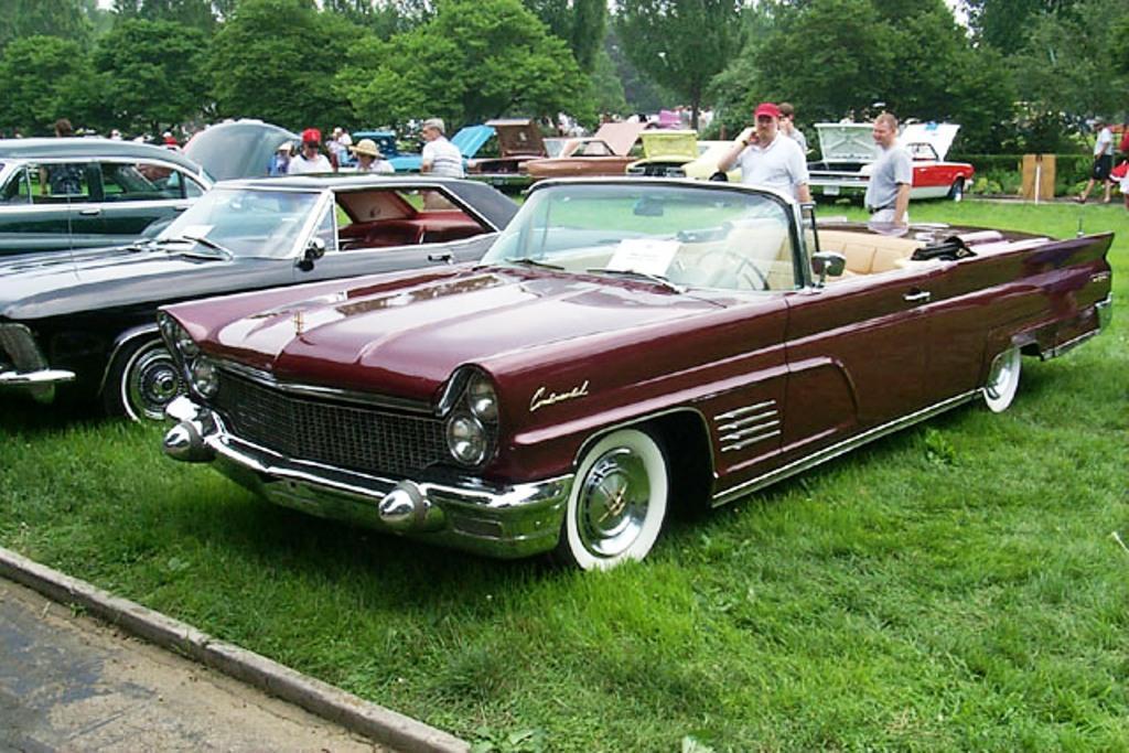

gtx6970 Posted October 3, 2016 Posted October 3, 2016 (edited) I picked this one up last winter as a future project. And once I saw a 1/1 pic of the car in I had to move it to the front of the line this winter. ( I dont build much in the summer months ) So in late summer / fall I paint maybe a half dozen bodies in prep for winter indoor activities. This is one of 4 I have in process at the moment There was nothing to add BMF to along the base of the windshield so I've added strips along the perimeter of the opening for the lower trim mldg and then stacked some small strips to give some added depth for the wiper blades. Also gonna try the BMF under the paint for the emblems one more time and see how it works on this one. 1st my inspiration for the project . Edited December 9, 2017 by gtx6970

CometMan Posted October 3, 2016 Posted October 3, 2016 Very nice, Bill! I love those big boats! Your color looks a little to be a little too bright red for Maple Leaf, the examples of that color are usually a darker color with a more purple tint, but that could be the pictures we are seeing. Anyways, it is a good color for that car!
gtx6970 Posted October 3, 2016 Author Posted October 3, 2016 Your color looks a little to be a little too bright red for Maple Leaf, the examples of that color are usually a darker color with a more purple tint, but that could be the pictures we are seeing.Agreed,In person it looks a little different than my PC monitor shows it to actually be ( especially out in the sun ). But even then I think its off a tad. But I'm going to live with it as is .Going out today to pick up some paint for the interior and some Tamiya conical swabs,,,,I've got my fingers crossed I get the emblems to come out right

Mark IV Posted October 4, 2016 Posted October 4, 2016 Nice! But note that the "Continental" scripts on the 1/1 are gold colored as well as some of the other trim pieces.
gtx6970 Posted October 4, 2016 Author Posted October 4, 2016 (edited) Nice! But note that the "Continental" scripts on the 1/1 are gold colored as well as some of the other trim pieces. I wasnt 100% sure of the color, in some pics they look gold, in others they look chrome . Either way my plan is go over them with a yellow sharpie once the car is done. I think the Mark V emblem on the rear quarter is also gold correct ? I think the emblems came out outstanding. My phone camera didn't want to focus in on it that close. but you can easily read them both . I'm stoked Edited October 4, 2016 by gtx6970

horsepower Posted October 5, 2016 Posted October 5, 2016 I'm getting into this pretty late in the game, but for anyone who's interested, you CAN'T JUDGE colors by what you see on screens, or what you see in print. The only true way to check a color is with an actual PAINTED chip, or panel. Inks and color pictures can't capture the exact dyes or toners to get the color right in print and even digital photography isn't fool proof because it still relies on an existing color palette, not the actual pigments. So if you are happy with what you have, chances are it's extremely close if the paint formula was followed carefully by who mixed it.
horsepower Posted October 5, 2016 Posted October 5, 2016 I'm getting into this pretty late in the game, but for anyone who's interested, you CAN'T JUDGE colors by what you see on screens, or what you see in print. The only true way to check a color is with an actual PAINTED chip, or panel. Inks and color pictures can't capture the exact dyes or toners to get the color right in print and even digital photography isn't fool proof because it still relies on an existing color palette, not the actual pigments. So if you are happy with what you have, chances are it's extremely close if the paint formula was followed carefully by who mixed it.Just curious why you didn't put the yellow on the emblems before burying them under clear? You could also use a transparent yellow on the pointed Q tips and get your gold effect, but you might find that a thin coat of transparent orange would look more like gold, in the case of gold anodized aluminum, in most cases it's done with a transparent orange and not allowed to achieve the true orange shade.
