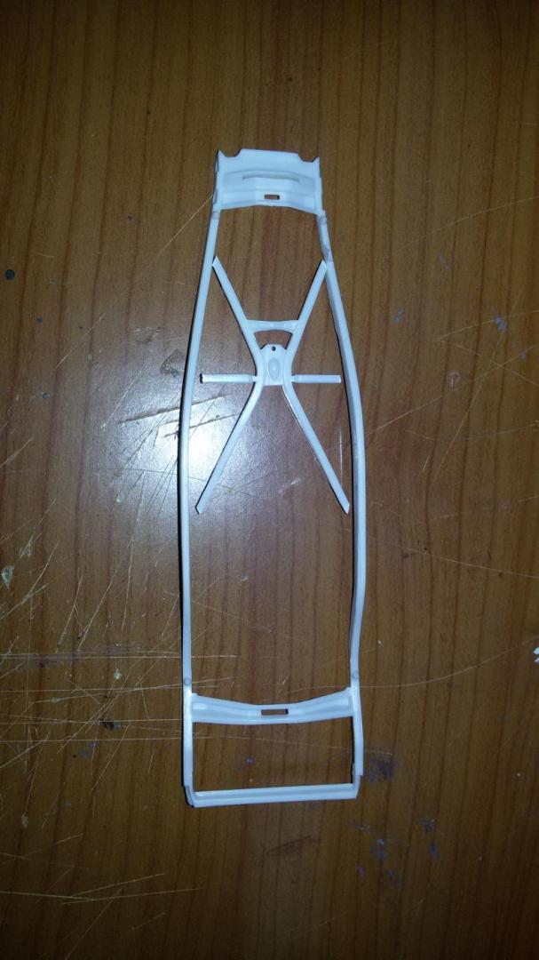

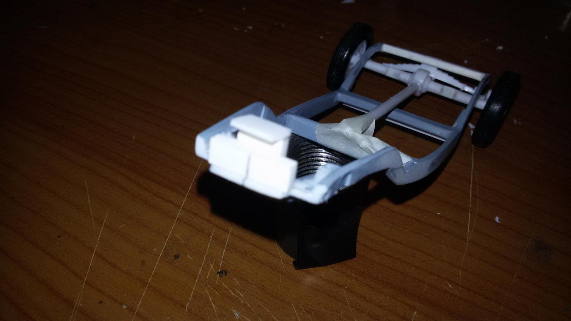

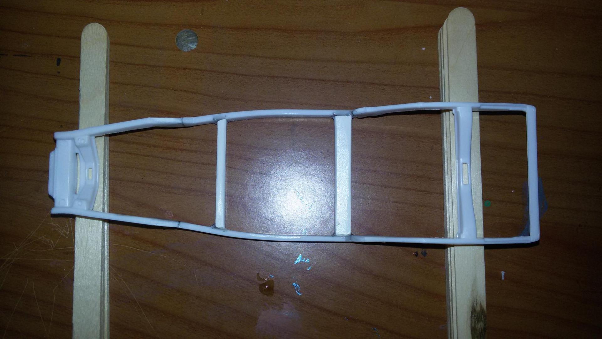

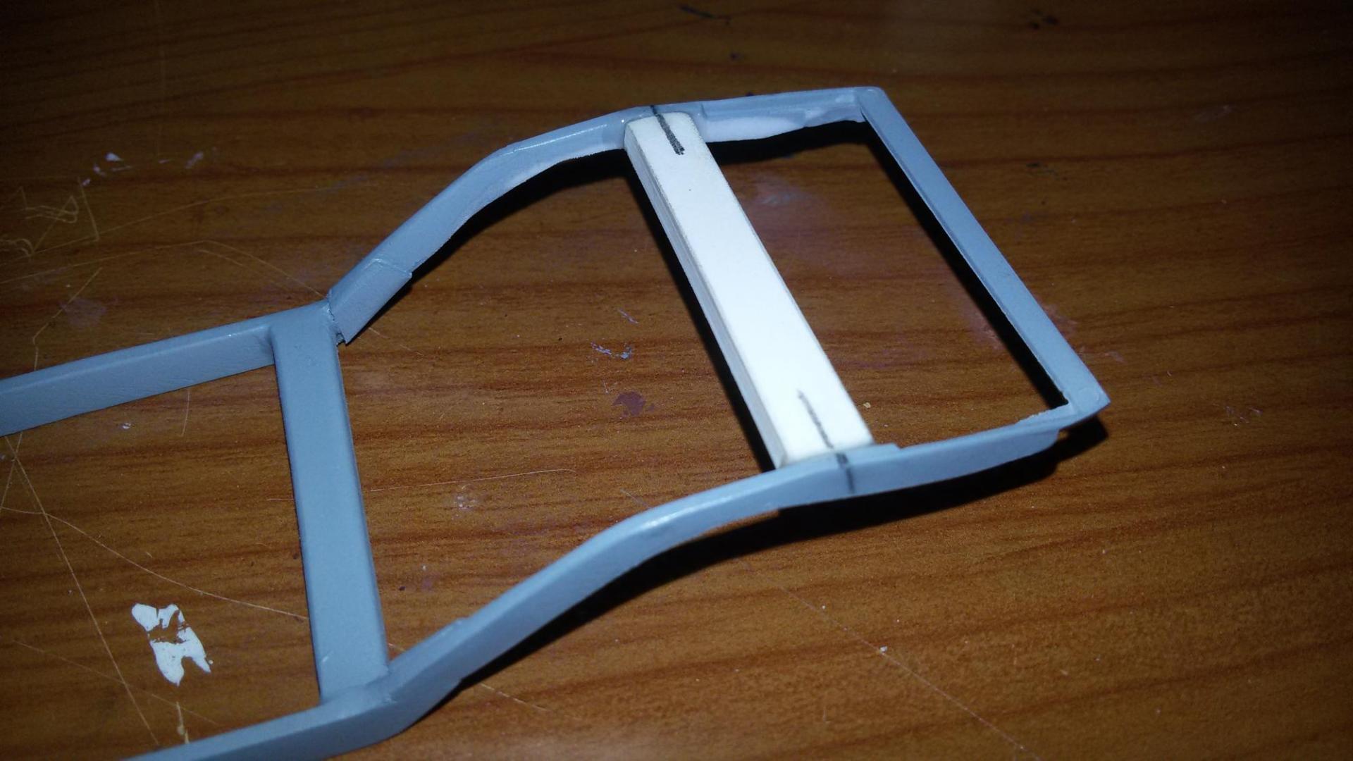

I began by eliminating the central part of the frame, which will be replaced by two new crossmembers I made from plastic chopsticks and I glued in place.
20160919_152939.thumb.jpg.195c76c7df861220160919_155729.thumb.jpg.c6f4973d690bd420160919_155721.thumb.jpg.a558c902ec3a4f20160919_155729.thumb.jpg.9a16119c7010f9

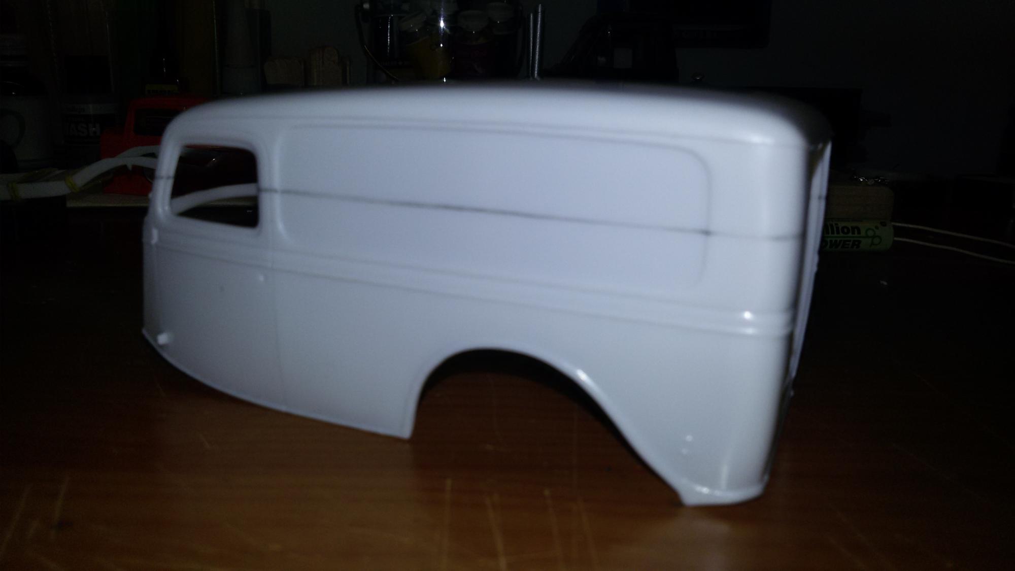

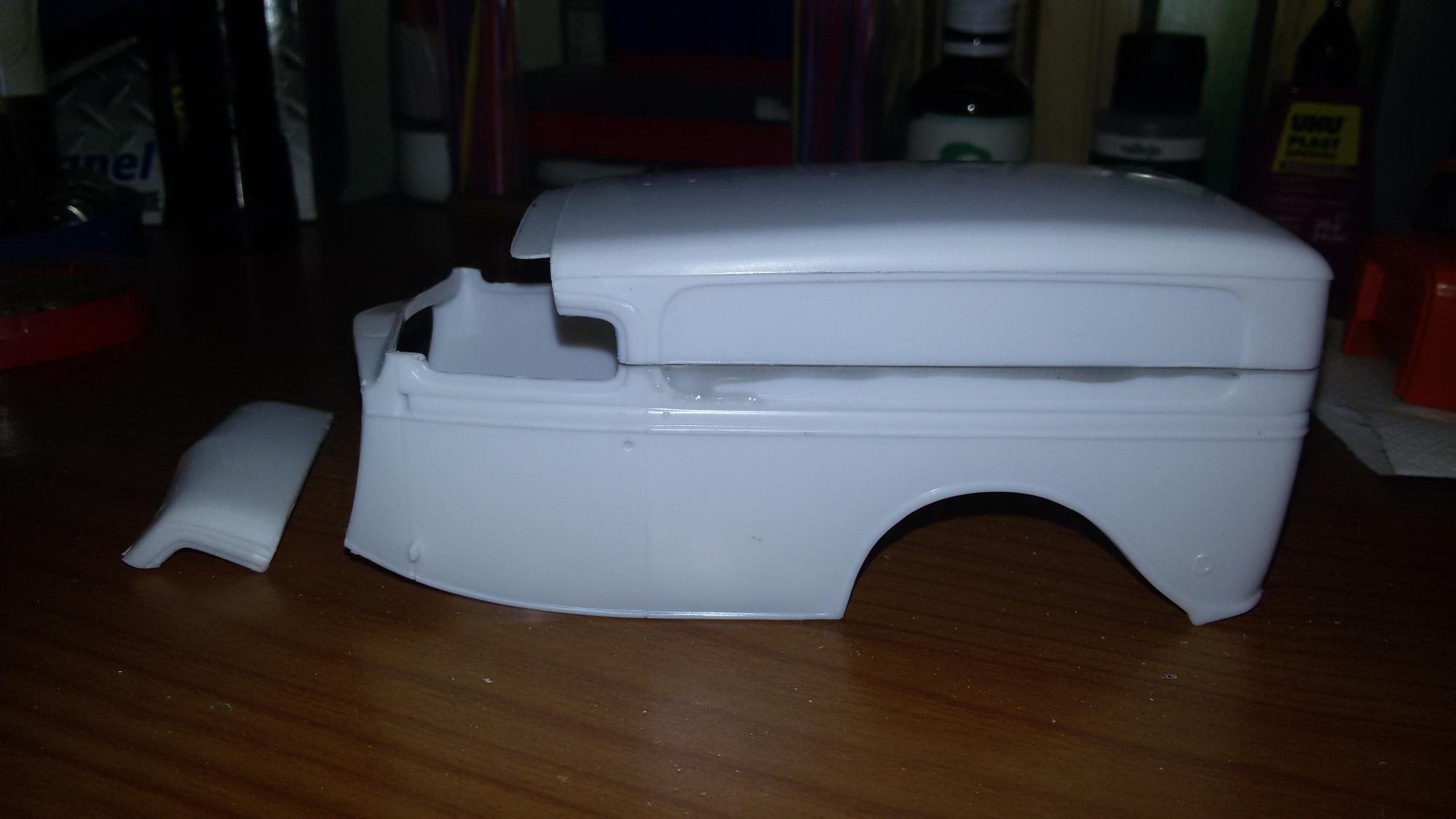

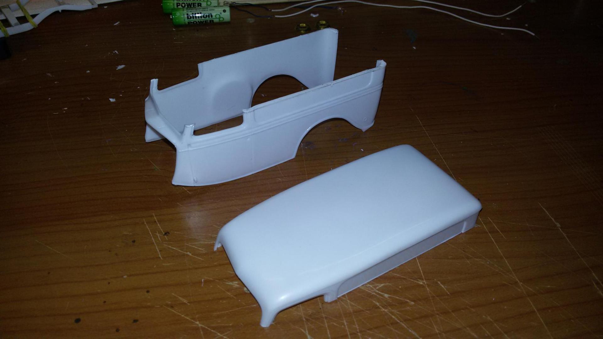

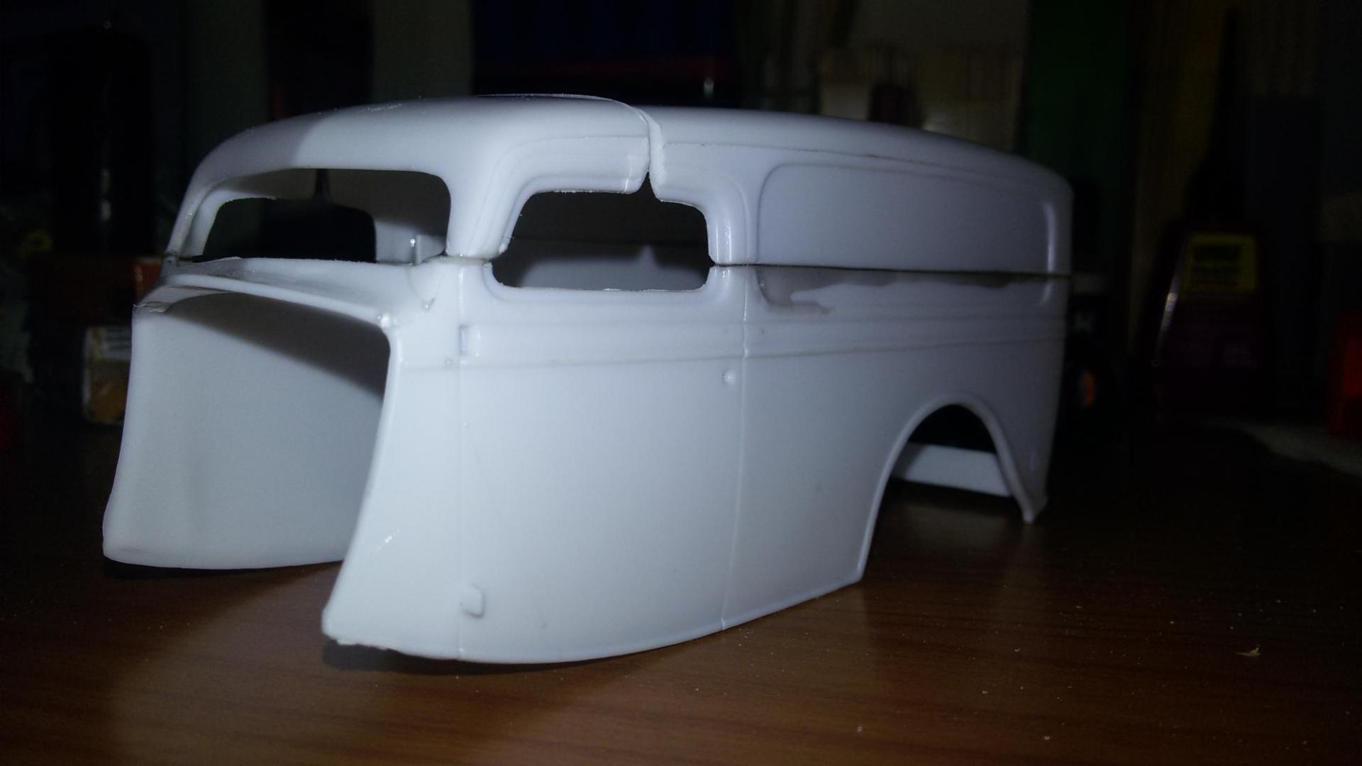

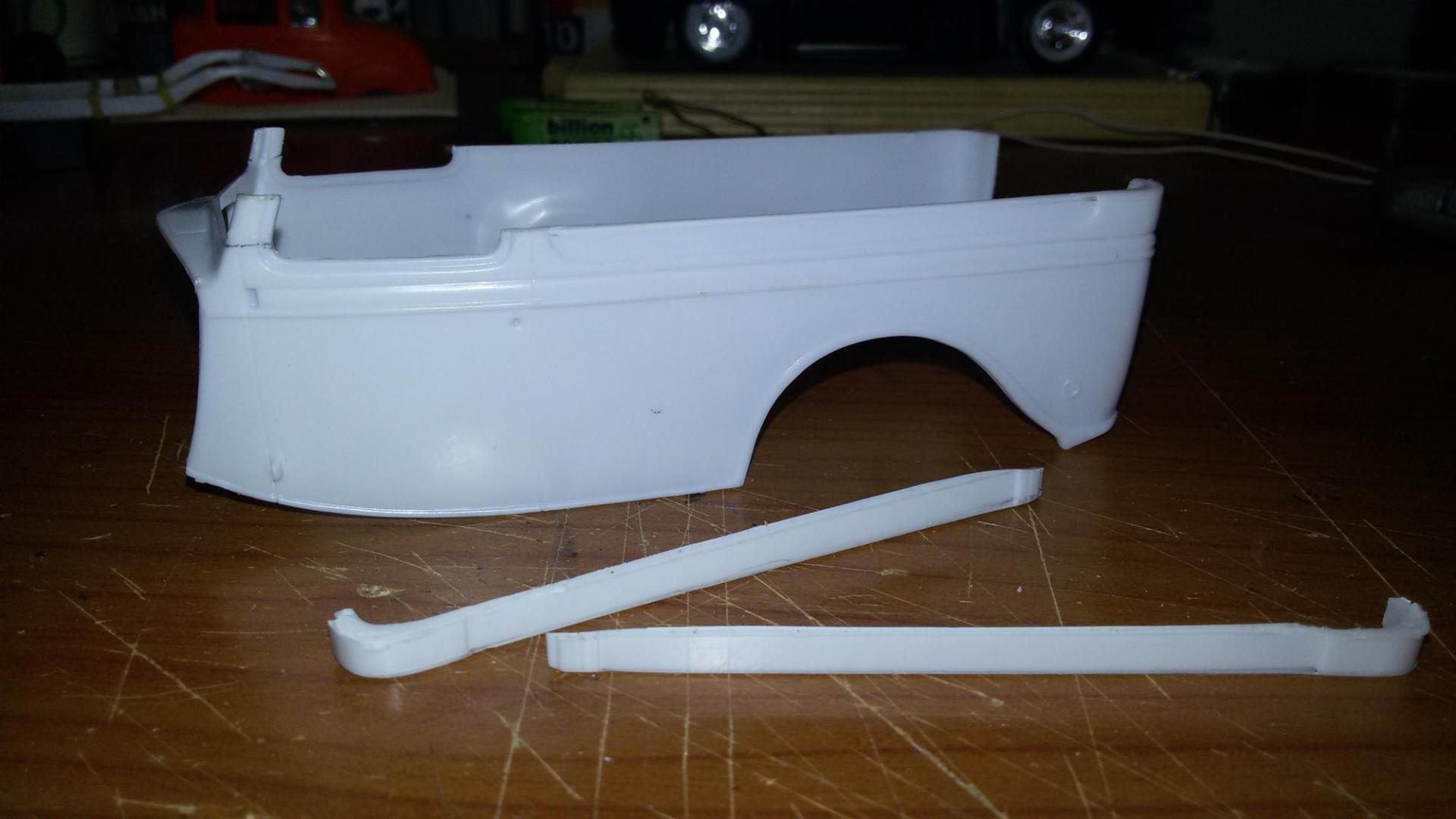

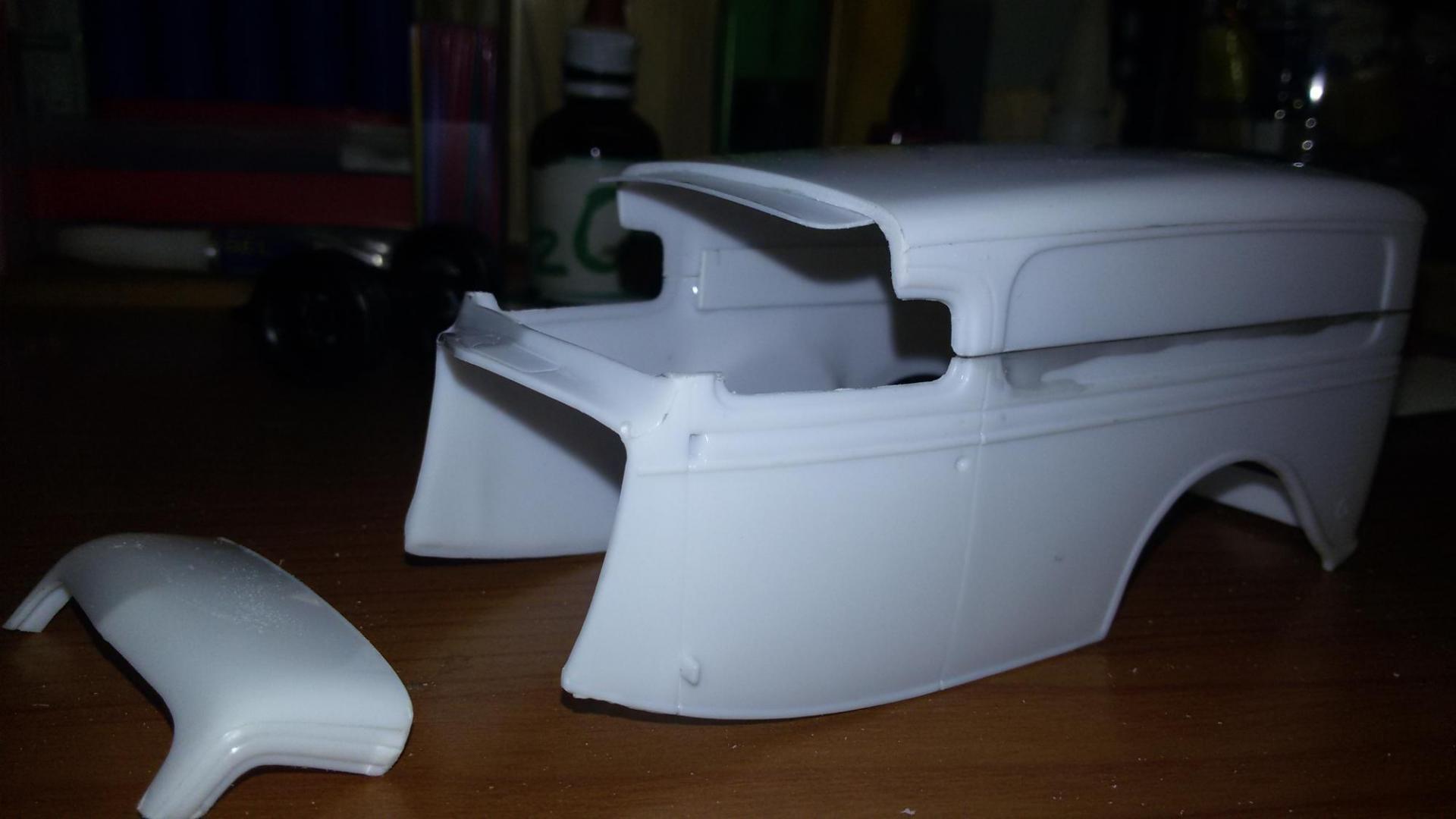

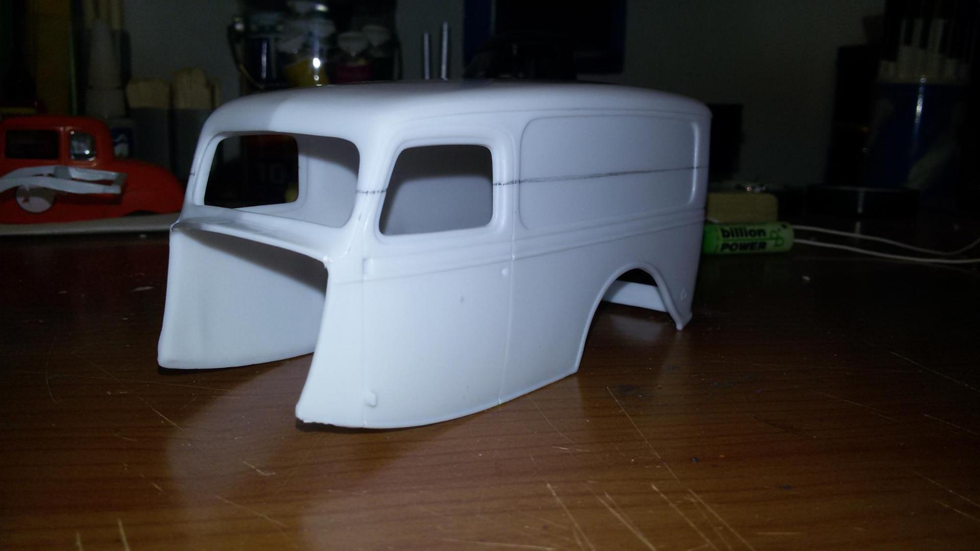

Meanwhile, I drew a line for cutting the body (my first top chop ... i was a little afraid ...) and made the first cut.
It comes better than expected, very accurate, so I continued with the second cut ...
in the picture you can see the strip that I deleted, about 5 millimeters, not much but I hope will see  the difference at the end.
20160919_162126.thumb.jpg.6dd9dae7a2ea8e20160919_162136.thumb.jpg.4fca4cde01458720160919_165925.thumb.jpg.aec0836dffc4c220160919_181554.thumb.jpg.bc9340037af2d6

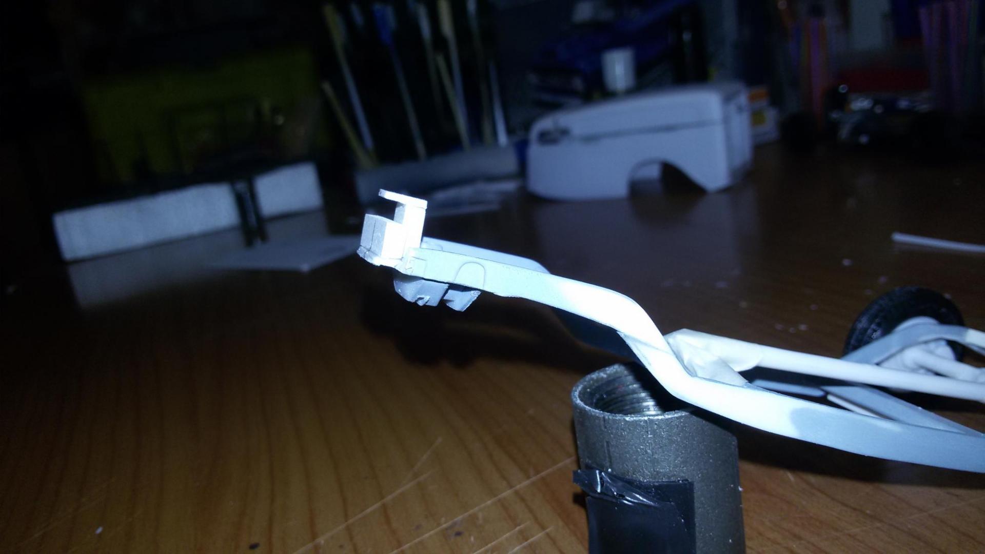

for now I'll stop here, the next step is to cut the frame to lower the suspension, using a method that I learned from a tutorial by a user of this forum of which I can not remember the name, but I was able to first try and it's very simple.
I do not remember how you call this technique, however, it is to obliquely cut the beams of the frame and glue them overlapping.

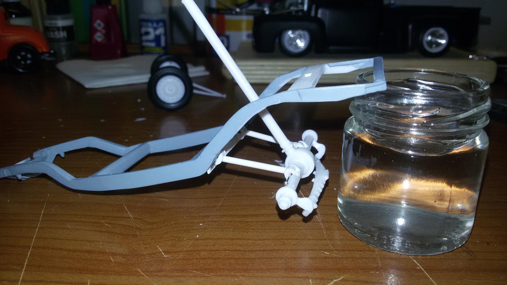

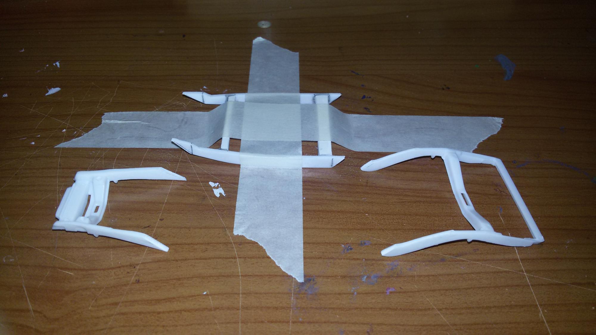

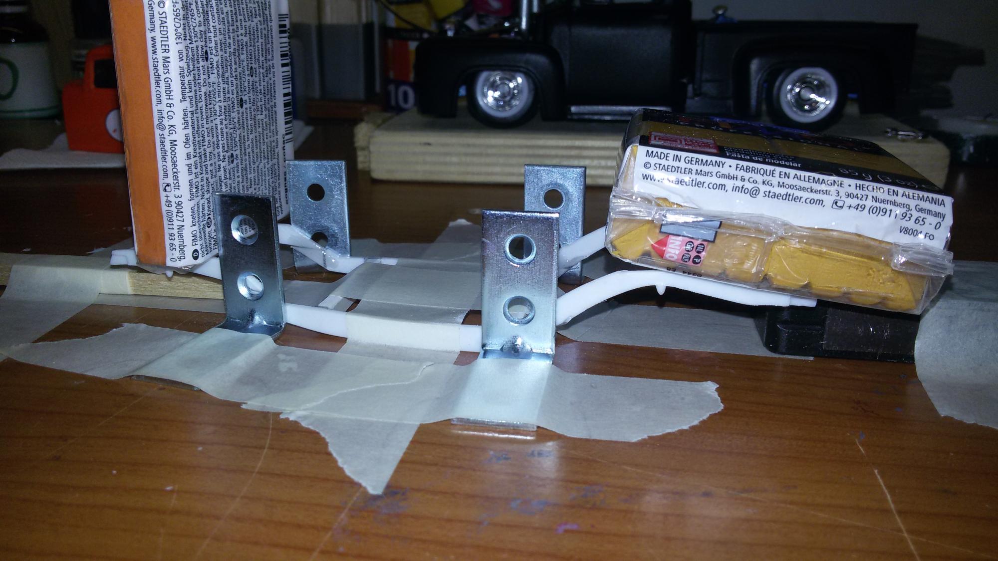

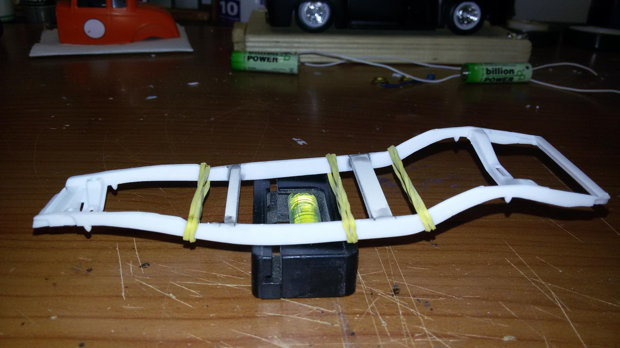

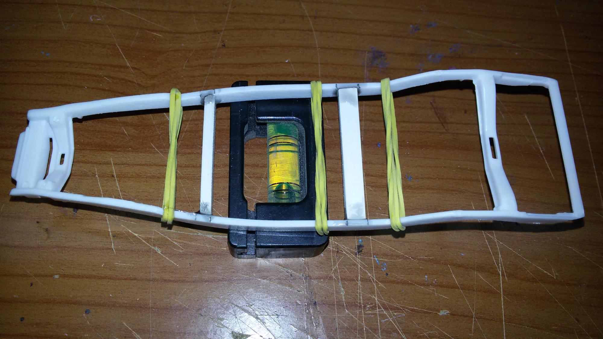

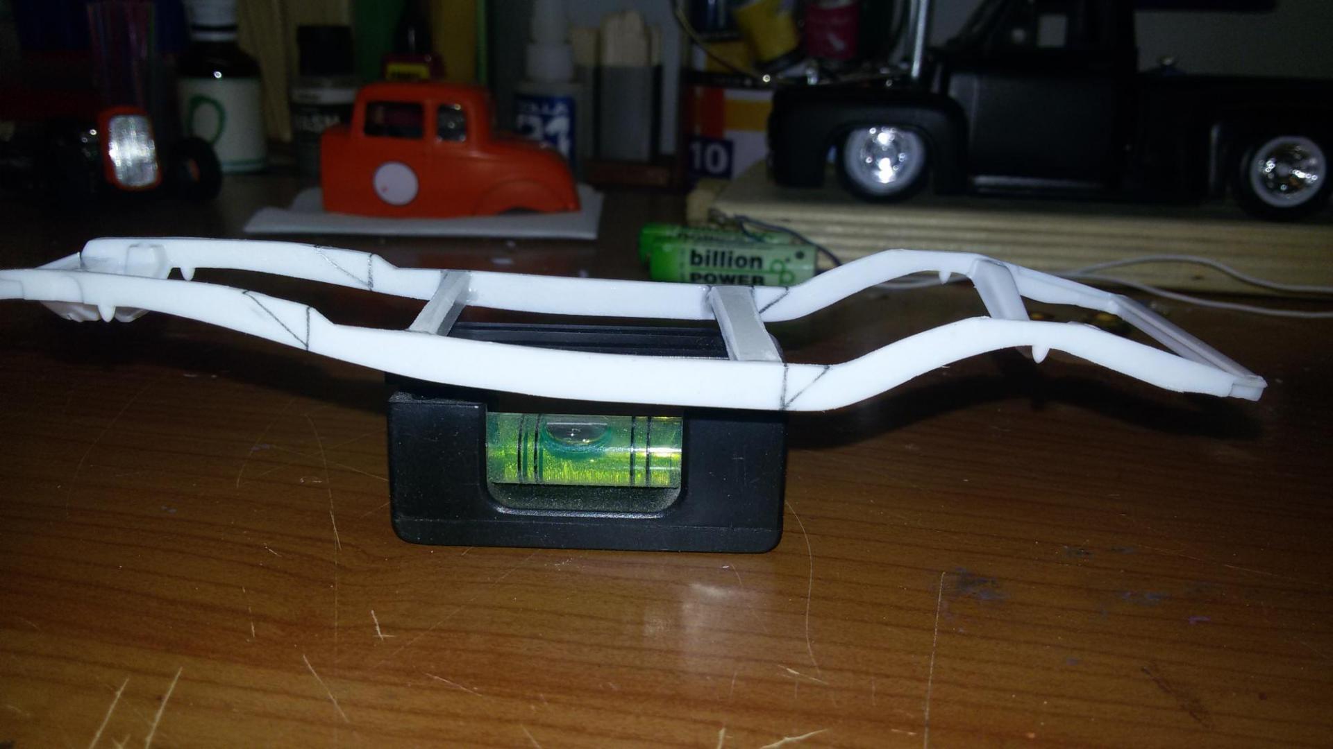

as mentioned, the next step is to modify the frame:20160920_084836.thumb.jpg.81cd3bc058add3
I then marked the lines for cutting and, not without a little fear, I sectioned.20160920_090621.thumb.jpg.017f69a65e5deb
I then built a template to make sure that was all in line20160920_092404.thumb.jpg.822c76b865dc30, and I glued with two-component glue.

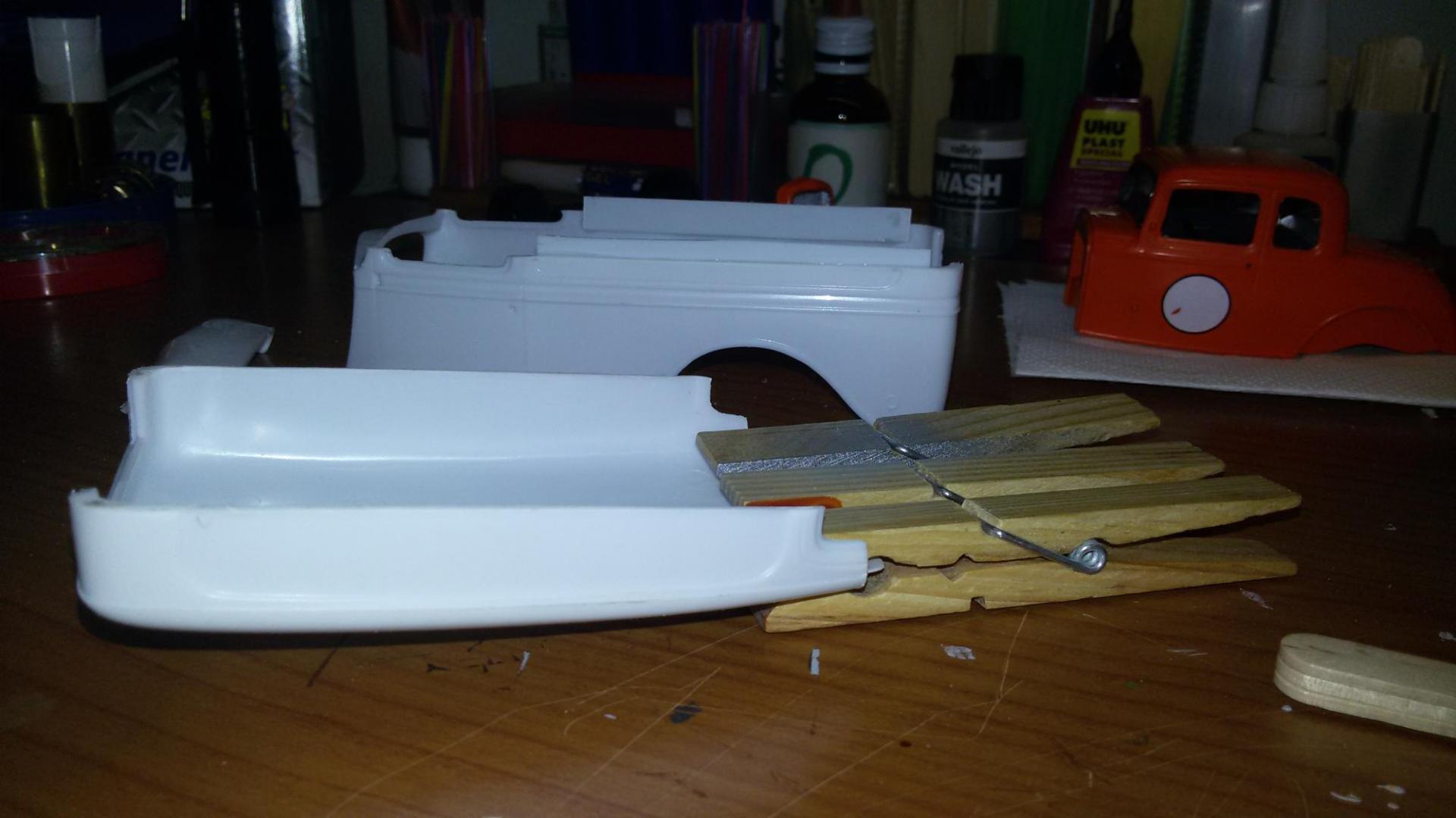

while the glue dried I built a piece of plasticard for joining the two parts of the roof that I had to cut on the length to ensure that pillars match
and I have also glued the top of the roof, adding a strip on each side inside the junction of the two parts.
20160920_094627.thumb.jpg.f42f2196f7ece520160920_095633.thumb.jpg.42ba6ad265facb20160920_095640.thumb.jpg.d74ddca31b2f5a

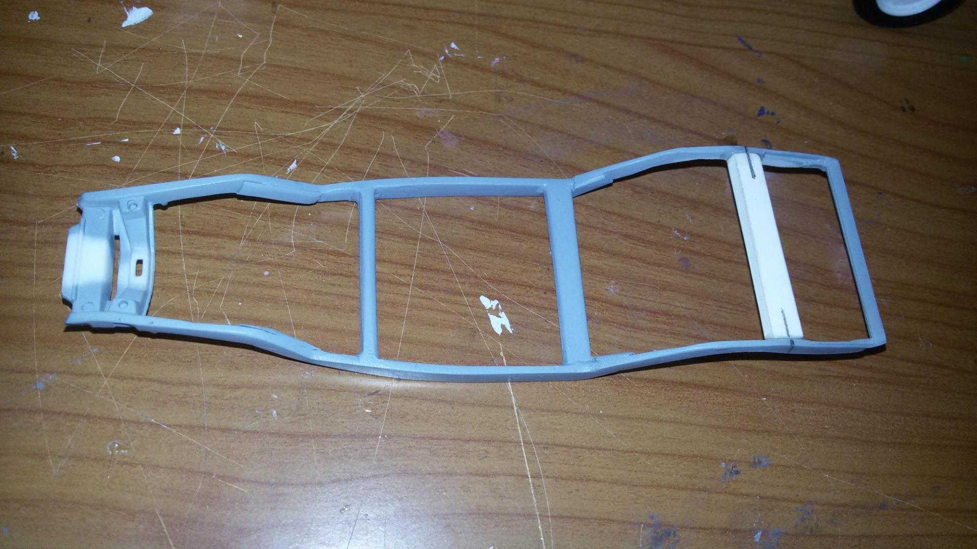

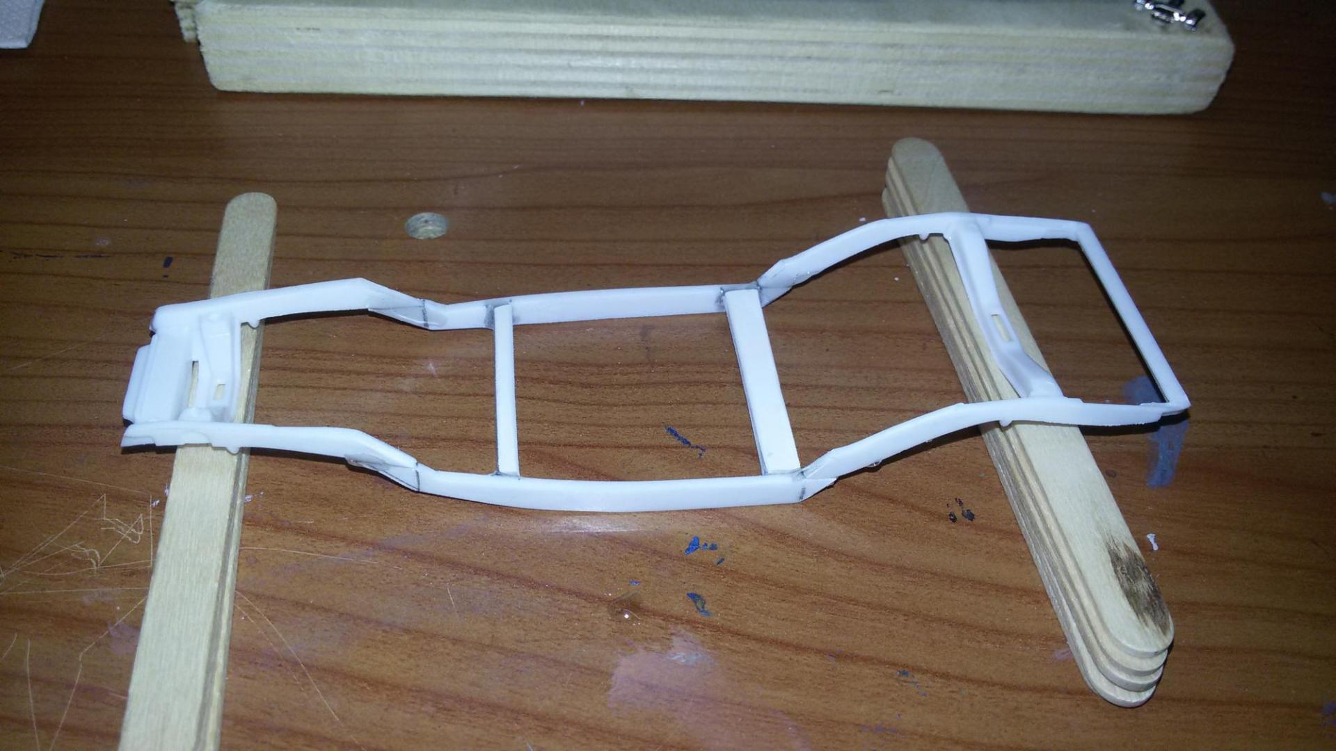

once the glue dried on the frame, this was the result:
20160920_115723.thumb.jpg.0dcf68b00c8d9f20160920_115731.thumb.jpg.3509bd3865a8ef20160920_115740.thumb.jpg.3a33d3b9a03056
as I said, the system for me is really simple and not difficult, just make sure that the pieces are properly positioned.
I think I got a good result, I was not convinced to do it, but I was satisfied at the end.
regarding the bodywork, I i then glued the front of the roof in position.
in the picture you can see the left pillar that does not fit at all well, luckily I noticed and I was able to fix it before the glue dry.

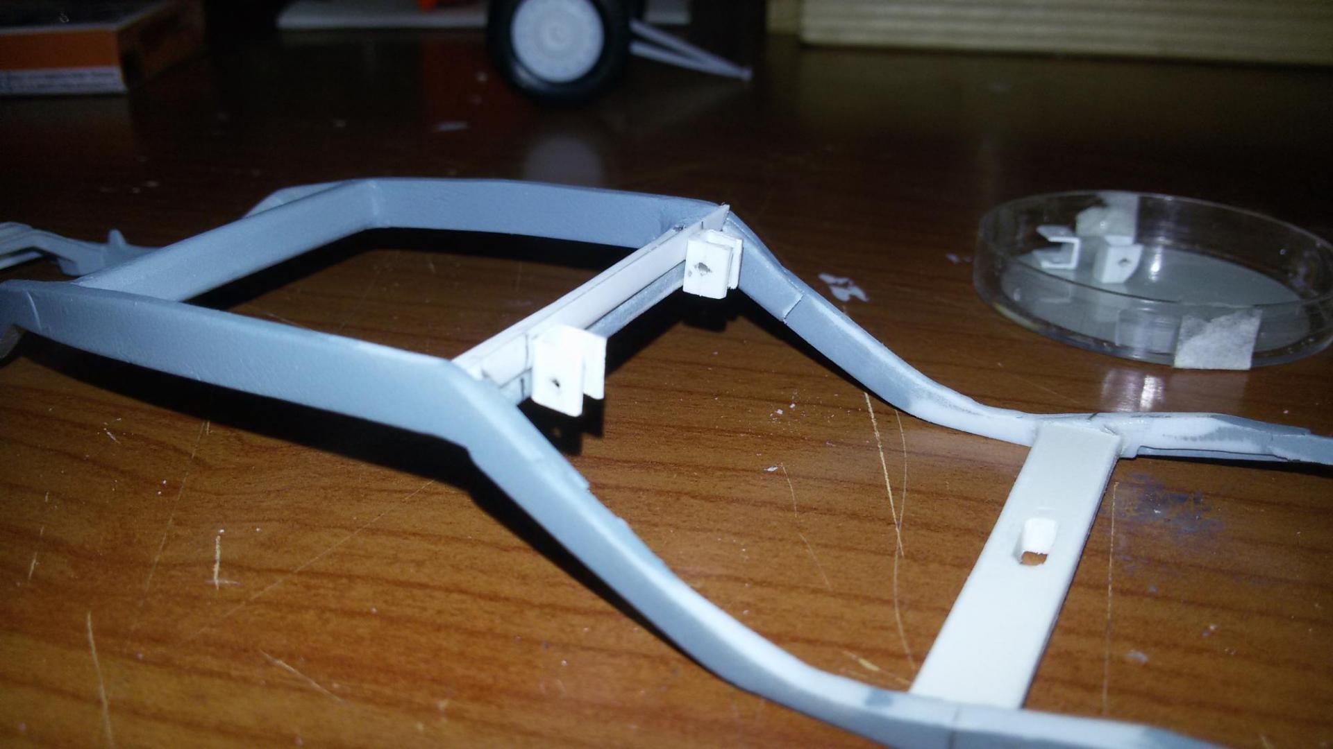

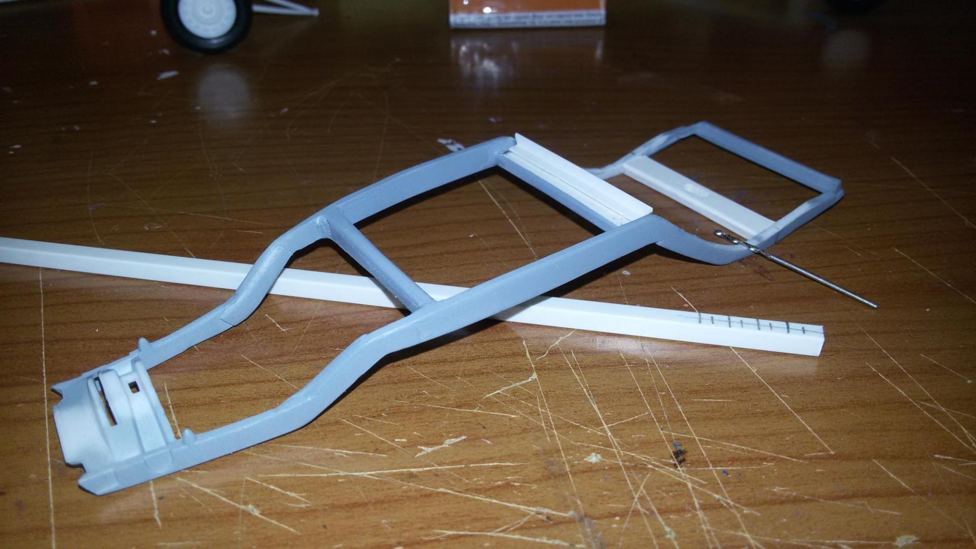

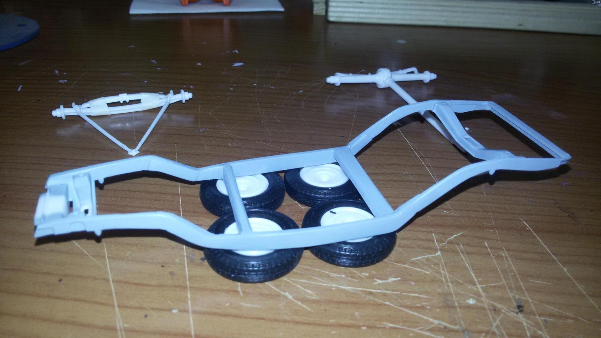

I then given a thin coat of primer to the frame to show the faults:20160922_113916.thumb.jpg.4228993cda5f9220160922_113925.thumb.jpg.2b9dbcb8a2dd3f20160922_113935.thumb.jpg.d74d2e10562850
oh, and you can see that I have added reinforcements inside the frame at the four points where it was glued, I was afraid that only the glue was not enough.

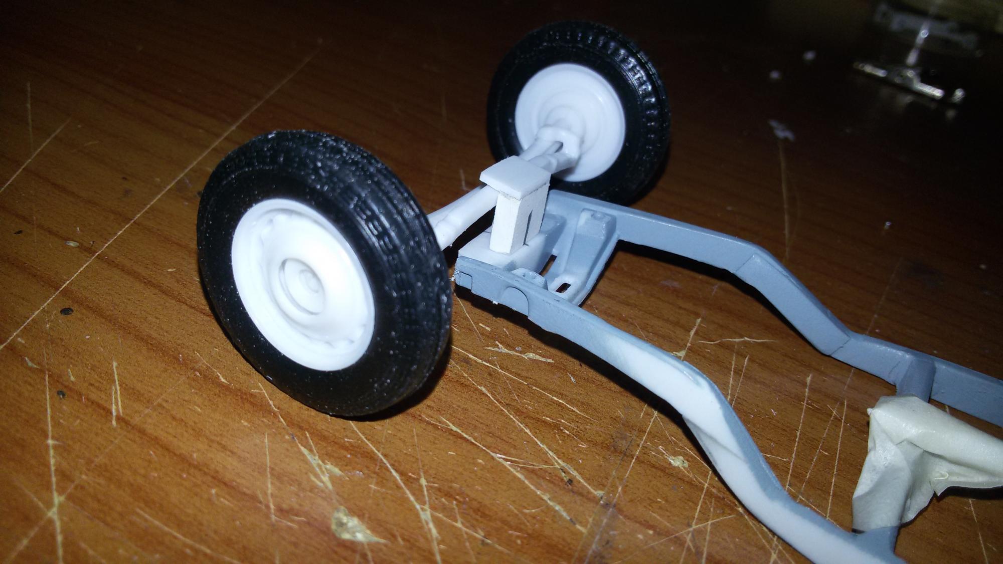

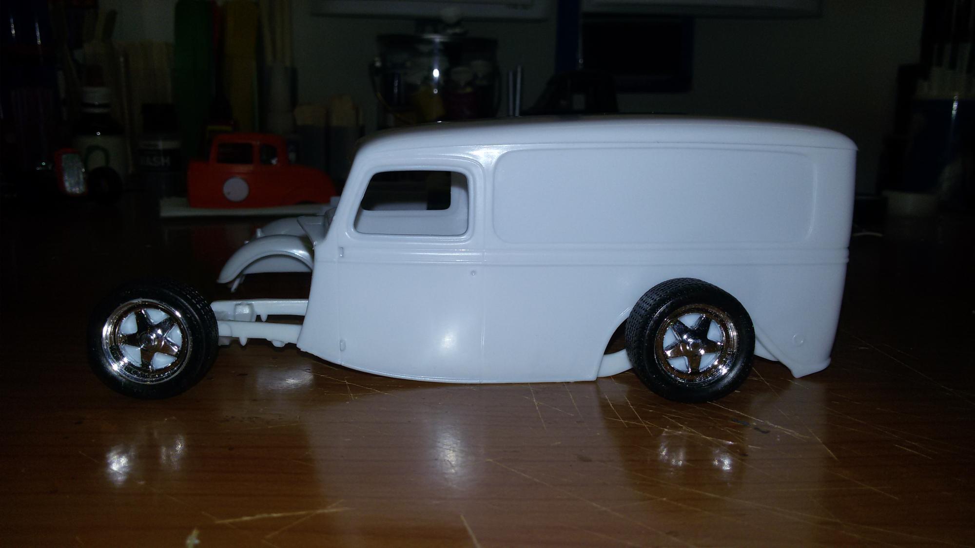

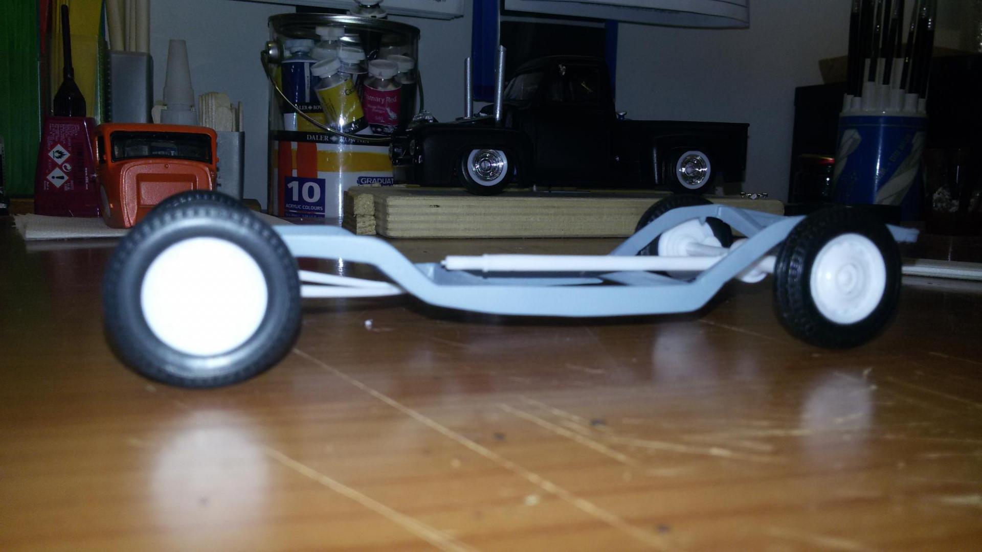

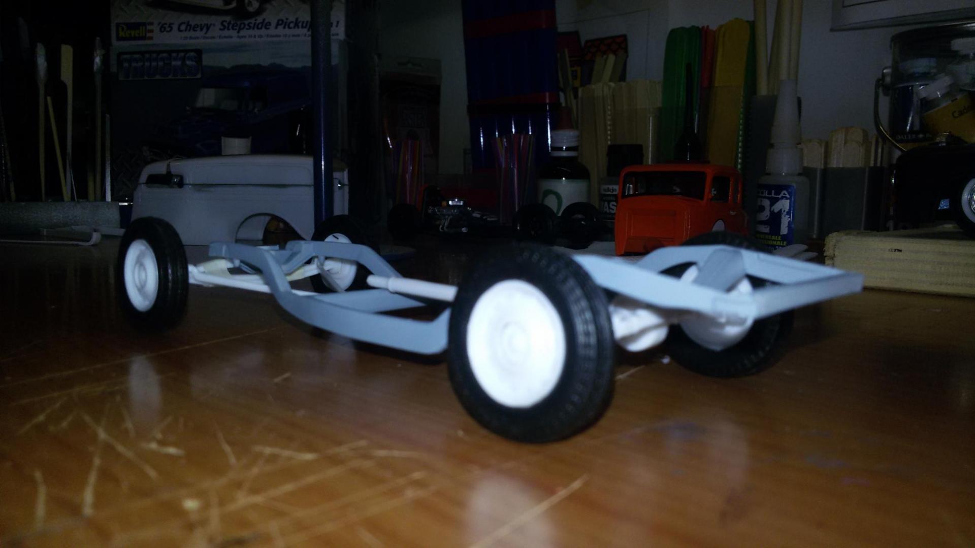

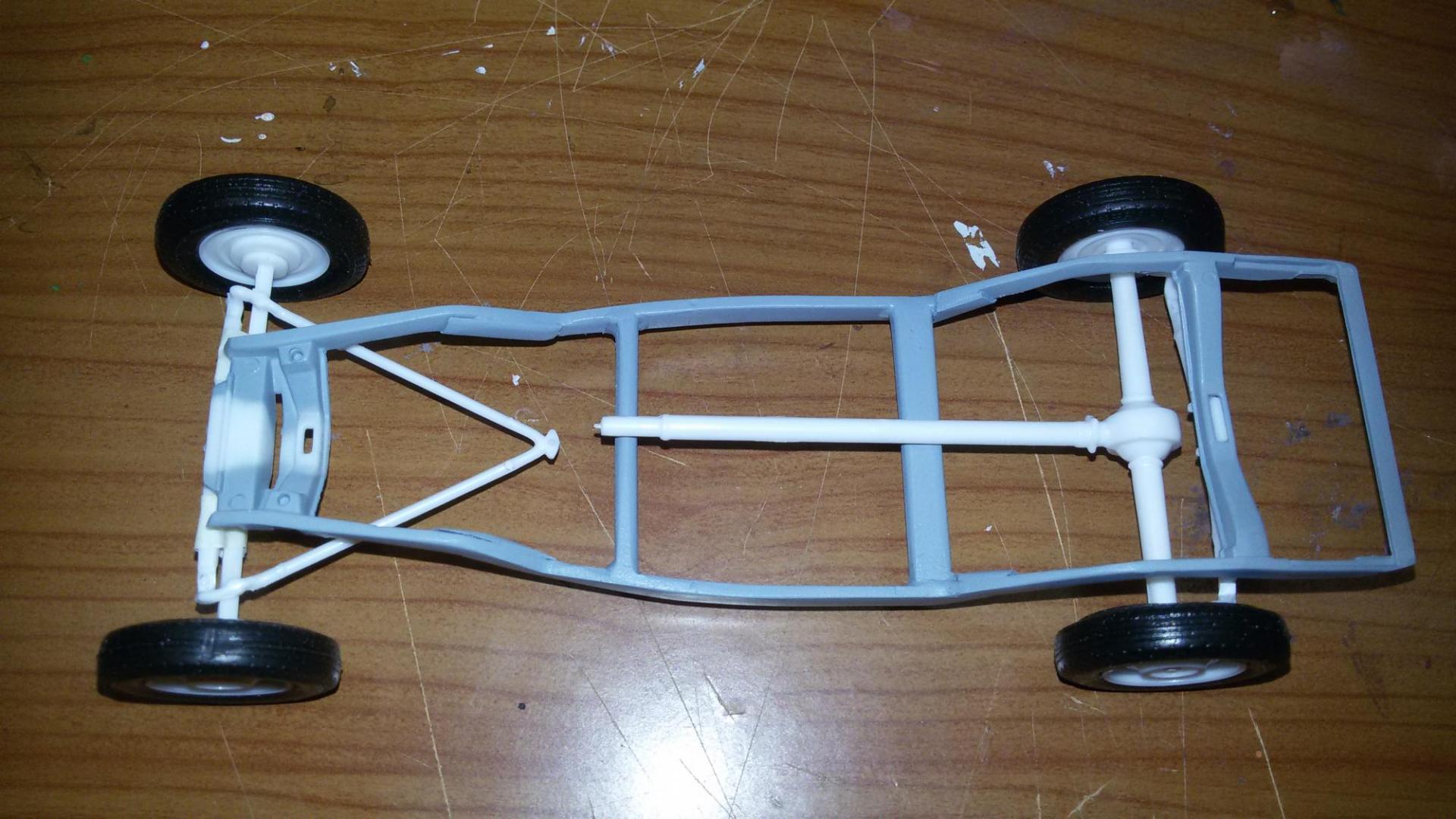

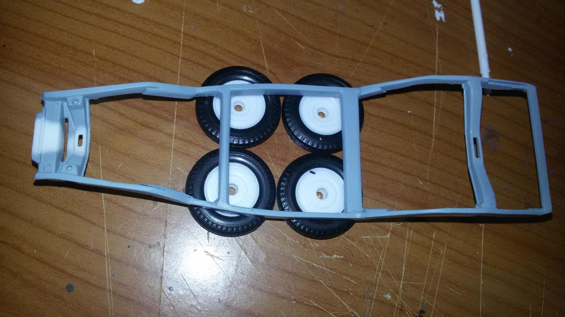

I then made a set-up test with the original suspension to see how ground clearance was
20160922_115126.thumb.jpg.cdc78aedce7b2620160922_115138.thumb.jpg.d566644235d89320160922_115148.thumb.jpg.6c76d1509e7f9820160922_115158.thumb.jpg.38a6137bcb0a5e
definitely too high, I want it much lower!

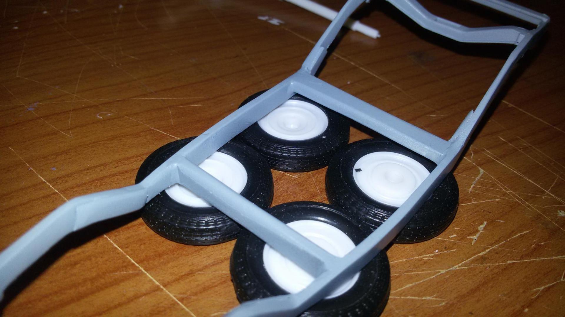

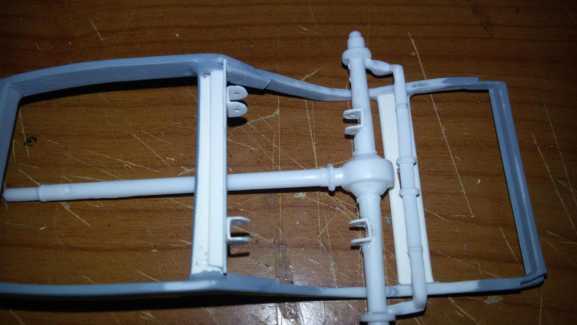

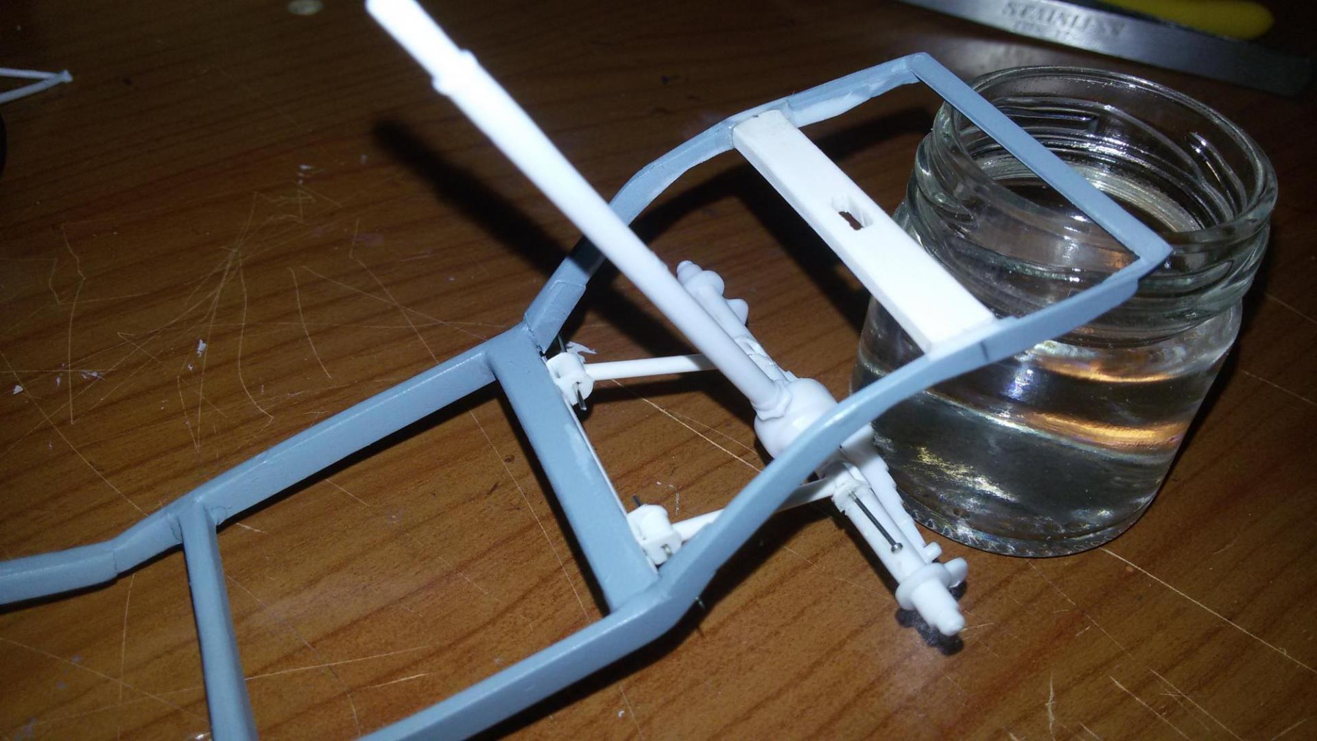

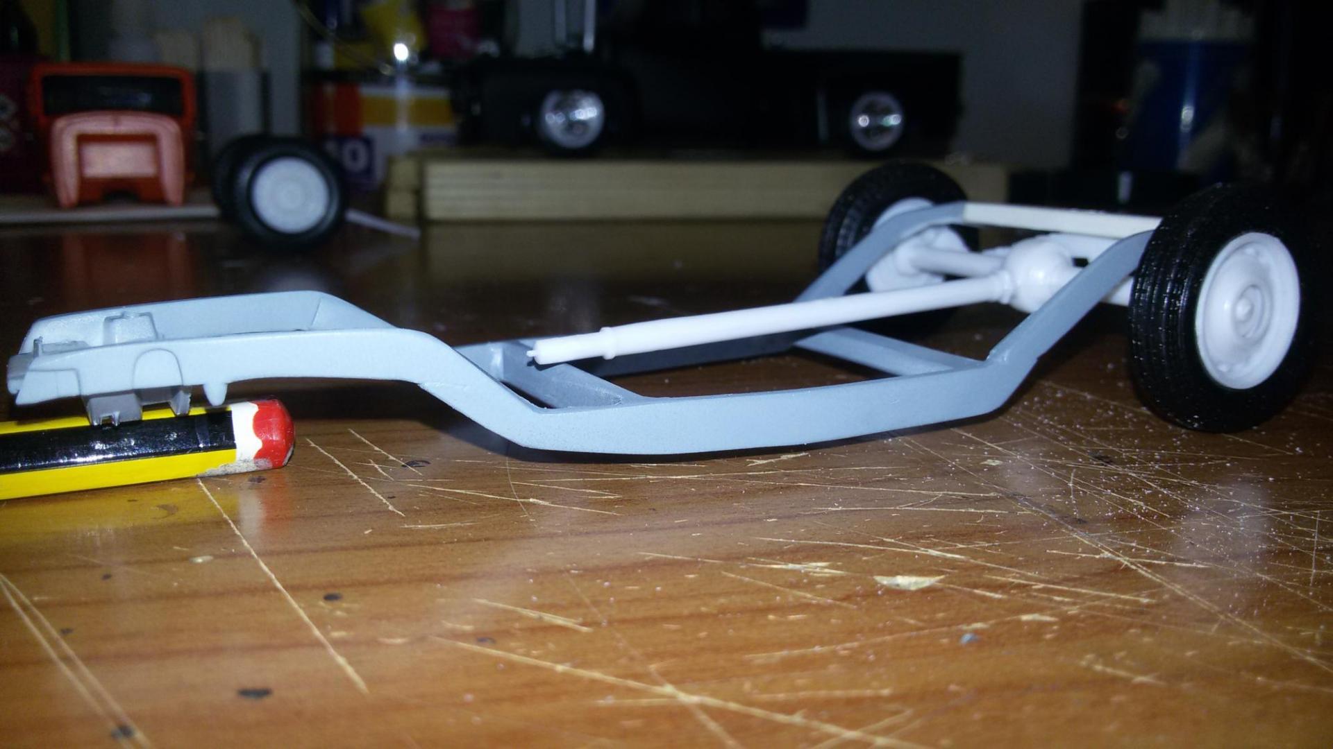

so I started from the rear to further decrease the height from the ground; I removed the rear crossmember and I rebuilt one in order to move further up the attack of the crossbow
20160922_154746.thumb.jpg.e2594d6d769fc620160922_154759.thumb.jpg.fb4da4518cb286in the new crossmember I replicated the original fitting of the Crossbow

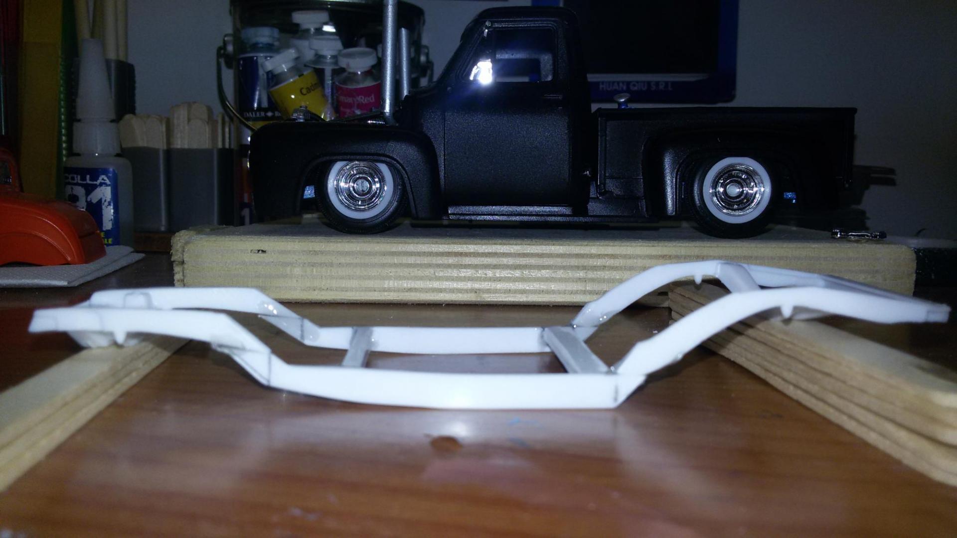

new height test , much better this way,this is the ground clearence that i want!
20160922_161709.thumb.jpg.4f17f82f293d80

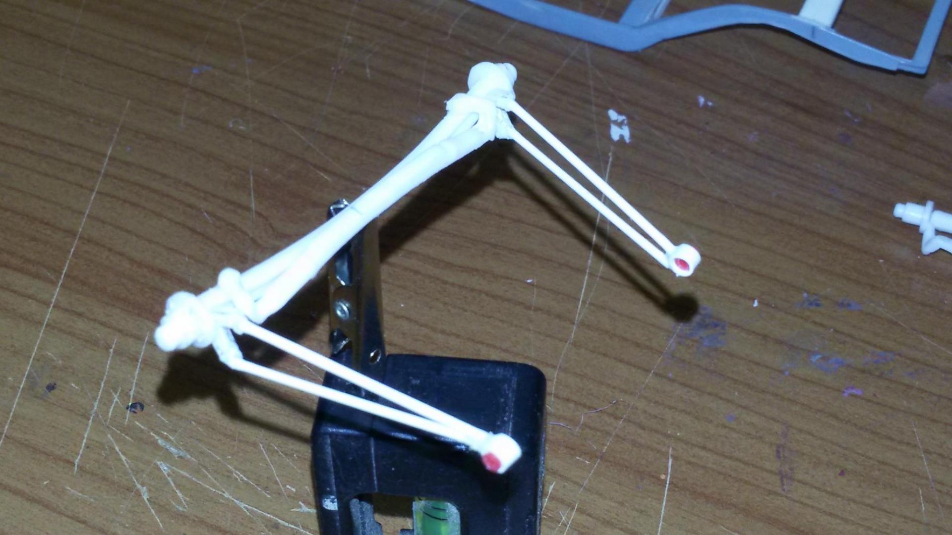

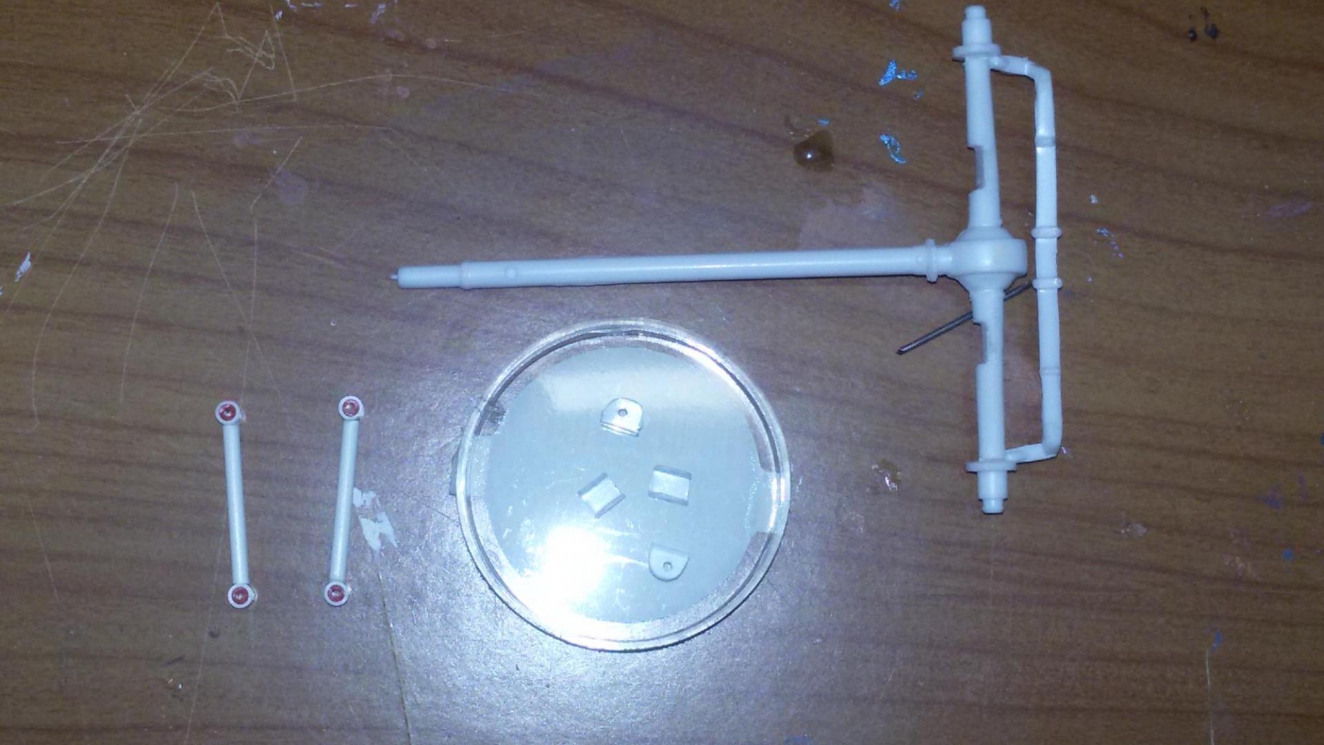

in the next photo you can see how I've changed, rebuilding them from scratch, the tie rods (I think ...) of the rear suspension; now, I know that maybe is one not too realistic scheme, I probably would have had to add two more arms or something else, but ... boh , I did so, I do not know why!
20160922_171326.thumb.jpg.23f188b2963aab20160922_174132.thumb.jpg.fe31a5bf995e1c20160922_185203.thumb.jpg.d731700b8f147b20160923_094235.thumb.jpg.051cb916781fdc20160923_094202.thumb.jpg.d48b5a5b01848020160923_094124.thumb.jpg.cdf0d323cf31f620160923_094132.thumb.jpg.507b9457ff5f3220160923_124002.thumb.jpg.52645c3fe54ee7
i then redone the tie rods and brackets attack _ because I was not satisfy with  them, but unfortunately I did not make photos of new ones, perhaps you can see them in the following photos.

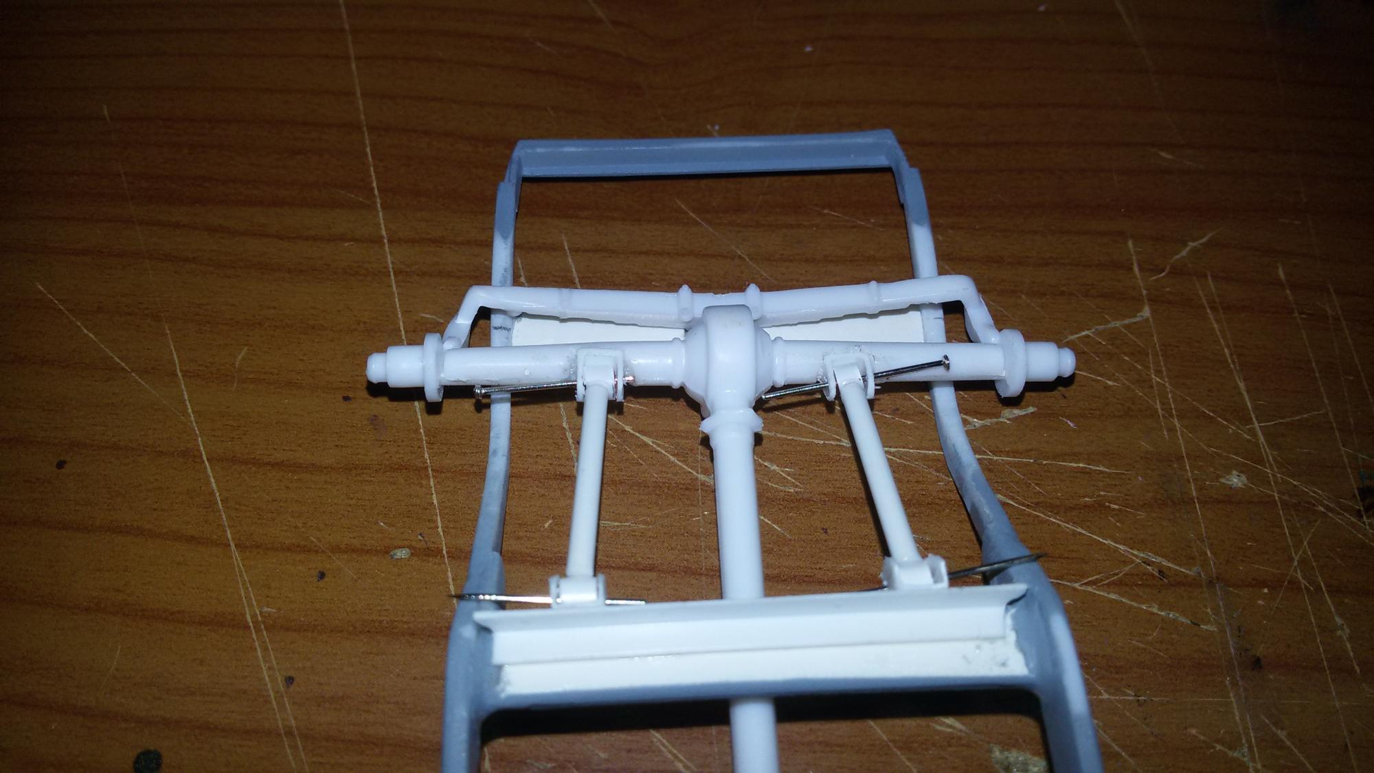

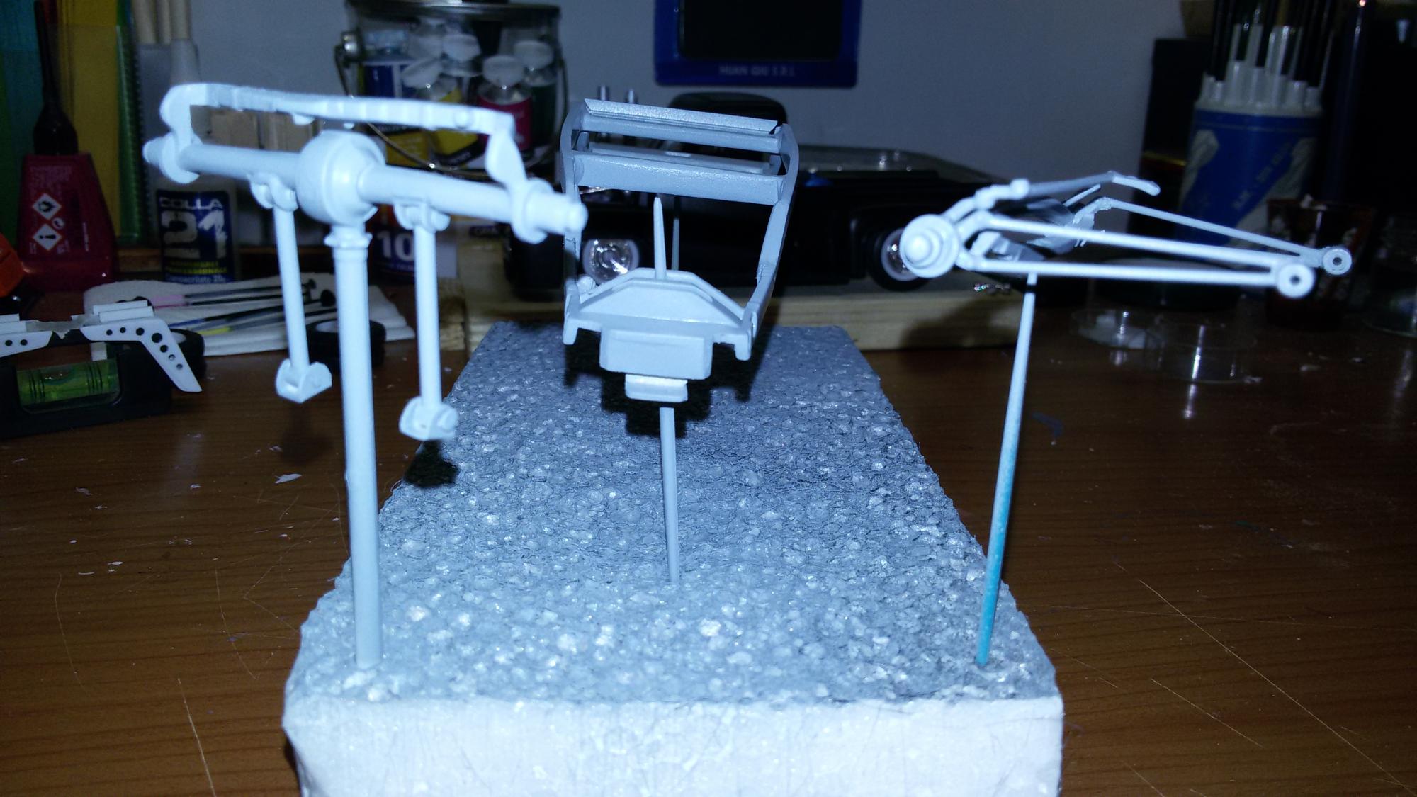

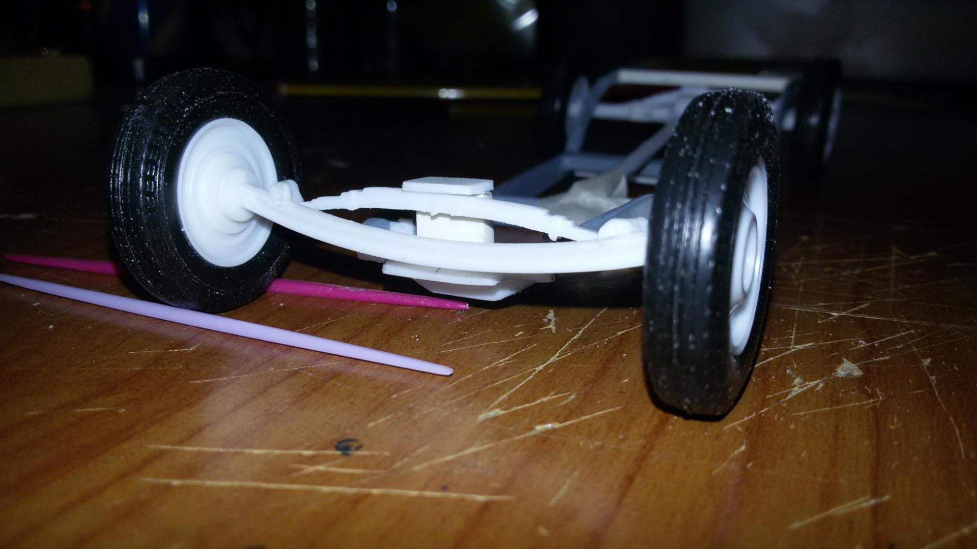

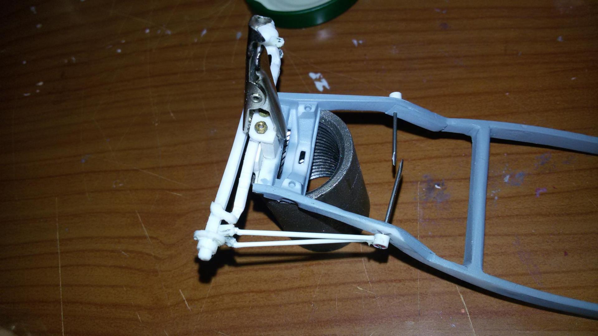

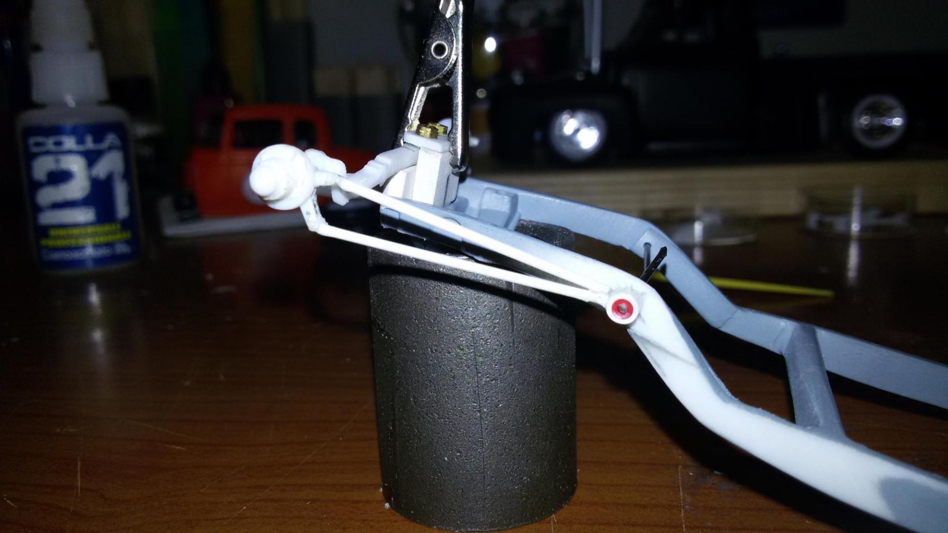

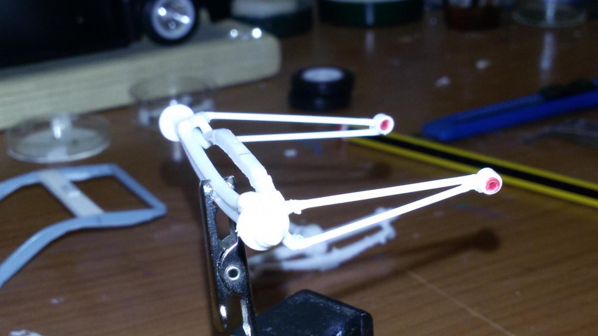

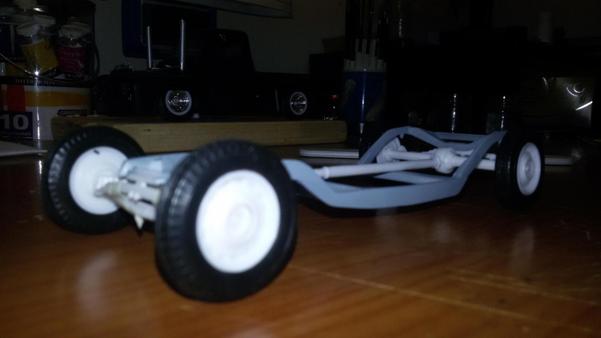

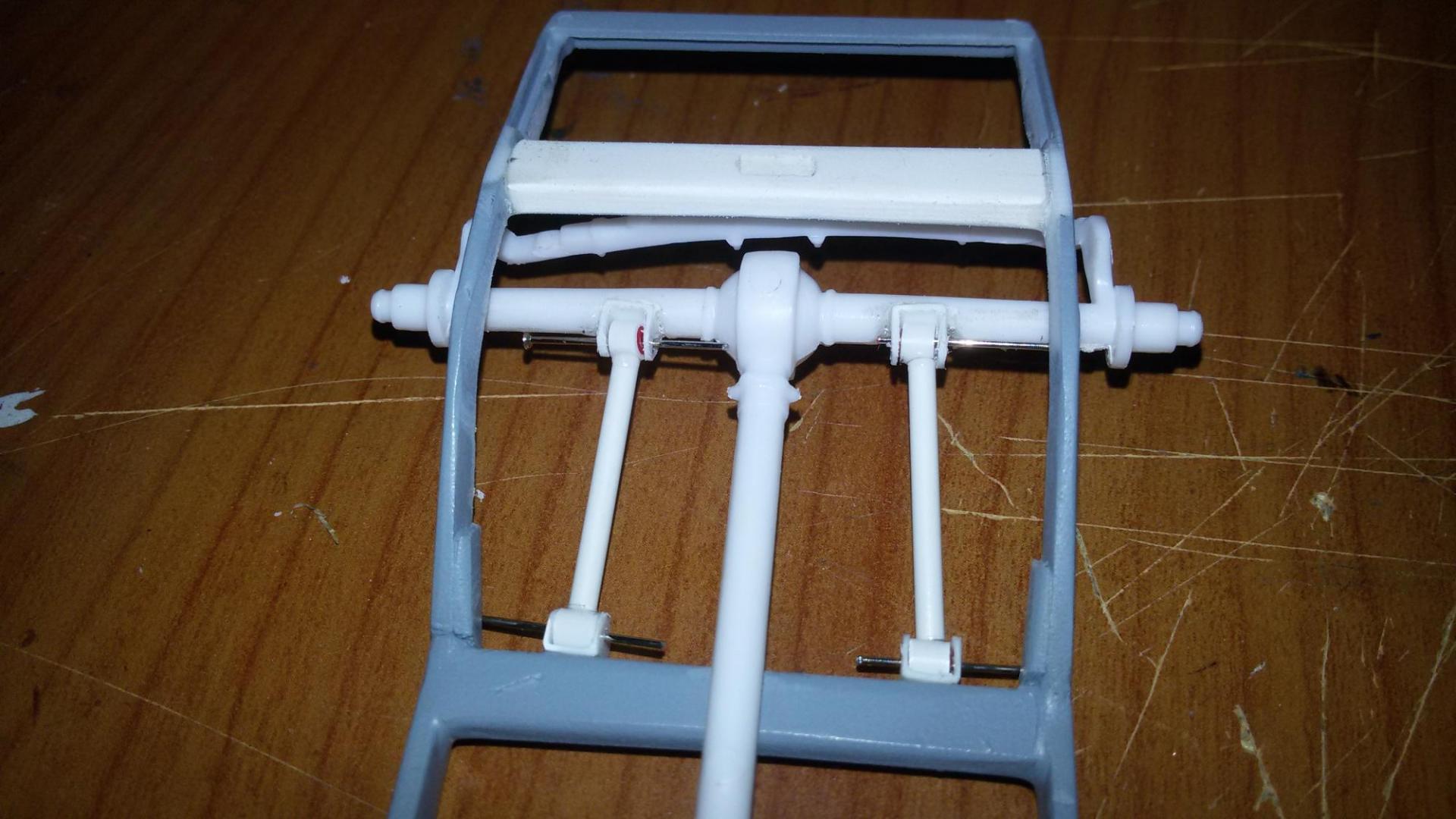

at the front, I moved the suspension to the front of the frame, creating, I think, a suicide front end.
I built a bracket and a support for pinch the leaf in the middle and I built from scratch the tie rods.
I then drilled the frame for fixing.
here too, i don't know whether it is a realistic scheme, I copied from some pictures found on the net.20160923_174816.thumb.jpg.bd86eb33a2a15620160923_174828.thumb.jpg.198af09b950c5e20160923_170456.thumb.jpg.85705cb007b3af20160923_170445.thumb.jpg.ad8cf3f4a769d720160924_103946.thumb.jpg.d5bc1a0f791fa020160924_103954.thumb.jpg.2e4eee77deb21a20160924_120901.thumb.jpg.d0f497fe61d3ff20160924_120915.thumb.jpg.9e8ed0082cb18a
sorry for the pictures with flash, I realize now seeing on the computer screen that really sucks, I hope the next are best.
Control heights with new front setup: OK
20160923_175711.thumb.jpg.24b48e84d02211

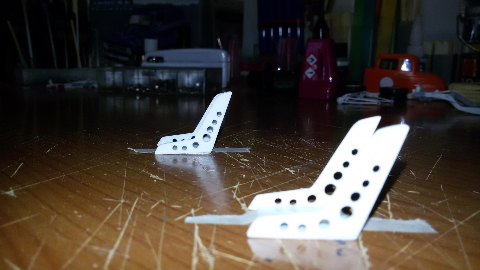

in the meantime I built the seats
20160926_103234.thumb.jpg.8b6ba97639109a20160926_104936.thumb.jpg.b8f00e39b4bd8320160926_104946.thumb.jpg.5711cea71d7d52
... And Obviously I did not took pictures of the finished seats ... oops ... ok, you will see later in interior pictures anyway...

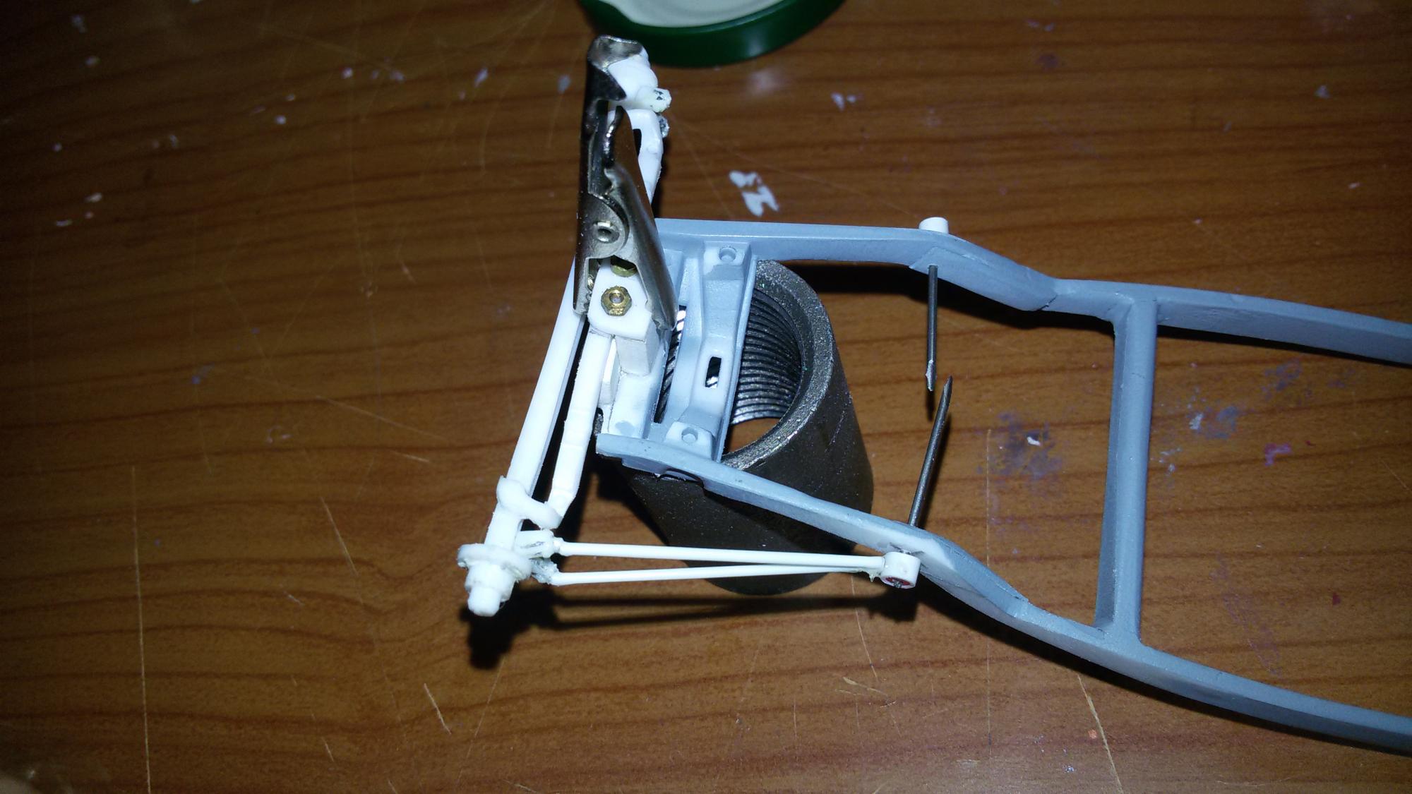

Now is the time to find the positioning of the engine and build the supports.
i used the engine of this kit :
20161011_103325.thumb.jpg.575f72f60035ed
I built two simple lower supports (with a lot of effort to find the right positioning) and the gearbox rests on the crossmember properly shaped
20160928_114439.thumb.jpg.fdb2a29145ffc220160928_114449.thumb.jpg.d5c642a668599820160928_114533.thumb.jpg.4e1cb8e2dbaec7and in any case it is not straight! later I will try to straighten it, now she came to me the unhealthy idea of building a supercharger from scratch ...
unfortunately I have no photos of the construction, however, I used round tube, some plasticard leftovers, washers and various other pieces that I had on the bench ...
this is the result, perhaps not realistic, but I was satisfied with it:

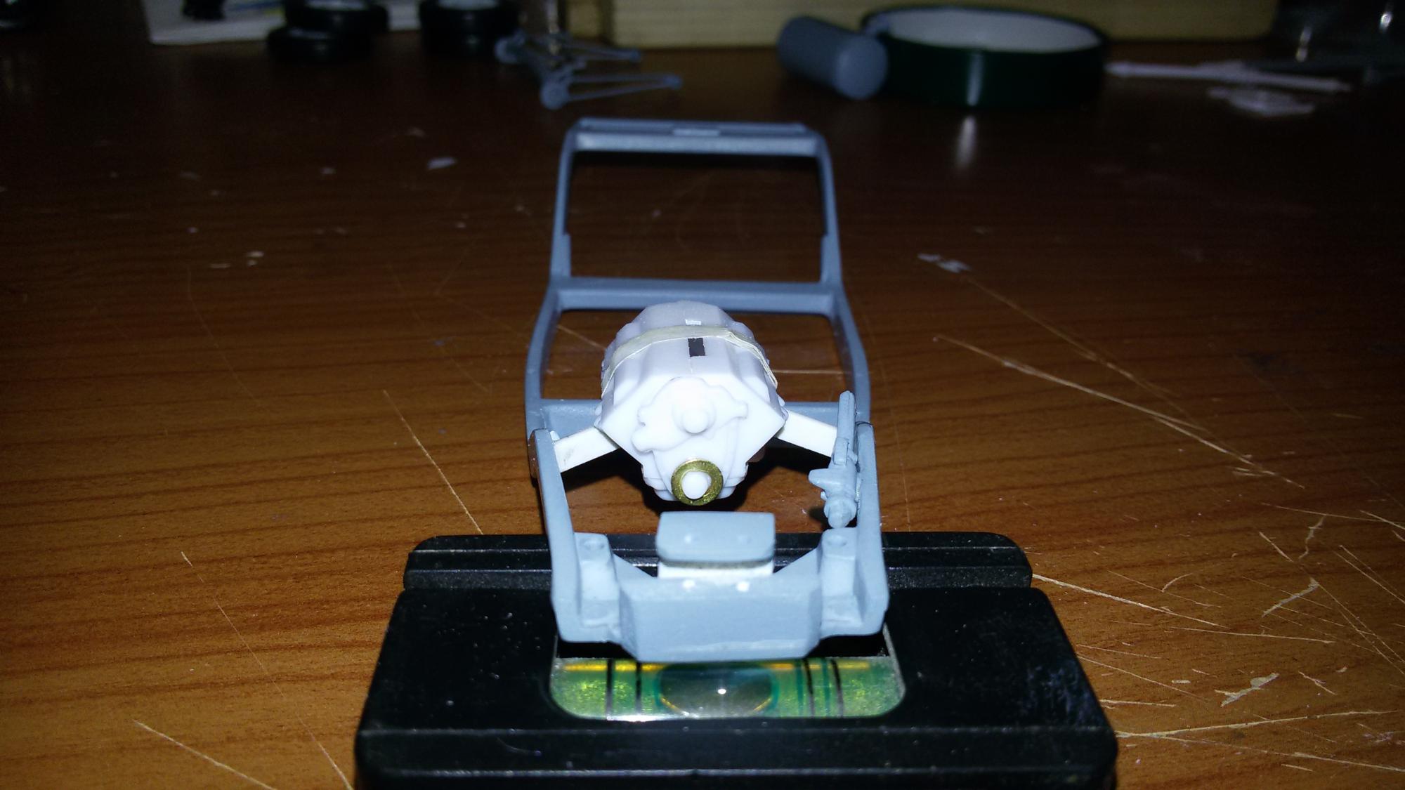

meanwhile i've partially assembled the motor and the turbocharger and mocked up on the frame with also the interior and the rear floor
and with the body
