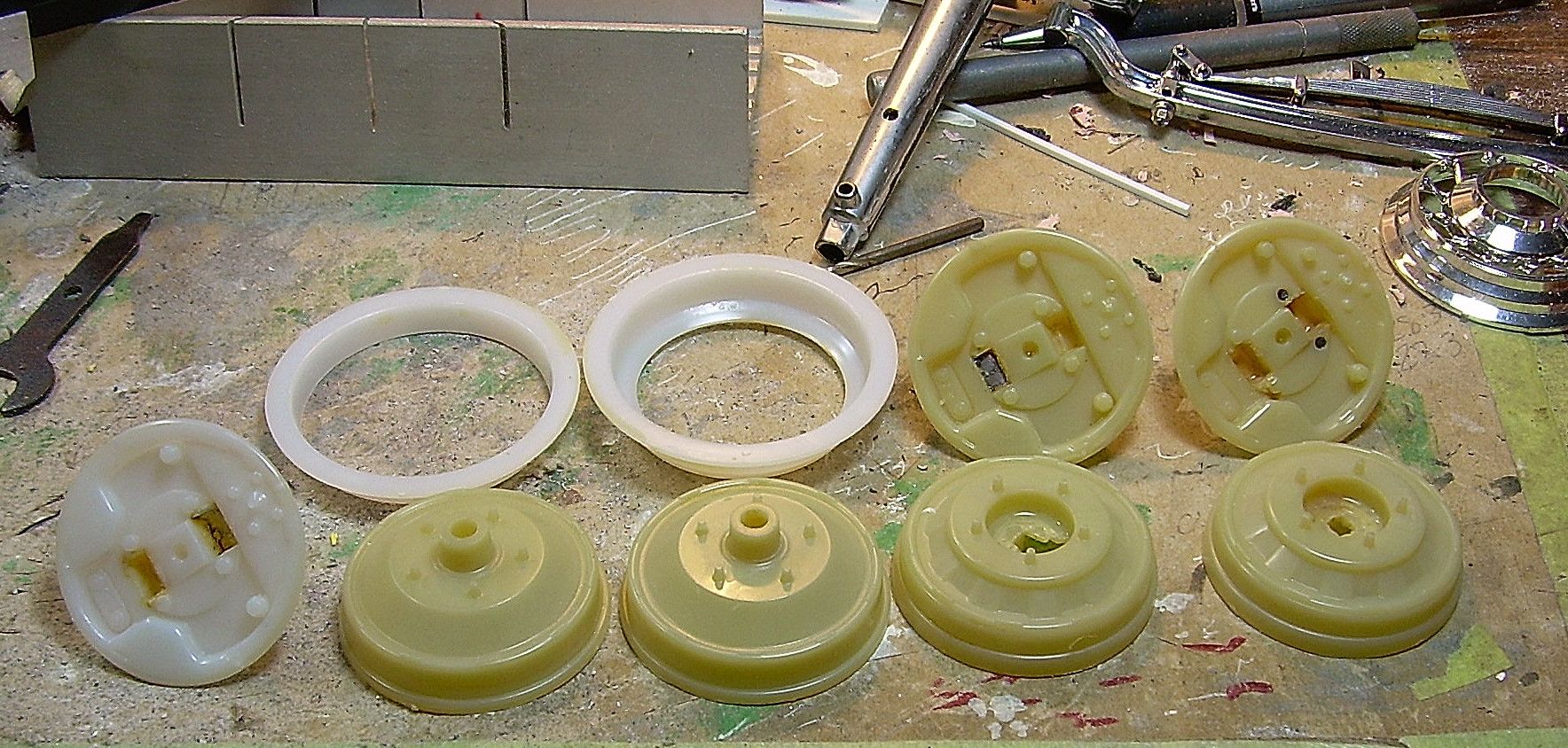

Ace-Garageguy Posted October 30, 2016 Posted October 30, 2016 (edited) The brown residue is most likely a combination of the clear undercoat that's under a lot of kit chrome, and residual soapy scum from the oven cleaner. I use the real smelly EasyOff stuff, let the parts soak in a sealed plastic bag for a couple hours...which always seems to loosen EVERYTHING...and then rinse and SCRUB with HOT water, Comet, and a toothbrush. Results? These are 1/8 scale parts that had thick chrome and undercoat... WARNING WARNING DANGER DANGER: WEAR EYE AND HAND PROTECTION. OVEN CLEANER WILL BURN HANDS AND EYES. Edited October 31, 2016 by Ace-Garageguy
