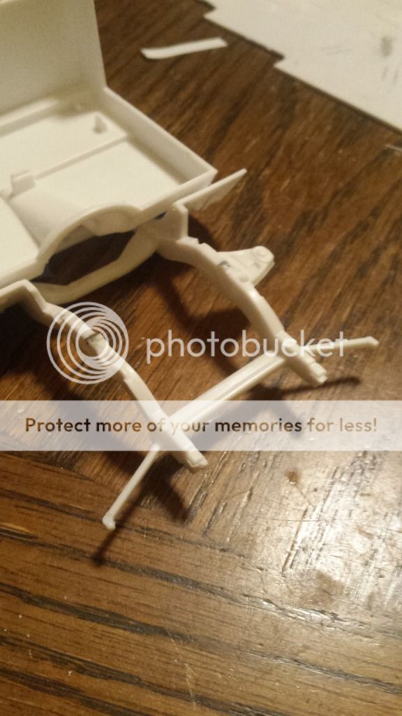

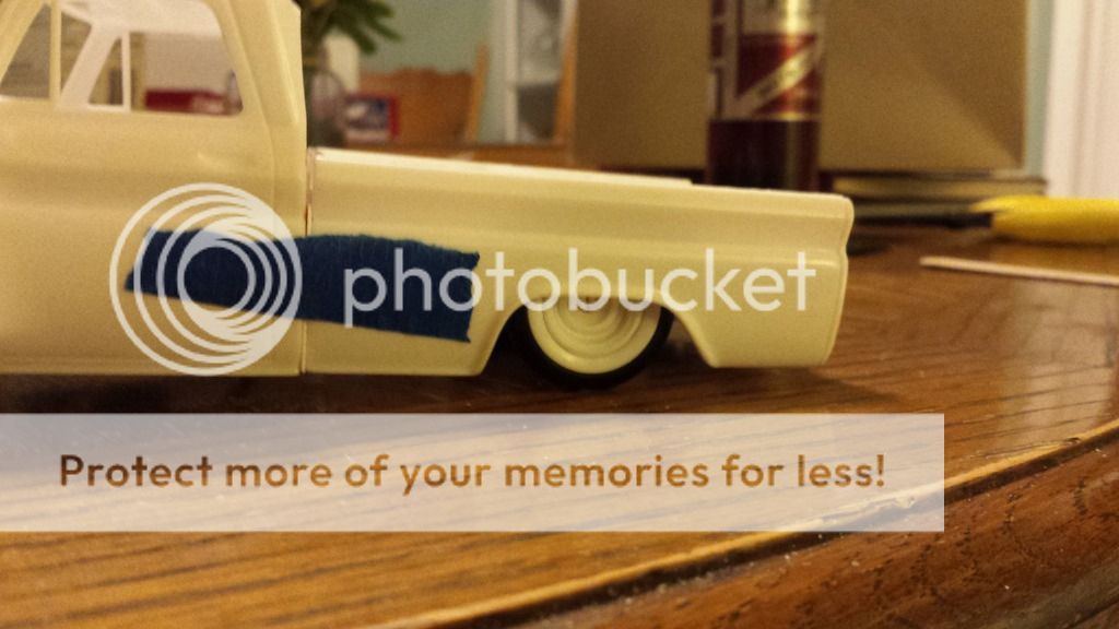

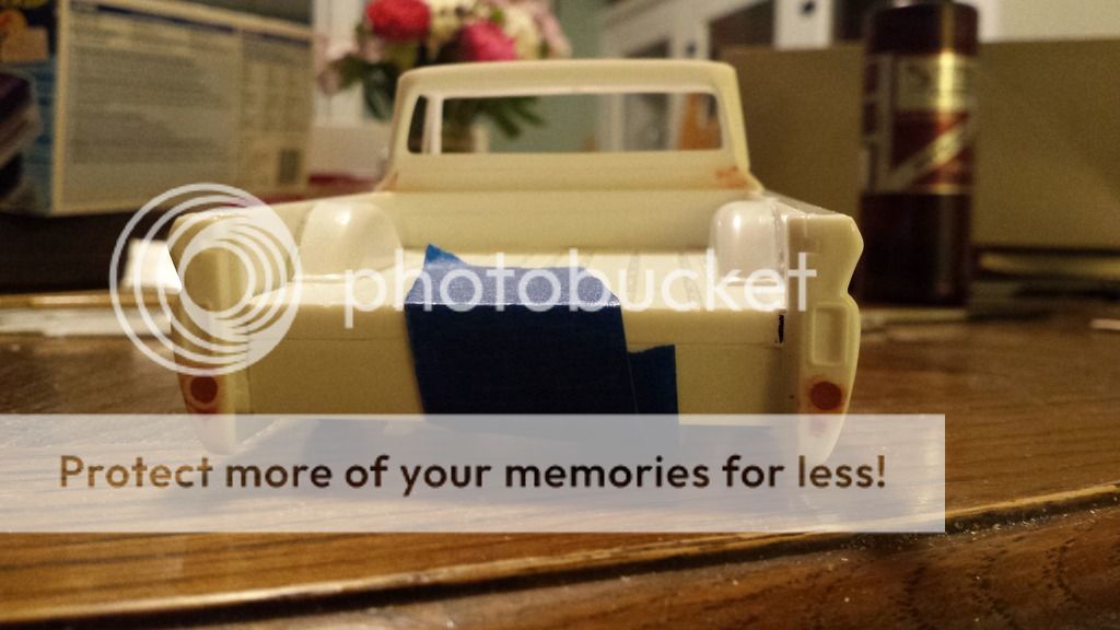

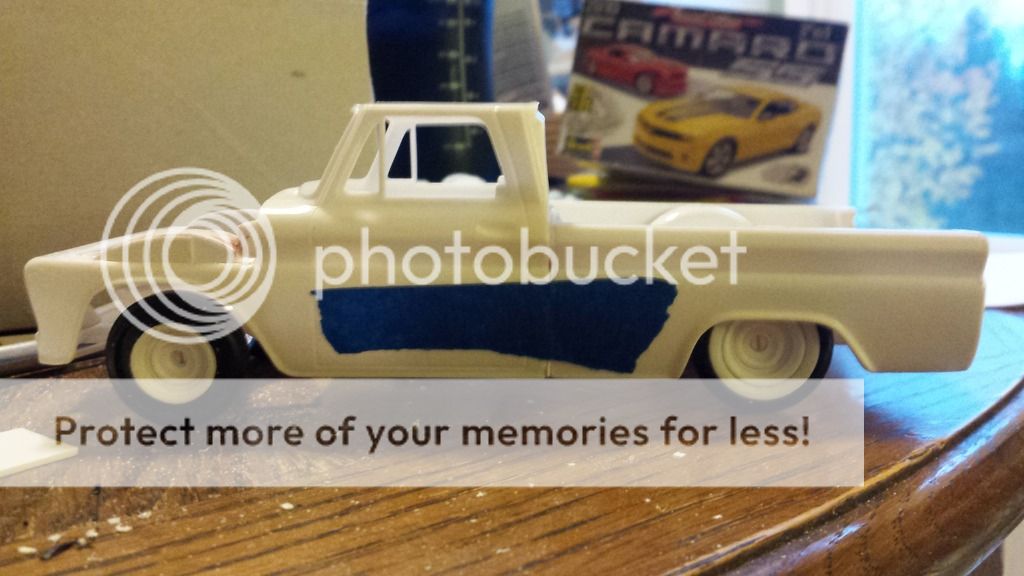

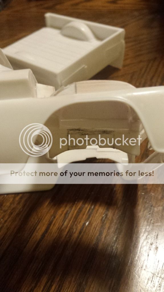

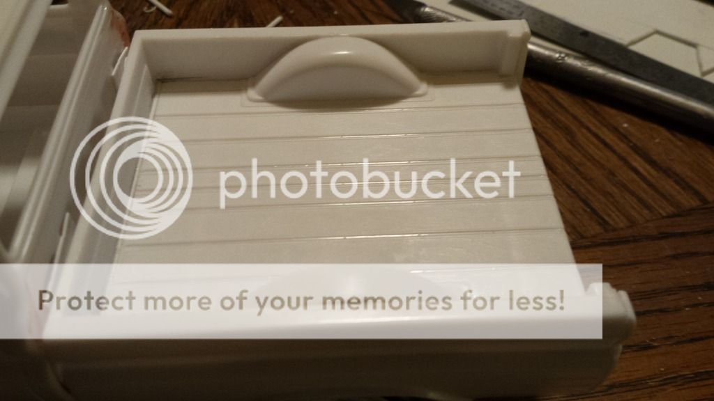

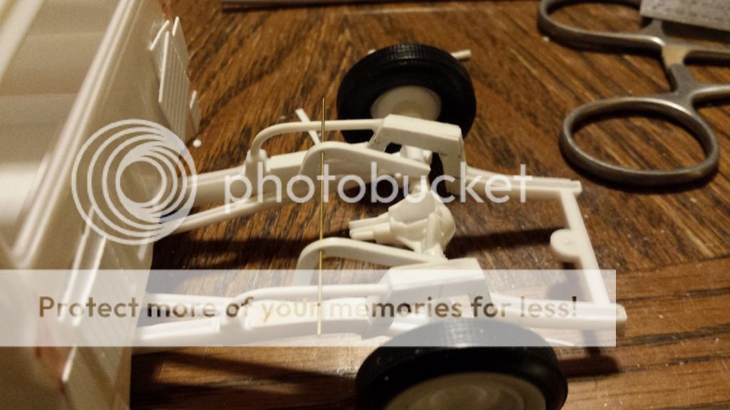

Modlbldr Posted October 31, 2016 Posted October 31, 2016 Since I am home recuperating from the hospital I figured it was a great time to.work on a project. However, my current 3 projects are all at work. So I dug out this kit that I had started the clean up on a while back. I am planning a truck that is extremely lowered, perhaps even laying frame. So far I have roughed in the widening of the front wheel wells and raising the bed. http:// When I started this project I had thought of using wide wheels and tires but now I'm thinking stock tires and wheels. Well, the option is there. http:// This is how it sat in the rear after the begining of the c-notch. http:// http:// Here is the rear suspension I am shooting for. http:// http:// Still a lot of work and a lot lower to go. Later-

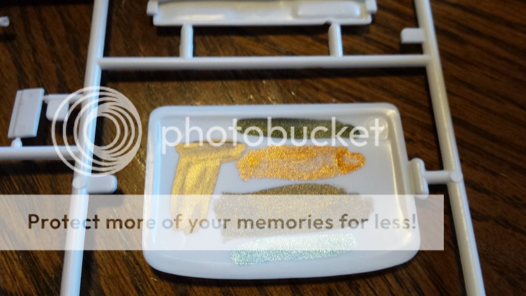

Modlbldr Posted November 6, 2016 Author Posted November 6, 2016 (edited) I'm thinking about complicating this project by scratching the side trim for it. I like the look of it much better. I have brushed out a few possible colors for this truck to see which, if any, I liked best. I may go with one or a "stock" color. What do you think? I am leaning towards the green on the top or the bronze (3rd down). All are nail polish. http:// I'm back to work tomorrow so progress on this will grind to a crawl. Later- Edited November 6, 2016 by Modlbldr

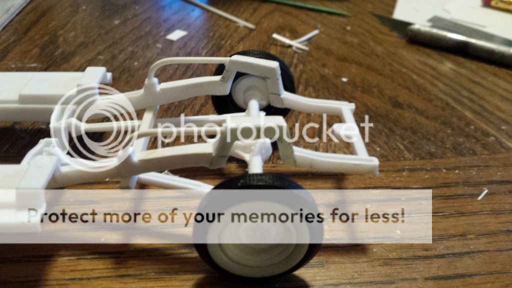

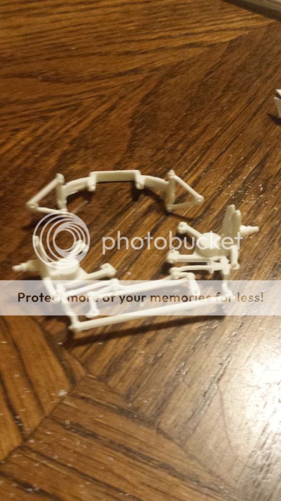

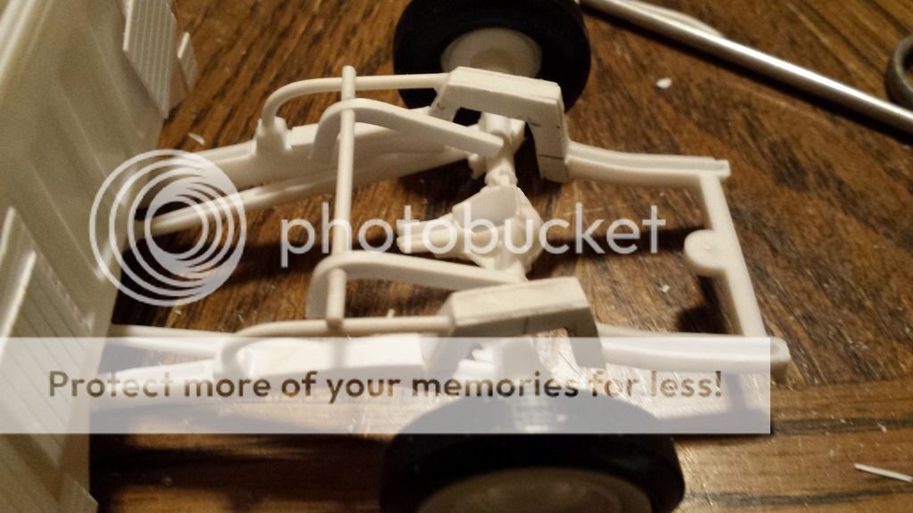

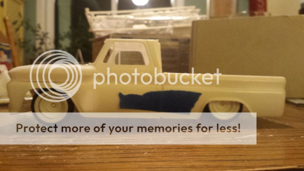

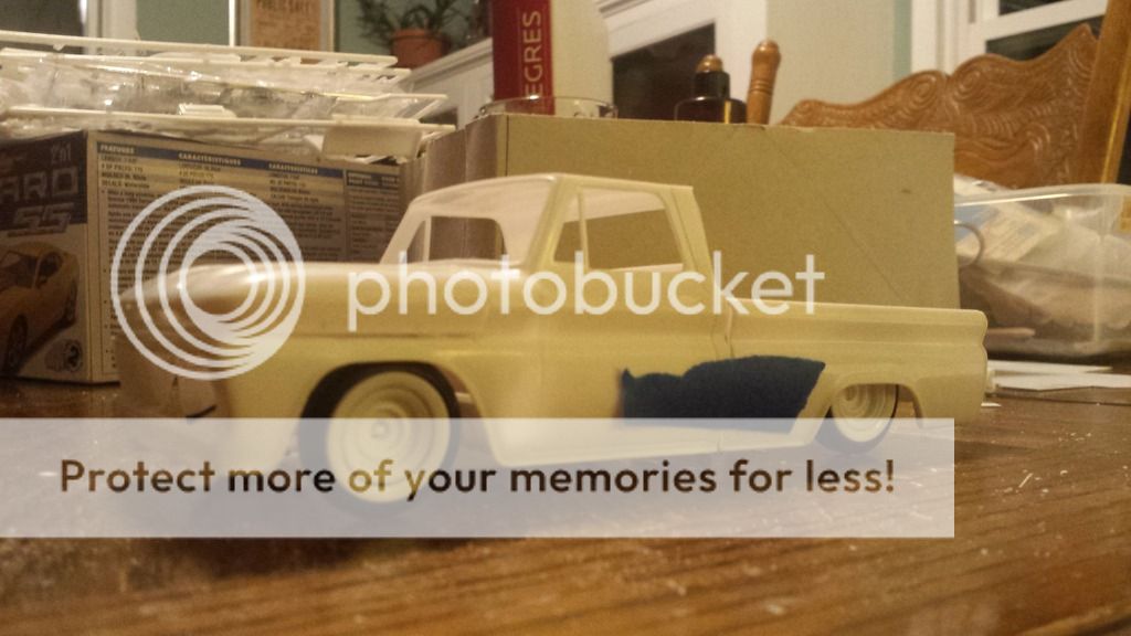

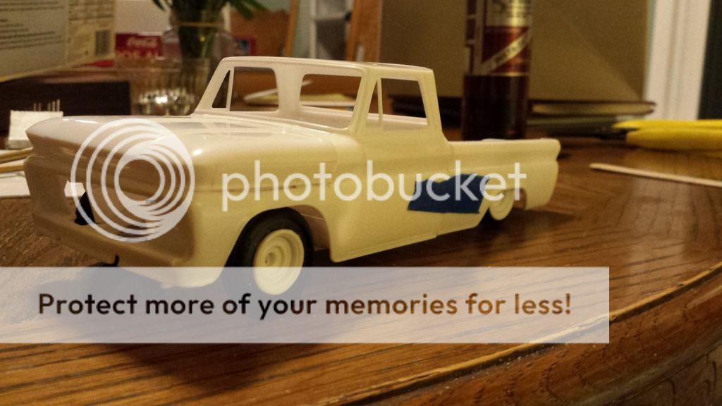

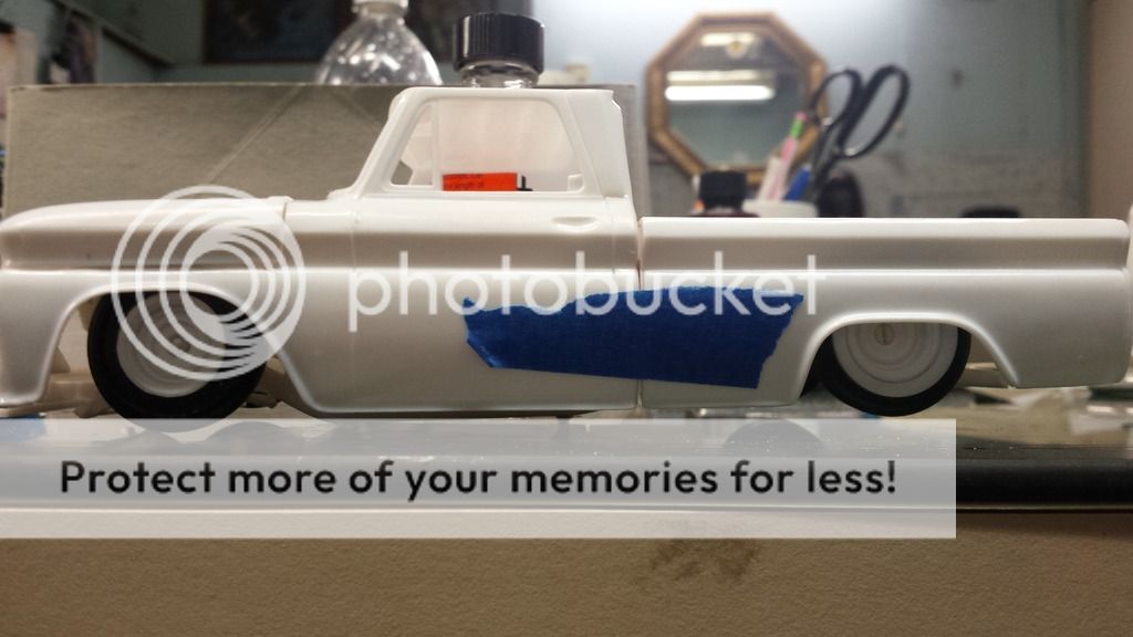

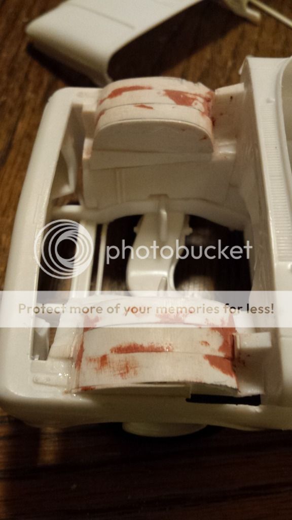

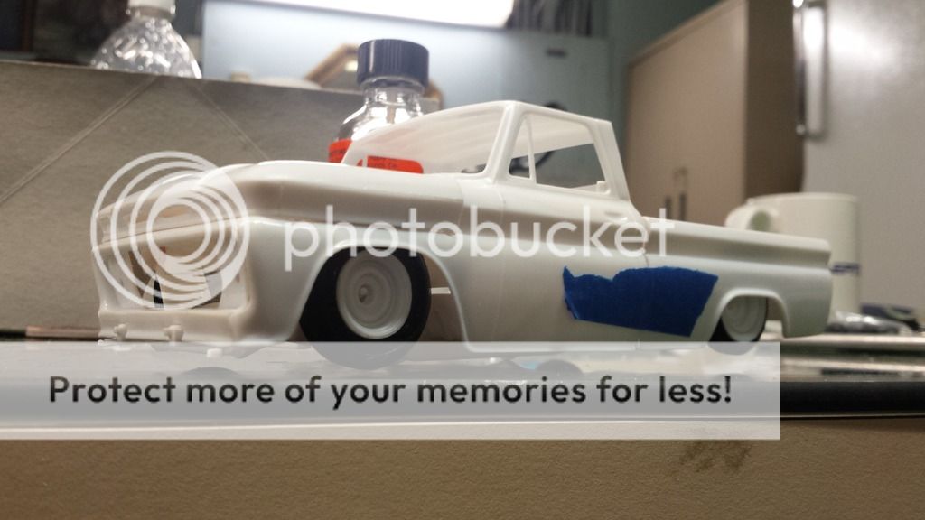

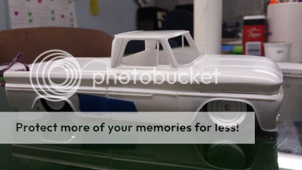

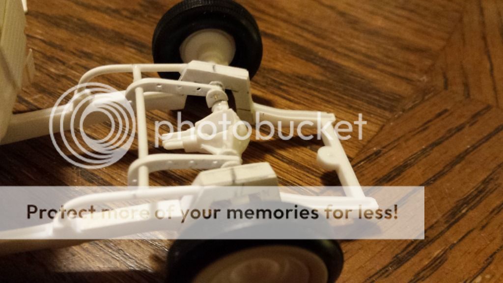

Modlbldr Posted November 13, 2016 Author Posted November 13, 2016 I've been extemely preoccupied these last few weeks but finally got a bit of time on this one again. Still have a bit of work on the rear suspension but I wanted to see what it was going to take on the front suspension to get it lower. I began with the front suspension from a NASCAR Monte Carlo kit. I removed the molded in parts on the pickup chassis. http:// These are the MC parts. http:// Here is the ride height with the parts just tacked in place for the time being. http:// I need to remove the shaded area of the inner fender panels in order to clear the upper A arms and see how the cab sits. http:// http:// http:// Not bad for an hour's work. Still needs a bit of tweeking. Or, I may leave it with a slight rake to the rear. I kinda like it like it is. Enough for tonight. Comments and criticisms welcomed. Later-

Modlbldr Posted December 12, 2016 Author Posted December 12, 2016 I managed to get back on this one for a bit during lunch today. I have started making side trim for the body. I have the passenger side done but still need to do the driver's side. Pics of that later... I worked on lowering the front suspension but got a bit too low. http:// http:// Now the frame cross member is dragging. I think in order to fix it I will lower the front spindles 1/16 inch. Otherwise I'll have to raise the cross members. Plan A sounds easier. I'm going to try to get a bit further on this tonight. Later-
