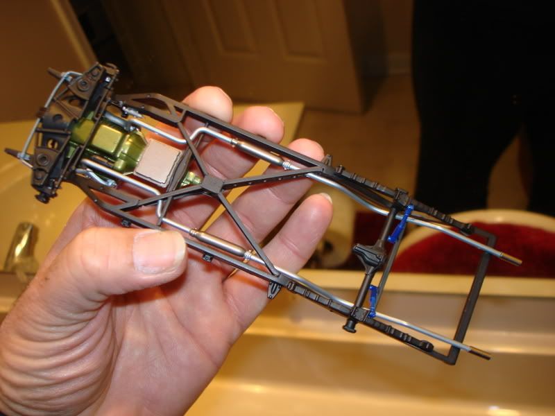

cruz Posted May 6, 2008 Posted May 6, 2008 I have had success using these little creams I found at a Michael's Craft store down my way. I used them on this Impala chassis and on the Model Car Garage Stromberg carbs. Very careful though, a little dab goes a long way. You can rub them with your fingers or w/ a small stiff brush. I used Model Master Stainless Steel Metallizer on the carbs first and them added the rub and buff gold color on. Finished w/ a wash of The Detailer...

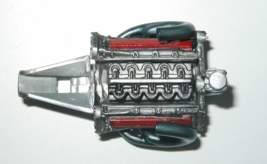

monkeyclaw Posted May 9, 2008 Posted May 9, 2008 Len; This is another one of those questions that you will get a lot of different answers to...and it really depends on what TYPE of aluminum finish you wish to replicate....all of the above mentioned products work GREAT for doing polished aluminum finishes; and I will add how I do "cast" aluminum finish; for engine blocks; gearcases , Turbos and such... I begin with a spray cn product called "cast coat" , available at auto parts stores; it is used to replicate the cast finish on alternators and cast parts when you replace them in older cars....this is a "textured" spray paint; and 2 or 3 coats generally gives the correct texture for cast and sand cast parts....this finish will be way too bright though; so I then cover all of the cases with a mix of testor flat gray/ silver to give a more correct color finish to the overall part.....after that I come back with a bright "crome" silver; and do all of the raised ribs and machined edges to pick them out, as if they had been milled....the last step for me is to use a .001 tip inker; and ink in all of the deep recess area edges, to really give a nice 3-D look to the parts.......I hope this helps.........matt
