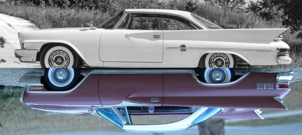

ChrisBcritter Posted November 7, 2016 Posted November 7, 2016 Food for thought: Camera angles may cause some variation, but this might help.
StevenGuthmiller Posted November 8, 2016 Posted November 8, 2016 Food for thought: Camera angles may cause some variation, but this might help. I was hoping someone with some know how would do something like this! Thanks Chris! Okay, so now I can see a slight difference in that cowl area of the front fender, albeit very small. What stands out more in my eye is the difference in the leading edge of the rear fender well. Almost looks to me like rather than stretching the entire front end, quite possibly the problem is in the rocker panel area. Extending the front edge forward a tad, & the rear back a little might be what it needs. Neither of which I would ever do by the way. The difference is so slight, especially in the front, that I could never justify the work involved to do it. I do want to reiterate though, that my part in this whole discussion was never to get on Bill Geary's case about anything. I just wanted to get the whole thing straight in my head as to what difference there was if any. Initially, I was not seeing anything to suggest that any modifications to the body were warranted. So cut away Bill! Your build will most likely be extremely unique. I don't see there being too many guys ready to take this one on. Steve
gtx6970 Posted November 8, 2016 Author Posted November 8, 2016 Food for thought: Camera angles may cause some variation, but this might help. this type photo ccomparison works only if the subject is the exact same distance away from the lens. Taking into scale differences obviously
