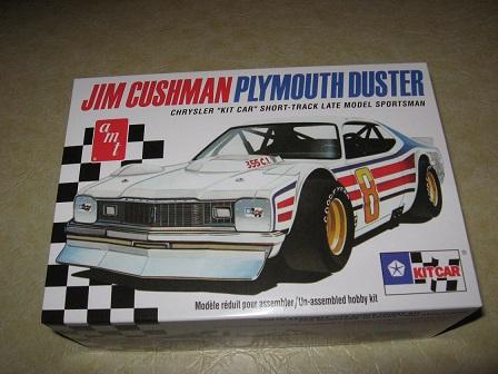

Vietnam Vet67 Posted November 25, 2016 Posted November 25, 2016 Haven't built a model in years, however, I picked up the following kit at a toy show last week plus a "Testors Amazing Air" airbrush paint set with various acrylic paints. SO, when I paint the body white (it is molded in white plastic) how do I prep the body? Do I have to put a primer before doing the white or can I just spray the white over the body after cleaning? What should I use to prep body before painting? The paint in the kit says it is acrylic..................are all Testors paints now acrylic or are there enamels out there I should use? Any other help would be appreciated. Thanx............... .
