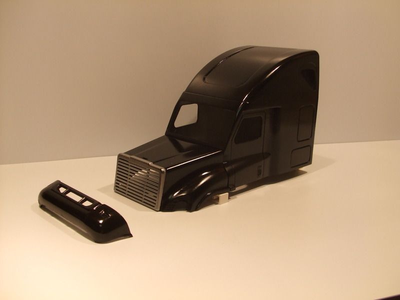

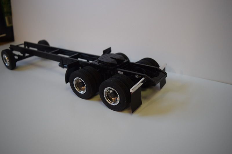

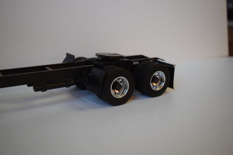

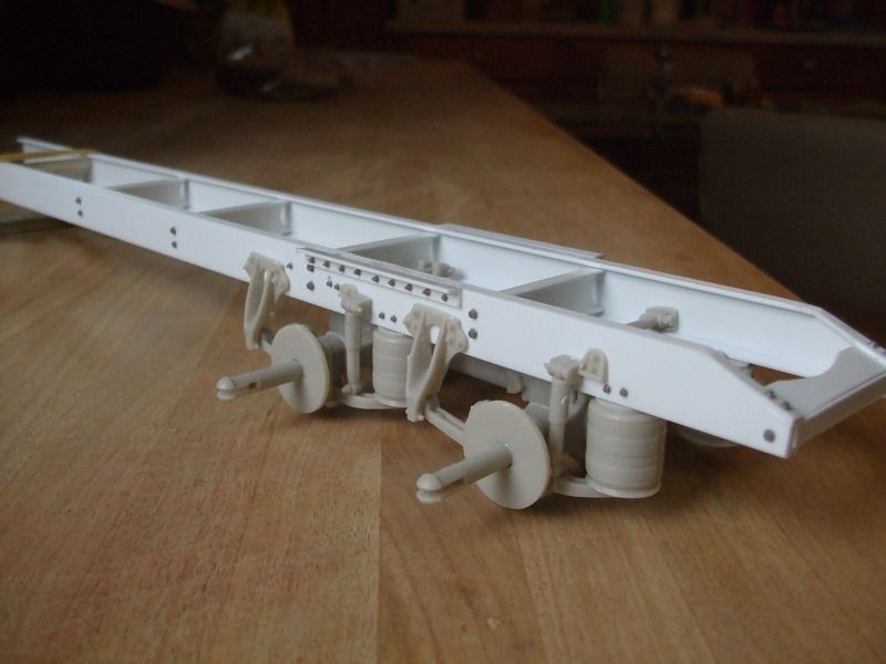

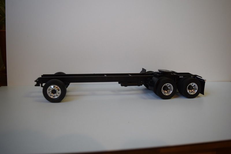

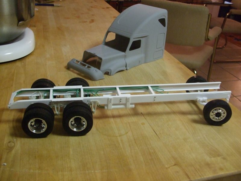

KJ790 Posted November 27, 2016 Posted November 27, 2016 I started building a cab and hood for a Freightliner Cascadia about 2 years ago. This weekend I finally decided to do something with it. I started with scratch-built frame rails using 7/16" I-beam with the flanges shaved off of one side. I used the suspension from a Moebius Lonestar kit and added nuts and bolts from Meng. I used Moebius rims, but sprayed them with Spaz Styx to dull down the kit chrome shine a little bit. I drilled out the centers and added some resin drive hubs. Next I painted the chassis black and added some scratch-built quarter fenders and rear mudflaps.

KJ790 Posted November 28, 2016 Author Posted November 28, 2016 Nice work KJ . Who made the Cascadia kit ?Thanks Dave! Unfortunately nobody has made a Cascadia kit, so I made the cab and hood myself. I had plans of building this 2 years ago when I made the cab, but it got put on the back-burning at the time.

vincen47 Posted December 4, 2016 Posted December 4, 2016 Could you tell us more about what went into making the cab from scratch? Did you use scale drawings from somewhere?

KJ790 Posted December 4, 2016 Author Posted December 4, 2016 Could you tell us more about what went into making the cab from scratch? Did you use scale drawings from somewhere?I drew the cab in 3D CAD and then had it 3D printed. This was by far the hardest shaped cab and hood I have ever drawn. It took me around 40 hours of drawing to get it to look right, and it is still not exactly right. I had a few known dimensions (length, width, height, etc) and I scaled everything else from pictures. Some of the complex curves on the cab are still a little off, but I am hoping that the rest of the build will mask some of the flaws.

KJ790 Posted December 10, 2016 Author Posted December 10, 2016 I got a black base sprayed on the cab and hood. White will be painted over it in a couple days once this has cured.

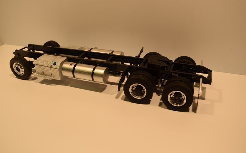

KJ790 Posted December 13, 2016 Author Posted December 13, 2016 I scratch built some side steps and DEF tank, as well as some fuel tanks. I used PVC pipe for the fuel tanks.
