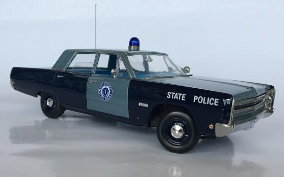

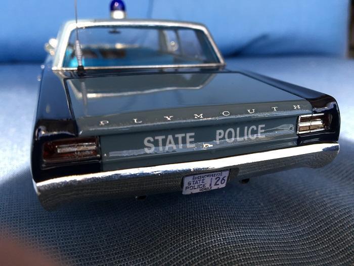

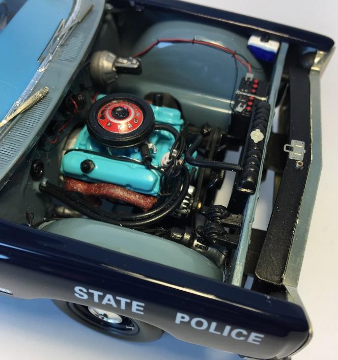

Rdkingjay Posted December 4, 2016 Posted December 4, 2016 Finally complete after 11 months. Once again, thank you to forum member Tom Sheehy. Tom is a kit bash master for these old kits and he gave me some good advice at the on-set of this project. I picked this kit up, un-assembled but open, along with my recent '60 Plymouth wagon MSP build, about 3 years ago. Like the '60 wagon, I opted to do a chassis swap to get a more detailed look, over the curbside chassis provided in the kit. My '60 wagon used the Lindburg 64 A330 chassis and was an easy drop in. Such was not the case for the Fury. I used the chassis, suspension and engine from the '68 Revell Special Edition Charger. Right from the word go, there were issues. The Fury's interior tub had to be cut behind the back seat to allow it to sit on the Chargers chassis properly. The top of the Chargers chassis floor then had to be ground down as well, for proper fitment of the Fury interior. The Chargers chassis then had to be widened and lengthened behind the rear wheels to meet the inside of the Fury's rear quarters. Then, I had to cut the round front fender wells from the original Fury chassis and adapt them to the Charger chassis to achieve the proper look of the engine compt. Fury's did not have the typical boxy engine compartments that most Mopars of this era had. I opted to use the Chargers firewall, due to the amount of detail it provided and because it was a relatively good fit in the Fury body. Other than the above mentioned items, not much else was modified. Detail was then my goal. The engine is wired, has a fuel line and filter (hard to see), cooling and heating hoses, battery cables and clamps, washer reservoir hose, wired wiper motor and wired siren and horns. I also cut mud flaps for the inner fender wells from very thin cardboard. The header panel for the hood spring and striker is scratch-built and the grille has been hollowed out and filled with very thin metal rods to simulate the grill. The interior uses the kits supplied radio gear, but the mike cord is coiled wire. The seat material is actually 3M Micropore medical tape that when painted, gave the seats a material, rather than vinyl look. I left the front door windows out and "rolled" down the rears. The chassis has a very unfinished look and it drives me crazy. It was sprayed in gray primer. then fogged along the edges with the french blue, as if the car was built as a french blue car. Then the Electric blue was sprayed in with "not the best" tape lines under the rockers, as it might have been, when the Electric blue was applied later at the factory. The rear of the chassis and front sub-frame where then fogged with semi gloss and flat black to simulate the black chassis finish and under coating. The lack of clean tape lines makes me a little crazy. The front lower control arms are done in a color I mixed up, to look like the cosmolene rust inhibitor finish. The finish on the car is standard MSP livery. Authentic French and Electric blue. Three coats of clear then polished out. Fender numbers did not appear until the early 70's. The hood and trunk "Plymouth" scripts were BMF'd prior to painting then, following each coat of paint, I removed the paint from the letters with a Tamiya q-tip, then cleared the car. The result is nice chrome letters. PE'd parts include, hood ornament, valve stems, wheel weights, door locks, hood striker, wipers, radiator cap, battery clamps, battery hold down and tray and window cranks. Scratch built items are the spotlight arm, antenna mast and turned down exhaust tips. Please feel free to ask any questions you may have. I share my tips and tricks. Thanks for looking and take care.
'70 Grande Posted December 4, 2016 Posted December 4, 2016 Your hard work really paid off! This is the most outstanding build of this vintage kit that I have ever seen! Very impressive!
charger74 Posted December 4, 2016 Posted December 4, 2016 That is one really cool police car !! Looks awesome
D. Battista Posted December 4, 2016 Posted December 4, 2016 Outstanding build...! One of the nicest cleanest well detailed police cars, or any car for that matter..... that I have seen..!scripts look awesome ...I have used that method and know that it's not all that easy to do....Awesome over all..!!!
Earl Marischal Posted December 4, 2016 Posted December 4, 2016 Very nice work and not something you want to see in the rear view mirror of your '67 427 Corvette when you have the hammer down! steve
bbowser Posted December 4, 2016 Posted December 4, 2016 Beautiful work. I love the cosmoline a-arms, underhood detail is outstanding.
Dodge Driver Posted December 4, 2016 Posted December 4, 2016 That is truly outstanding work! I have a real appreciation for Mopar police cars. My family owned both a '72 Fury and a '75 Gran Fury. Ex state police cars.
donb Posted December 4, 2016 Posted December 4, 2016 Outstanding work. Engine detail is superb. Hood latch mechanism is a really nice touch. Impressive.
Foxer Posted December 5, 2016 Posted December 5, 2016 (edited) Just those colors put the fear in me and "only 10 over" on the speedo".That is a beautiful build! Edited December 5, 2016 by Foxer
PARTSMARTY Posted December 5, 2016 Posted December 5, 2016 An absolutely amazing over the top build-perfect in every way!!!
NYLIBUD Posted December 5, 2016 Posted December 5, 2016 Very nice job.I really like the way you made the rust scattered on the exhaust pipes.And the interior looks great.
slusher Posted December 6, 2016 Posted December 6, 2016 Great build and wonderfully done. I really like all the detail..
disabled modeler Posted December 6, 2016 Posted December 6, 2016 AWESOME BUILD..! Love everything about it...and its a 4 door whats not to like...LOL

mangodart Posted January 7, 2017 Posted January 7, 2017 Your hard work really paid off! This is the most outstanding build of this vintage kit that I have ever seen! Very impressive! I agree !!! Very nice, engine bay details are gorgeous !!!
