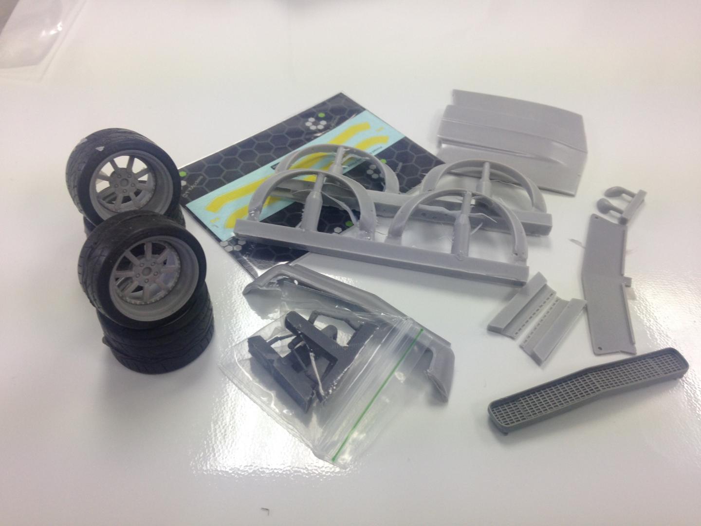

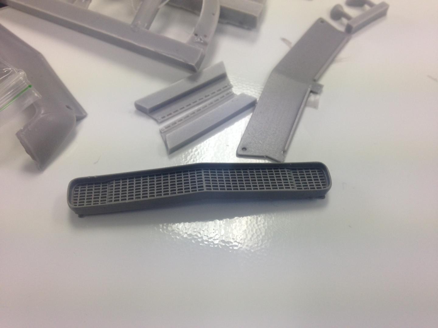

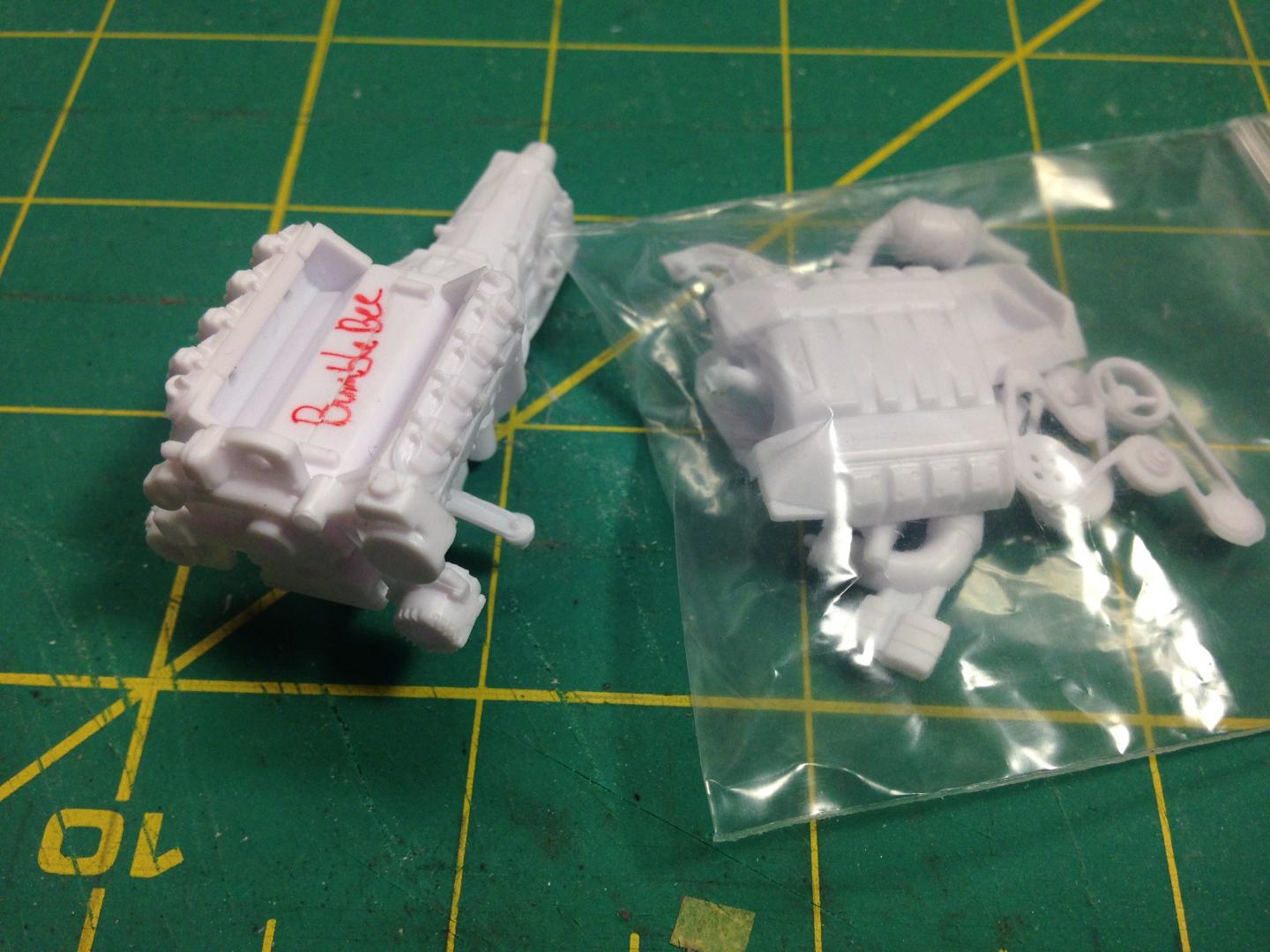

Almost 2 yrs ago I quickly snapped up one of C1 Models resin transkits. & finally managed to pick up the plastic kit that it goes with. Little dispointed with the fit, some of the parts seem a little small, but im sure i'll manage to make it work.

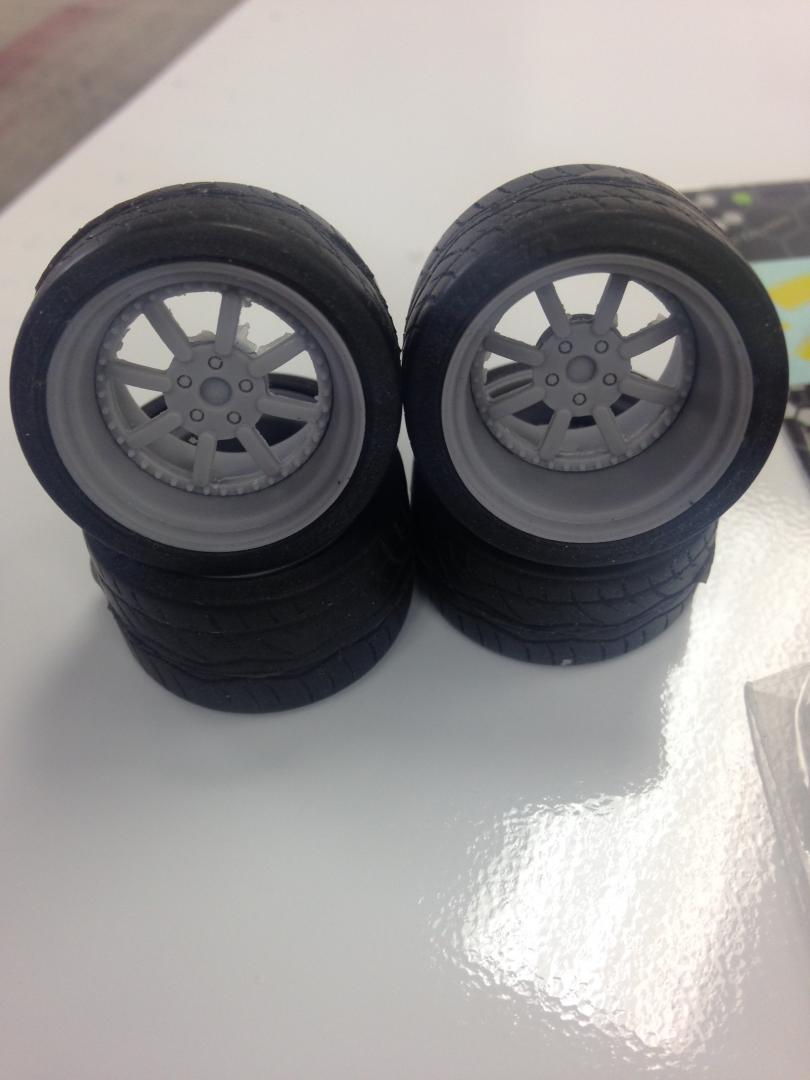

Contents of the Transkit

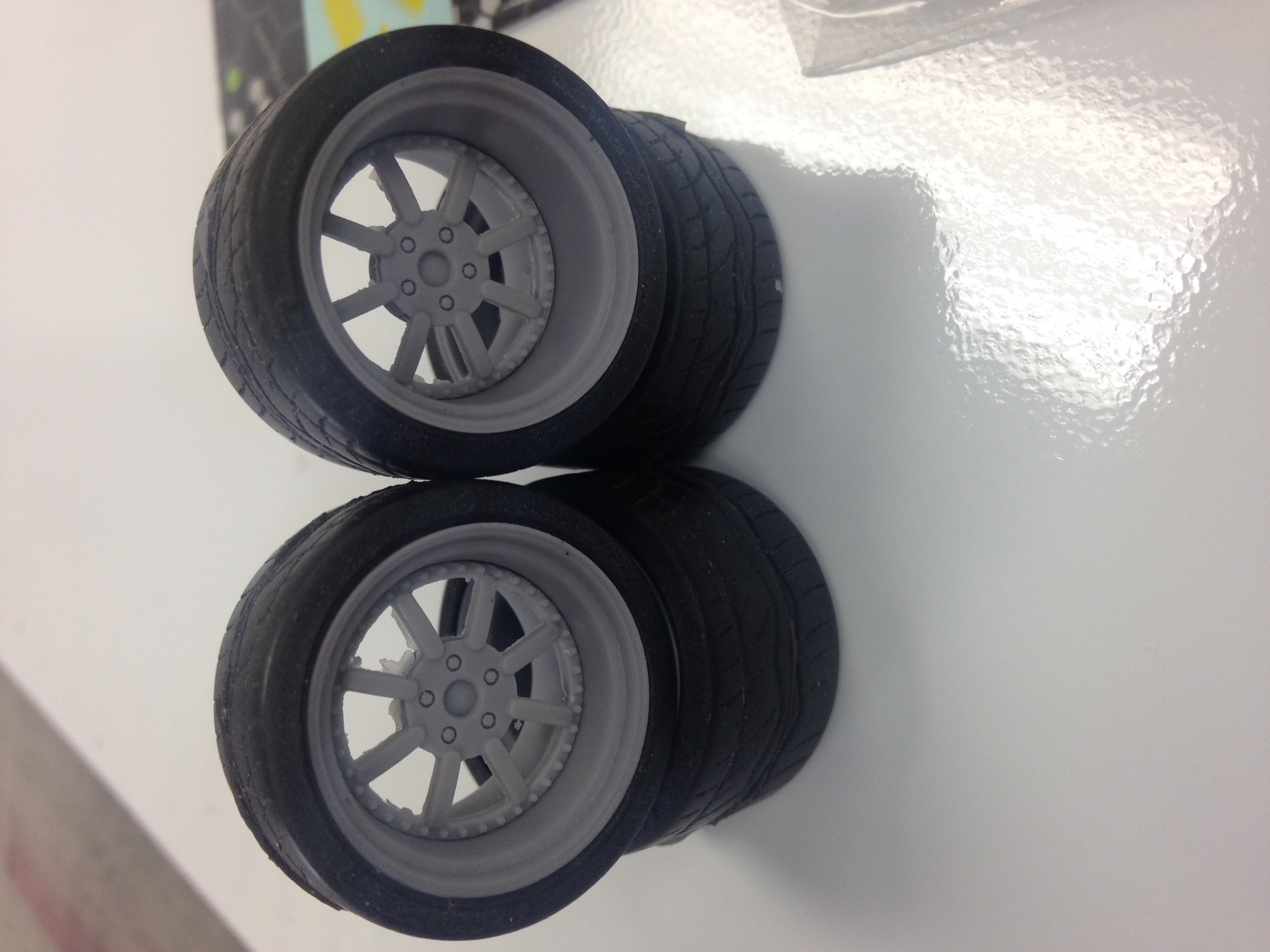

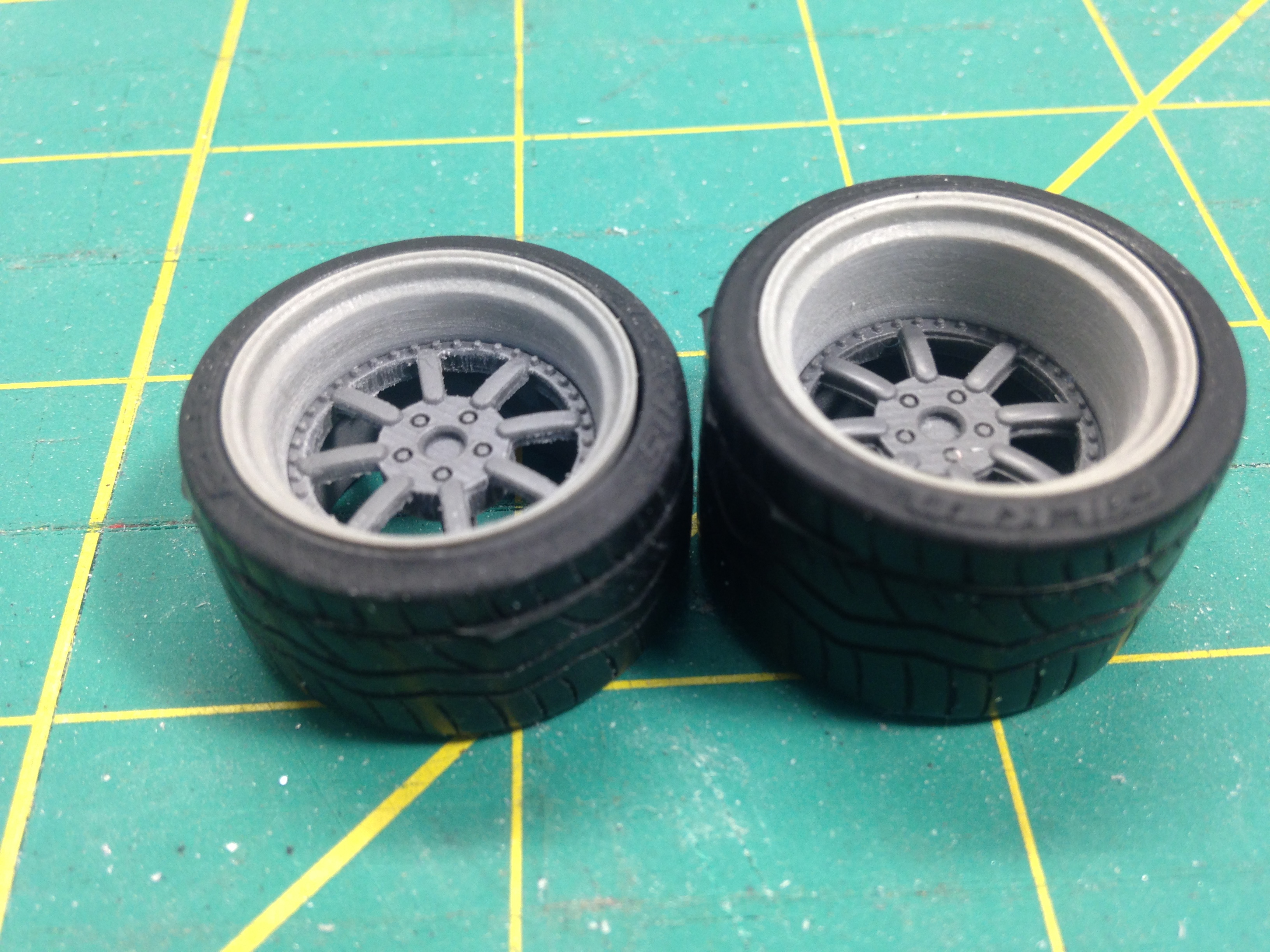

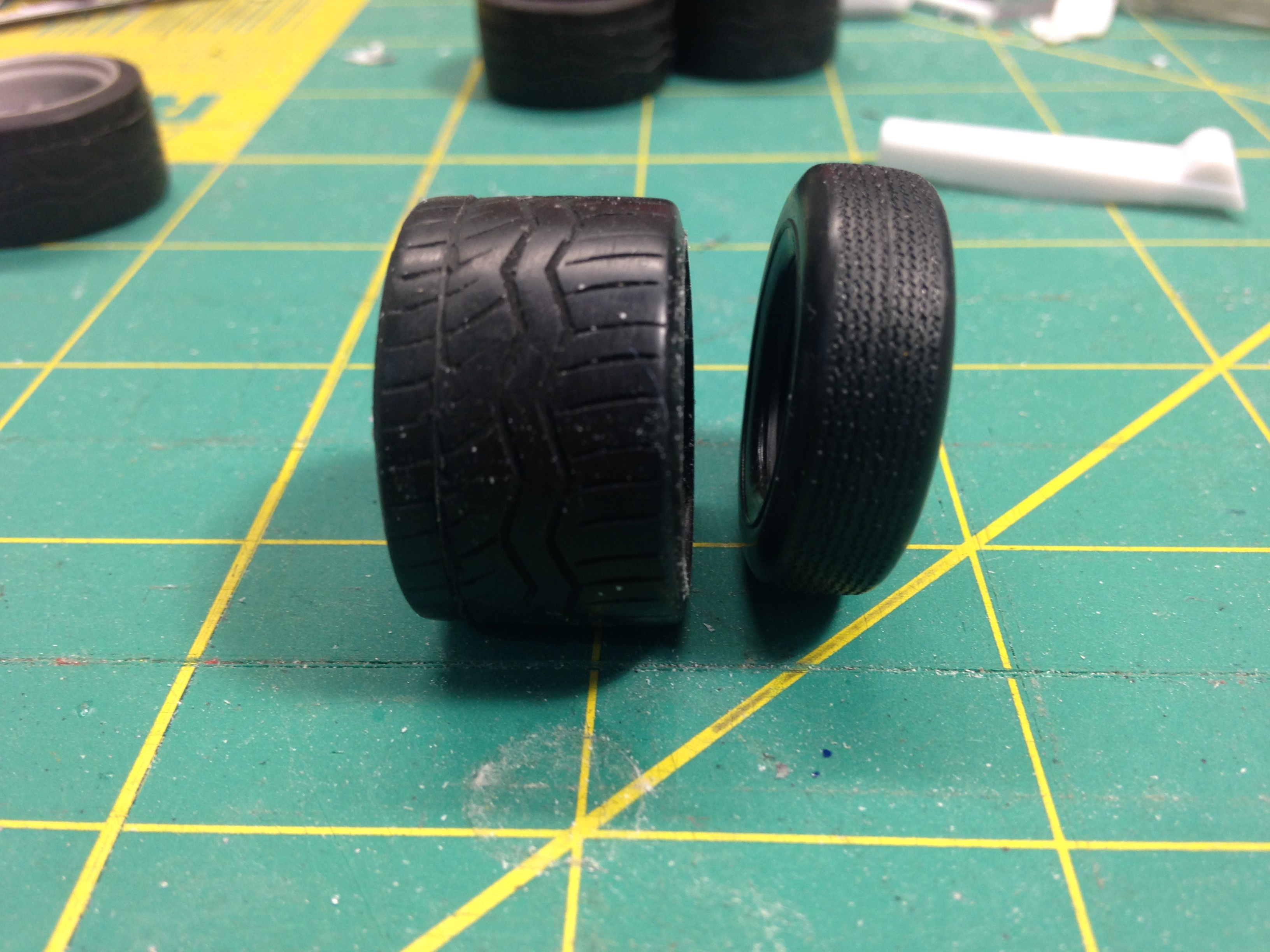

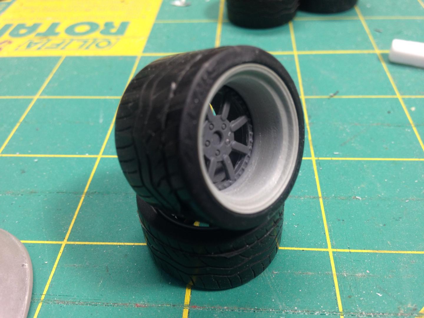

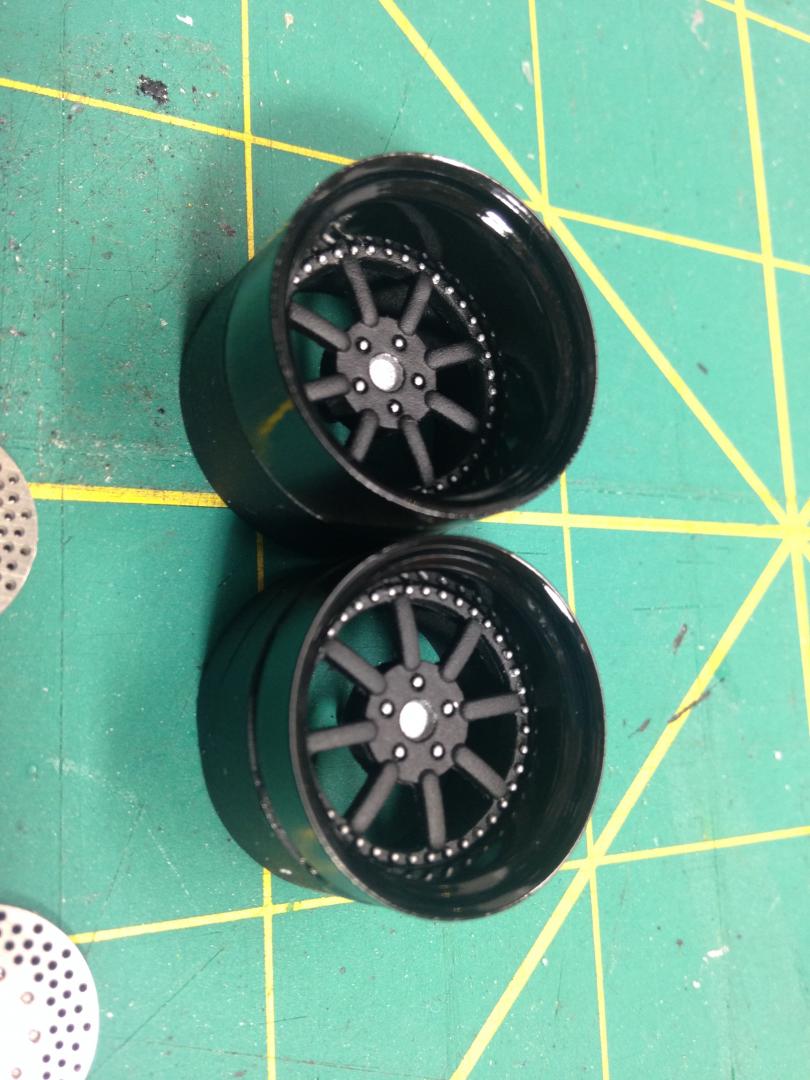

I love these wheels! There so awesome & massive!!! 3x larger than the stock wheels.

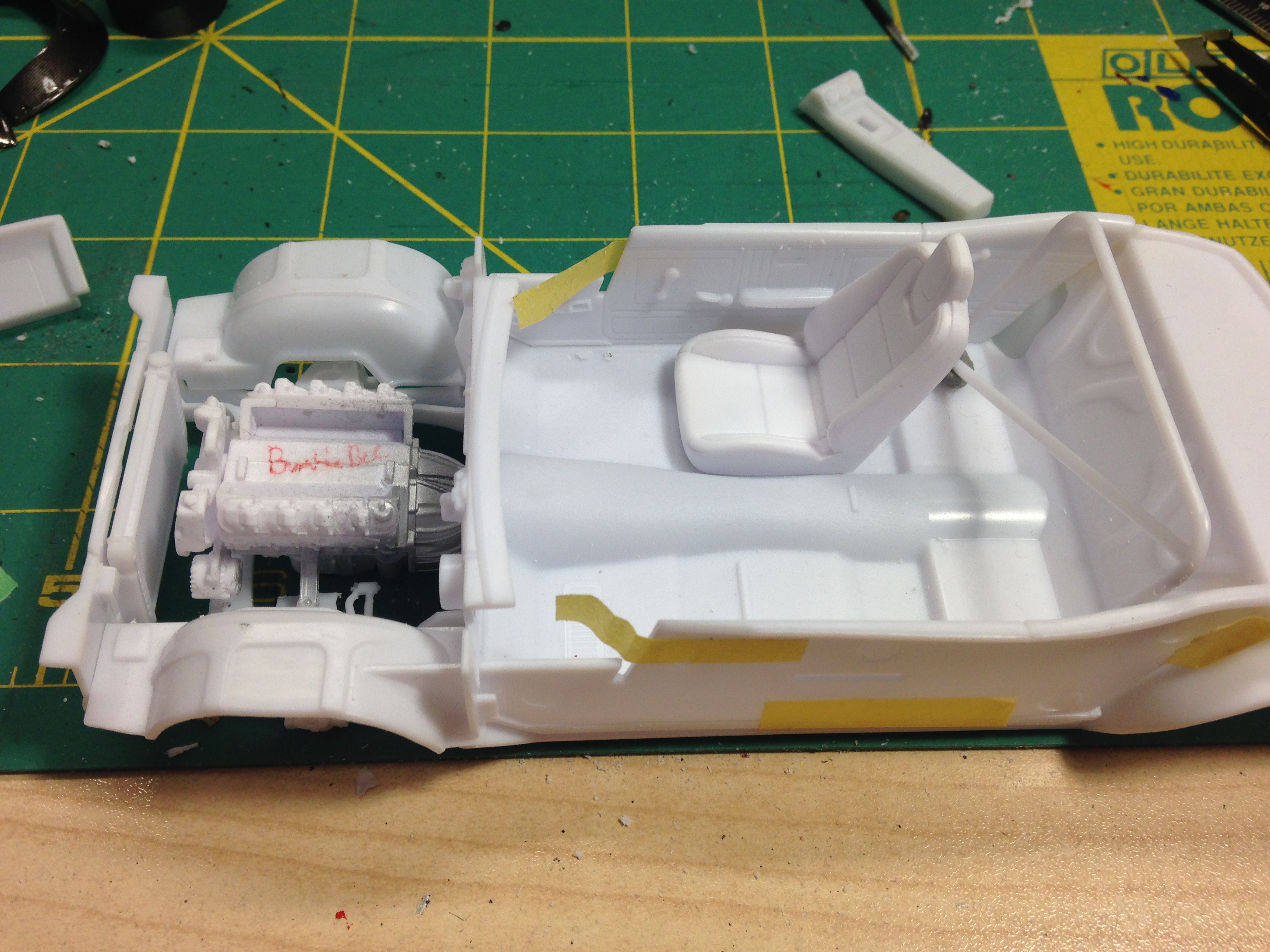

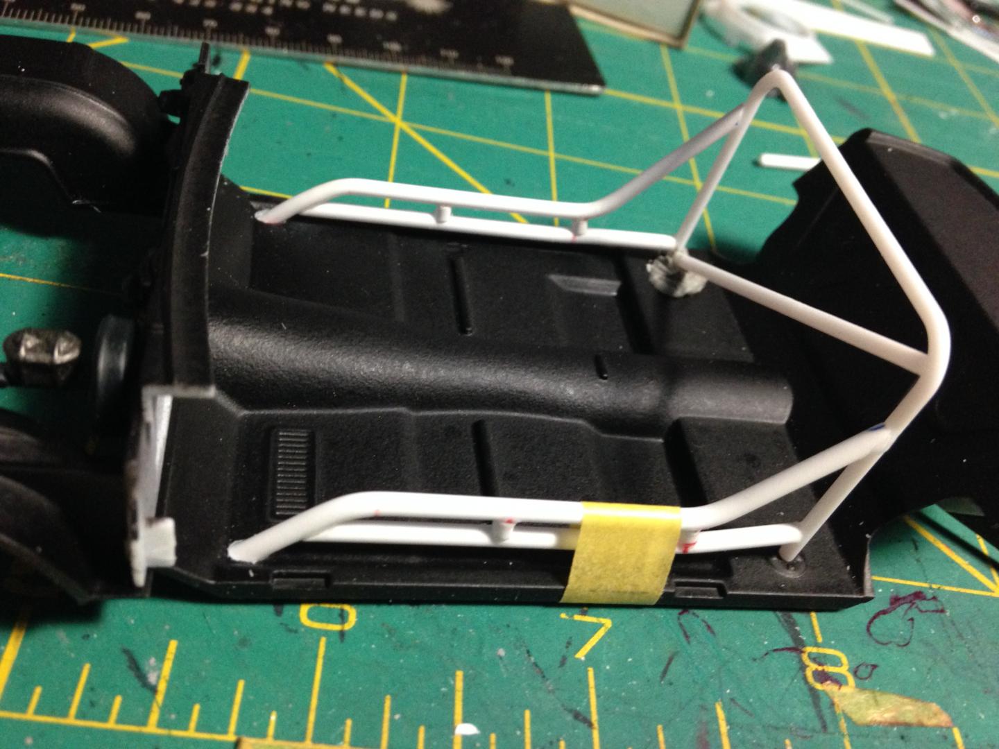

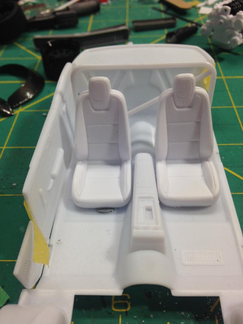

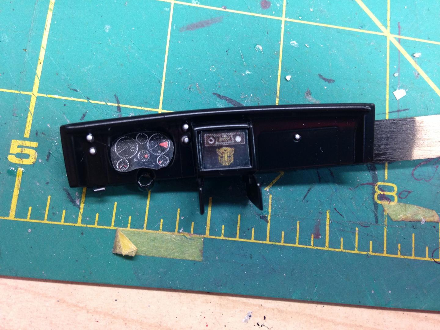

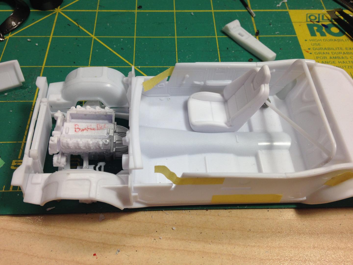

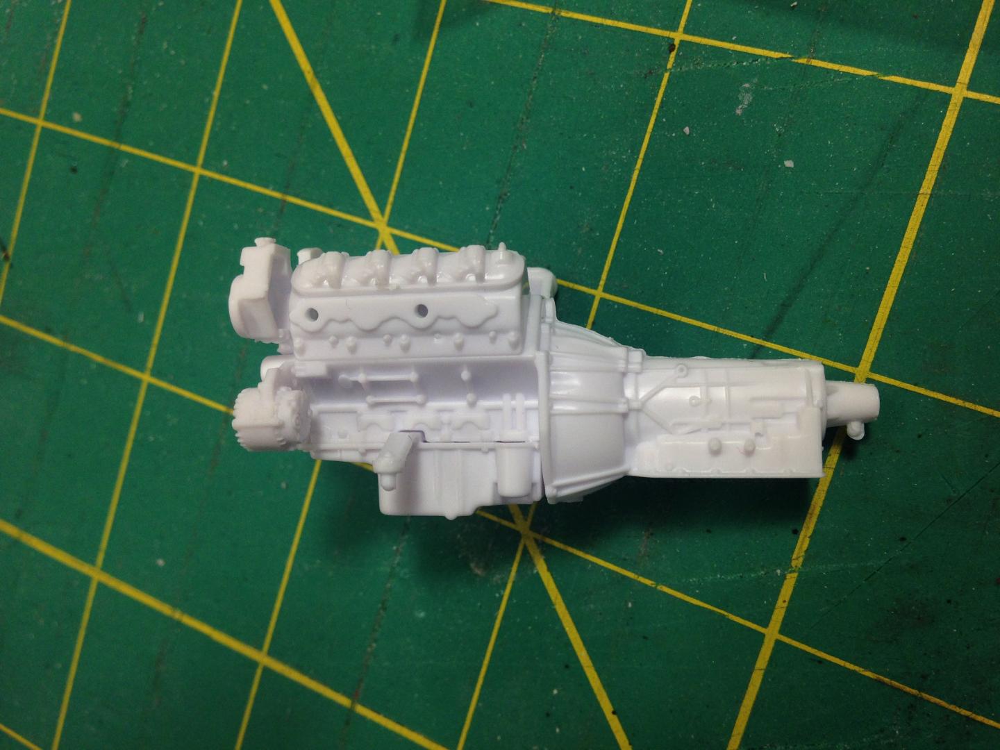

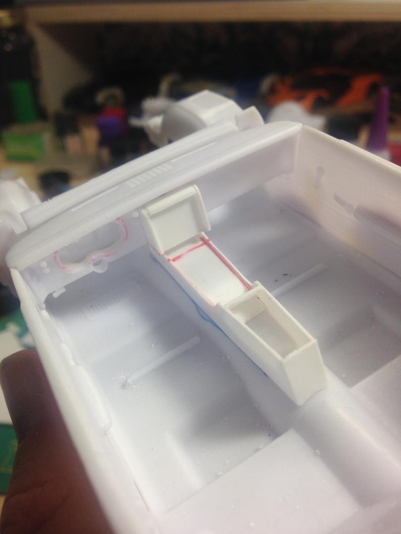

Bumblebee is a restomod & had a modern engine & a more modern interior which I'll try to replicate. Ive got some spares from my Camaro SS-x Build (still slowly being worked on), mostly the engine & the seats. Ive got to scratchbuilt the centre consol & modify the dash. & build a Tigercage too.

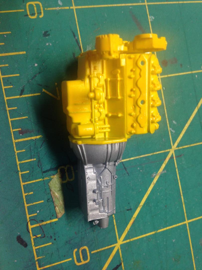

engine is from Revell 08 Camaro SS, not sure if this is 100% accurate but loos good enough to me.

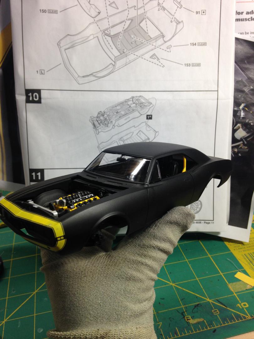

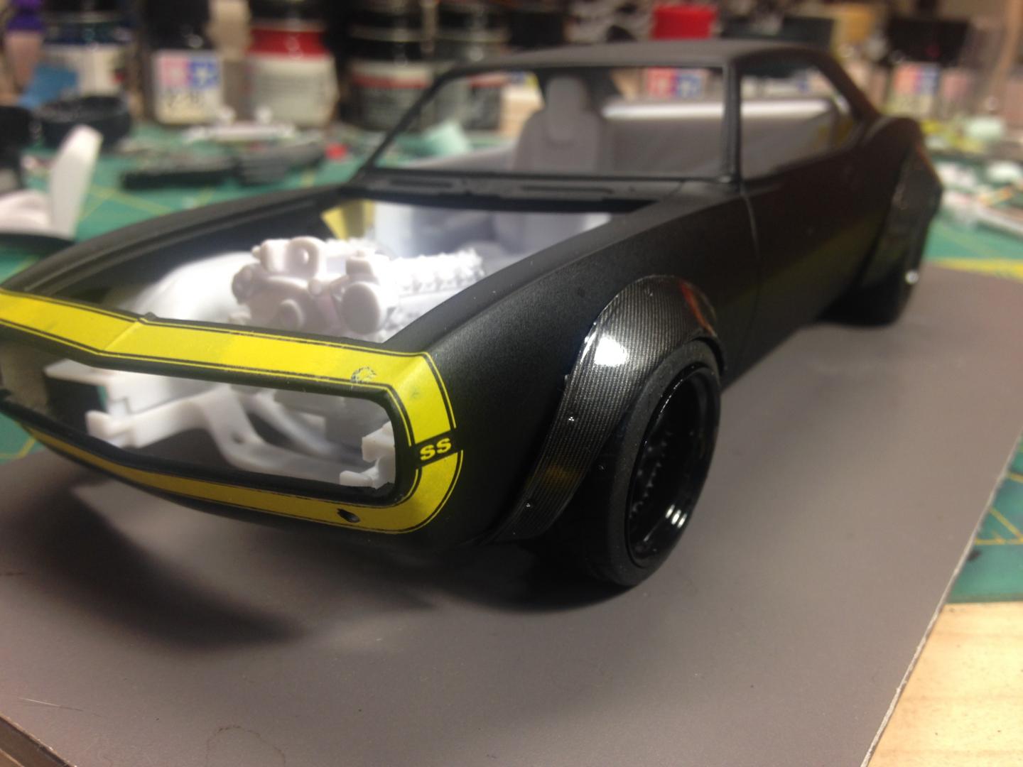

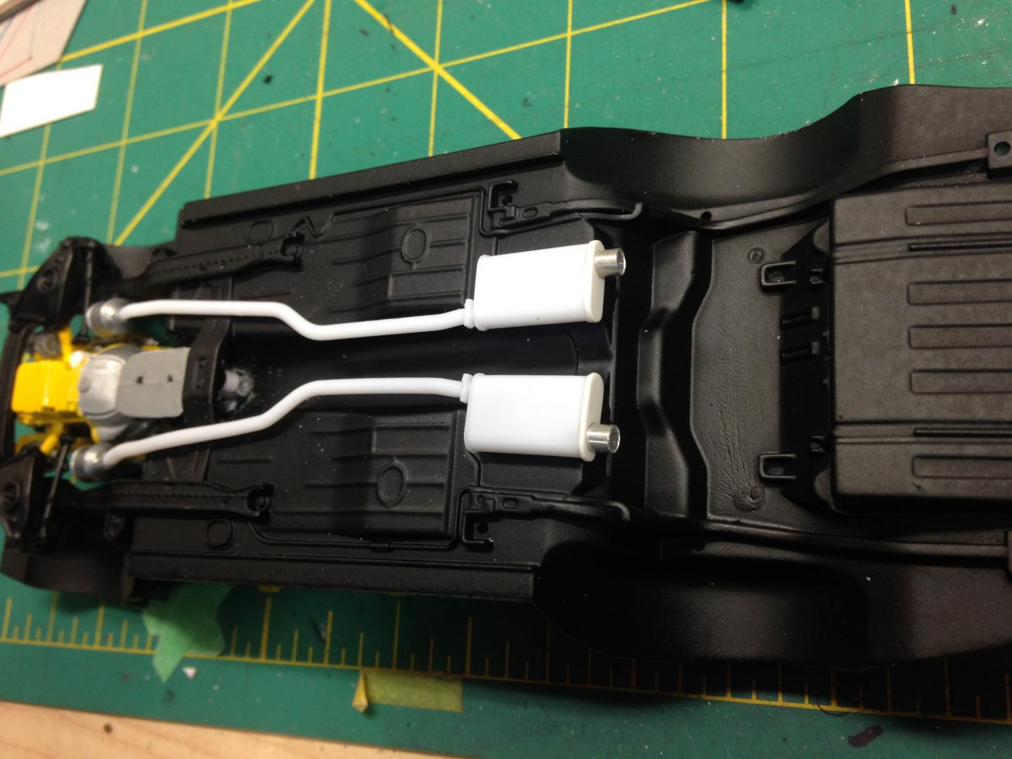

 & this is where Im at, aside from widening the bonnet ive attached the lower valance. needed to be cut into 3 pieces to fit properly. Still plently of work to do.

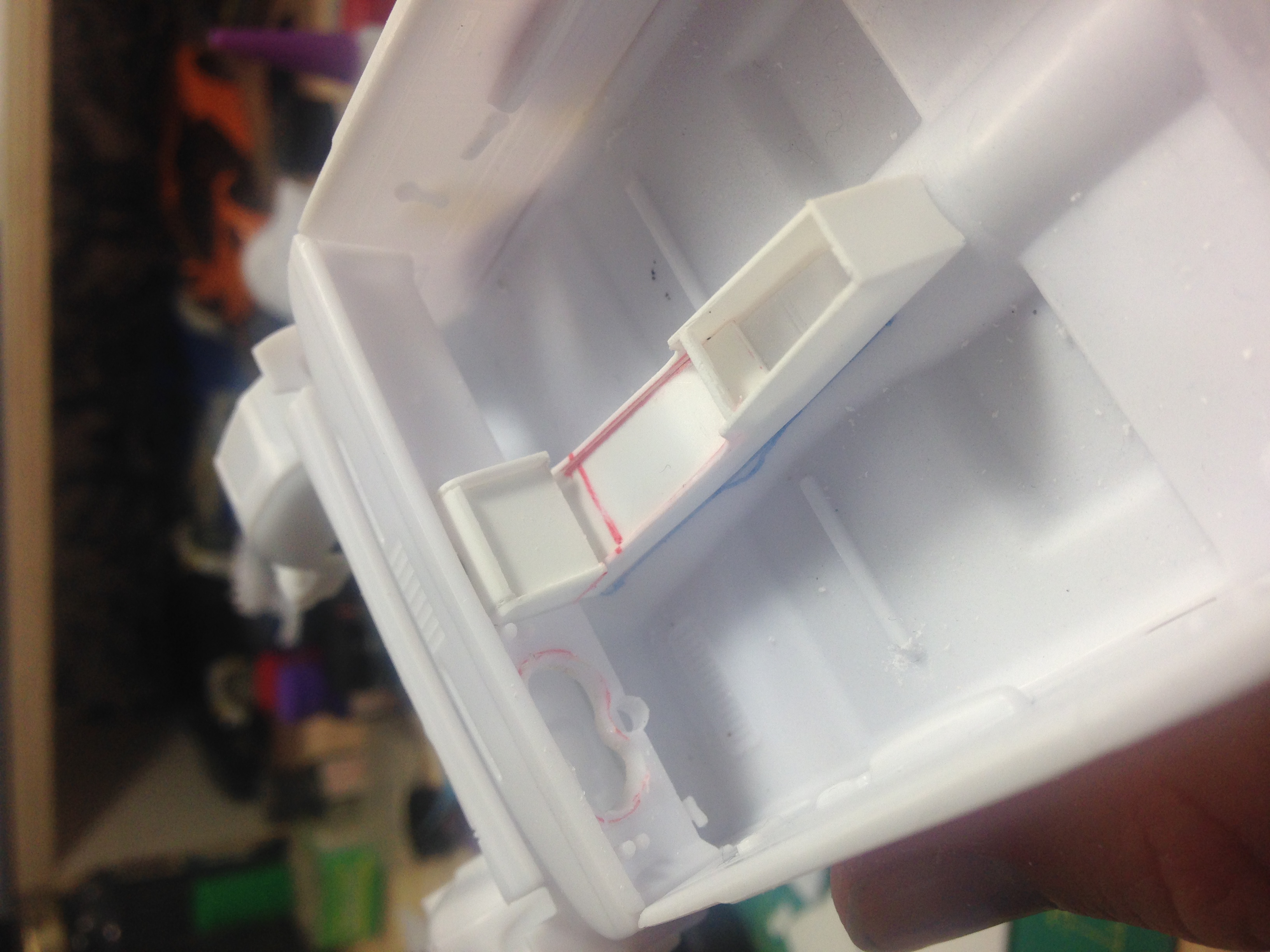

I do have a question for you guys tho, Im trying to replicate the side undercut (where the chrome trim goes) its been removed on the 1:1, but Revell has molded it inplace. ANy ideas whats best to do? I had thought of just sanding it off & not worrying about the undercut line, but thought I might give it a go.

Ashley, looking at the real car versus the kit, to me it looks as if the real car has an overhang in the trim area and if you sand off the kit chrome it will be flat and no reveal line there. If it were me building the car I'd take a carefully fill the upper part of the trim line to fill it in with the door to the trim. Then sand it down til you hit the trim, thus leaving a bit of an overhang to give you the reveal line as on the real car... Hope that makes sense??!!
Cheers! Great Idea, I might give that a go!

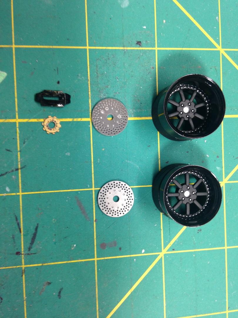

You might have already thought of this, but incase you haven't -http://www.dirtmodeler.com/store/index.php?route=product/product&path=153&product_id=436
No I hadnt seen those before, theyre pretty awesome! Cheers!!!! I think id only really be able to use the smallest ones tho.
I was looking at getting the A+ Club chrome stickers https://www.mediamixhobby.com.sg/shop/acms017.html but might get these instead
I've ordered ALOT of parts from them and their quality is Awesome!!! I saw your build theme with the Transformer on the engine and thought this photo etch would really look cool. I'm looking forward to following this build.

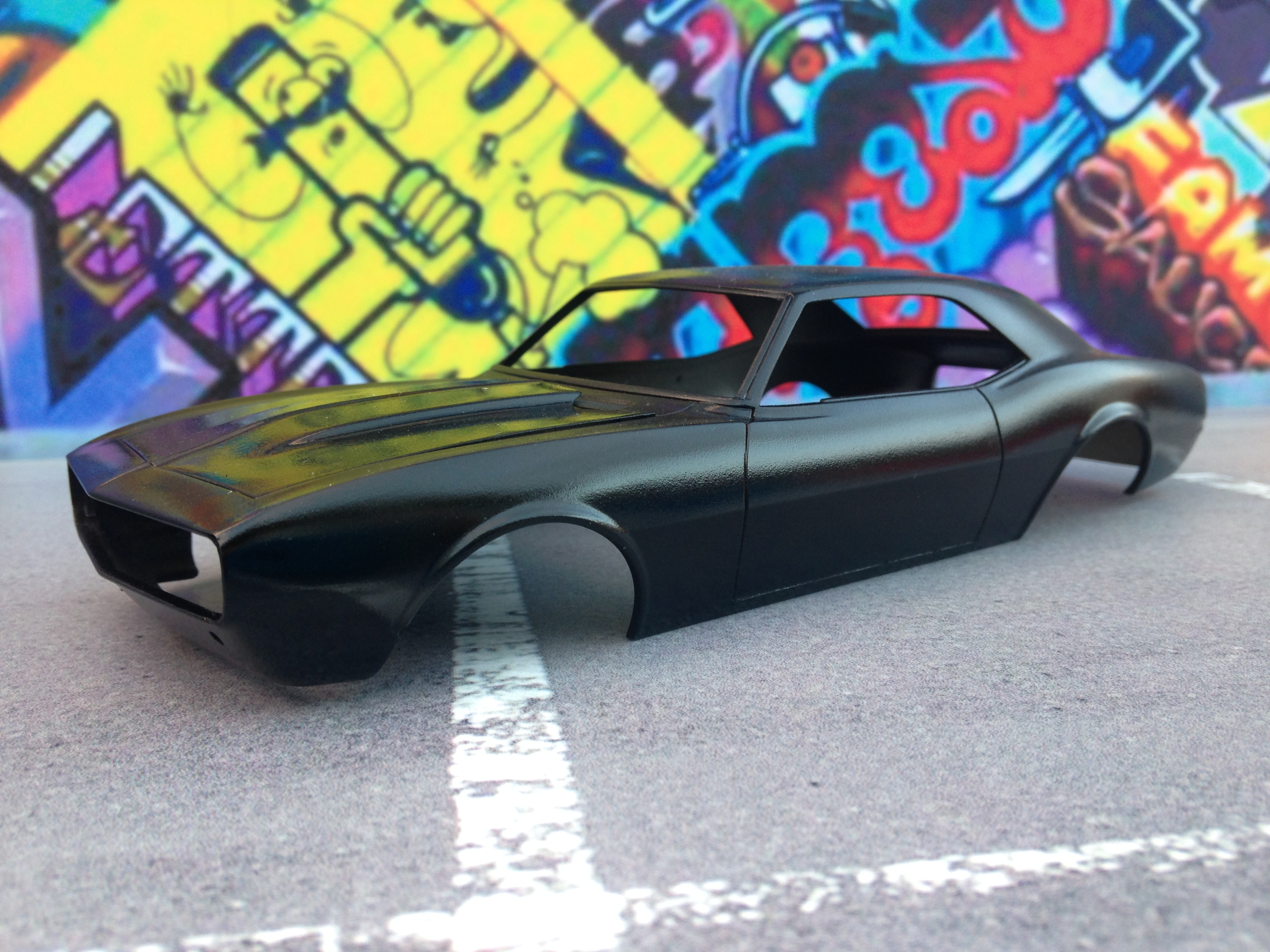

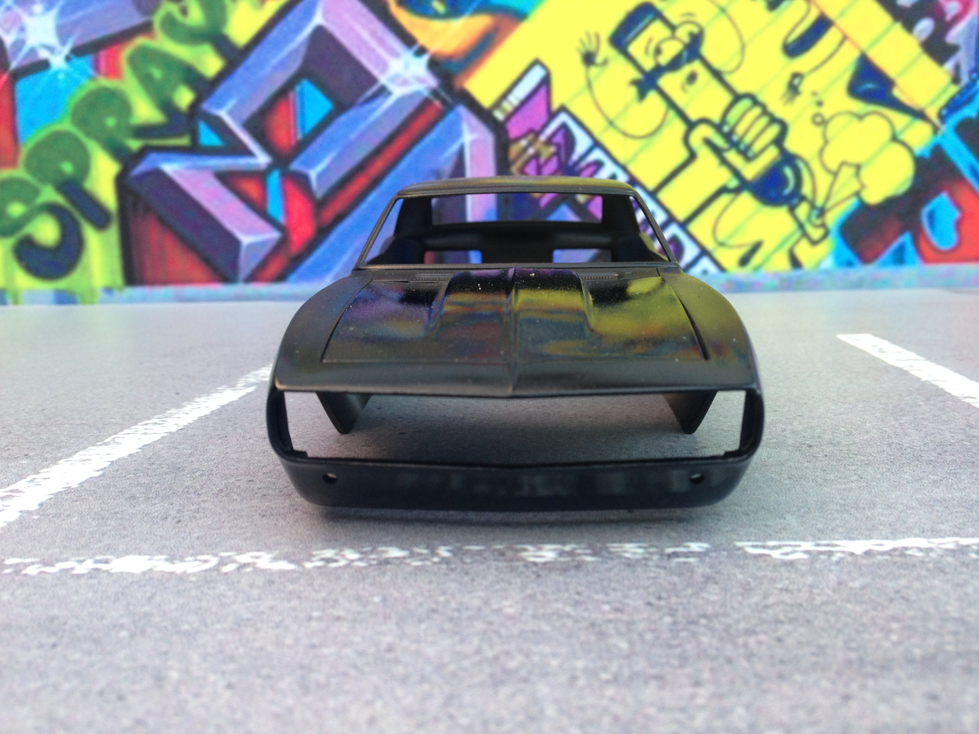

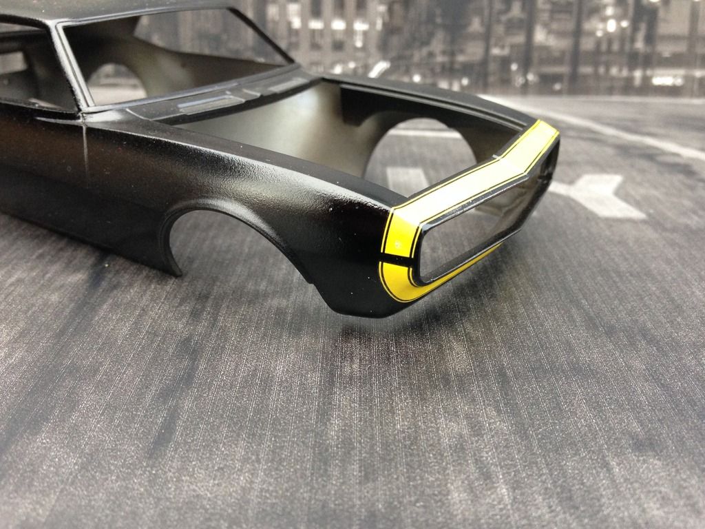

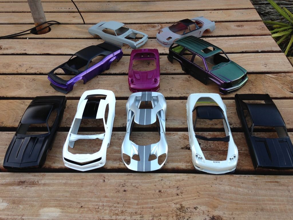

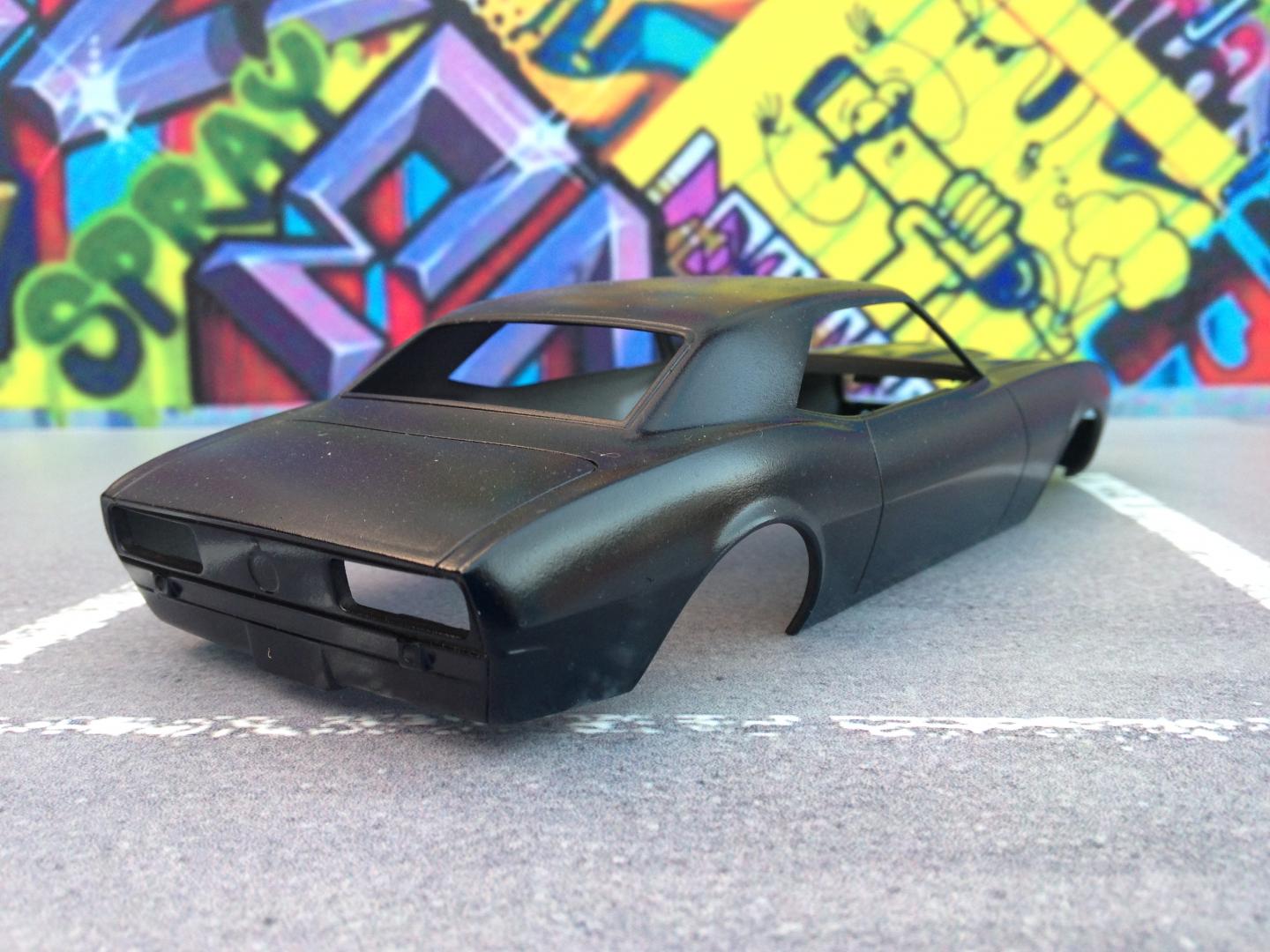

Been awhile since i last updated this thread, ive been on my summer holiday, had 3 weeks off work with plenty of jobs to do around the house & plently of time (& perfect weather) for model painting! I planned to get 7 kits all painted up ready to be assembled & ended up with 8 kits painted & 2 left to paint the bodys on...

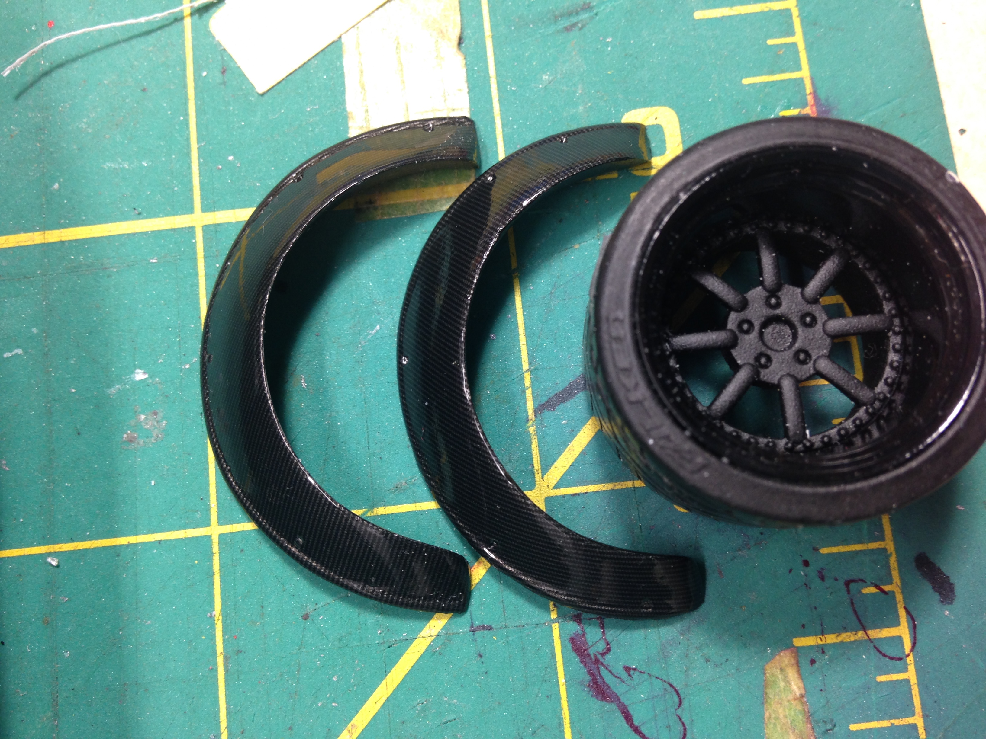

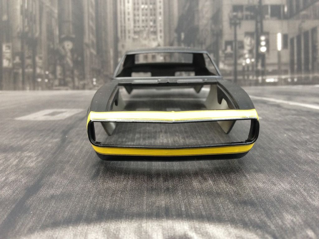

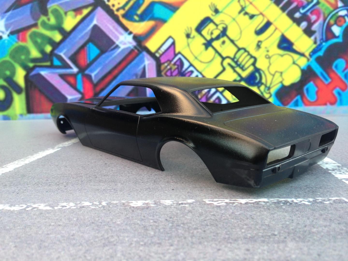

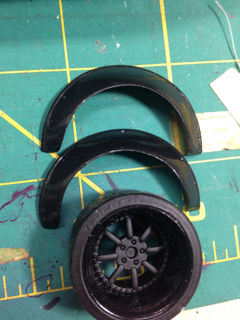

Bumblebee being one of them! He certainly took quite a bit of work to get painted. I tried to keep the undercut on the sides but my plan didnt work & I lost it. oh well, it still looks good without it. Had to fill in all the seam & panel lines too. Bumblebee got a healthy coat of gloss black ready for the decals & will be clearcoated matte once theyre on. I left the flares off the body for now as they are glossy carbon fibre & dont want to risk masking the clearcoated carbon flares.
Everything for the exterior of the car has been painted, & just needs final clearcoats (Gloss & Matte)

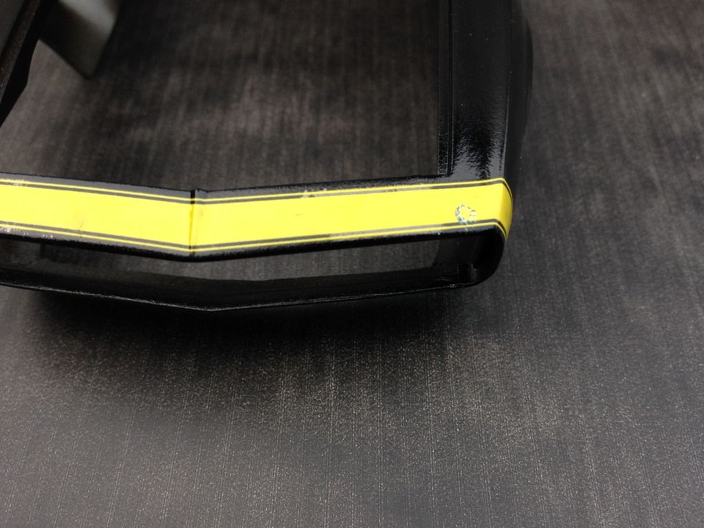

Did some decaling last night, still lots to do to trim.
Made a bit of a boo boo tho.... never touch the what looks like a water droplet after youve applied Decal Solvent....

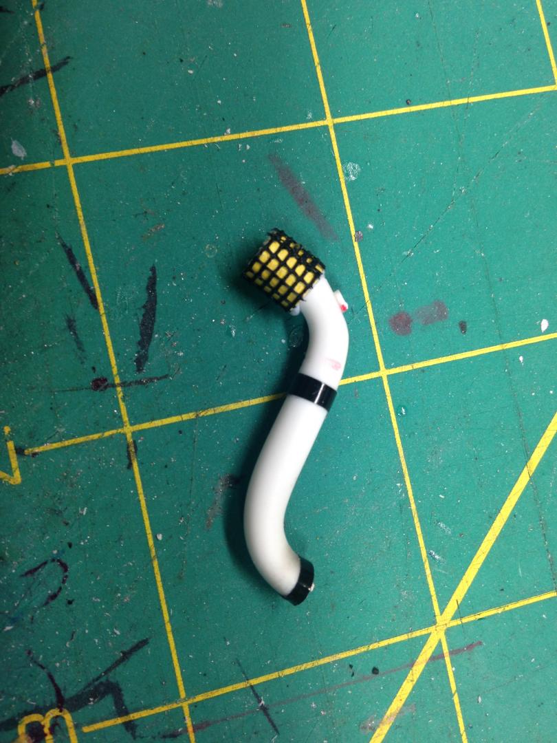

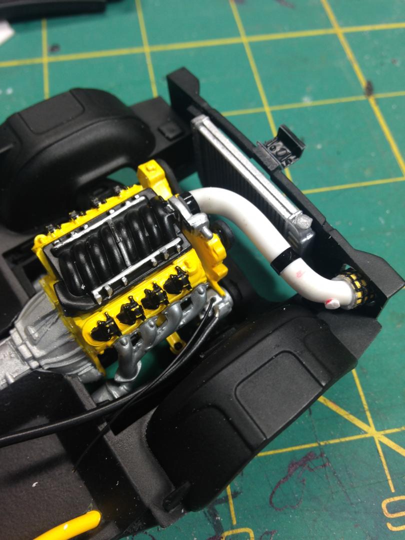

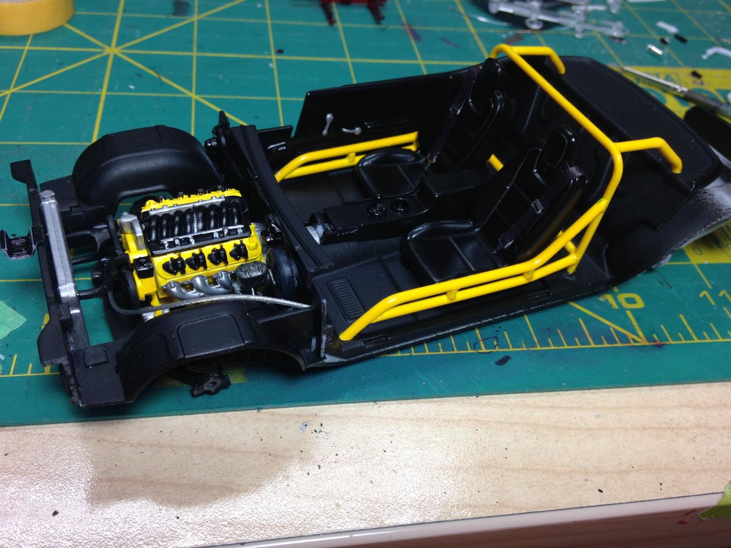

Firstly cheers to Photobucket for ruining everything Ive ever posted.
Rather than try to update each post heres a bulk one with where Im up to.

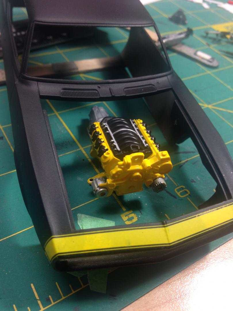

Body painted, decaled & clearcoated. Engine is coming along too.

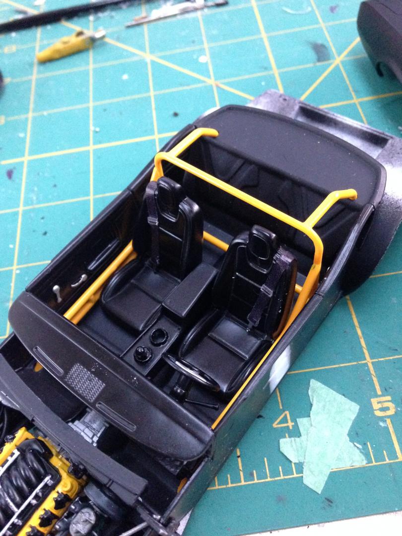

Interior is almost done with just the rollcage & dash to finish. I'm trying to get it finished for a local Model show 1st October.

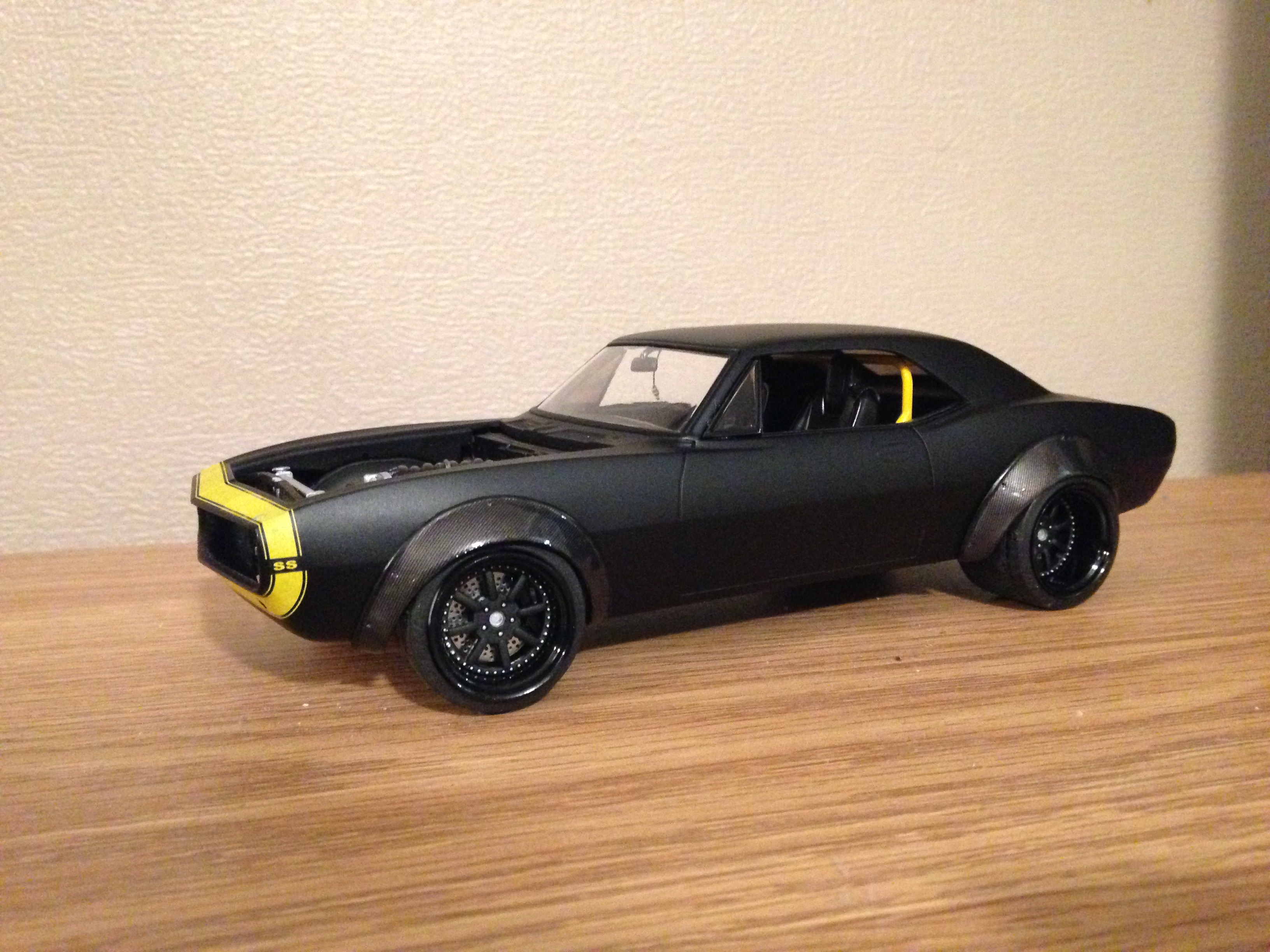

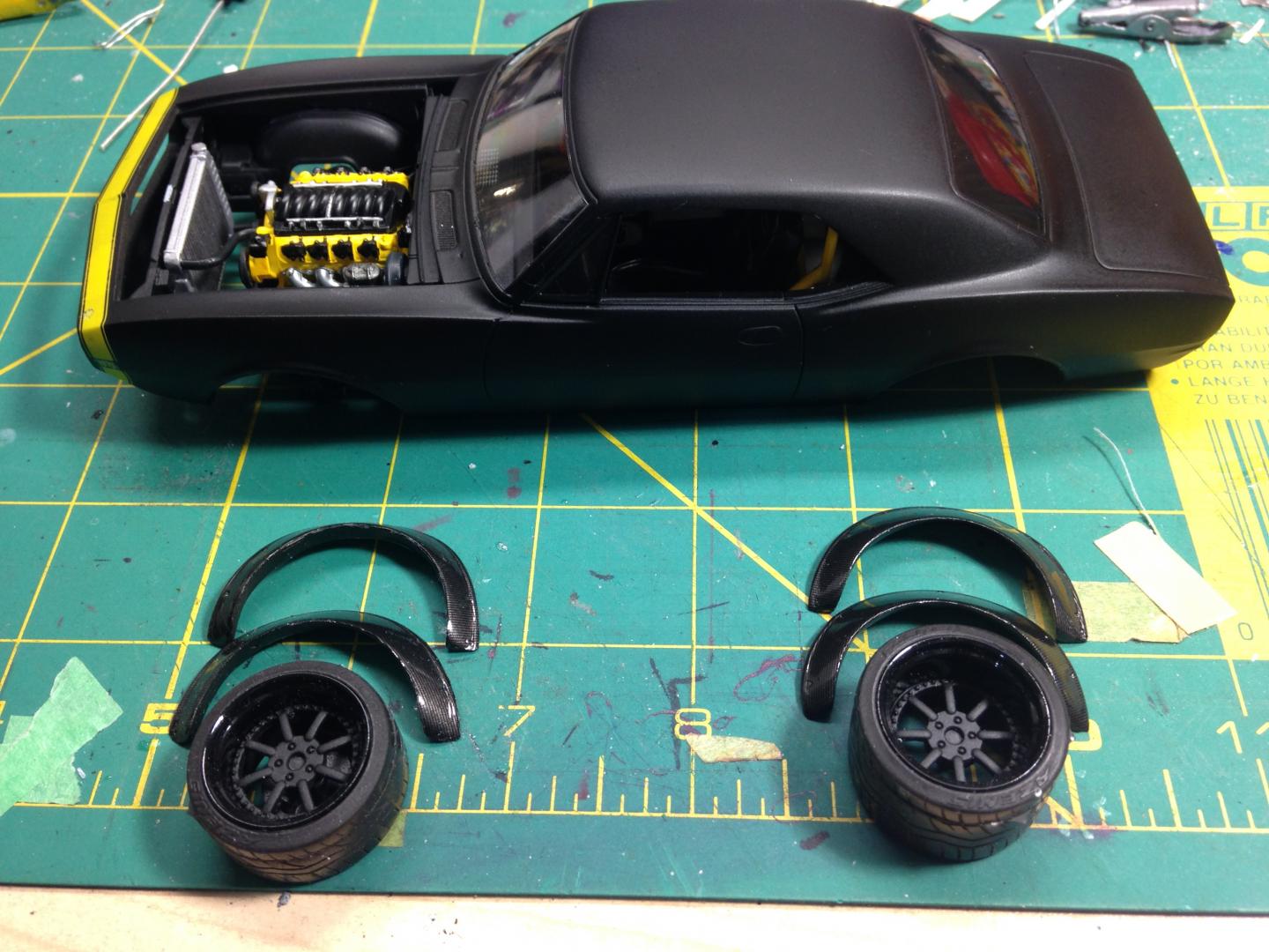

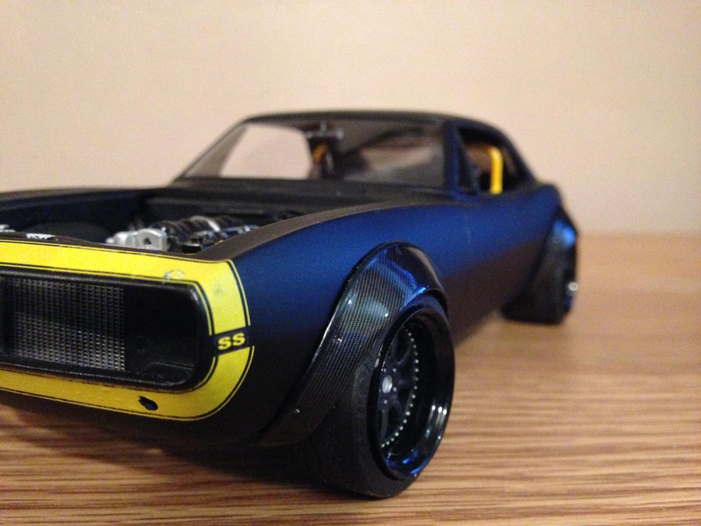

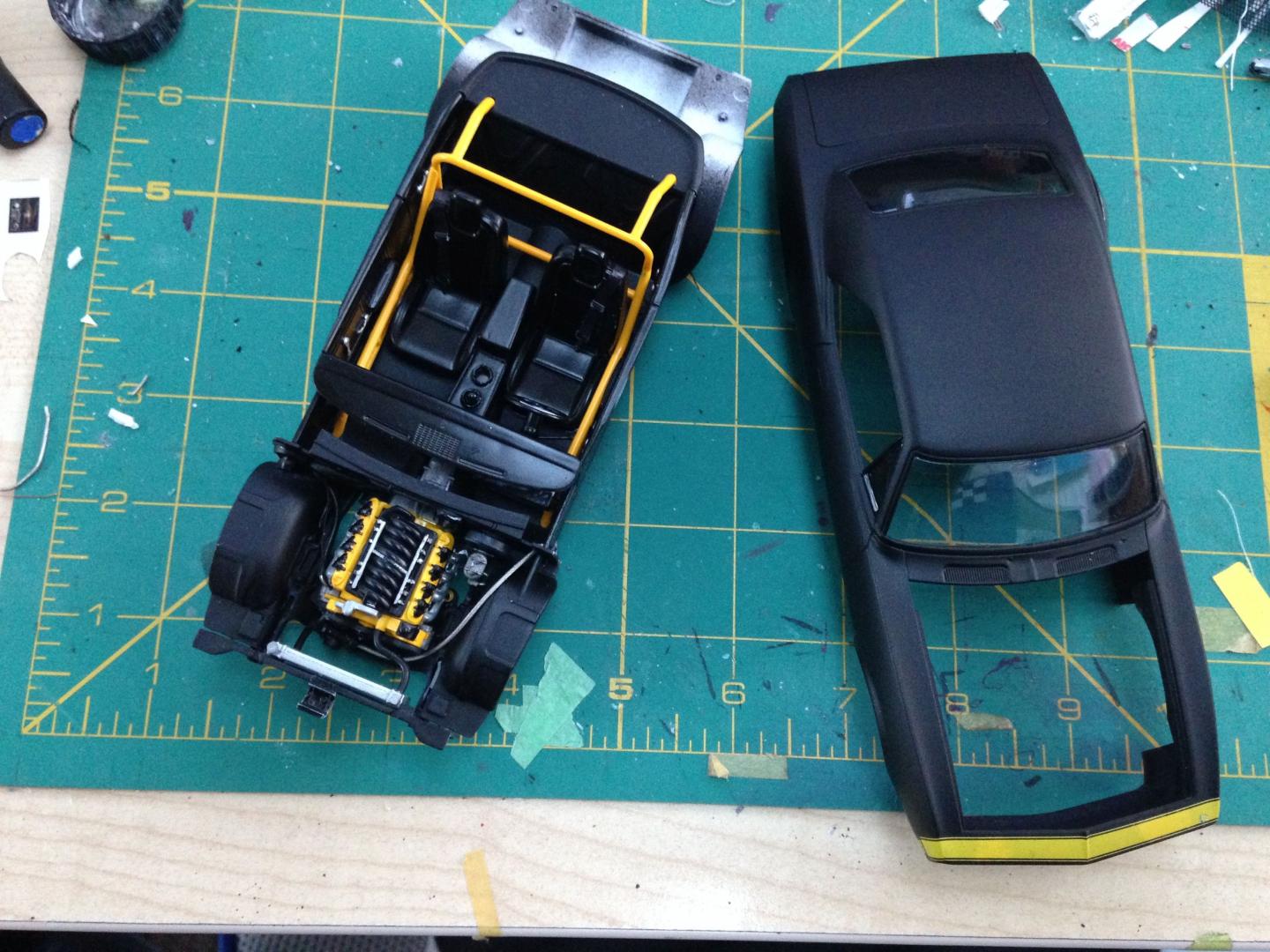

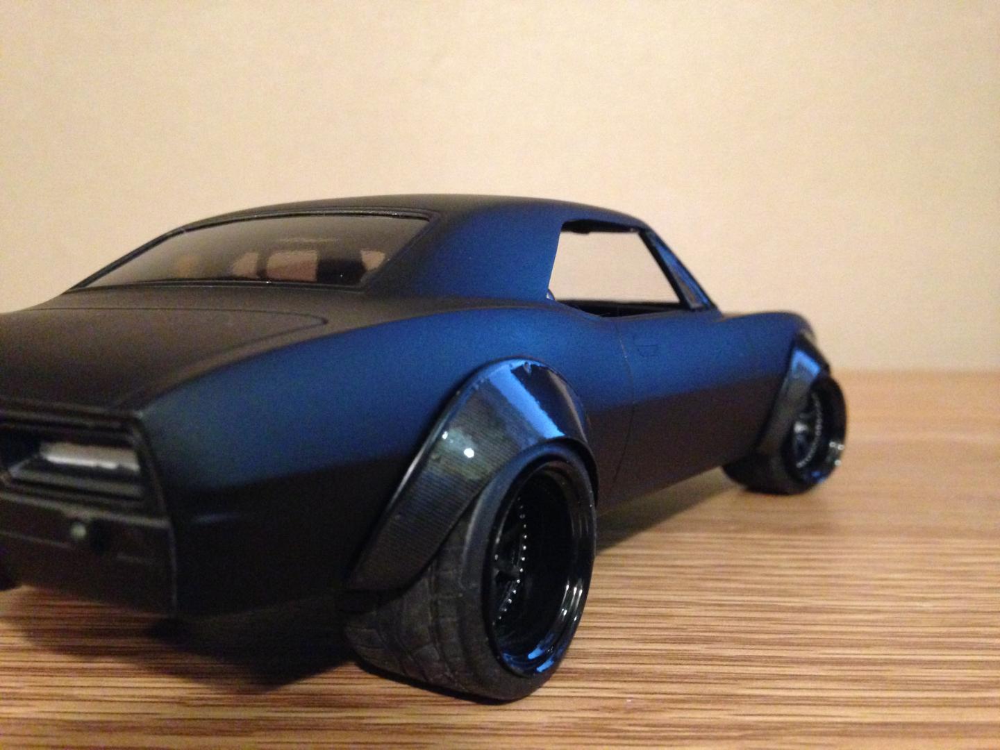

Hey Guys

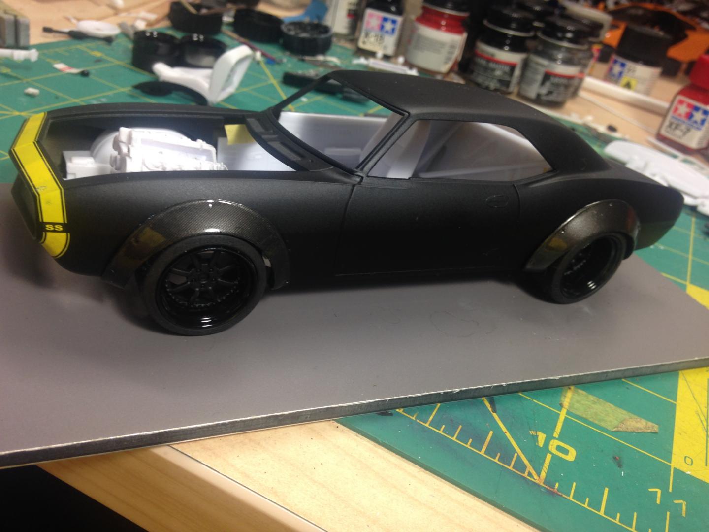

Another update of my Bumblebee that im building for the Transformers group build. Got the interiort all painted & detailed & mounted to chassis. Also Ive managed to mount the body to chassis with engine etc.
On the home stretch now, got the stance right over the weekend & brakes ready.
Thanks guys, Less than a week to go, better get a hurry on!!!
Fender flares were installed over the weekend, rideheight was sorted too. These pics were just mocking up rideheight but are now fixed in position.
Lots of little things to tidy up & finish off now.
