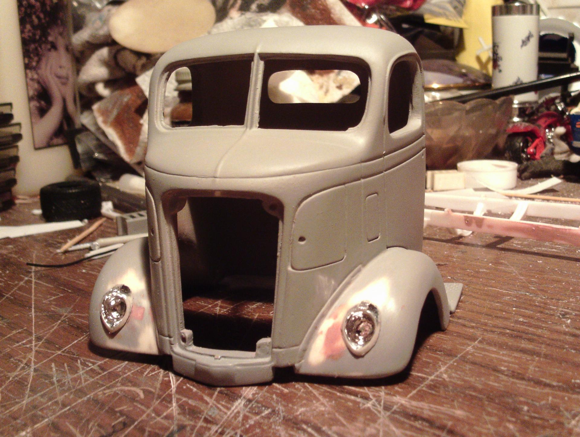

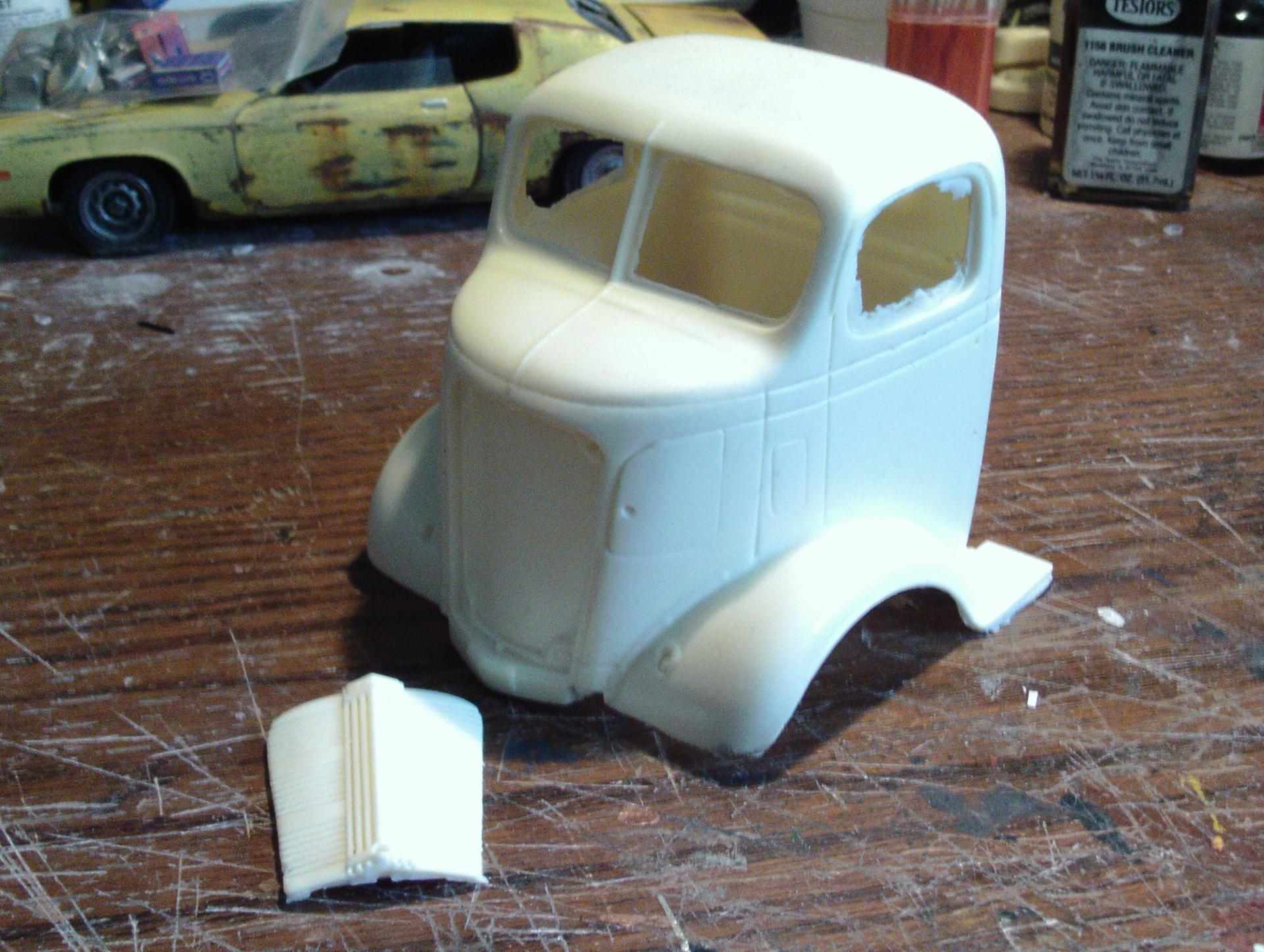

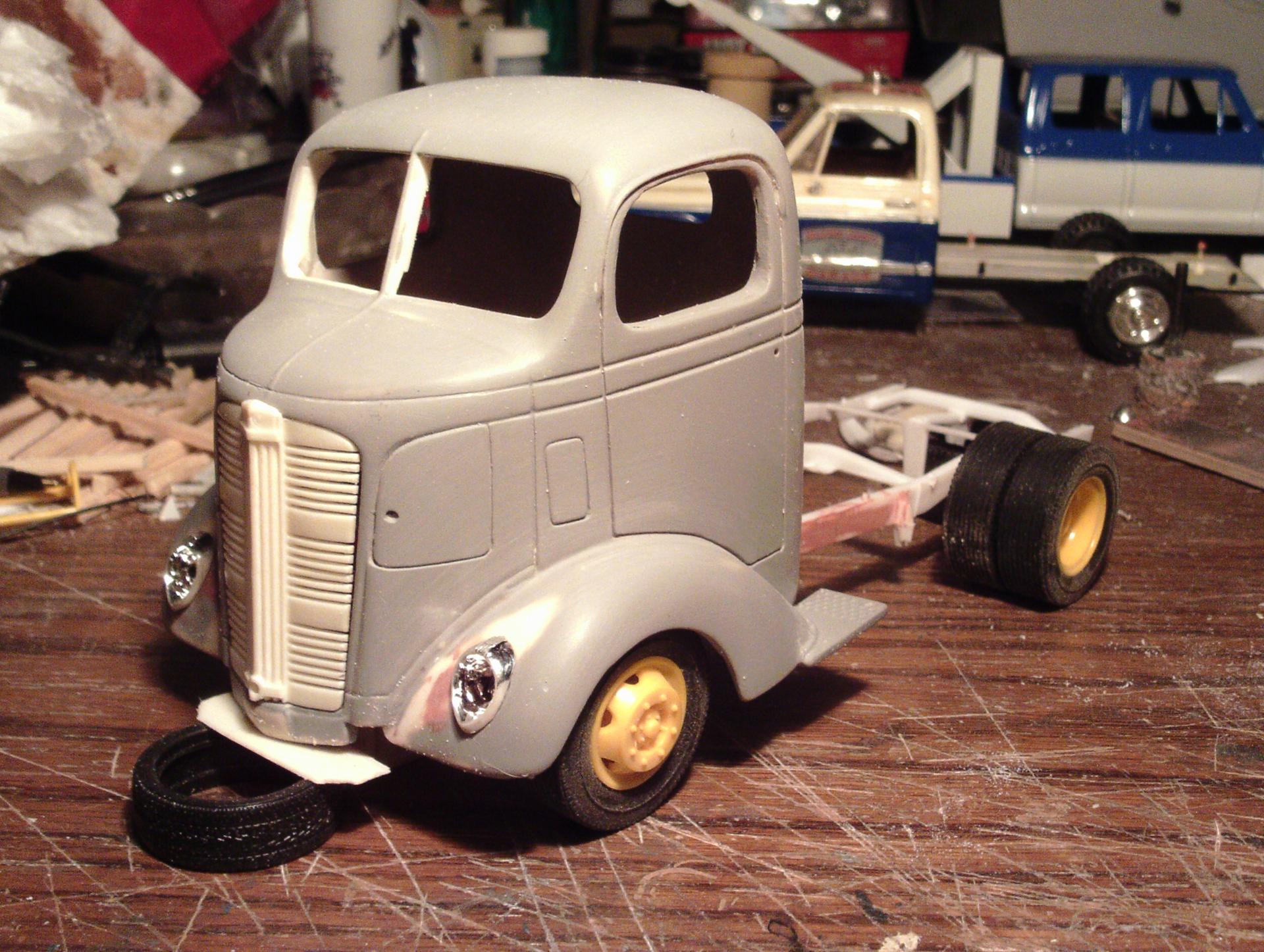

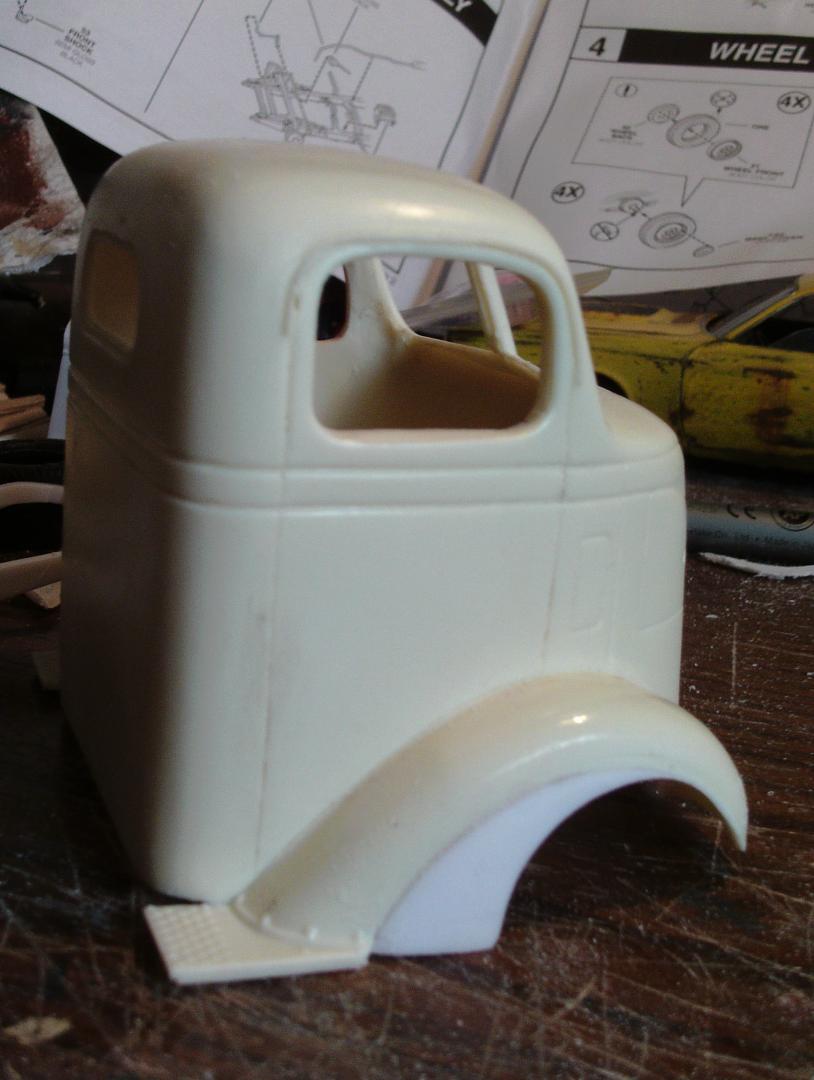

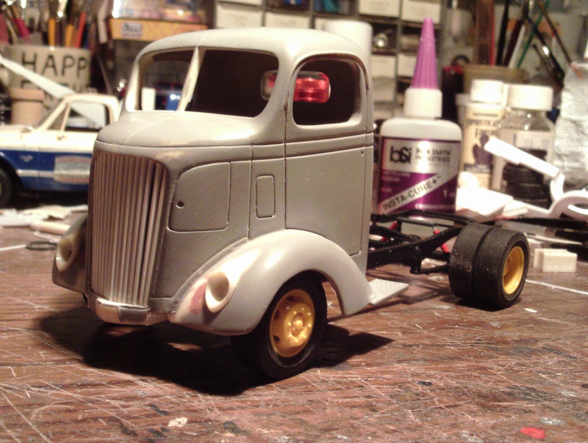

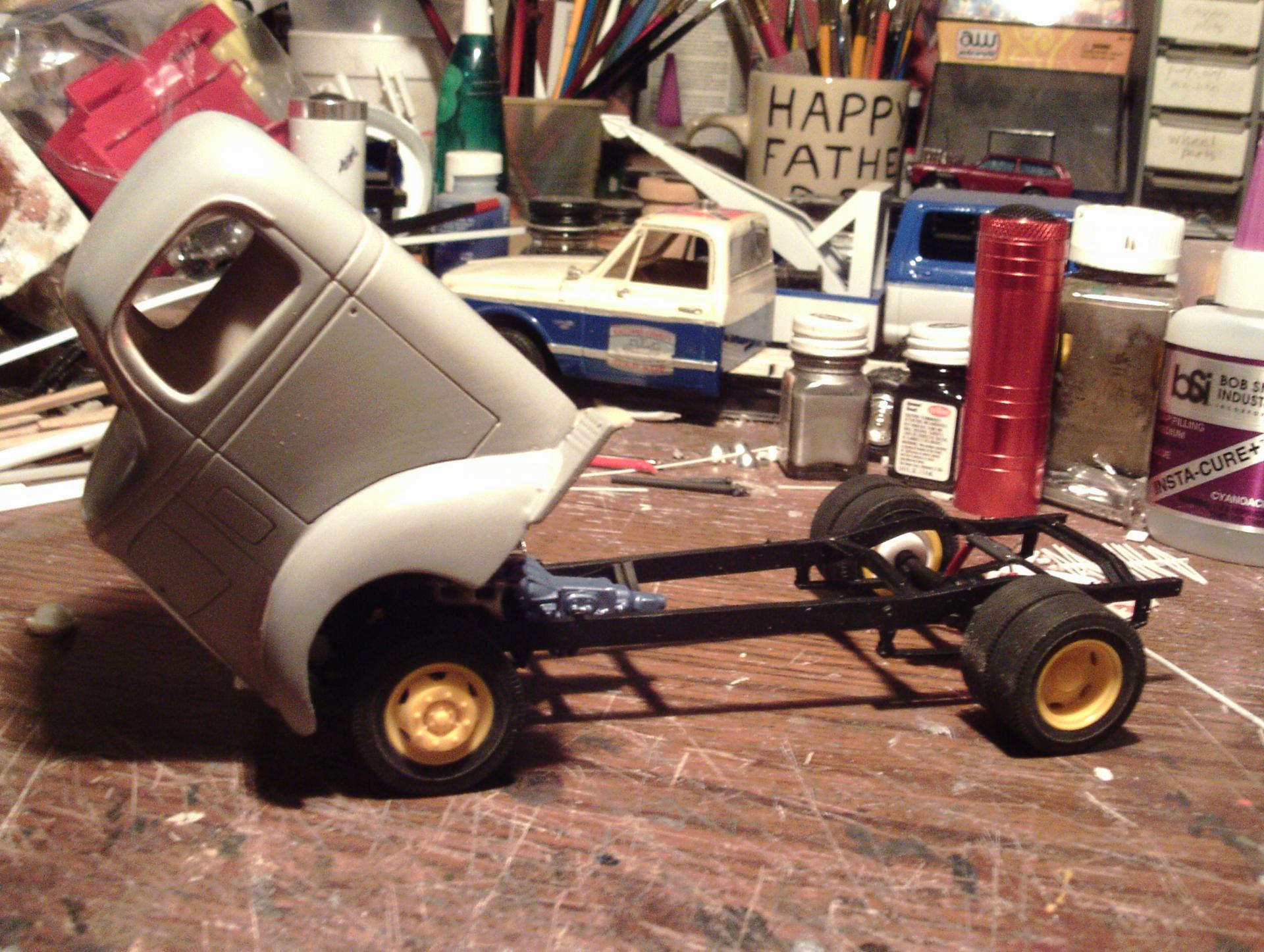

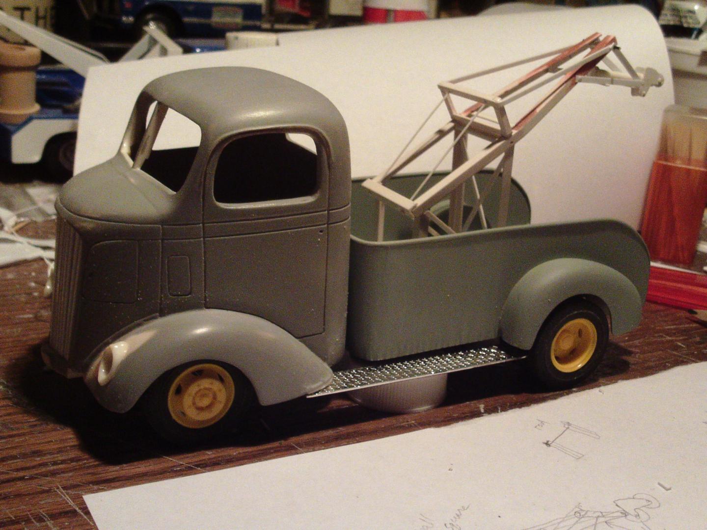

O.k. I thought I was going to do the bus but it just isn't going to happen. I started this instead, it's a 1938 GMC cabover cab & I'm using a 41 Chevy for parts along with a few other things from here & there. This is all I've got so far, I'm not happy with that grill so I think I'm going to make my own. The rear will have a scratch built wrecker body & boom.

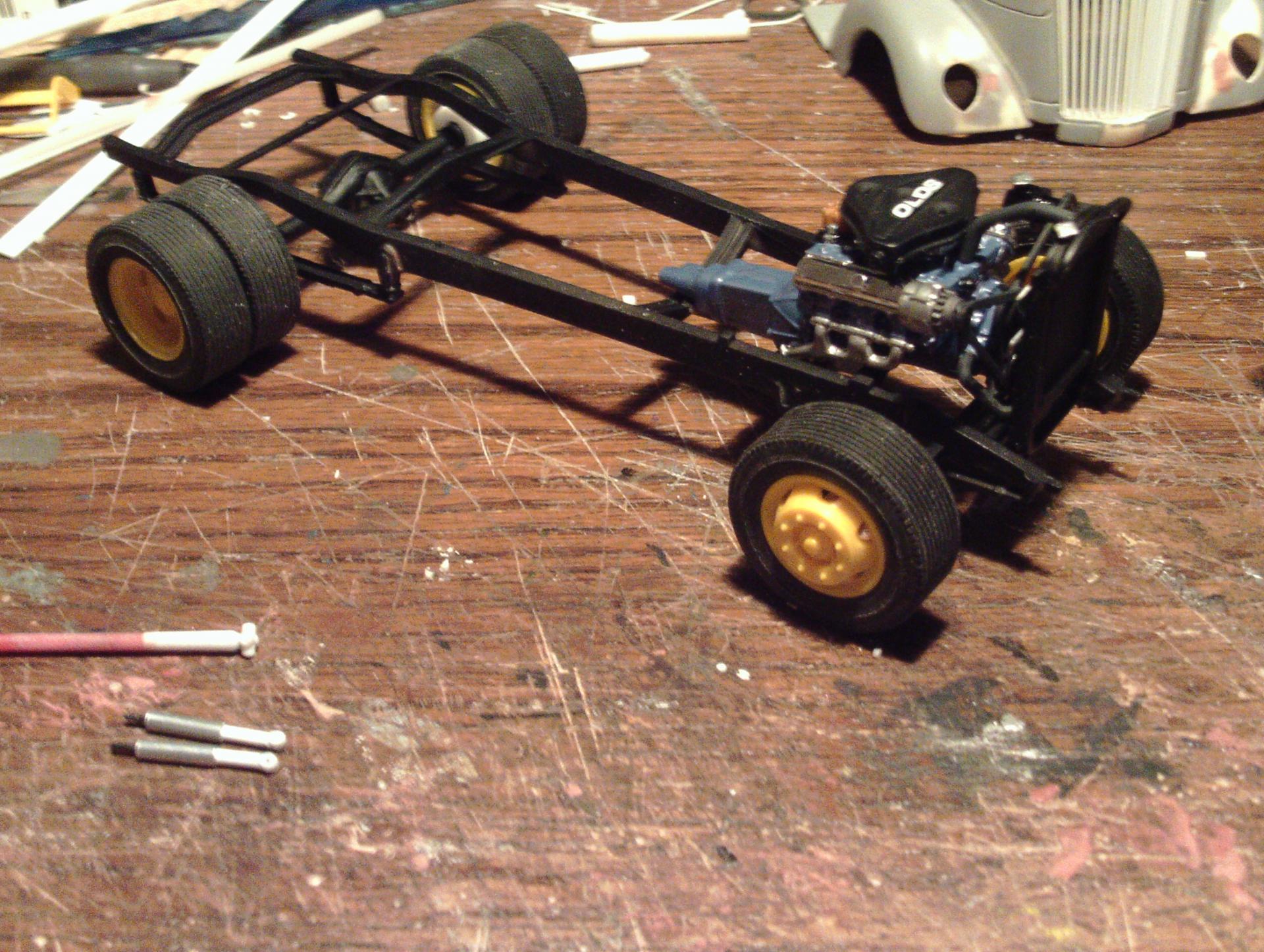

Just a little update. I made a new grill & did some work on the chassis. I used an Olds 442 engine because that's what I had.

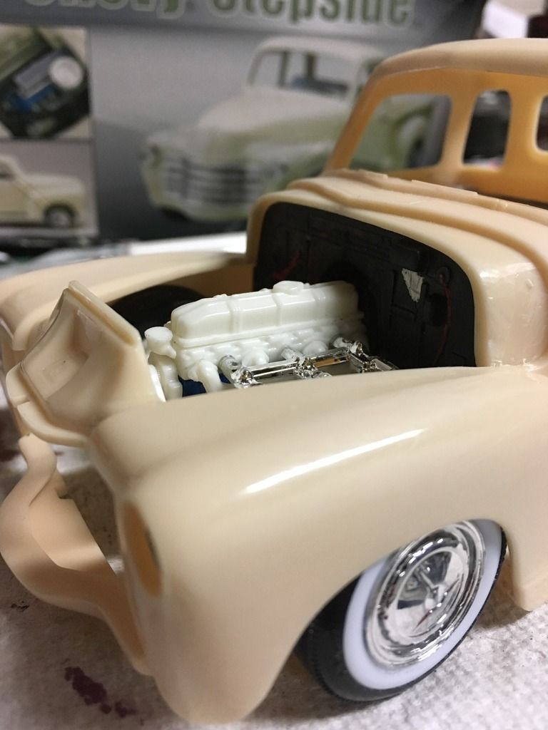

I’ve decided to build a ’50 Chevy 3100 for my next build, using this glue bomb I scored off of eBay.  I knew it was missing parts when I bought it, but what I didn’t know was that the kit was missing the drive train, chassis, and interior.
So…..I’m going to use this ’53 Corvette kit (Flea market find for $5!) as the donor for the missing necessities.

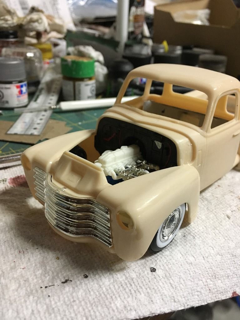

After cleaning up of the body, a quick mock up….
…really digging the look of the ’57 Bell Air wheels!  I may swap over to the Corvette wheels before things are finished, but I’m confident that the White Walls are staying.

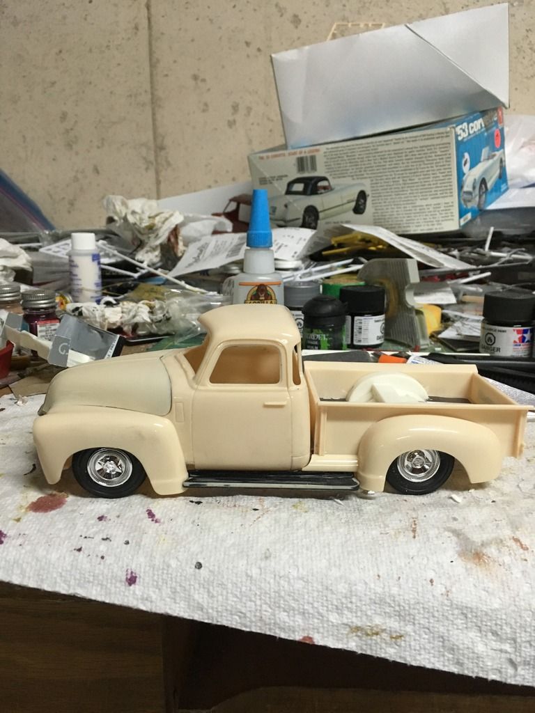

Got a little more work done on the Chevy.  Started building the missing interior tub using the Corvette parts...

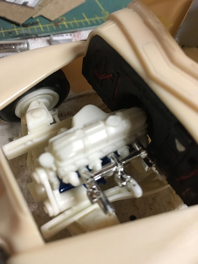

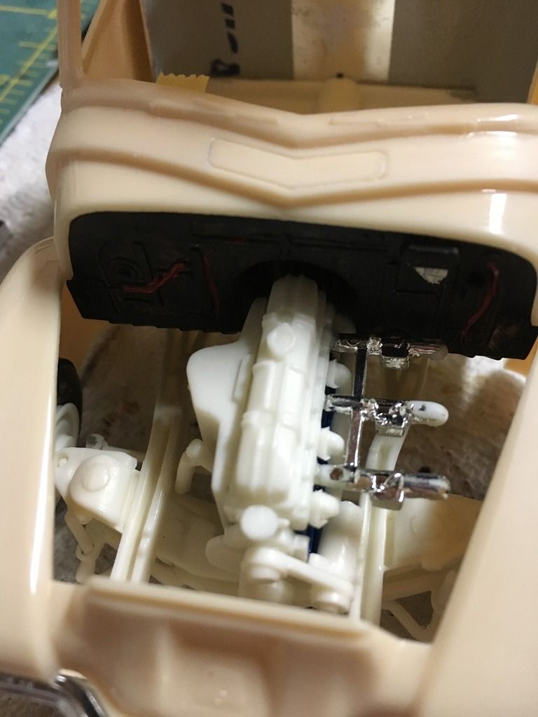

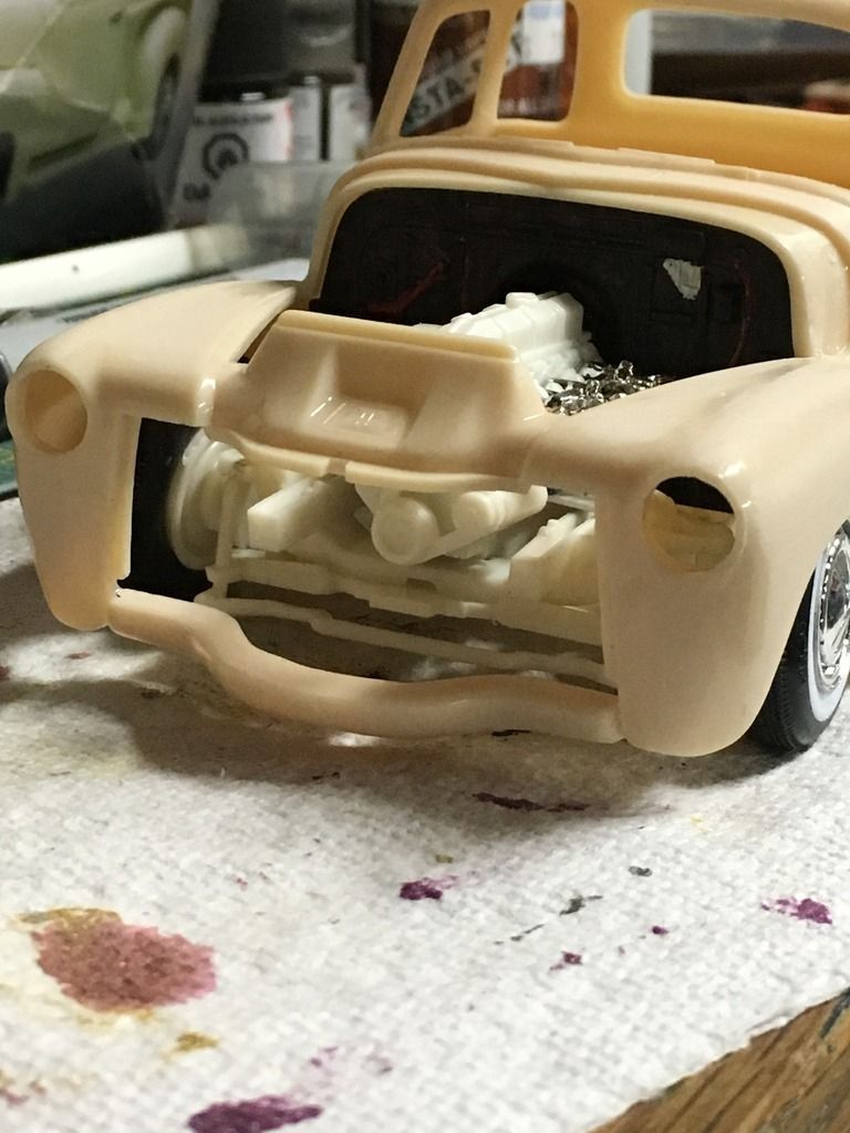

Mocked up the Corvette drive train.  Had to notch the oil pan and move it forward between the rails to fit properly under the hood/clear the cab firewall.  All that aside, I think the minor modification will be worth it after paint and final assembly.

Here's some more pics I forgot to upload earlier.

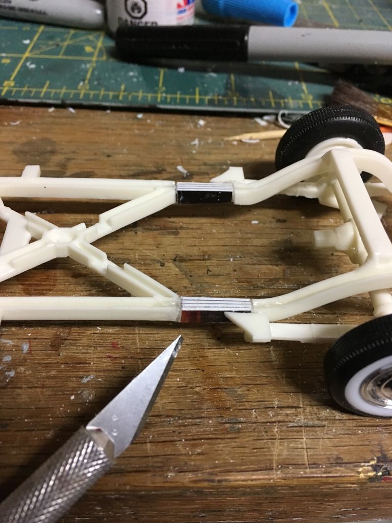

In this one - you can see where I extended the Corvette frame by approximately 14 scaled inches using some old plastic gift cards.  Some minor clean up required.

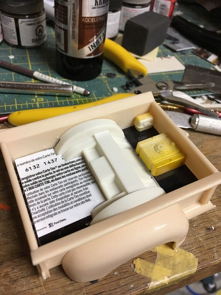

Here, I started modifying the back half of the Corvette floor pan to make a custom truck bed...
More to come...
Completed the bed floor - used more gift cards for the job and added some left over components like the fuel cell and battery box from my '29 Ford.  Ready for paint!

The view from the rear...

Extended the drive shaft by cutting off the U-joints and using some scrap for the extra length

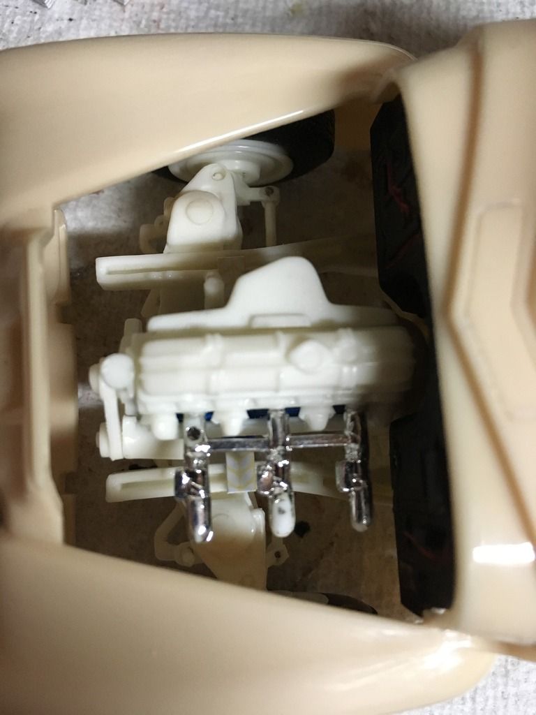

Make shift motor mounts made...
In this mock up, you can really see how far the body has been dropped on the Corvette chassis...
Motor nice and centered in the engine bay...
...and this shot just because I like it the stance....

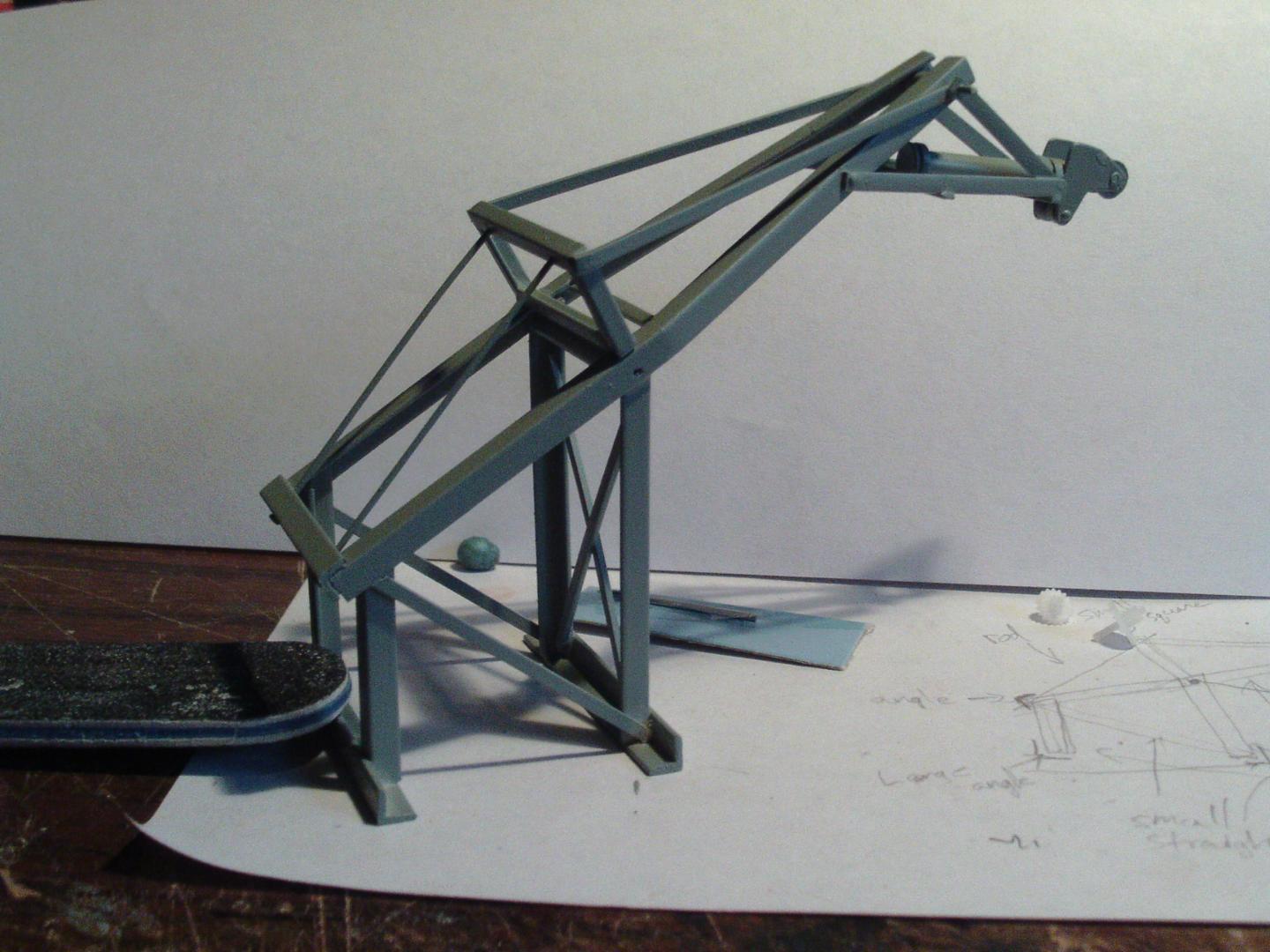

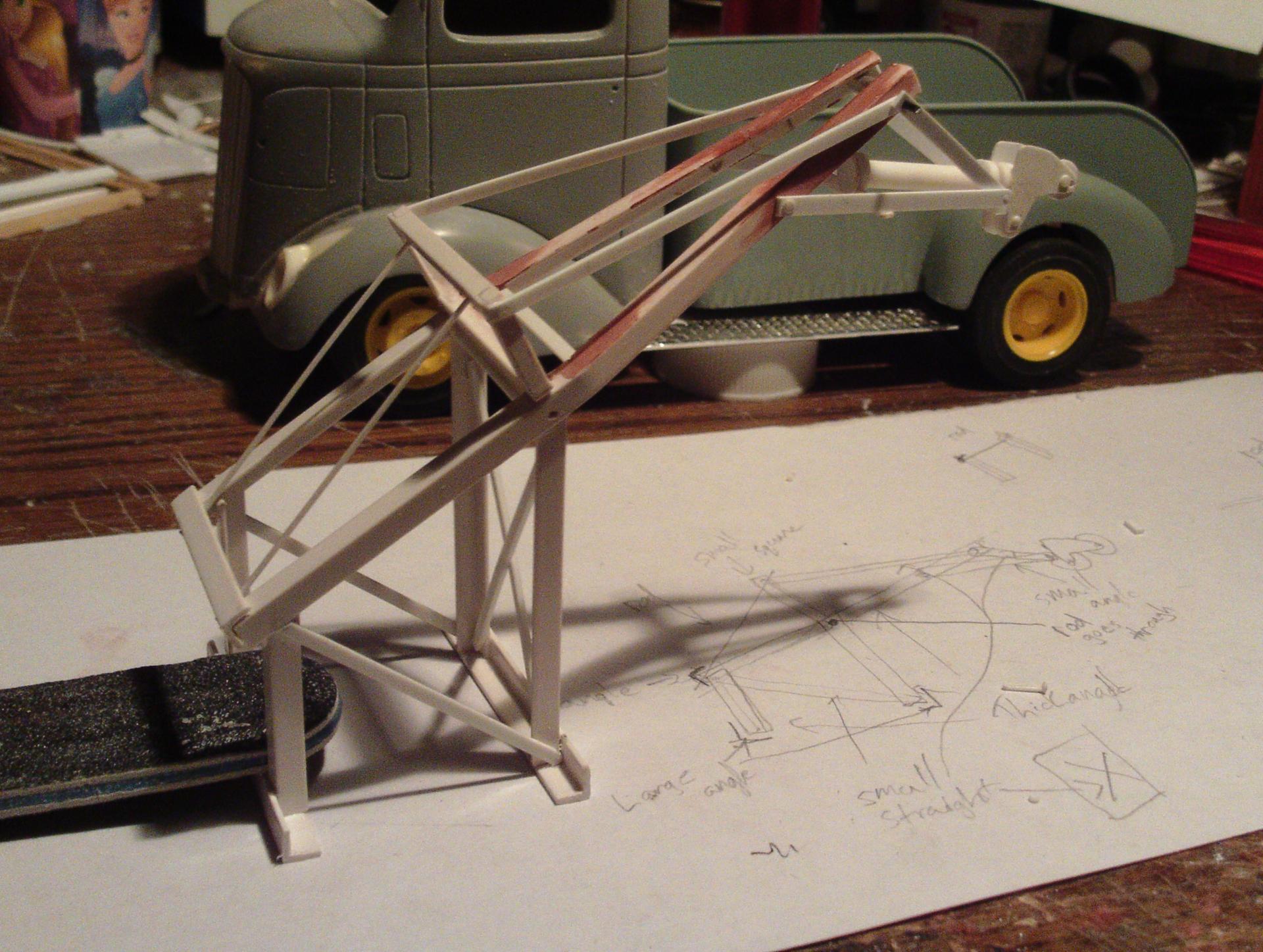

I got a little more work done on this thing. I built the body & I never had such a hard time! I've done lots of them before but it just wouldn't work for me. I had to walk away a few times before it ended up in a million pieces. The tow boom (which should have been the hard part) was built in a day, no problems yet, I just have to find some gears for the hand crank winch. I want it to look like a "Manley Wrecking Crane".
Man, that is an awesome looking wrecker Mark. Nice work mate. Going with a "new" paint job or a rat rod patina? Cant wait to see.
The hard (frustrating) work is paying off-sweet cab over!
Thanks, but what's sweet is that Stepside Vette your building! Really nice work & I love the use of gift cards!
Thanks David, new paint, what's that?;) Definitely going rat rod patina, I haven't been able to pull off a "new" paint job in years.

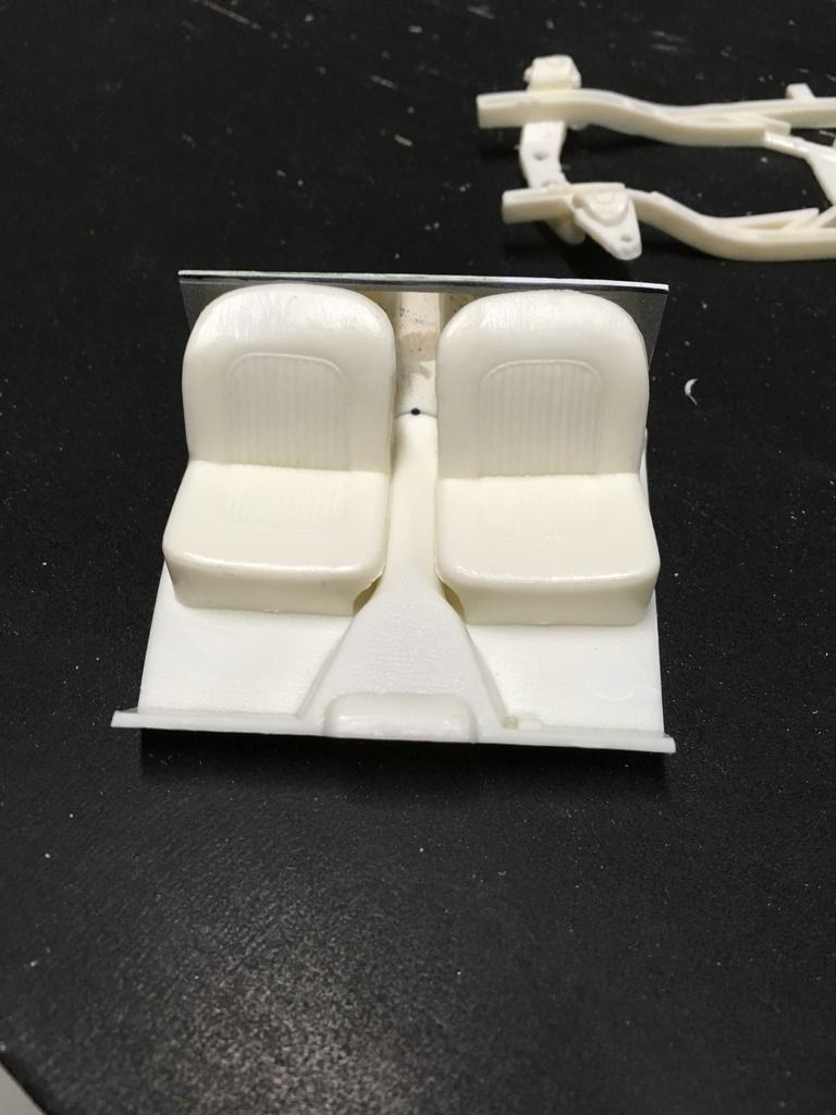

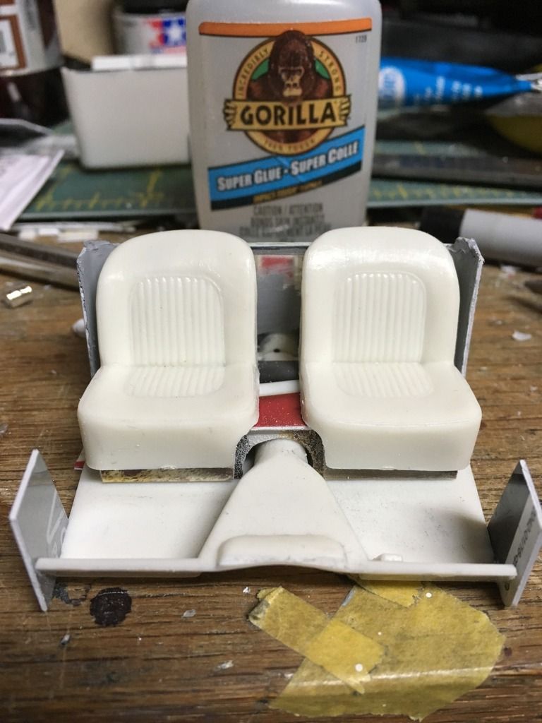

I like the Corvette bucket seats, but they are just too low for a truck application.
A comparison of my scratch building to the kit stock tub from my stash…
The seats need some sort of riser… bring on the gift cards!
Crude, but it works.  Lots more tweaking left to do...

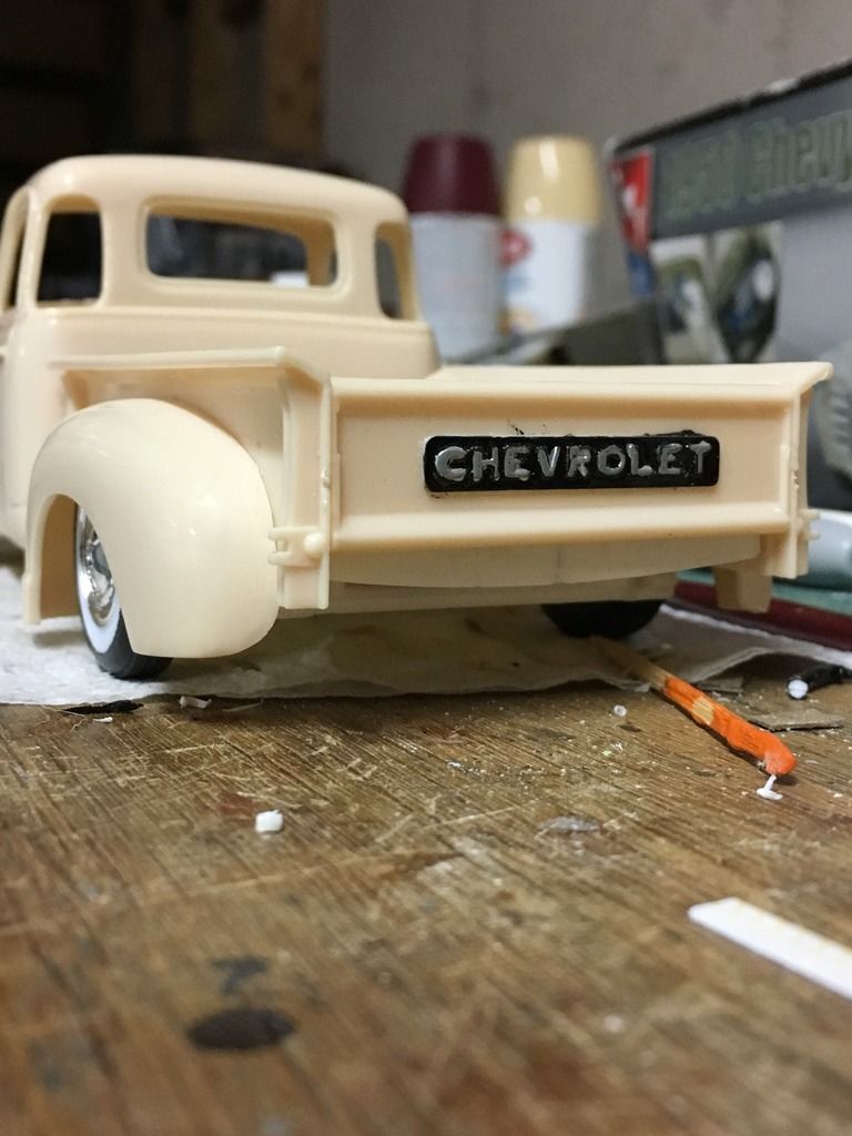

The running boards are attached to the cab here.  Also playing around with different wheel/tire combo.  The AMT ’53 Corvette wheels fit better on the chassis than the Revell ’57 Bel Air wheels, but they don’t look nearly as cool…
 photo IMG_2470_zpse4369mpa.jpg photo IMG_2469_zpsng3piq5w.jpg photo IMG_2471_zpsqueqoq4b.jpg
Wouldn't be difficult at all to turn these tires into white walls.  A minor issue compared to everything else.  I’ll get it sorted – may need to throw some paint on the body this weekend to see what works better!

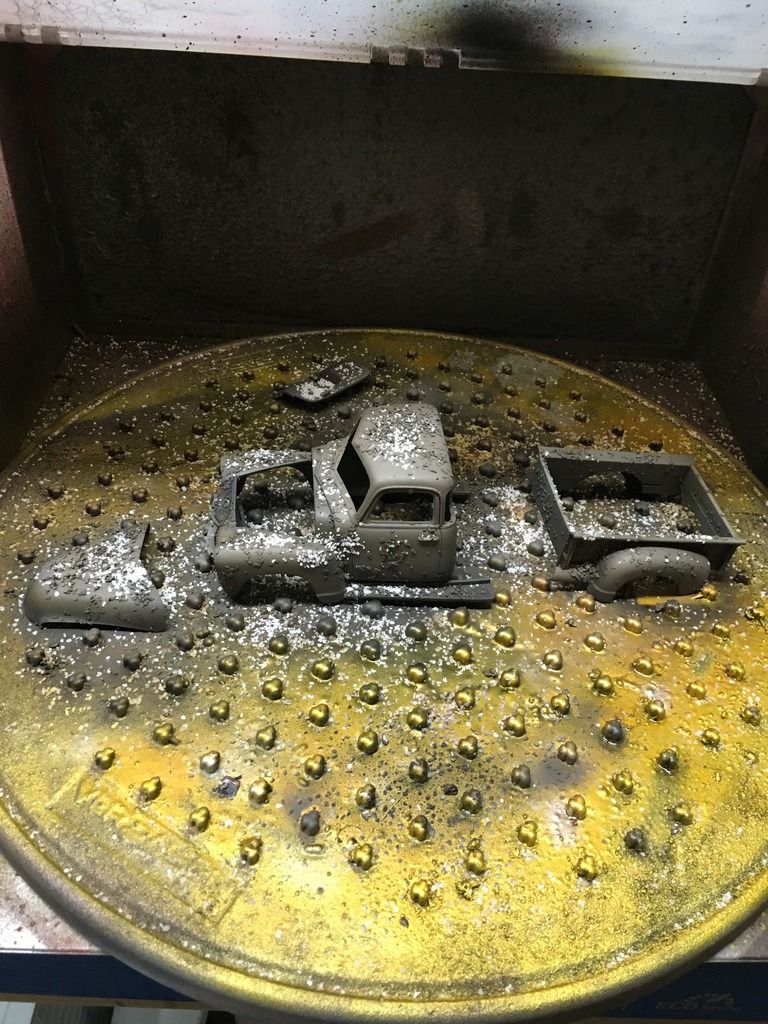

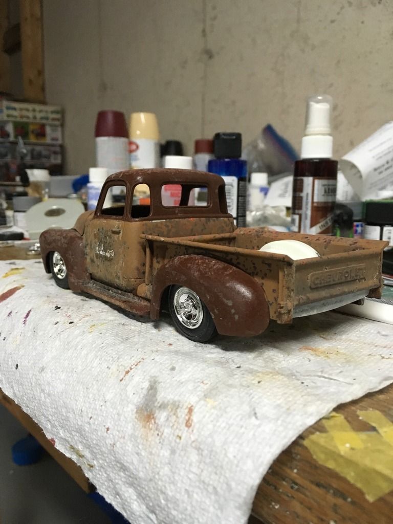

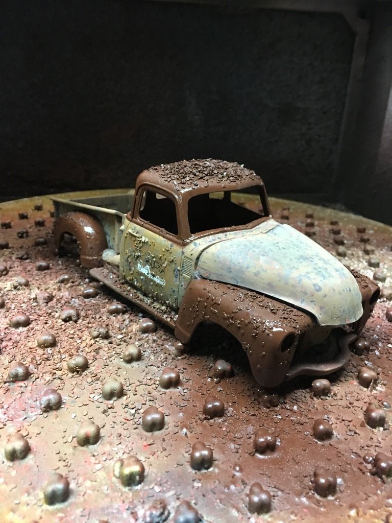

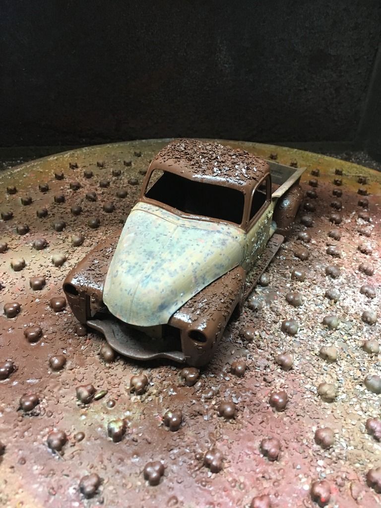

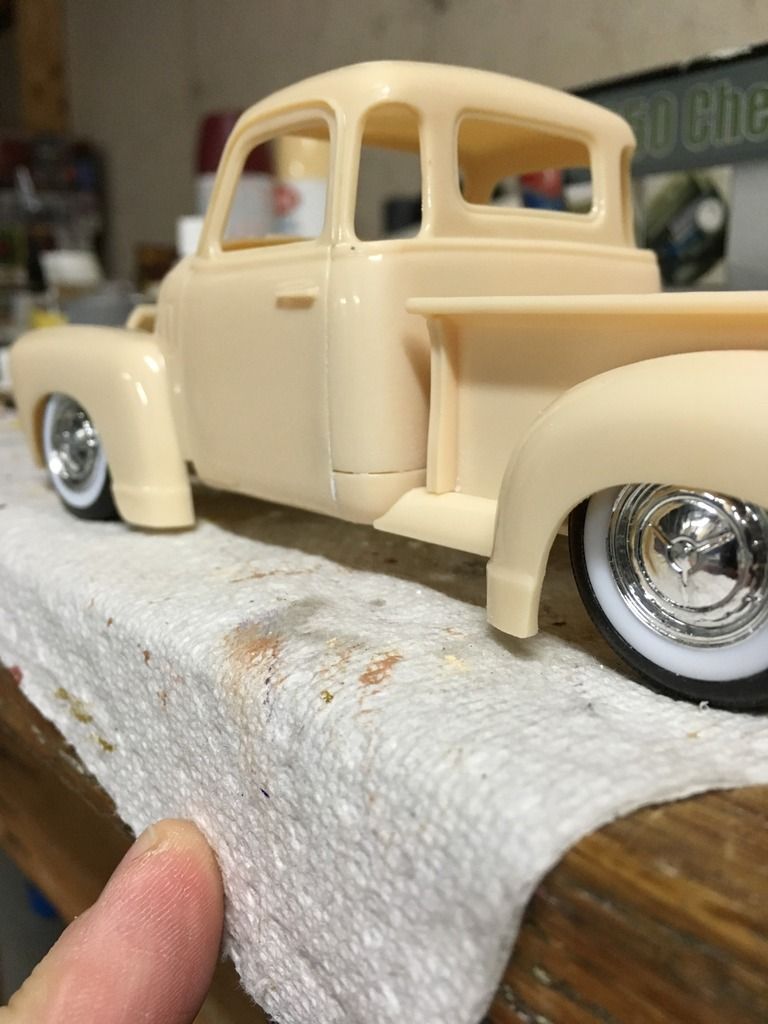

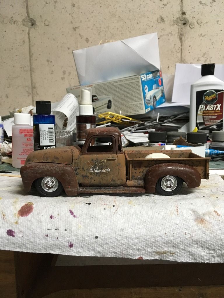

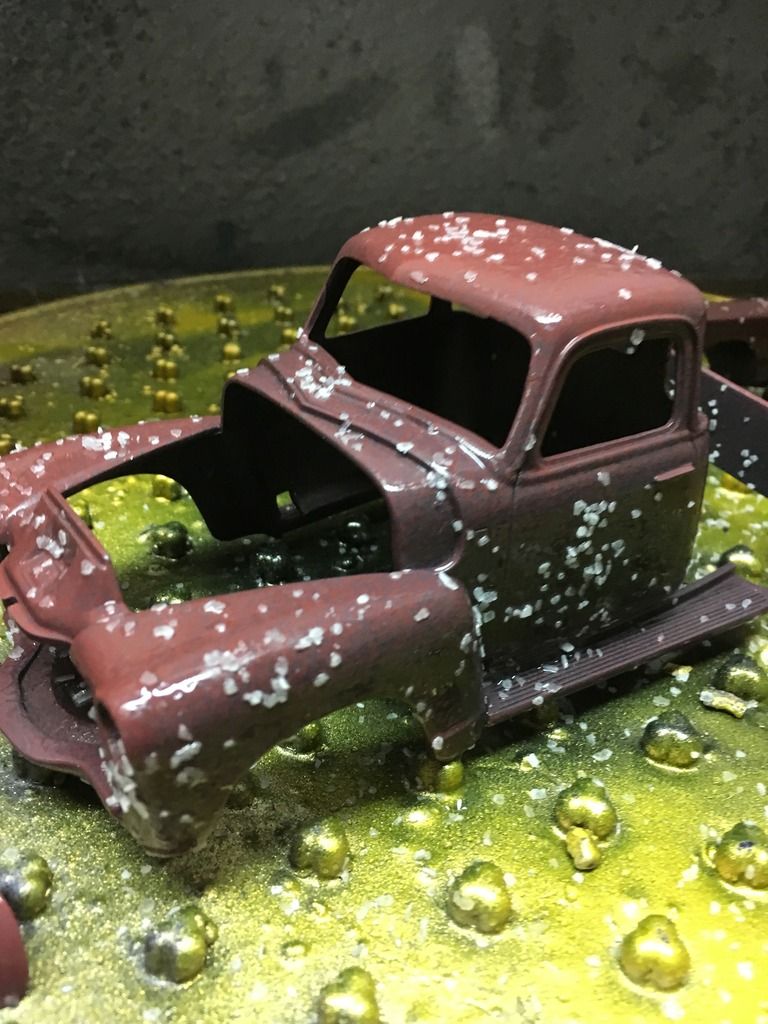

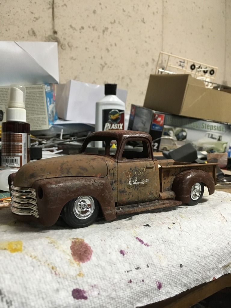

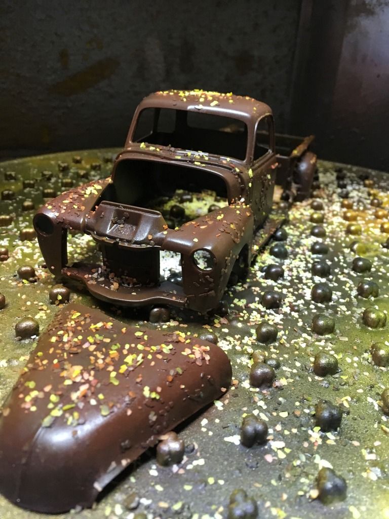

Sprayed some paint this weekend….
Here’s some primer – Red Oxide over grey, over black
Tried my hand at the slat method for the first time….
I like that technique, it looks great!

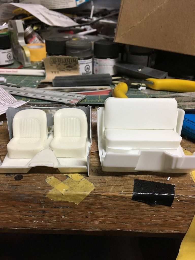

I don't have any pictures at the moment, but last night I did some more work on my build with getting the interior tub pieced together. Essentially, I used the majority of the Revell interior for the front seat area, and the seat-area back from the AMT interior for the rear portion. For the seats though, I'm using the AMT seat for the front seat since it's more detailed and slightly larger, while the Revell seat will be used for the back seat since the cushion is shorter.

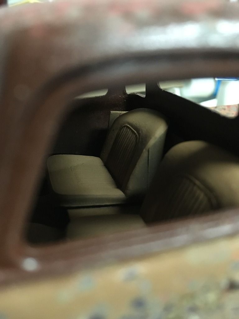

…and now for a quick mock-up.
Interesting how the colors change in different lighting conditions!
Not the results that I was hoping for, but close the look I was trying to create.  Still some more work to do, but almost there.
 photo IMG_2676_zpspoyhp0pp.jpg photo IMG_2674_zpssvrfdybm.jpg photo IMG_2672_zpsdumjrow8.jpg photo IMG_2671_zpszohcpcyj.jpg photo IMG_2670_zps6fe8l3h5.jpg photo IMG_2673_zpsccvag8ge.jpg
So far, the Corvette wheels are looking the part for this truck.
