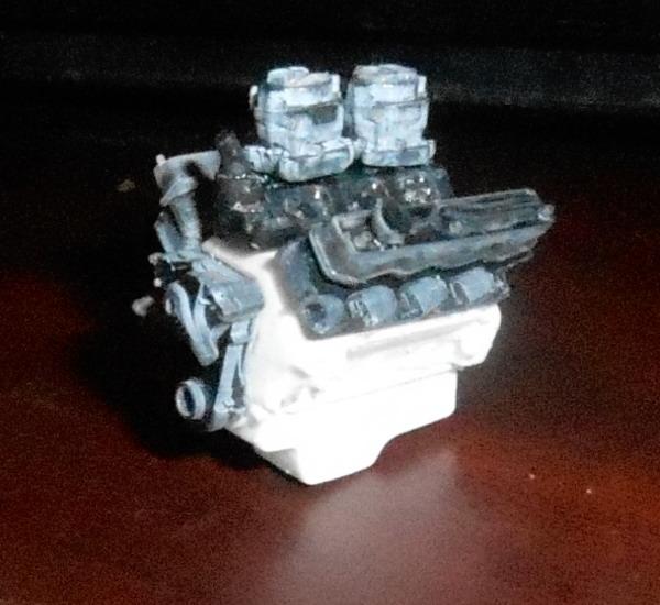

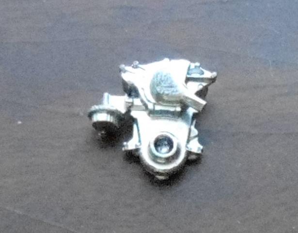

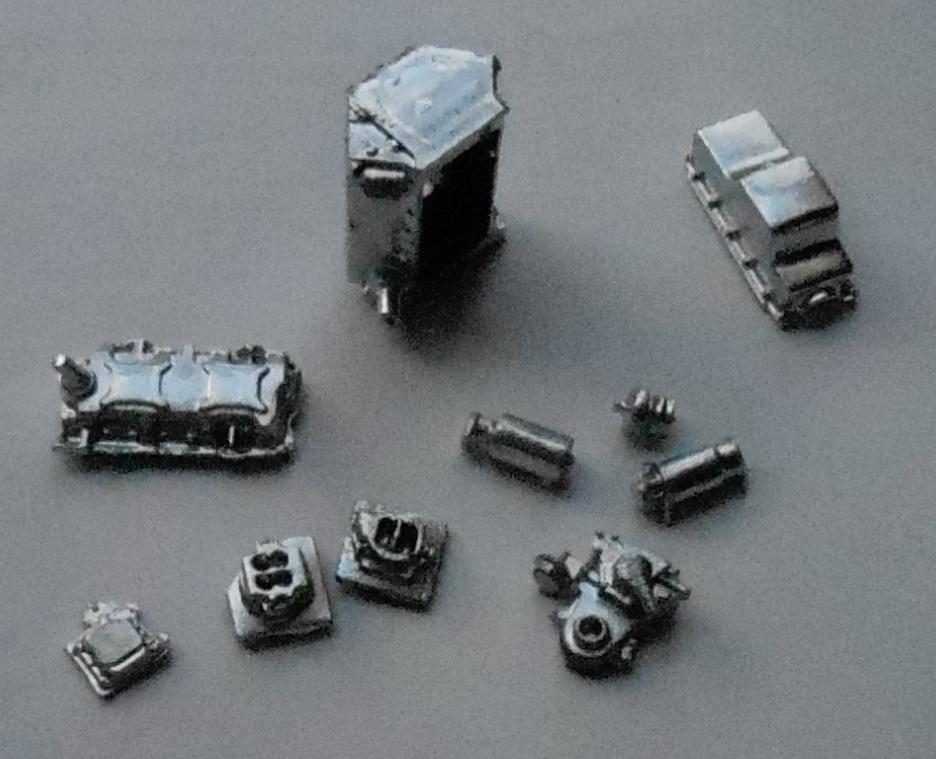

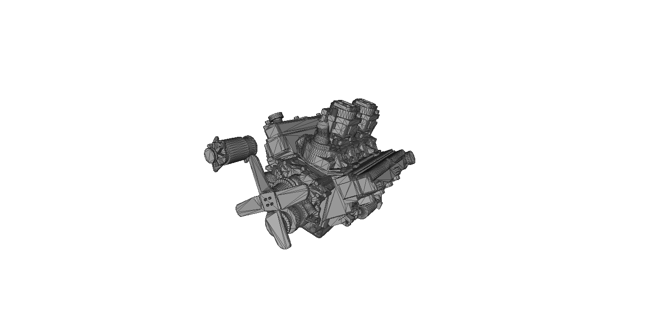

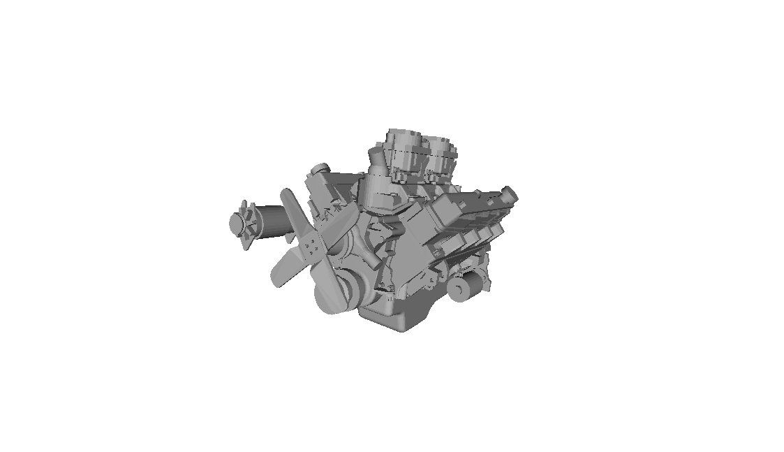

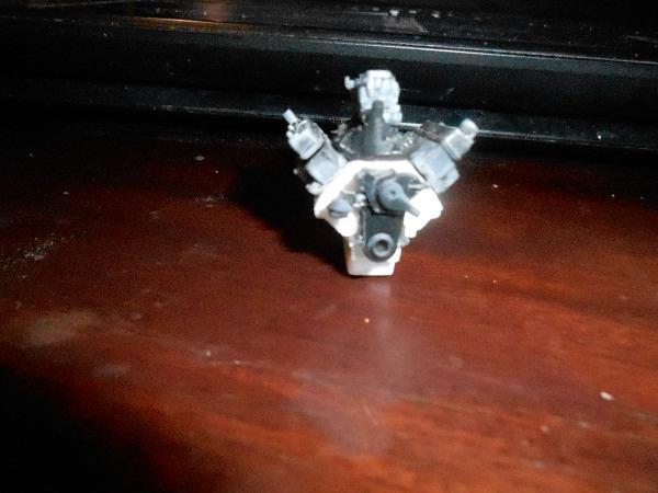

my66s55 Posted December 22, 2016 Posted December 22, 2016 (edited) I need this engine for my upcoming 56 Plymouth build and since others have expressed a desire for one, I started creating it. This version is for the 56 & 57 Plymouth. The A engine was only used in Plymouth for 56-58 models. There was an older poly head version used in other Chrysler lines through 58. The heads swapped out with hemi engine heads and and everything else except the valve covers were hemi. I am open to any thoughts, questions, suggestions and or comments on this project. The actual engine My engine in it's current state Shoing the stl. files The printed parts starting with the head valve cover Timing chain cover and water pump- kindly excuse my thumb print on the water pump The water pump pulley, fan and oil filter cartridge The engine block in two pieces The engine block shown as one piece. The oil pan, harmonic balancer and crank shaft pulley, starter, generator, intake manifold, and the 3 sections of the Carter wcfb carb. Edited January 14, 2017 by my66s55 missig picture

my66s55 Posted December 23, 2016 Author Posted December 23, 2016 Thanks for the positive replies. Yes Dan, I designed these created the files and printed these parts on my 3d printer. It takes a different type of printer to print this type detail. It uses u.v. curable resin and a D.L.P projector instead of melting plastic in layers. John, I am creating this now because there has been an interest in being able to obtain this engine in scale. This version is only good for 56 & 57. 58 needs a different oil pan.The heads and valve covers might not fit the engine block you want to use. What block did you want to use them on to create what engine year?There will be more versions in the future as this block is only used from 56-61. I have the 62-66 Block already. The valve covers from 59 on didn't have the center screw bolt. The torqueflite A488 cast iron trans was used from 56-61 and is the bell housing is unique to the A engine. The trans from the 57 Chrysler 300 is not correct and has flaws. I'm in the process of creating the A488 file currently. Past that, I need to do the exhaust manifolds and air cleaners. Future parts will be a single 4 barrel and a 2 barrel manifolds plus a 2 barrel carb and air cleaners to match.
Ace-Garageguy Posted December 23, 2016 Posted December 23, 2016 Very nice, parts look great so far. Are some of them Alcladded to enhance contrast in the photos, or do they come out silvery?I'm always in the market for unusual engines, so this is particularly interesting to me.Pretty impressive work, especially for a self-built printer.
my66s55 Posted December 23, 2016 Author Posted December 23, 2016 Bill, the parts are printed with a resin called deep black. As a suggestion from a member here, I started painting them with Rustoleum silver. Also, Plymouth engines of this era, except the valve covers, were silver.

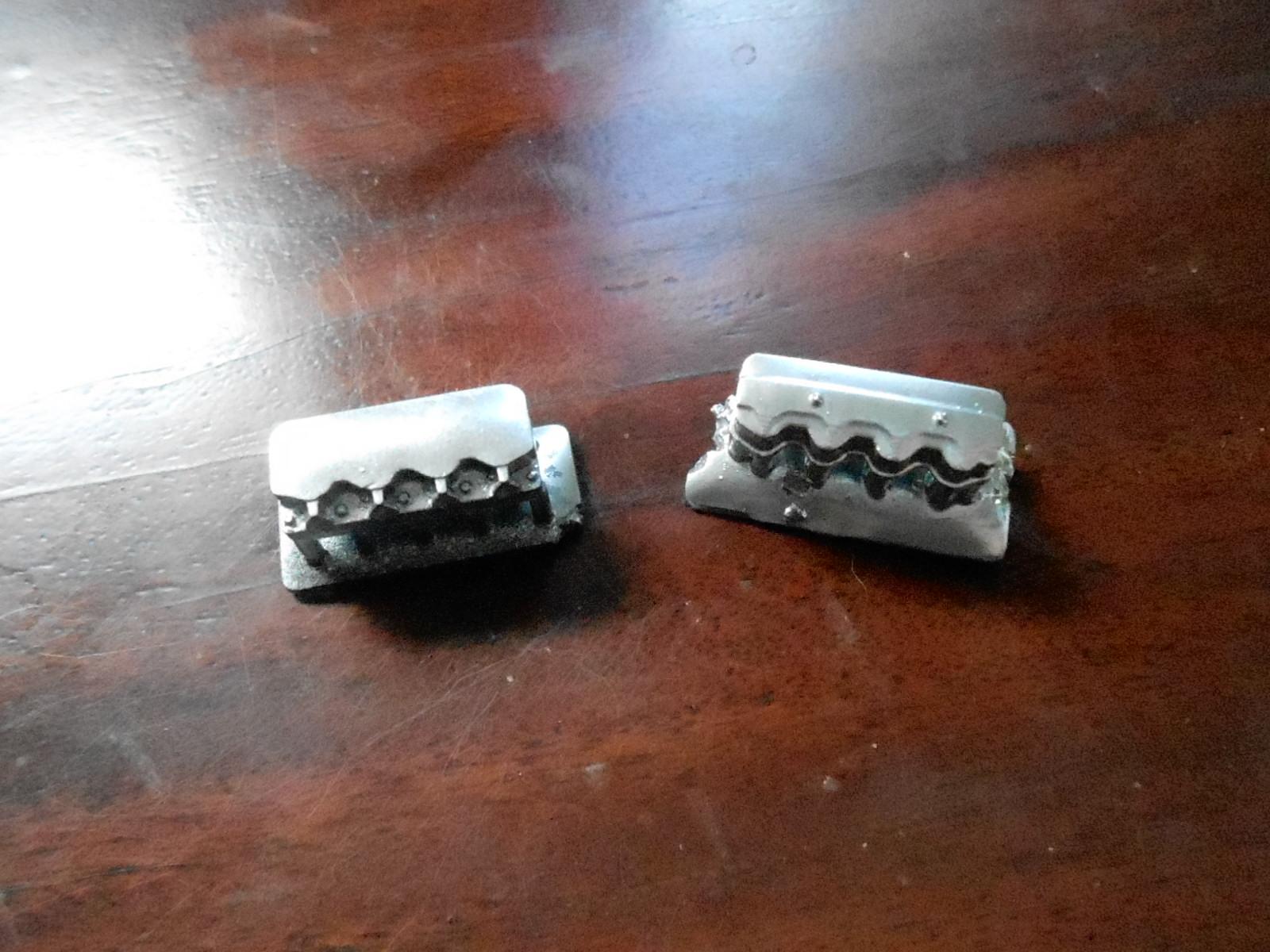

my66s55 Posted December 23, 2016 Author Posted December 23, 2016 A 325 poly can be made with these heads and valve covers that fit on the hemi in the AMT 57 Chrysler 300. When used with the hemi duel quad manifold in that kit, you have the engine that came in a Dodge D500.

my66s55 Posted December 23, 2016 Author Posted December 23, 2016 Brian, the 62-66 block was just a slight bit different as it mated with the 727 trans. The starter mounting changed position. I already have this block.Dan, the rtv and casting resin was on my doorstep bright and early this morning. Lets see how I do with that.

geetee66 Posted December 24, 2016 Posted December 24, 2016 Incredible!These 3D printers are a goldmine.Your parts look so crisp and clean. Did you need to do much clean up after printing?
my66s55 Posted December 24, 2016 Author Posted December 24, 2016 hOne thing with the older Poly Head engines before the A family.The 1955-58 Chrysler Spitfire was based on their 331-354 Hemi, no Poly Head engine with the 392 block.The 1955-56 Dodge Red Ram and the 1955-56 Plymouth Hyfire was based on the much smaller Dodge 241-325 Hemi, so if you want to do a correct Dodge or Plymouth Poly Head engine you can't base it on the Chrysler block as the Dodge Hemis are quite a lot smaller than the Chrysler's.A Dodge Hemi can be found in the Ala Kart kits.DeSoto also had a Poly engine in 1957 but it was also based on the Dodge, so no Poly head engine based on the DeSoto HemiThis is true, but that the 57 300 hemi is much nicer in detail and has the A488 trans. I have a Dodge hemi and a Desoto hemi from the Amt 29 Ford roadster and 53 Ford pickup. Based on the availability of someone using an existing kit engine, the 300 engine makes sense. Comparing the size of the 3 kit engines, they are the same length. In real life, going by the 1956 dimensions that I could find when I started this project, the Chrysler width-height are 25"x30". Dodge was 23"x27". Plymouth used the A engine. I'll use the Chrysler. I could modify the A block to the correct specks, but just doesn't make sense to me.
my66s55 Posted December 24, 2016 Author Posted December 24, 2016 Incredible!These 3D printers are a goldmine.Your parts look so crisp and clean. Did you need to do much clean up after printing?No. Just light sanding to get the bottom of the print even and rid support residue. There is no need for surface sanding as the surface is smooth.

my66s55 Posted January 3, 2017 Author Posted January 3, 2017 (edited) I used Aleene's tacky glue to do a mock up to check major parts for proper size and fit. The intake manifold appears to need widening. The carbs have not had their bottom sanded yet. This is just a preliminary before fine tuning. Edited January 3, 2017 by my66s55

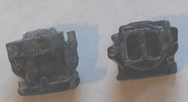

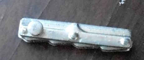

my66s55 Posted January 12, 2017 Author Posted January 12, 2017 (edited) I got the intake manifold scaled right so it fits perfect. Here's a better picture of the Carter wcfb carbs. Edited January 12, 2017 by my66s55
