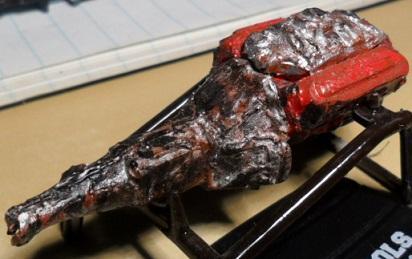

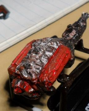

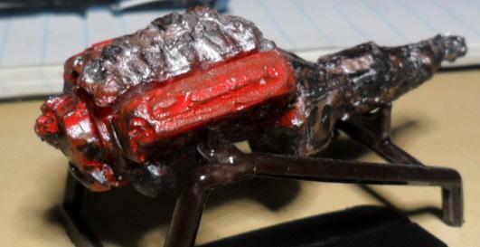

Mike Chernecki Posted December 30, 2016 Posted December 30, 2016 Well I bought a tube of Permatex Black silicone and did a few tests. Everything I applied it to, it become one with the part, impossible to remove with destroying the part and the silicone mold. I even tried cover parts in Baremetal foil first, it saves the original part, but the foil cannot be removed from the mold rendering it useless.
Mark Posted December 30, 2016 Posted December 30, 2016 VERY interesting! I have a couple of JF bodies so afflicted. I just checked a couple of JF bodies that are packed away. The '51 Chevy sedan delivery is still stuck together with the hot glue...and the kit hood fits the body as good as it fits the original kit body. It has the kit firewall, interior platform, and chassis in it. The upper part of the floor (behind the rear seat) has been cut in preparation for building the load floor in the back. Prior to gluing it up to pull the body sides in, the hood didn't fit worth a darn. The '53 Studebaker phantom sedan delivery is also still stuck together with the interior and chassis. That one didn't have any problems with hood fit, but the lower body sides were splayed outward a bit. I've got to figure out just how I want to do the interior for that one.I've also got a pre-chopped Studebaker salt flats body that got the rubber band treatment. One of the rubber bands fell apart and the other one dried out (from not even three years ago; I bought all of these at NNL East over the years). But the body is pulled into the correct shape and has stayed that way. This body has the pre-chopped top piece built into it; I've got to tweak that because the kit windows don't really fit that top very well.
talon63 Posted December 30, 2016 Posted December 30, 2016 Well I bought a tube of Permatex Black silicone and did a few tests. Everything I applied it to, it become one with the part, impossible to remove with destroying the part and the silicone mold. I even tried cover parts in Baremetal foil first, it saves the original part, but the foil cannot be removed from the mold rendering it useless.You may have to apply what seems like a lot of silicone to have enough "body" to allow easy peel off when it sets. Most of my silicon molds are between 1/4" to 1/2" thick, even more for larger pieces. That gives enough strength to remove with out damaging the mold, and working slowly, should peel off the source material with minimal work.
Mike Chernecki Posted December 30, 2016 Posted December 30, 2016 You may have to apply what seems like a lot of silicone to have enough "body" to allow easy peel off when it sets. Most of my silicon molds are between 1/4" to 1/2" thick, even more for larger pieces. That gives enough strength to remove with out damaging the mold, and working slowly, should peel off the source material with minimal work. I did one where the silicone was nearly 1/2" thick and the main body of the silicone was undamaged, but the surface attached to part I want to make a mold of shredded while trying to peel it off. There are still bits of silicone embedded in the details on the surface of the part.
