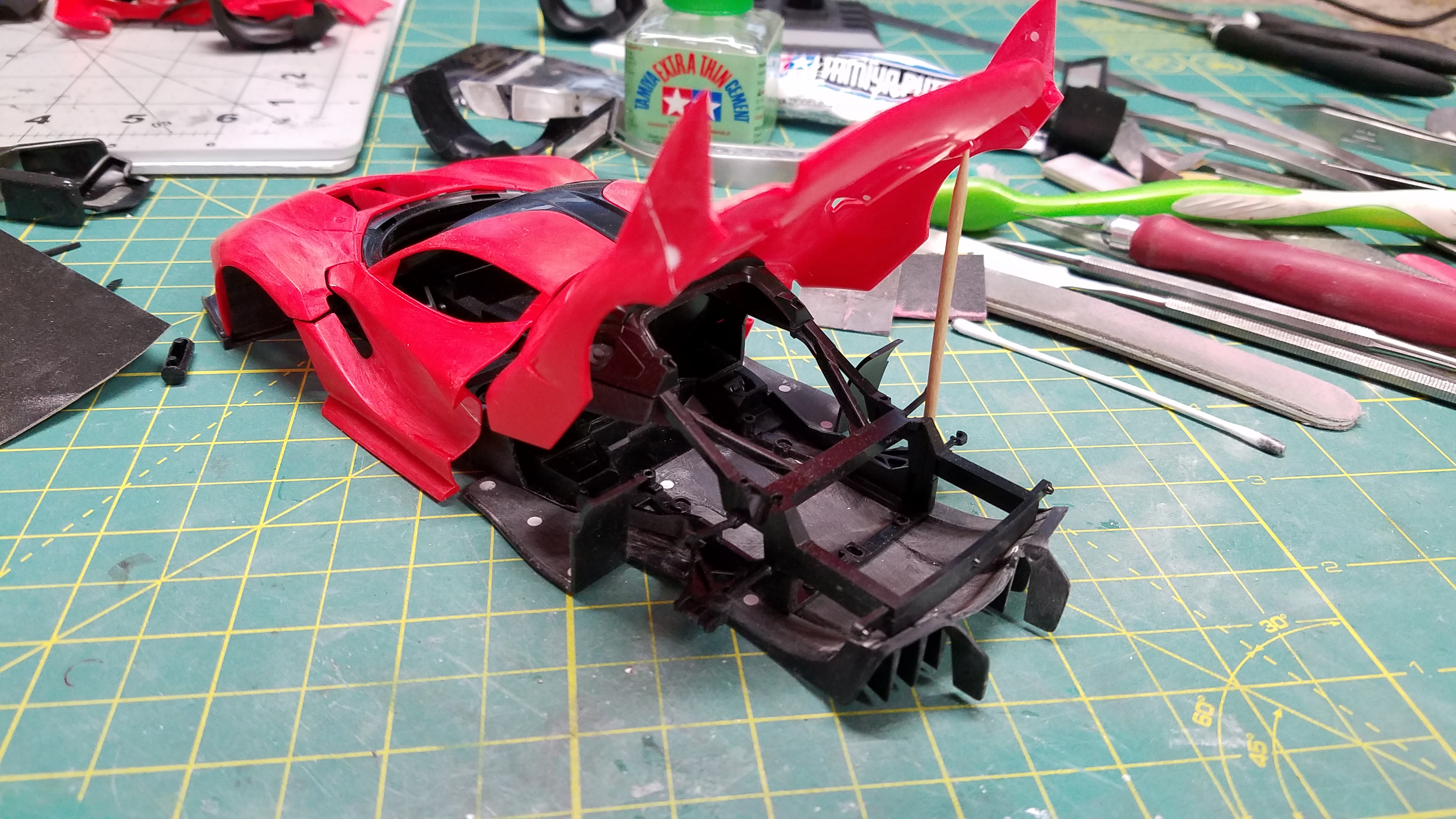

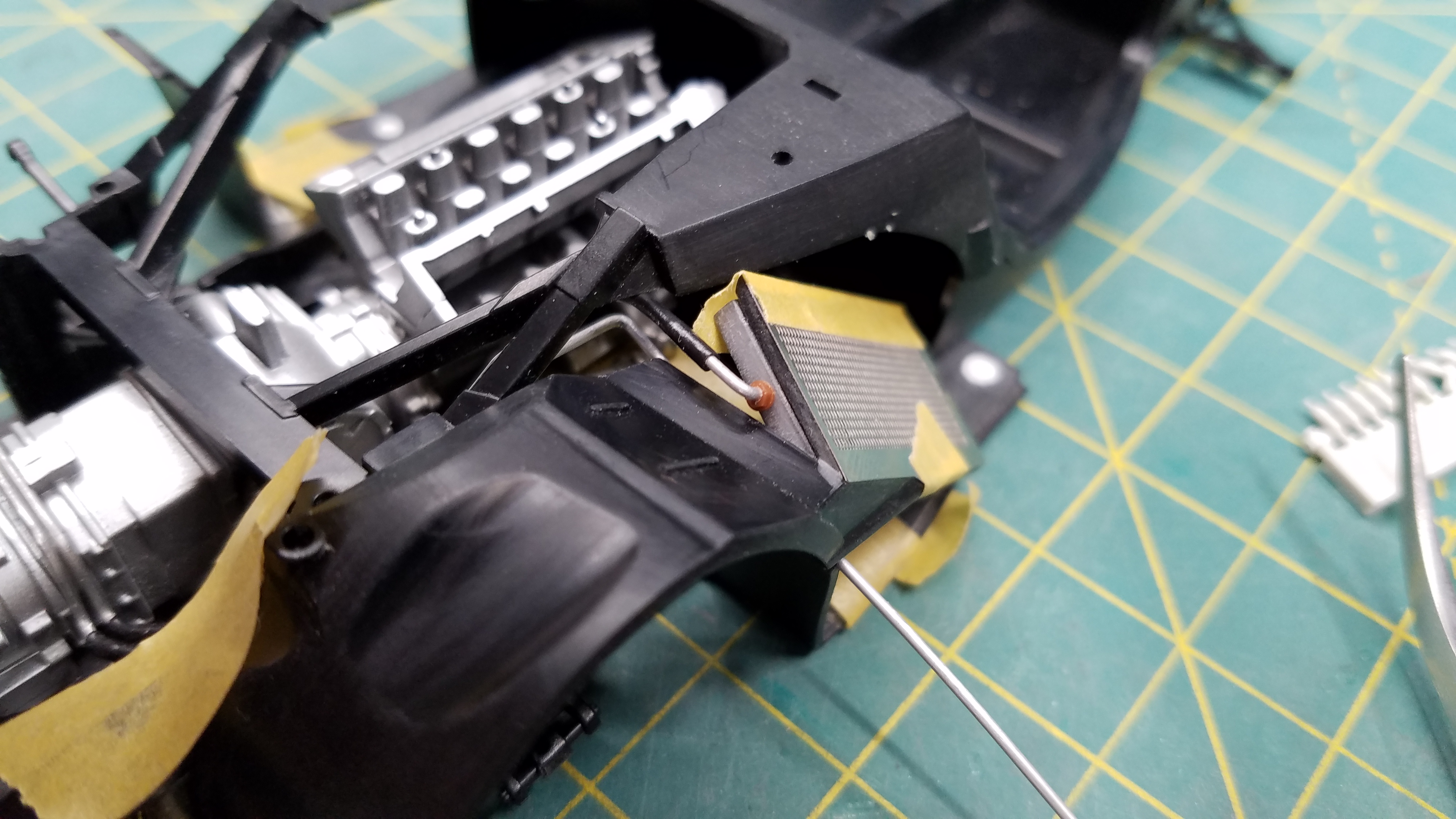

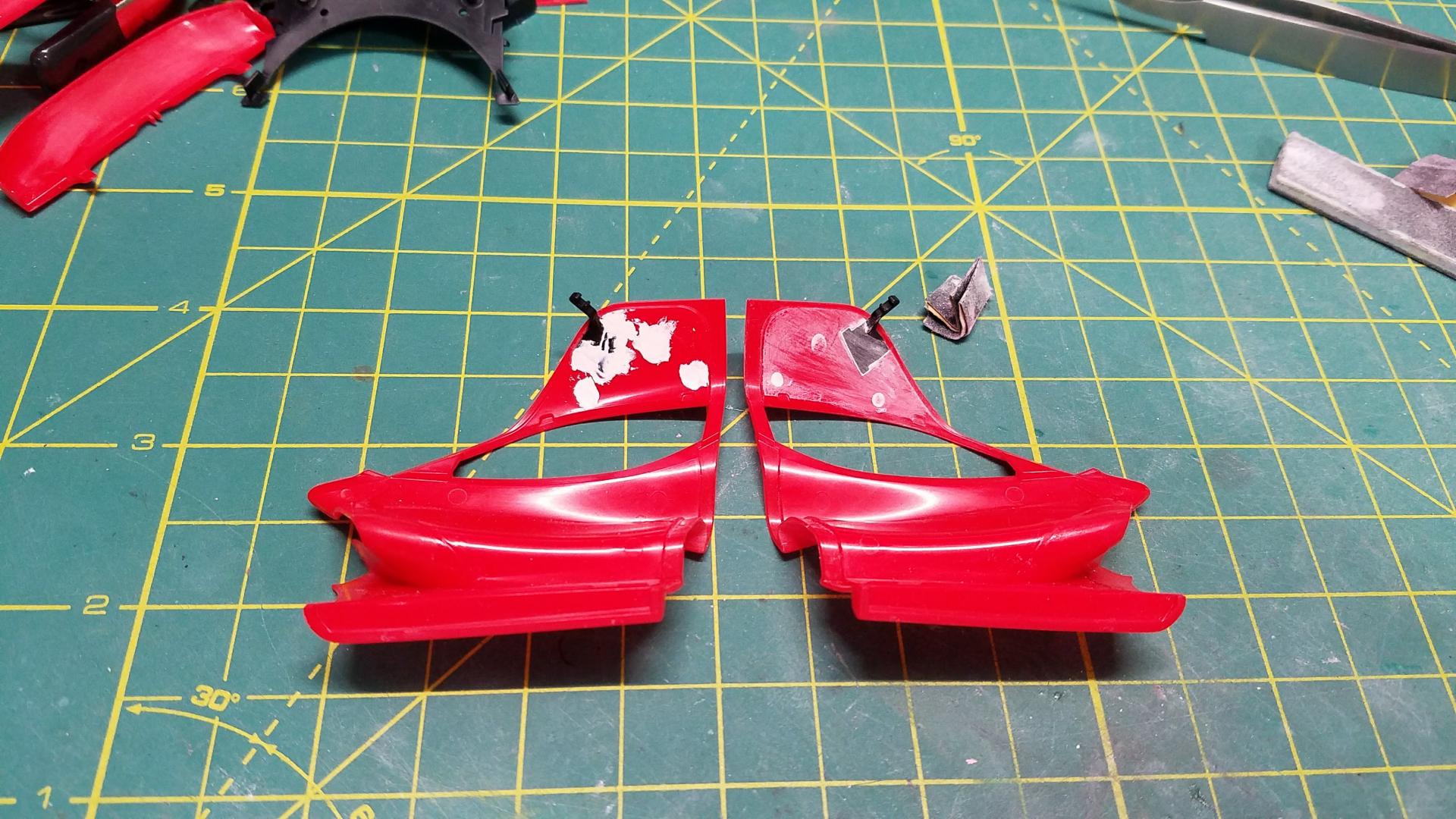

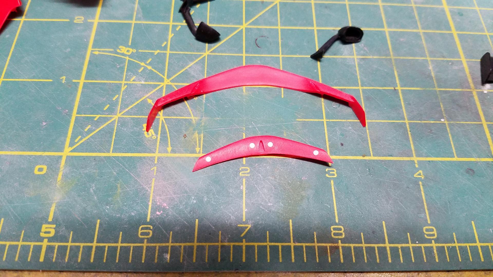

Quick GMC Posted December 27, 2016 Posted December 27, 2016 Not much progress, but I did start by fitting the PE pieces to all the body work and making sure I make all the mods I need to first. not sure how often I'll get to work on it. I do have my new (5th) modeling space mostly set up. Still some work to go, but it's functional. I wanted to keep going on my 29 Ford and 911 GT1, but I don't have the spray booth fully functional and setup. Until I can make the time (with a lot noise) to drill the holes in the wall for the vents, i won't be able to paint. I am in the garage now, due to our new baby due in March taking over the last room of the house where I had everything. Can't paint in the garage without a booth because the vapors go right through the attic and into the house. Pregnant women are incredibly sensitive to odors Anyway, I'll post better pics when it's 100% finished, but here's my new space. now for the model Hobby Design setCenter piece from the kit. Outside pieces are PE. Still need to ass the trim pieces and brackets when ready All these pieces to replace the 1 kit piece

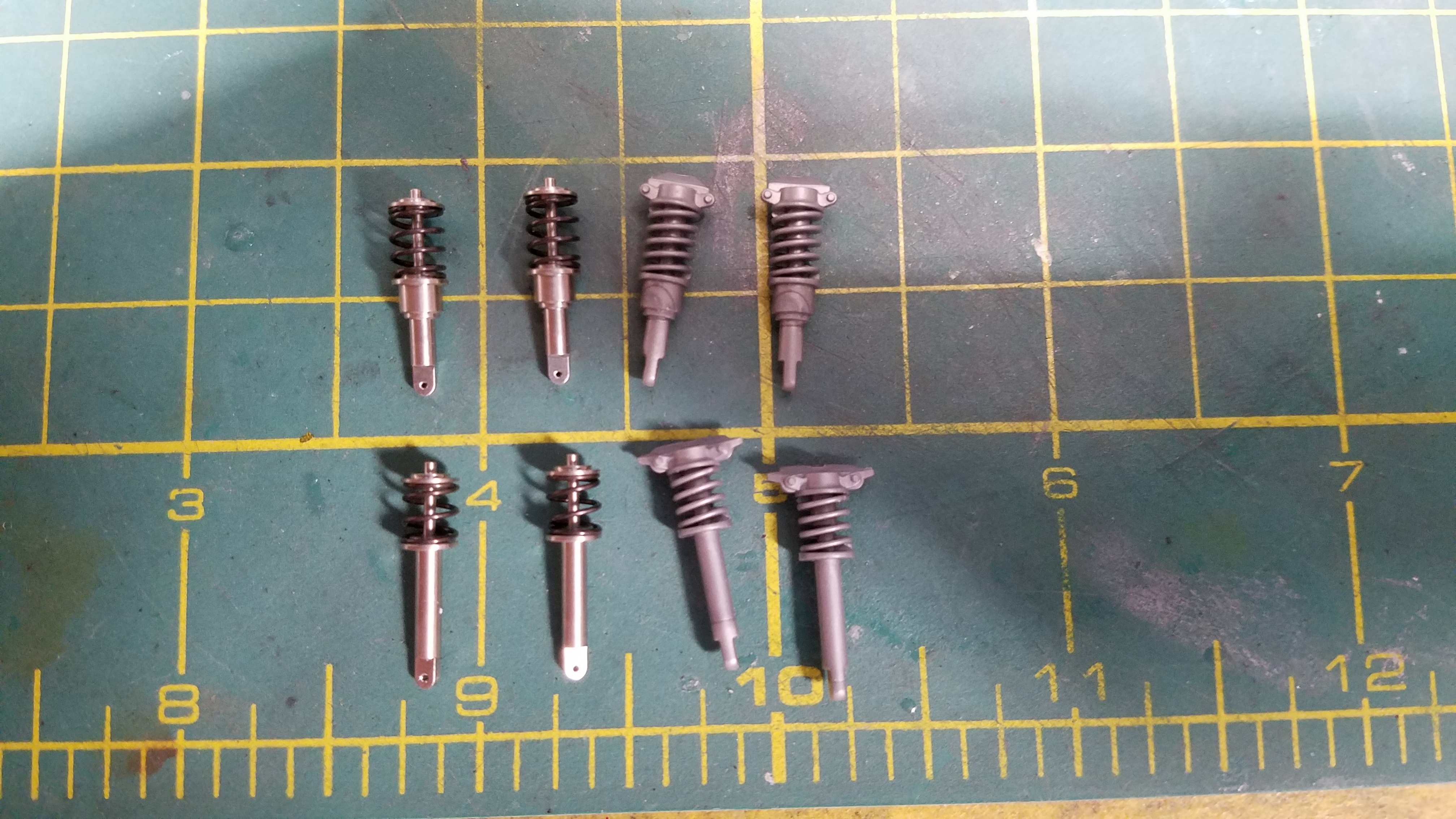

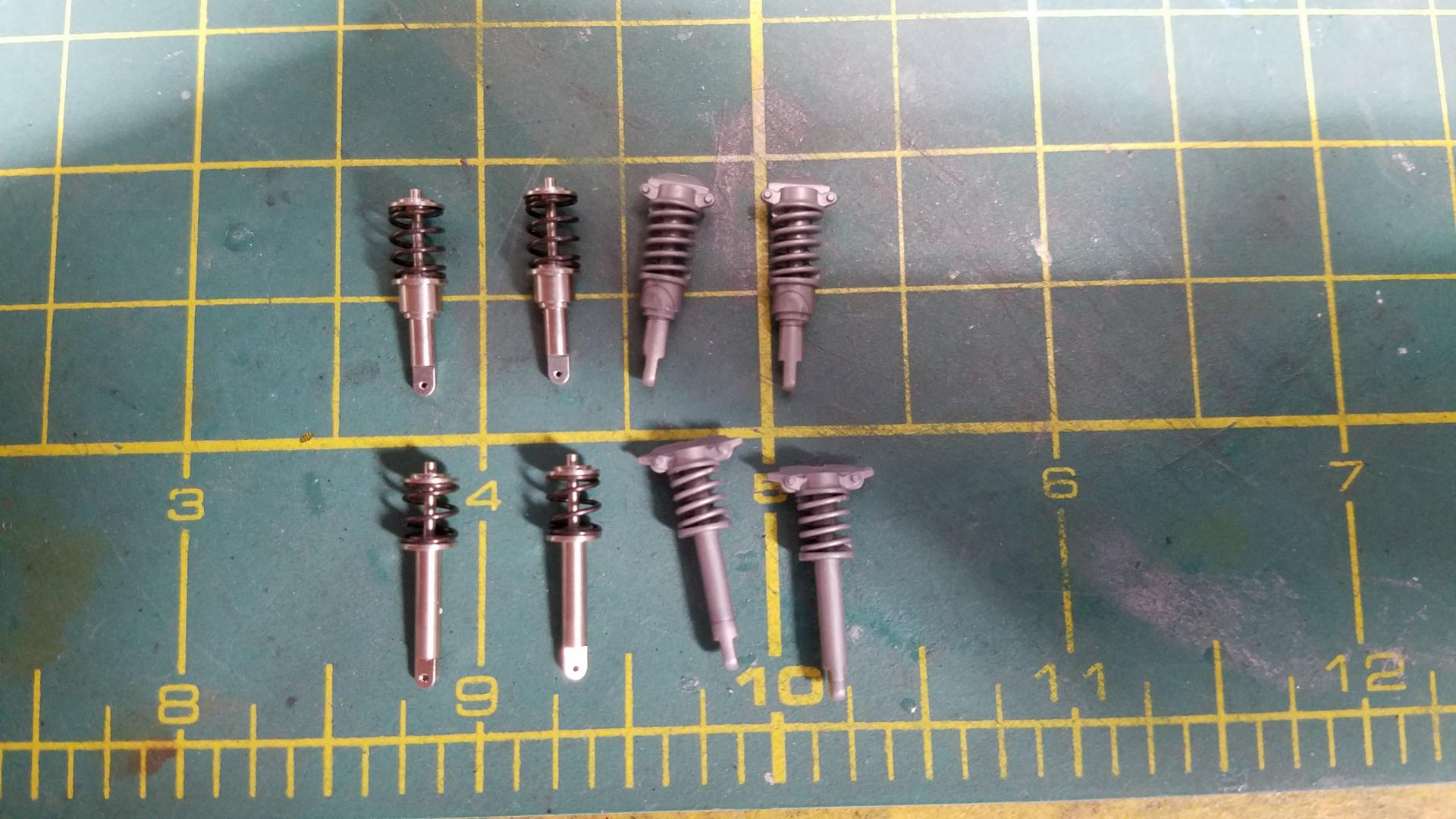

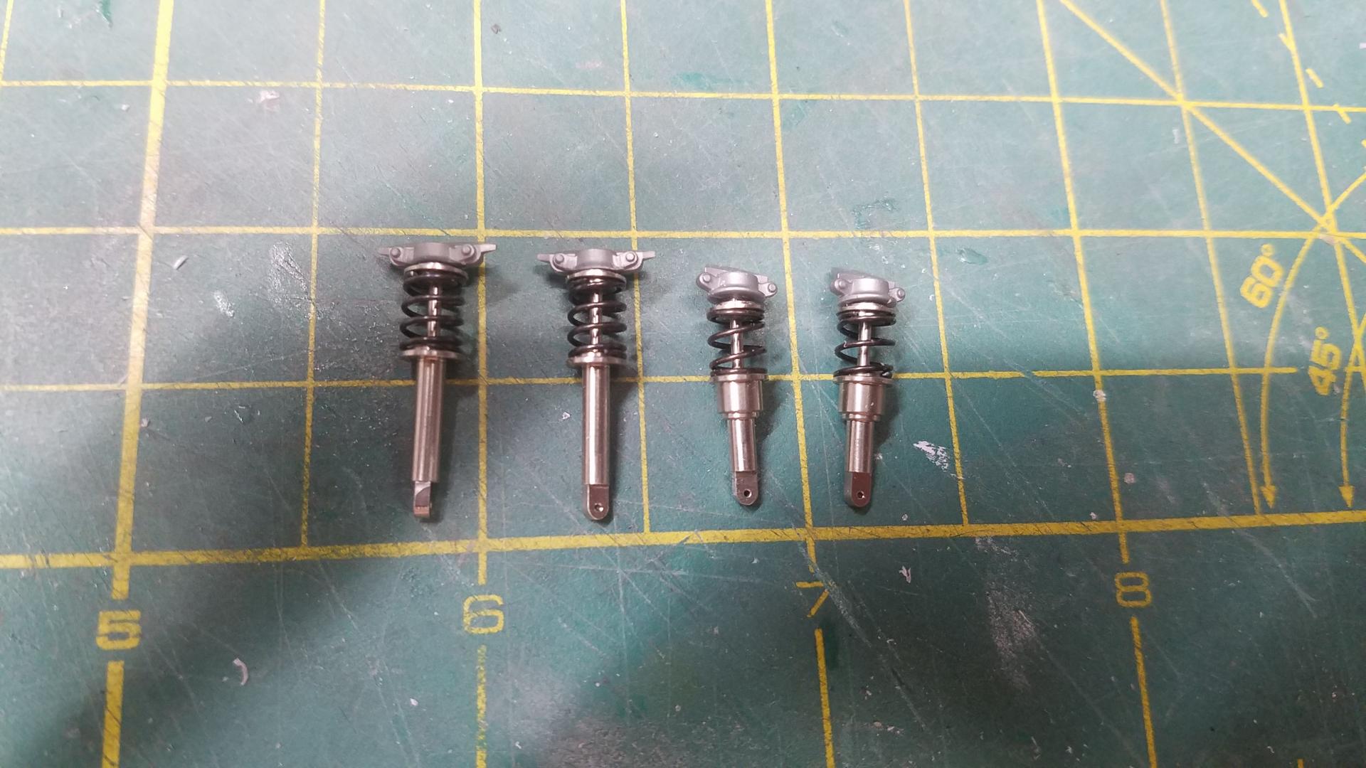

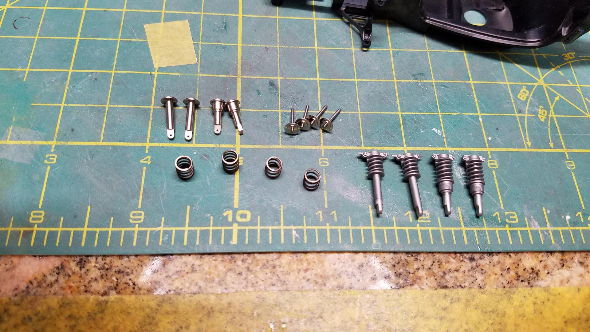

Quick GMC Posted March 22, 2018 Author Posted March 22, 2018 Acu-Stion shock set. It's a shame they won't really be seen when this is done, but I couldn't help myself. Had to chop the tops of the kit shocks off and migrate them to the new ones.

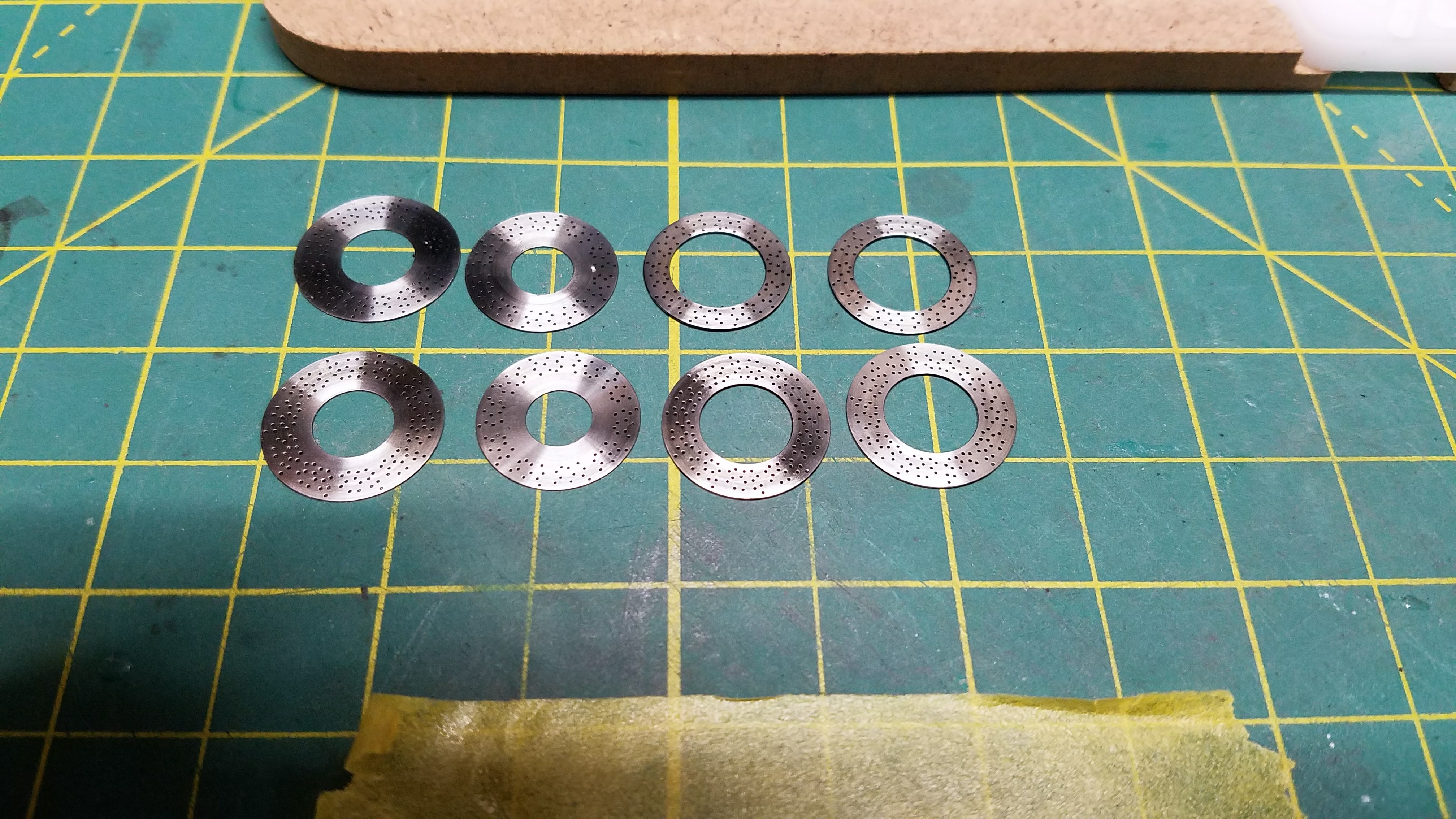

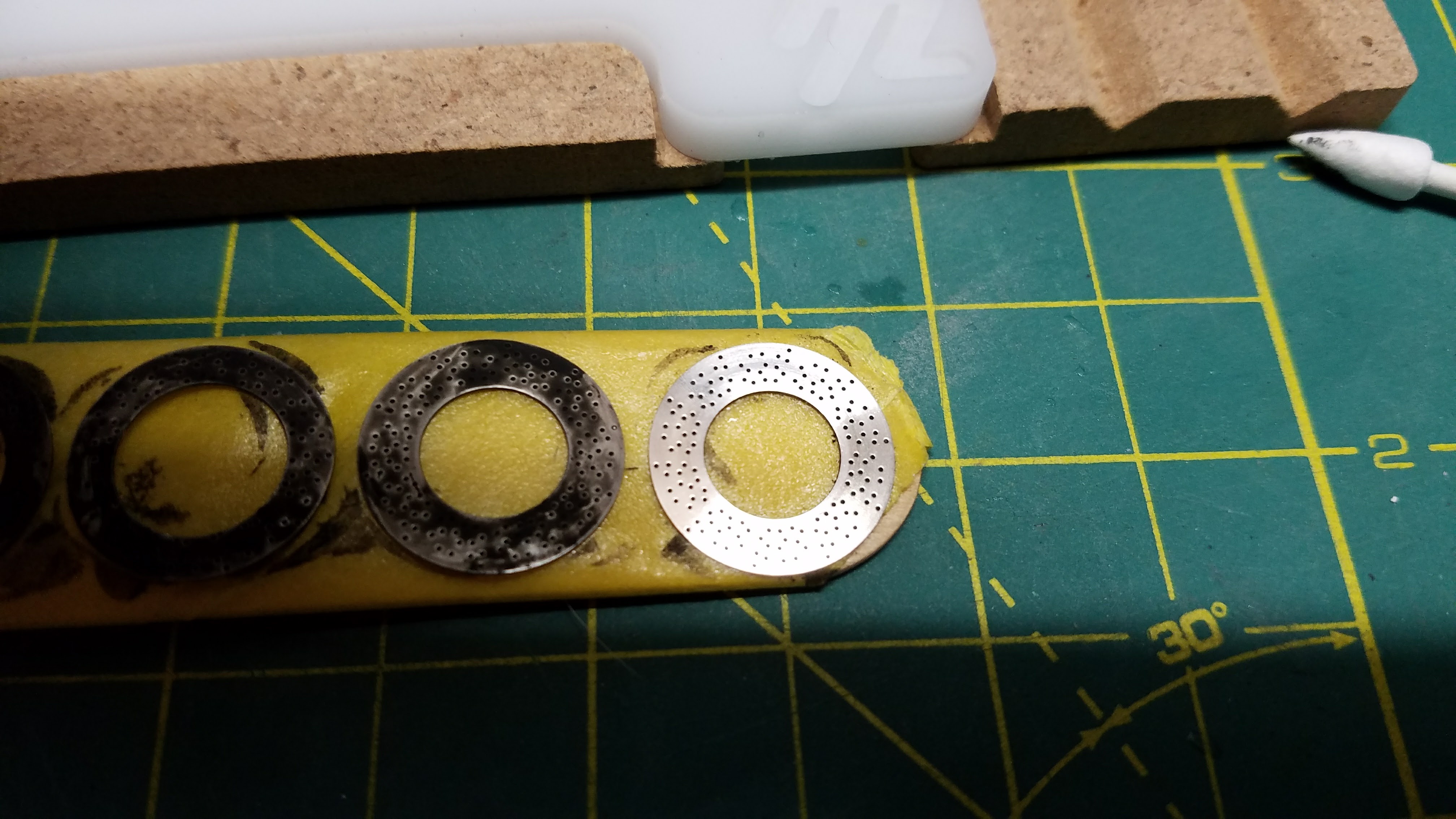

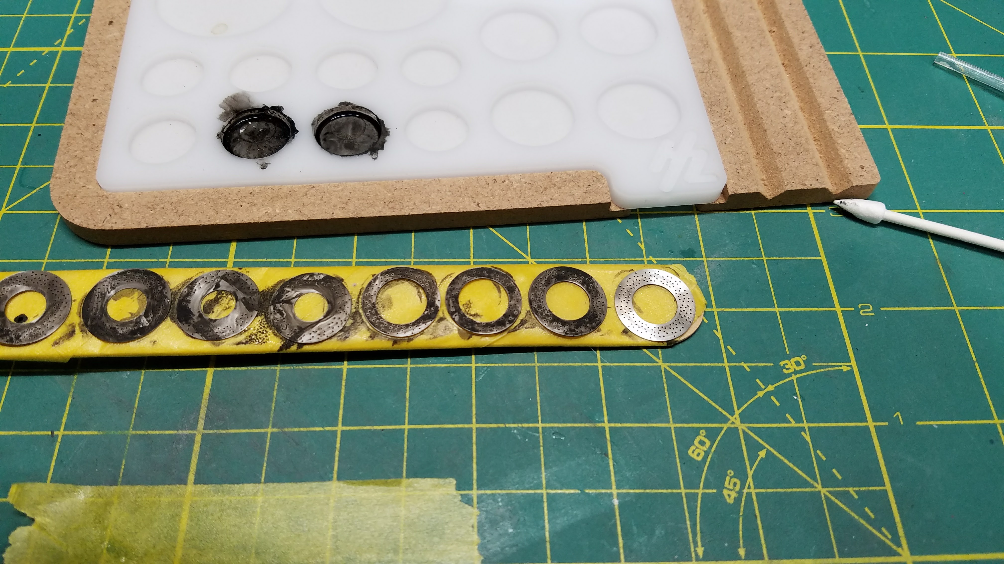

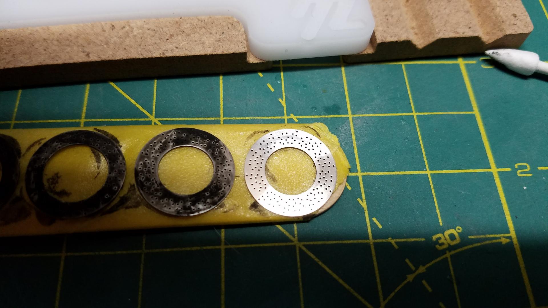

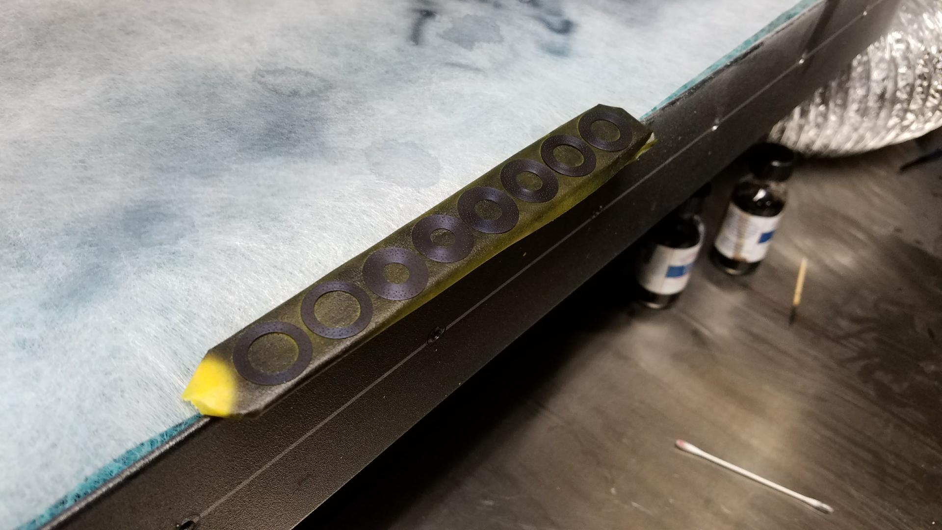

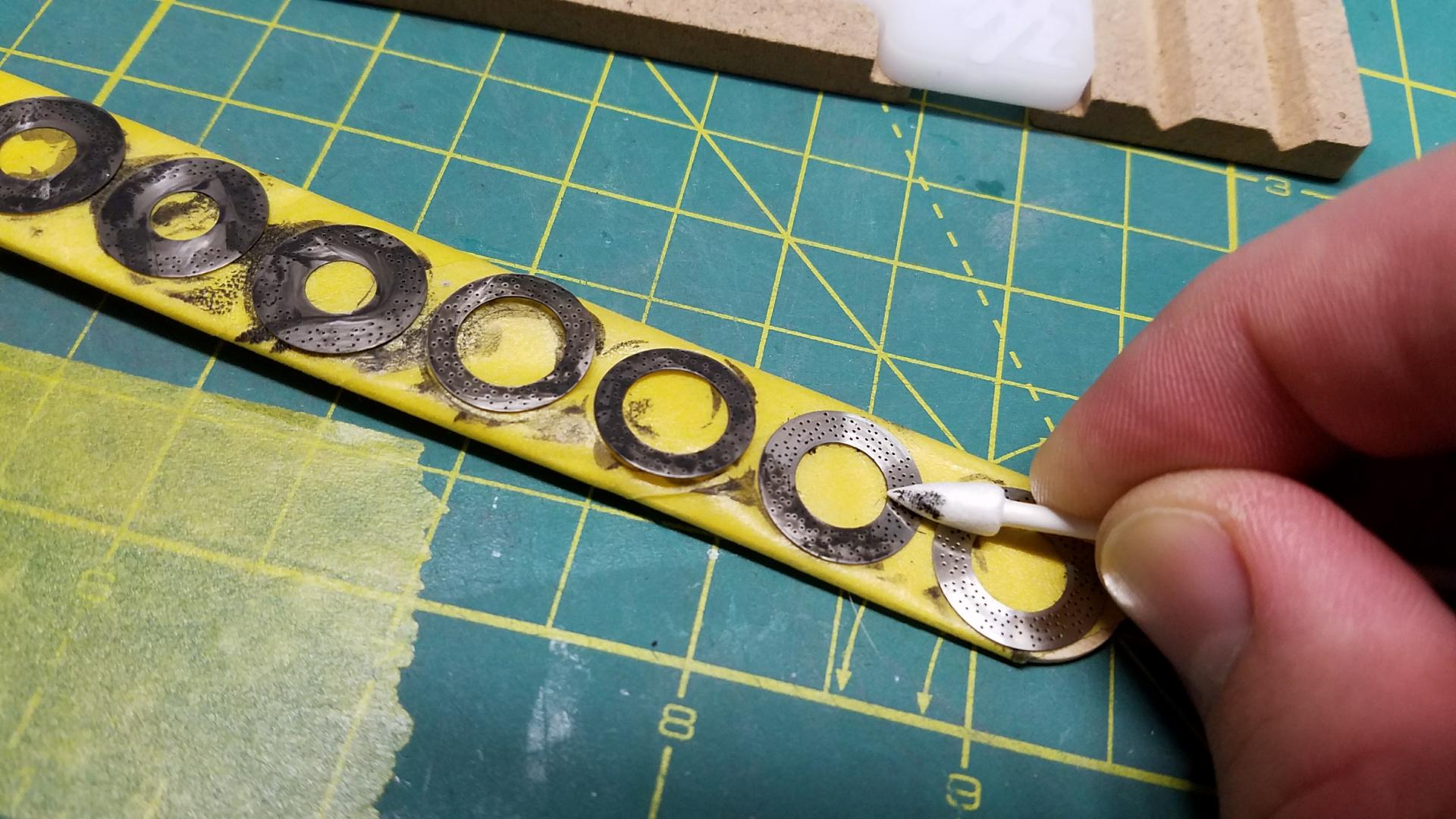

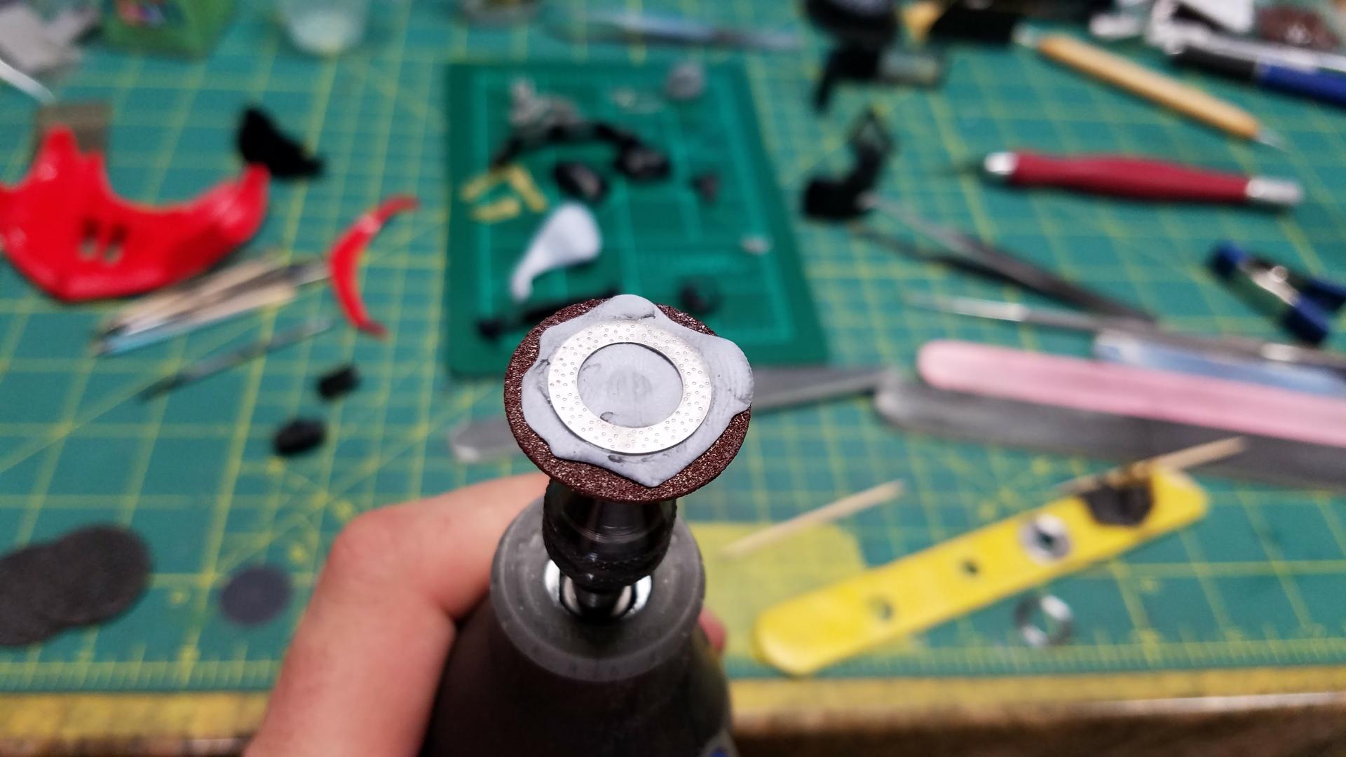

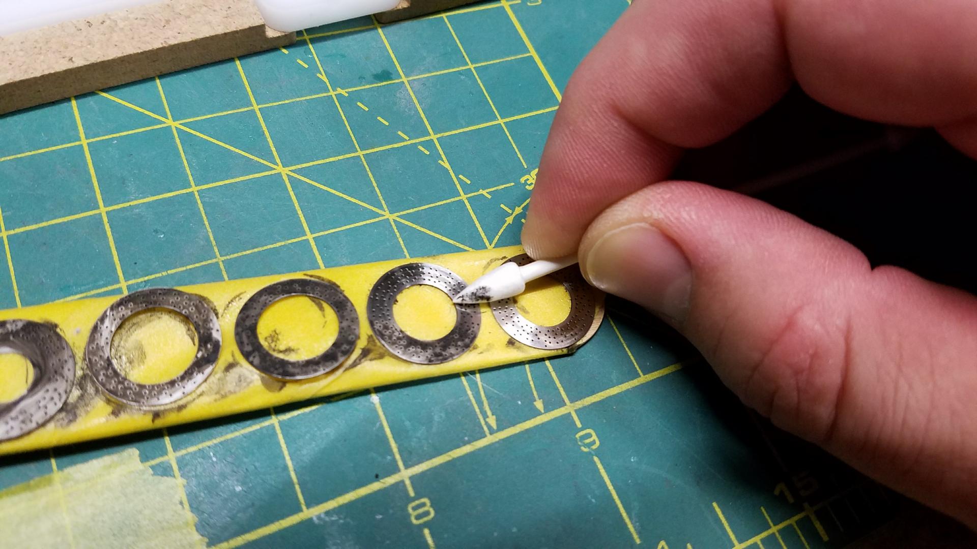

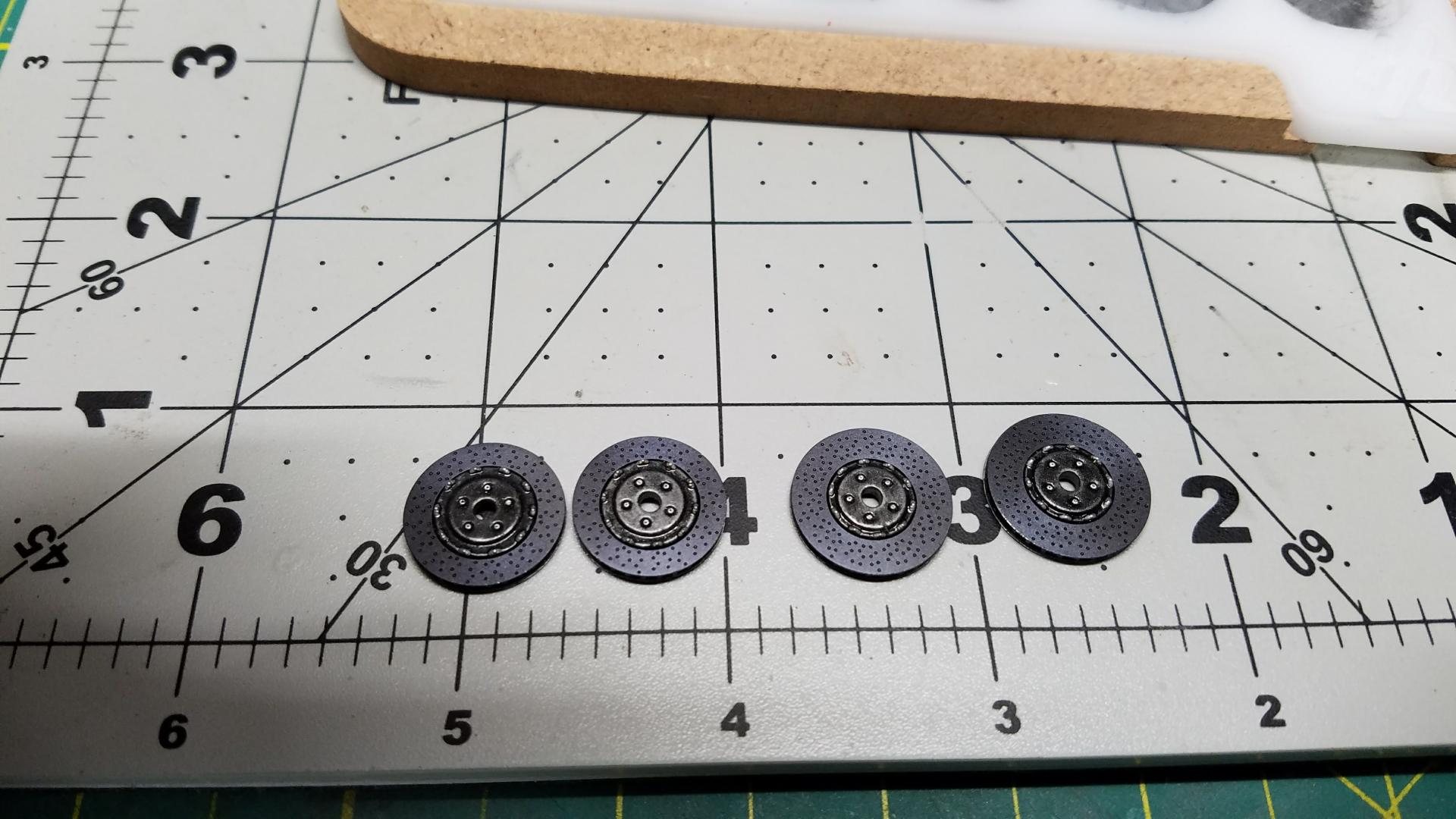

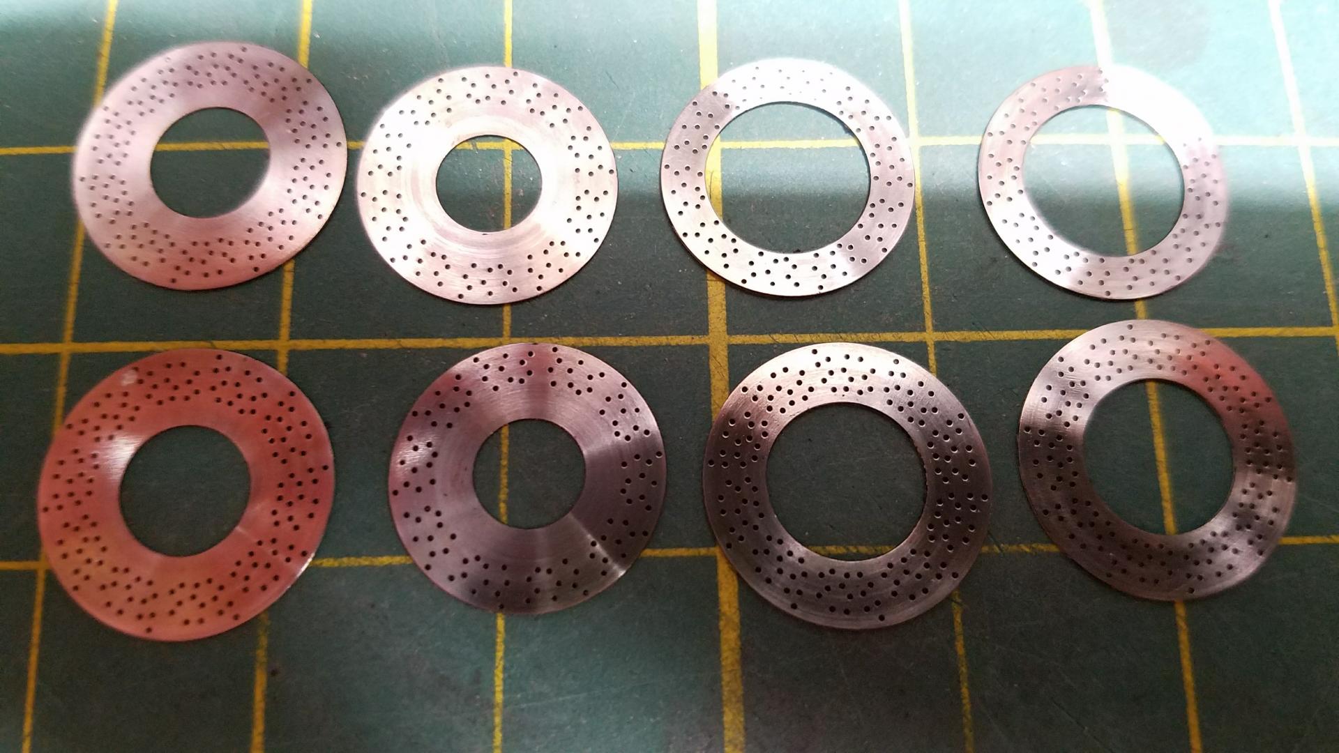

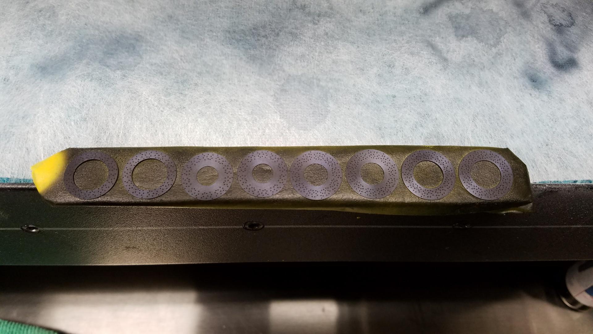

Quick GMC Posted March 22, 2018 Author Posted March 22, 2018 Not sure if I will keep these the way they are, not happy with the hubs. Centered the discs on some putty on a dremel and spun them with some coarse sanding sticks. Then did a black wash, then buffed the rotor faces with a rigid swab. Then did a light coat of Alclad Smoke, enough to get color, but little enough to leave the metallic rotor finish

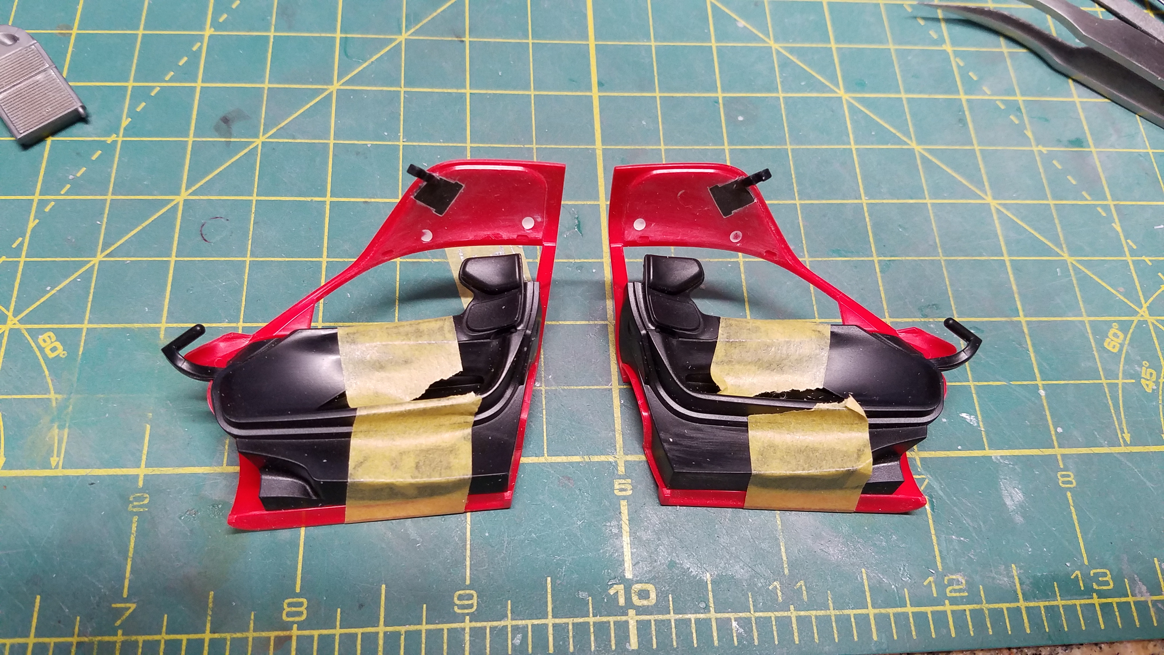

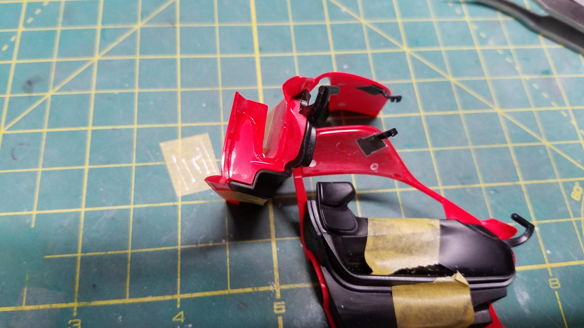

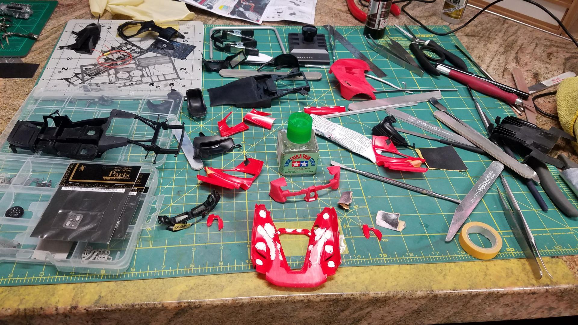

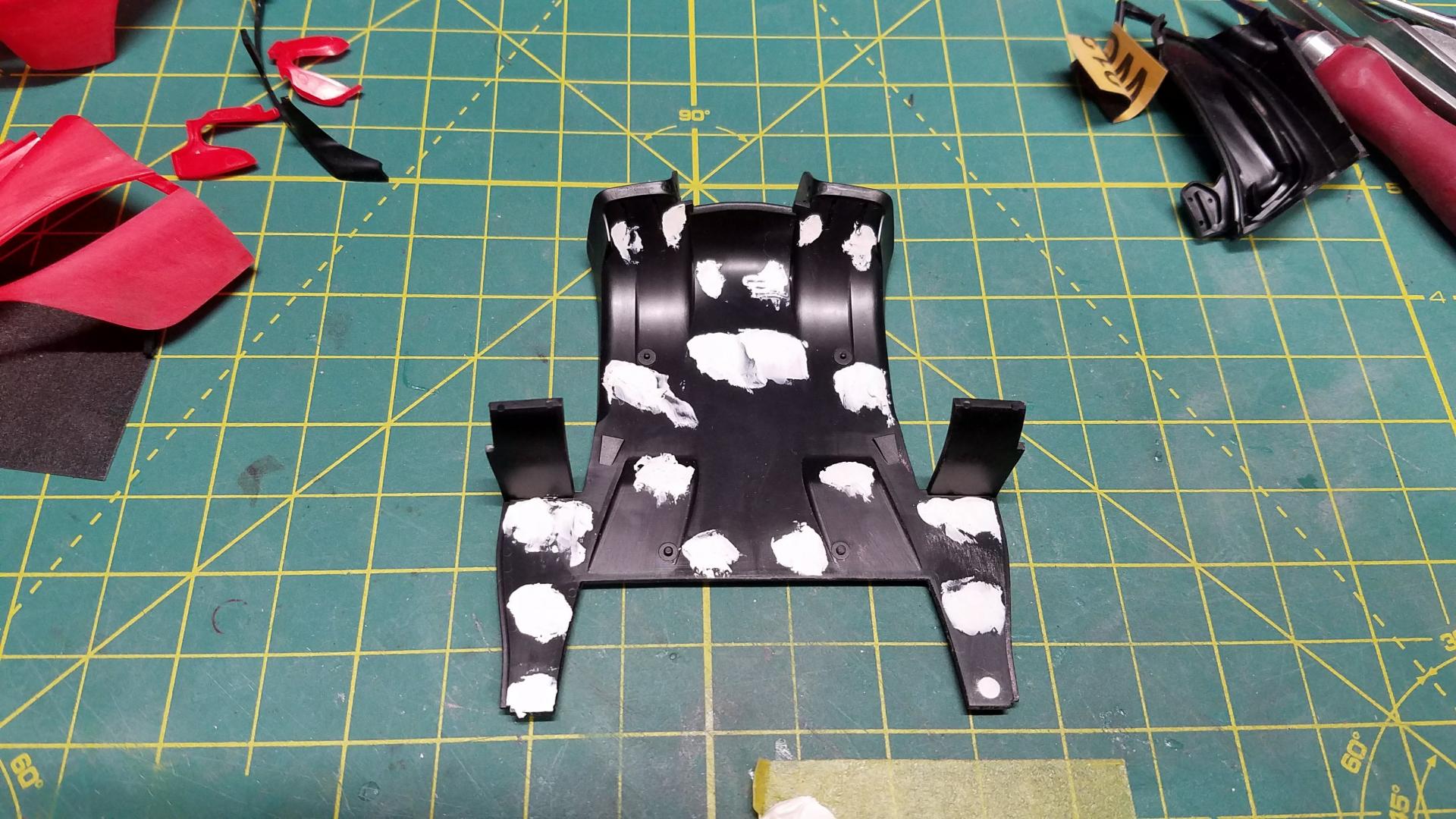

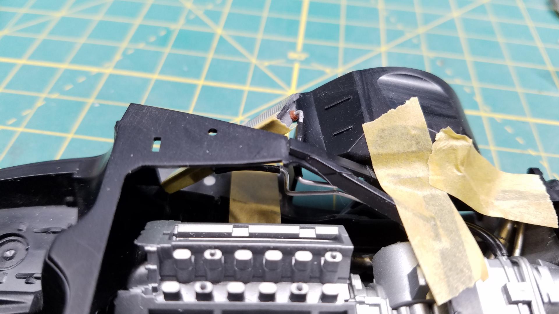

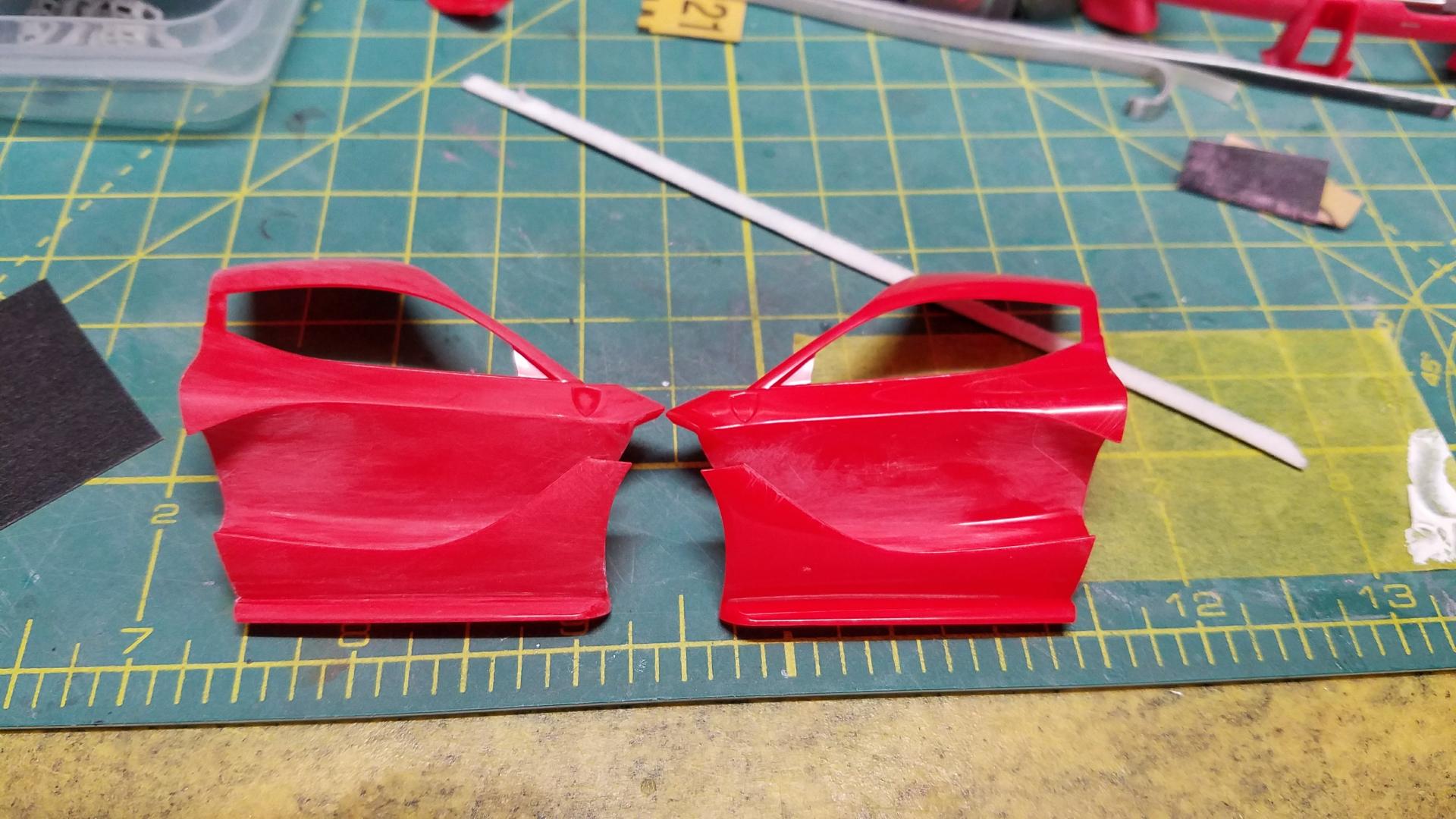

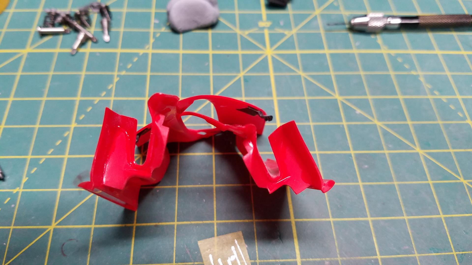

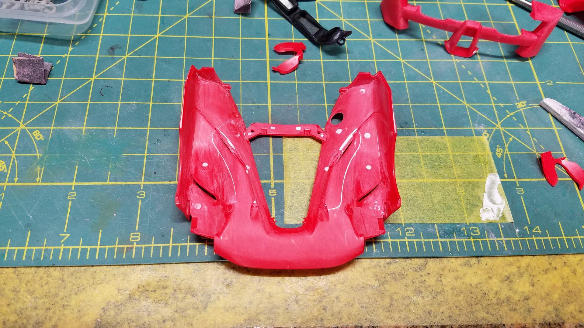

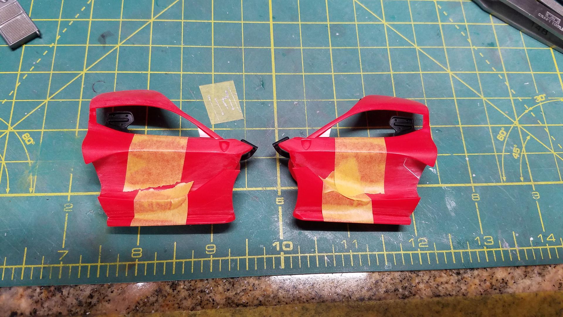

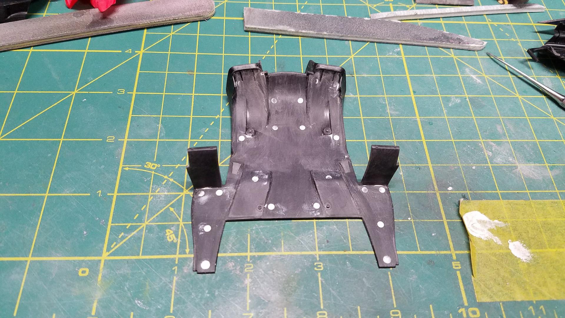

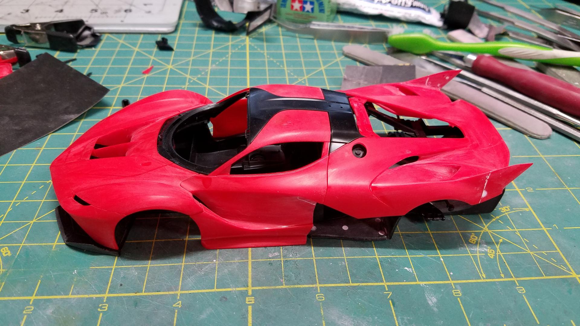

Quick GMC Posted March 22, 2018 Author Posted March 22, 2018 Lots of filling and sanding on the body parts. Lot's of pieces to glue together to make the single panels. Not everything needed to be filled as it all won't be seen when done, but I took the opportunity to practice. the last 4 pics show where i taped up the door panels to the door skins so I could fit the 3rd piece, the end of the door, which is the same color as the body. Then I removed the door panel so it could be painted separately. Finally ready for primer

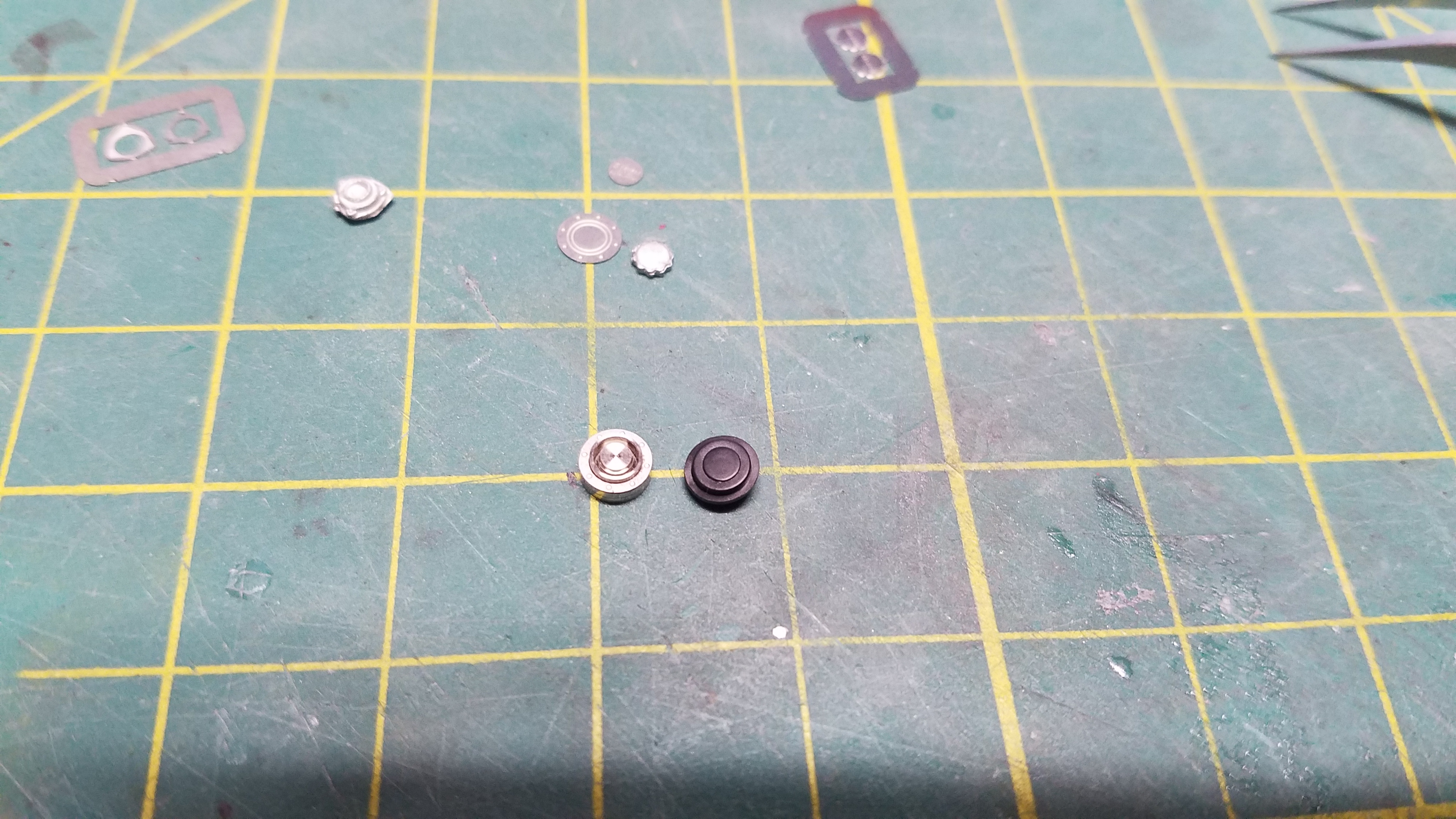

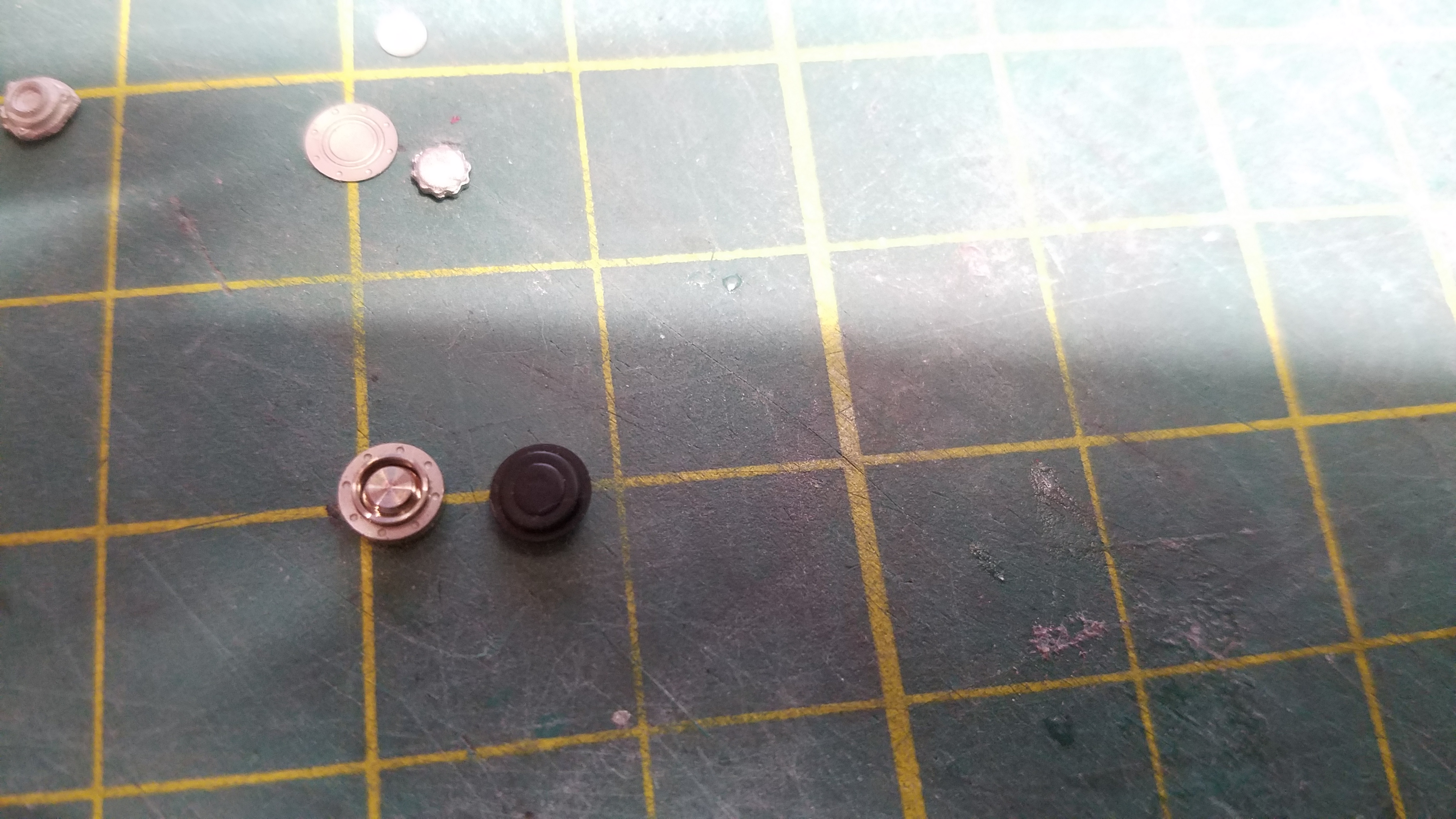

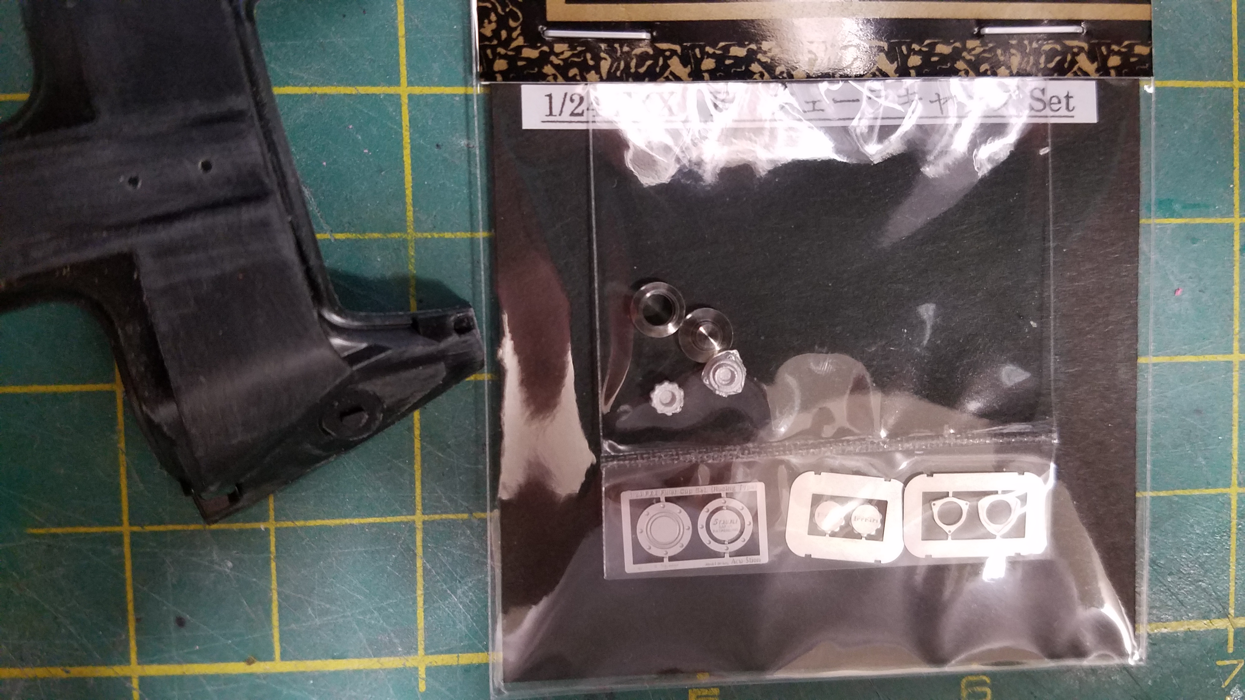

Quick GMC Posted March 22, 2018 Author Posted March 22, 2018 Acu Stion fuel filler set. Still not 100% clear how it goes together, no instructions, but I think I got it. Shown next to the kit piece
Jhedir6 Posted March 22, 2018 Posted March 22, 2018 (edited) WoW. Awesome. I like the discs man, I think they look like ceramic discs. The detail sets are looking good. Looking forward to more. Edited March 22, 2018 by Jhedir6

Funkychiken Posted March 24, 2018 Posted March 24, 2018 Excellent progress and thanks for sharing the details! What filler and sanding stick brands do you use please? All your PE work looks awesome, are you using superglue, if so, what brand? Cheers!

Quick GMC Posted March 26, 2018 Author Posted March 26, 2018 On 3/24/2018 at 5:03 AM, Funkychiken said: Excellent progress and thanks for sharing the details! What filler and sanding stick brands do you use please? All your PE work looks awesome, are you using superglue, if so, what brand? Cheers! Just the Tamiya white filler putty in the tube. The sanding sticks are from several places. Some are Flexi File which I really do not care for. They sand fine, but fall apart. My favorites, I think I used to get from Hobby Linc: https://www.hobbylinc.com/cgi-bin/pic.cgi?t=pics_user_gallery&item_i=79381&pic_user_i=124612&pic_pic_i=12185 And my other favorite are the fat oners with one side with 2 rough grits and the other side with 2 polishing grits. They come as a gift from Scale Hardware, but I haven't bought from them since they changed hands, so not sure if they still offer them

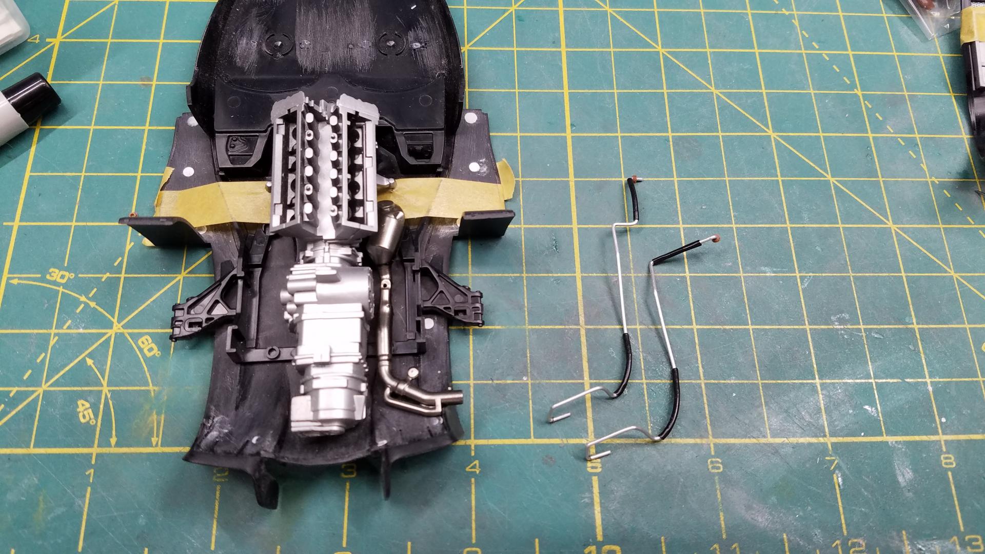

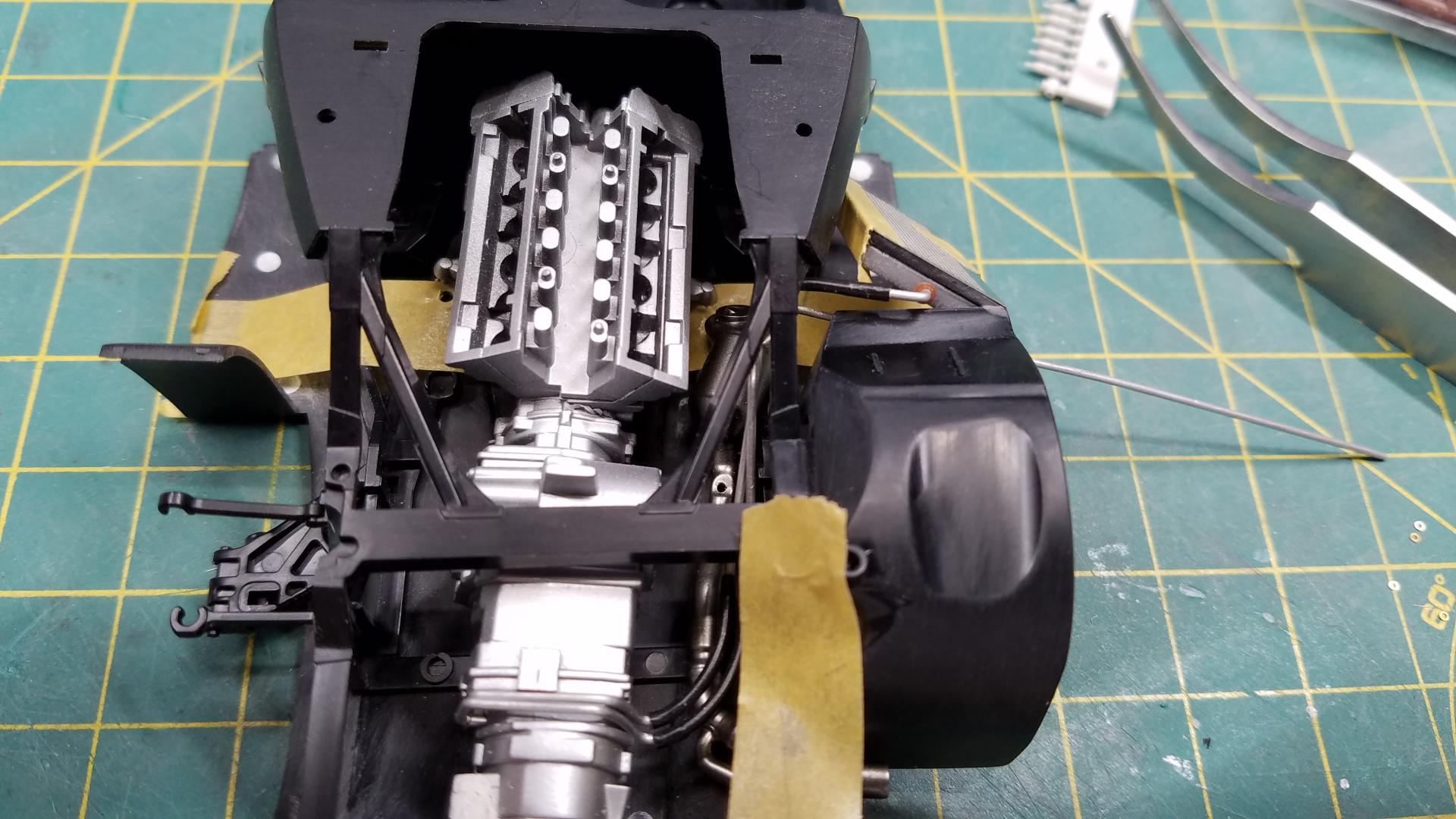

Quick GMC Posted March 26, 2018 Author Posted March 26, 2018 I copied some ideas from Randy Ditton, I even ordered the same fittings from the Train store. I realize how much work he put into his details and I won't be getting that crazy, but some extra detail that will be seen when the model is finished will be nice. I started with these cooler lines that go up and over the back of the tranny and into the R/H cooler. I have to add hose clamps now, which have always been a nightmare for me.
