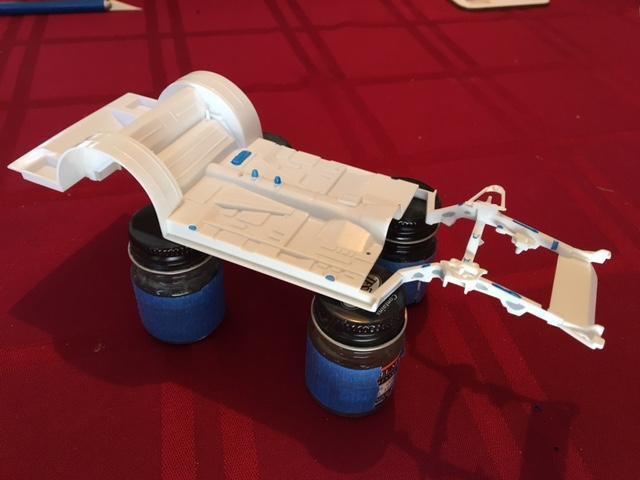

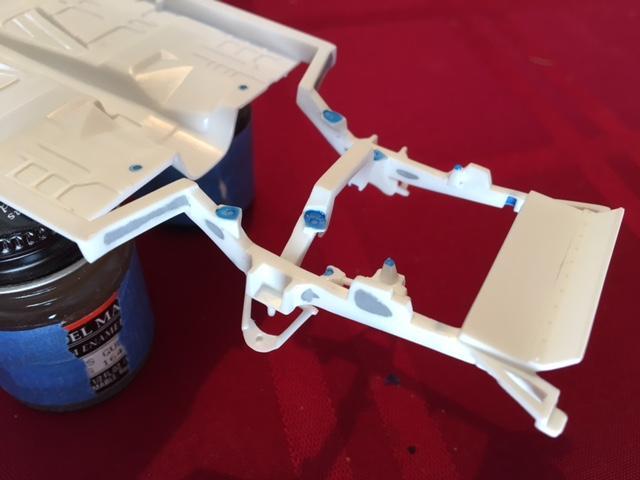

Goodwrench3 Posted January 1, 2017 Author Share Posted January 1, 2017 This is the next chassis i'm getting ready to paint. You can see the filler work I had to do to fill in the ditches, dents, holes, valleys, pin marks, etc. So are guys spraying the Tamiya primer and then actually sanding it on a piece like this with all that detail and the recesses etc. ?? Thanks Quote Link to comment Share on other sites More sharing options...
drsnapper55 Posted January 1, 2017 Share Posted January 1, 2017 I'm not much of an expert, but I certainly don't sand down something like you have pictured unless I'm sanding some easy, open flat areas or where I have filled with putty, etc. One thing that might help on something like the part above is more than likely you have handled it quite a bit in your prep which leaves oils all over it - not good for paint to stick too. Before painting the primer, wash it down good with some spray cleaner (like Purple Power) and a brush (like an old toothbrush). In fact, I do this with all my parts before painting them. Dry it out really good after. I like to make sure my paint in the can is at a decent temp too and mixed very well. I try not too push if it it seems too cold. I also spray just a little out first before it hits the part just to make sure it gets a good flow. As far as the finishing coat, I'm trying to practice more with just barely sanding the primer in order to get a smoother finish coat. Hope this helps you out some. Quote Link to comment Share on other sites More sharing options...

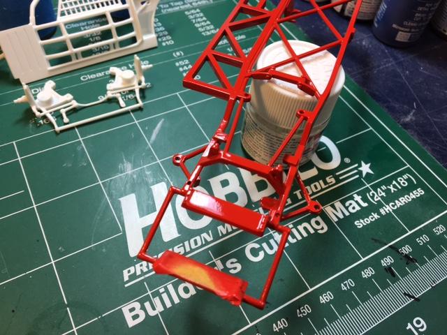

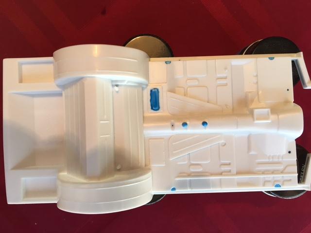

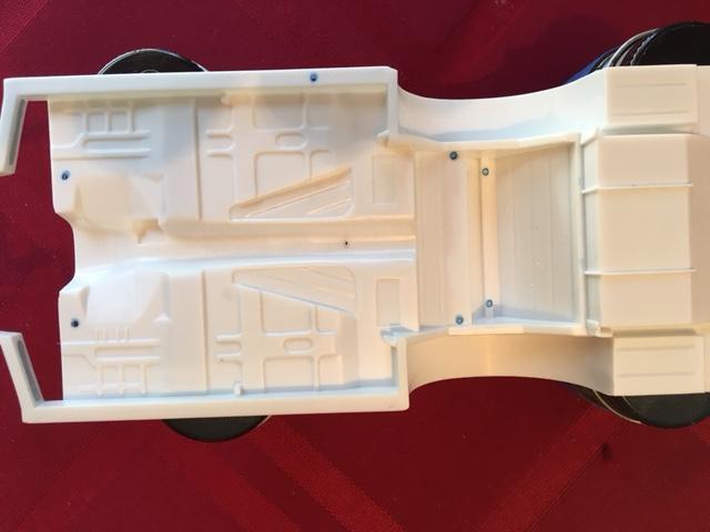

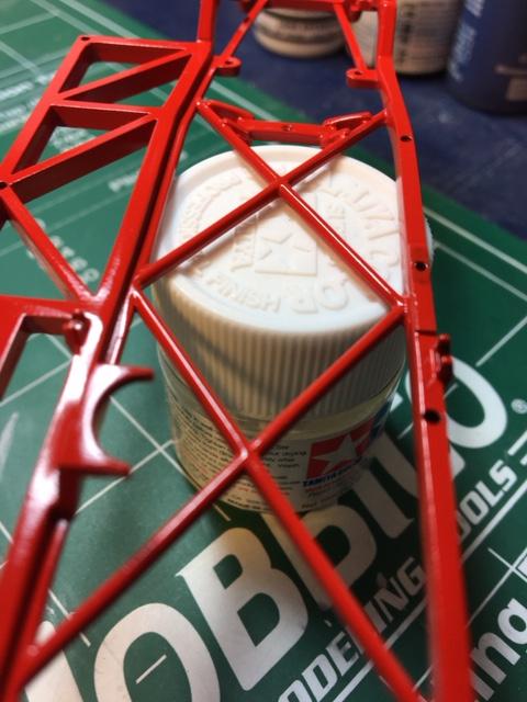

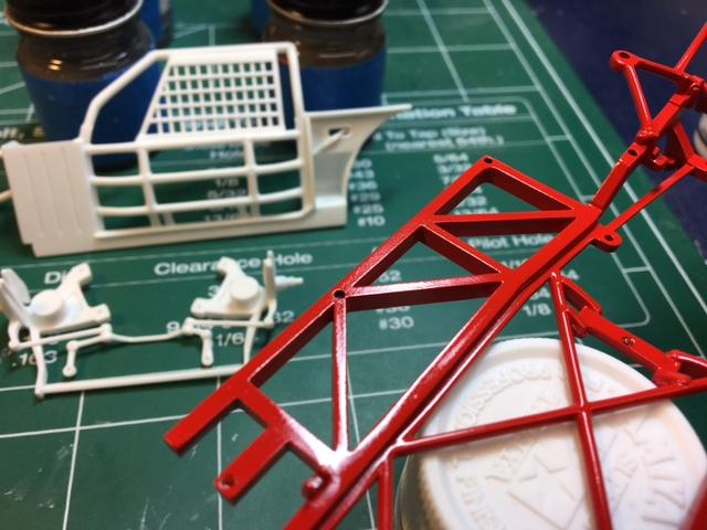

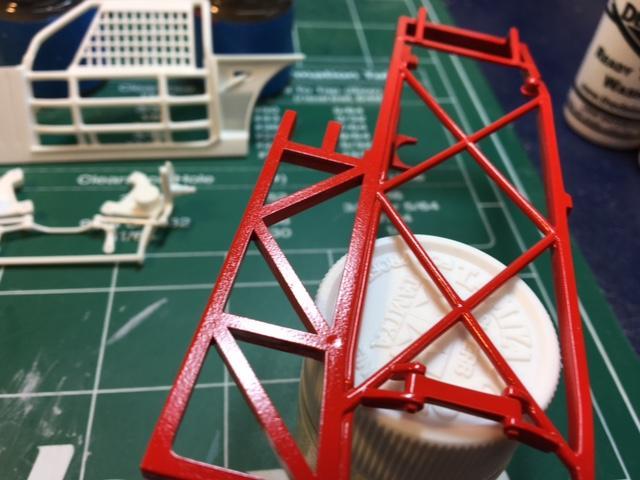

Goodwrench3 Posted January 3, 2017 Author Share Posted January 3, 2017 Here are some pics of the chassis I was referring to. Note in the first pic on the left side, you can see the "pebbly" finish reflected in the light that I was referring to. In the second photo the round cross member bars look like they have a pretty decent smooth finish. In the third photo, you can see the "pebbled" finish better in the light along that leftmost frame rail. In the last photo, you can see that the front end area has a pretty decent finish too. Thanks for your help. Quote Link to comment Share on other sites More sharing options...
935k3 Posted January 3, 2017 Share Posted January 3, 2017 There is actually a way to smooth out primer on chassis with allot of detail. I run into this problem with rally cars I build. I use a toothbrush and Soft Scrub cleaner. You could use something like COMET. make sure it is rinsed thoroughly under running water. Quote Link to comment Share on other sites More sharing options...
Jim N Posted January 16, 2017 Share Posted January 16, 2017 What you might have with the pebbly finish is orange peel. I get that kind of finish when I am spraying too far away from the part. I think it can sometimes happen when one applies an additional coat of paint before the prior coat has fully set up. You can use 600 or 1000 grit sand paper and wet sand the areas to knock down the high spots. You want to work slowly because the only thing you want to do is smooth the finish and not burn through to the primer. The way I tell if I have smoothed the finish, is to run my finger over the sanded area. If it feels smooth, I move on to the next area. Quote Link to comment Share on other sites More sharing options...
