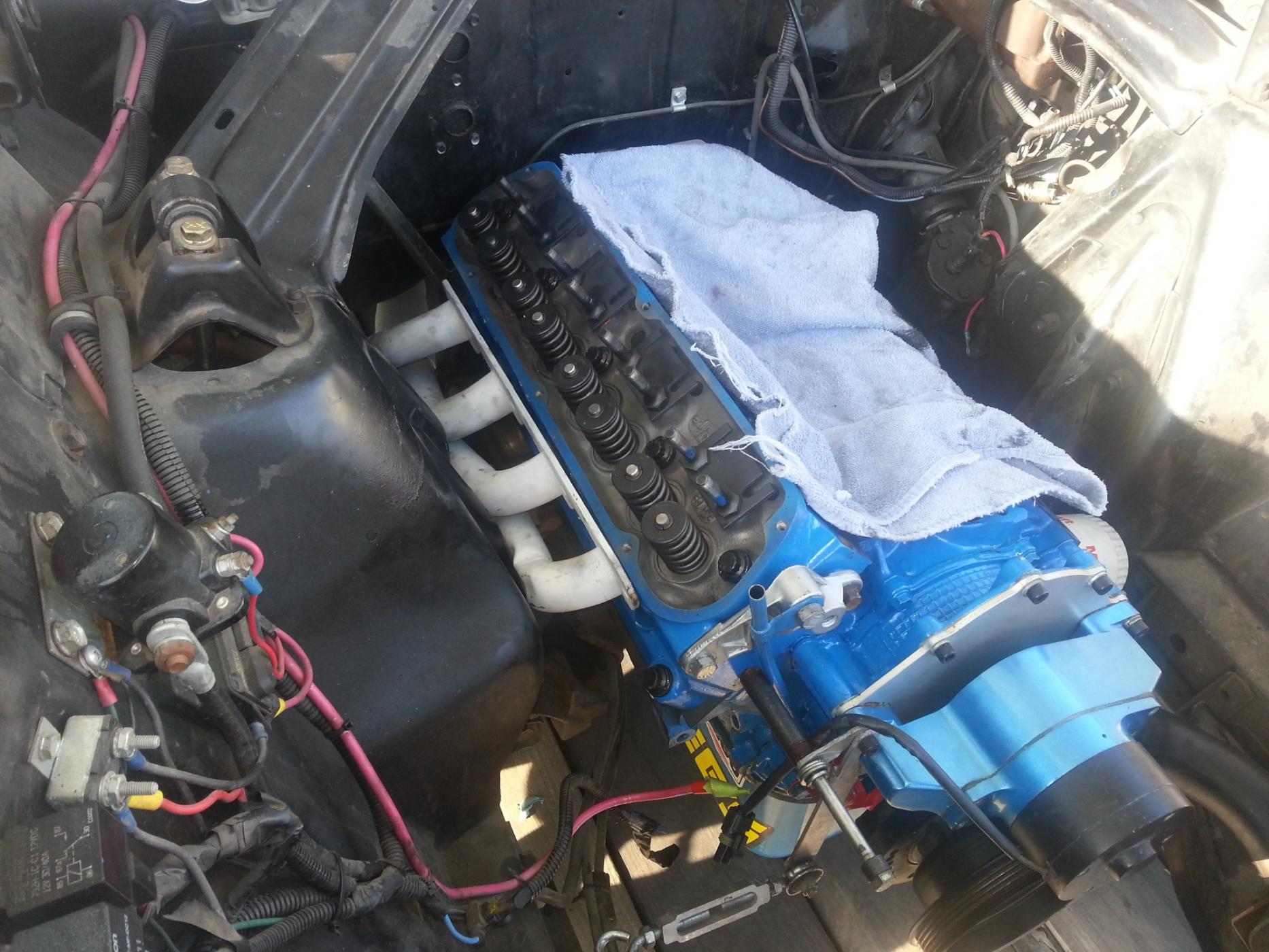

Reeves Racing Posted January 4, 2017 Author Posted January 4, 2017 Thanks for moving this. Thanks so much guys!, Here are some more pictures. Some of the body work sanded and a resin hood I found in the parts box that I am going to use on one of the other Comet Cyclone kits I bought. The mock up of the engine with the intake and distributor. I am going to have a tight fit with the headers (just like the real car) after putting in the stock spring towers. Here are some custom decals I had printed and a couple more of the real car. I got them from Thomas at Speedway Decals (his email is speedwaydecals@yahoo)
espo Posted January 4, 2017 Posted January 4, 2017 I really like the switch to a sedan with the B pillar. Great back ground story on this build. Since I just picked up this model to build I'll watch your build also. I also noticed the lower A arms looked a little off as you mentioned.
Ron Hamilton Posted January 4, 2017 Posted January 4, 2017 Mitch,I am so happy for you that you are finally going to build a replica of your '65. I knew I was not going crazy when I mocked up my '65 build, and it had the stance of a race car. You hit it right on the head, It is an AFX chassis, and not a Factory Stock '65 Comet Chassis. I am not as familiar with the car as you are, so I have to cheat the ride height by adjusting the spindles in the front end, and making up lowering blocks for the rear. Can I make one small suggestion? I am looking at the side window profile you are doing. From the pictures, you did a pie cut on the "c" pillars to represent the side windows for the post sedan. To me, the roof still looks too upright. The Comet roof had quite a bit more slant than the Fairlane roof. If I were doing it, I would have worked it from the side window, then the pillars. At this point, you do not have to do any more major work, just make it about 1/8" shorter, and lean the back window forward some more. That would get it closer to what the real one looks like.The other work you are doing is fantastic. I love the intake manifold and the chassis mods you are doing.I love this one!!!!!

Reeves Racing Posted January 5, 2017 Author Posted January 5, 2017 (edited) Well, that's a shame. I guess we won't be seeing an accurate stock version after all. Saves me some bucks, at least, but I really wanted to use that chassis for some other builds. I like what you're doing with it, Mitch! What kit did you use the shock towers from? I used the towers from the AMT 69 Falcon modified stocker kit I looked at the pictures of the upcoming kit of the AFX version that Moebius is releasing and the inner fender aprons are completely a different part. The spring towers on the AFX car are completely eliminated to make room for the supper wide cammer engine and the tops of the springs are held by cup brackets located outside of the engine compartment between the fender and the apron. So this makes it EVEN more frustrating that Moebius copied the AMT Fairlane fender aprons and spring towers instead of making the correct Comet towers that are tapered toward the top. The kit also does not have the welded in place shock tower braces but only a very skinny Mustang-esque bolt on export brace that was a dealer option not a factory option... The engine compartment of the Comets and Falcons of this vintage may look very much like a Mustang but they are narrower by 1 1/2 inches which is why you can't use 65 Mustang SBF headers on a 65 Comet or Falcon. Unless you beat the hell out of them and the fender apron that is... Edited January 5, 2017 by Reeves Racing
espo Posted January 5, 2017 Posted January 5, 2017 Wow . You can really see how banged up the #2 cylinder header is. I see you used a turn buckle on the motor mount. I like how you're fixing the top on this build.
