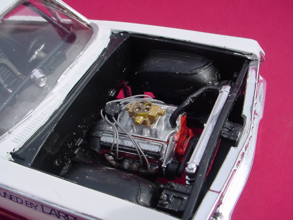

Reeves Racing Posted February 10, 2017 Author Posted February 10, 2017 (edited) Thanks Tom. I tried several sets of headers and much like the real car none would clear the spring towers. So I used some solder and I'm making my own. This solder is the perfect size for the primaries and is super soft. I super glued the ends where the collector goes and drilled a hole in the middle of the four pipes and glued a rod in the middle and then a bigger piece of tube stock. Then I put on some shrink tube, shrank it and then put on another layer of shrink tube to make the collector.I will use some more tube stock to make the turn downs. I took the carb back off because I have ordered a Detail Master carburetor PE linkage and bracket set. I am going try another first for me and use the tungsten filament from an 1157 bulb as the throttle return spring. I also added some nuts to the coil overs and detail painted the rearend. I had two different springs rates on the back of the car hence the silver and dark blue springs. The steering wheel is installed. Edited February 17, 2017 by Reeves Racing
Reeves Racing Posted February 13, 2017 Author Posted February 13, 2017 (edited) I did some more over the weekend. BMF, windows, tachometer, wiring and starter solenoid, master cylinder and proportioning valve, fuel pressure regulator and gauge, checked length of fuel line to carb. I'm waiting on some PE carb linkage before I mount the carb permanently. I made the support braces and test fitted them to see if there was enough clearance, added fuel pump and filter, 1/2" copper fuel line, and the hardware for the fuel cell mounts. Replaced the steering wheel with one that looked better, mounted body, mounted rear end, mounted radiator, electric fan, radiator supports, made radiator hoses, mounted alternator and charge wire, added tie down chain and hardware. Edited February 13, 2017 by Reeves Racing

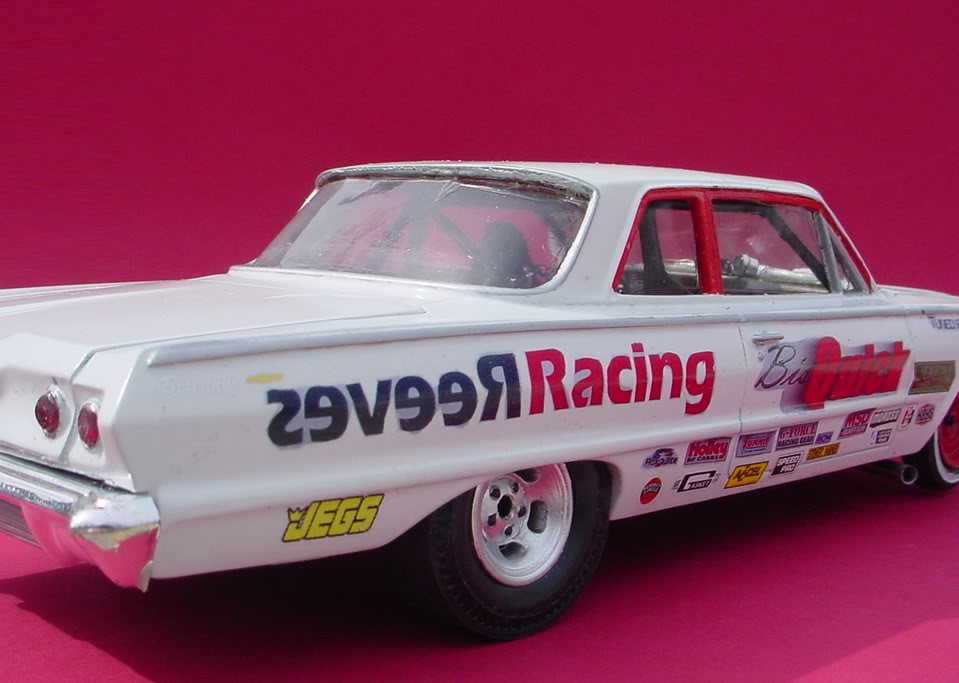

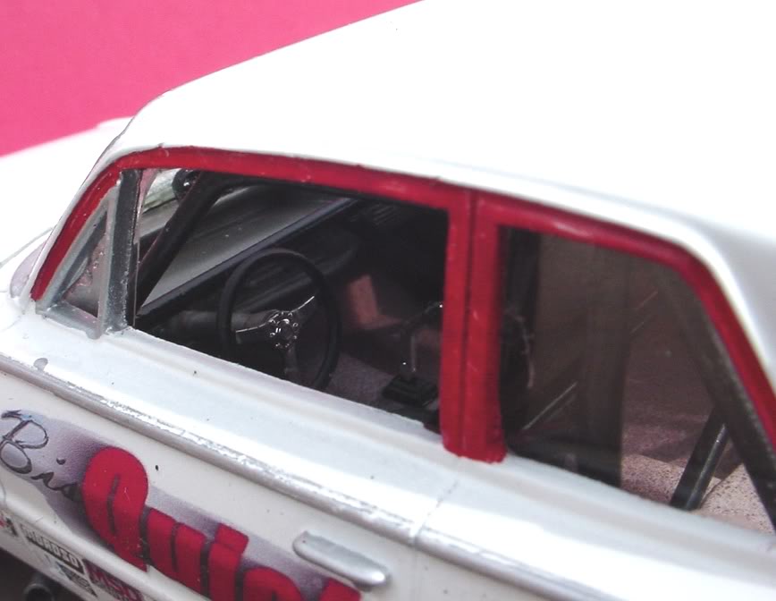

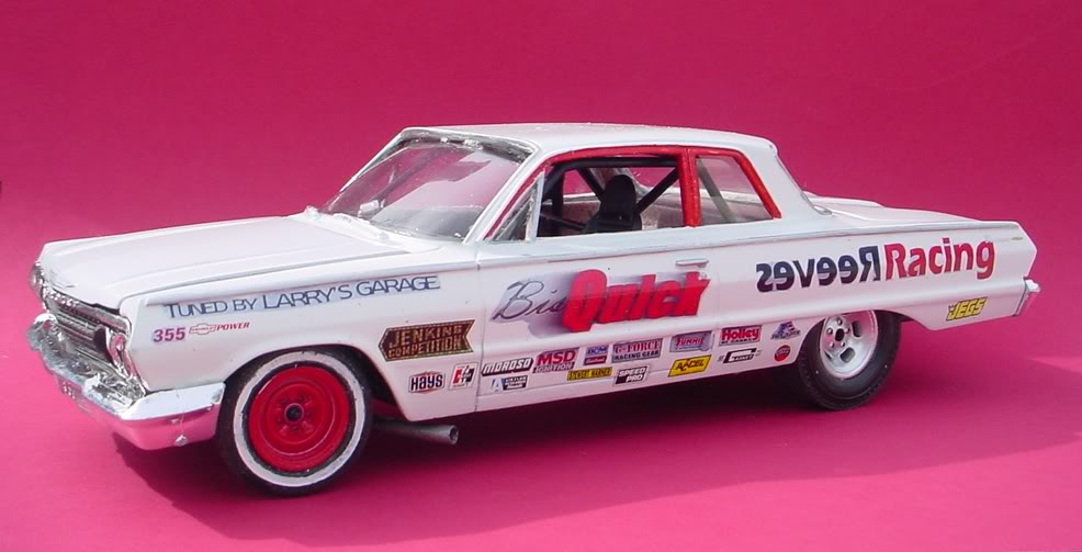

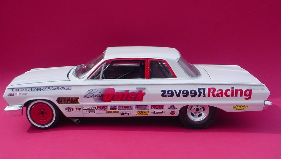

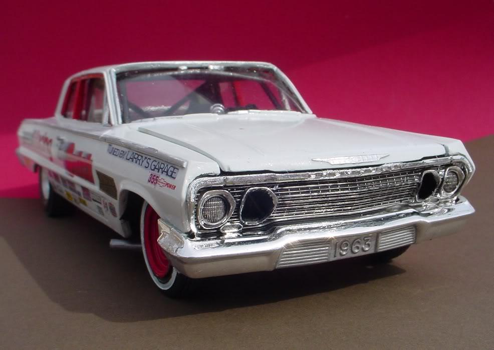

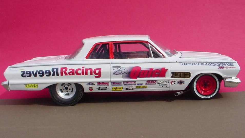

Reeves Racing Posted February 20, 2017 Author Posted February 20, 2017 The repaint was successful. I did hit one snag, I broke the windshield so Hi had to find another 64 Thunderbolt on eBay to get another windshield. The BMF (looks lumpy in the pictures but better in person) is done and the window channels and inside trim is painted and the rear and side glasses are installed. I made them from sheet stock. I started on the decals which is my favorite part of a build. I am really happy with the way it's tuning out. I wish some of my detail work was a little cleaner but that's where my vision for the build exceeds my skill set.
Reeves Racing Posted February 21, 2017 Author Posted February 21, 2017 Finished the decals last night. I need to reapply the BMF to the lower windshield trim and as soon as I get the new windshield I will be able to finish it up. I am also waiting on a PE carb linkage set to finish up the carburetor and permanently mount it. I am hoping the parts show up today or tomorrow. I finished up the disc brakes, the real car had 65 V8 Mustang spindles, 89 Ford Ranger rotors, 90 Chevy S10 calipers and Cadillac brake hoses and an adapter kit from Scarebird Fabrications. The chrome pens are awesome for touching up the BMF. I will finish detailing my trailer and the hitch on the truck and I will have a miniature of my tow rig.I set it on the bench last night. Boy does that bring back memories. I sold the truck when we moved to Louisville and I sold the race car a year and half later, and my trailer was stolen so I no longer have any these in real life any more lol... Here are some pictures.
