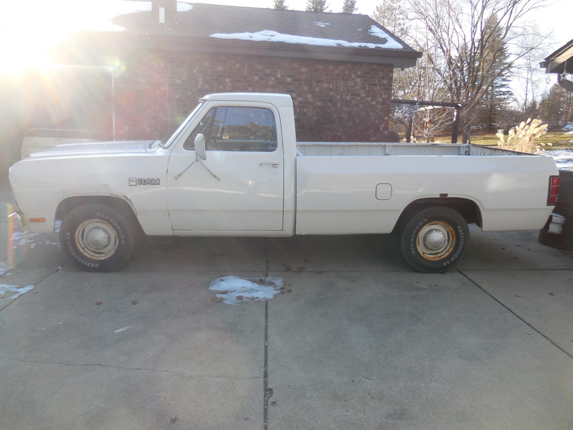

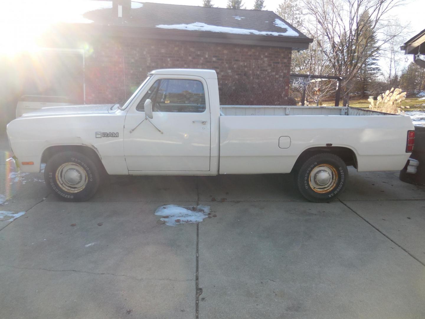

71_Sears Posted January 8, 2017 Posted January 8, 2017 It's my first time posting a build on here. Late February of 2016 I bought my first vehicle ( yes I'm 17 ) which is a 1983 Dodge D150 "Custom" package with slant 6 and A727 3 speed automatic trans. I love that truck so much.. When I saw the Revell '80 Ramcharger was being reissued I knew I had to take 2 of them slam them together and create the first 1/24 scale 1983 Dodge D150 long bed pickup. Started this project today. With that being said, here is the build so far. Starting off with a picture of the real truck which is the only one I had on hand. The kits I used to start this build as of now are the Lindberg '64 Dodge 330 for the slant 6 engine, and 2 '80 Ramcharger kits one to make the cab, the other one the bed.

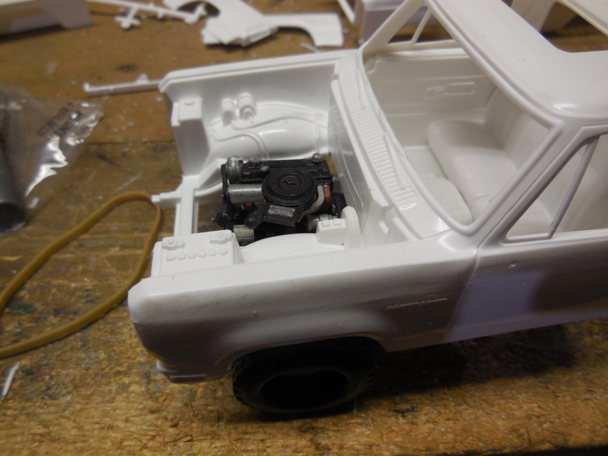

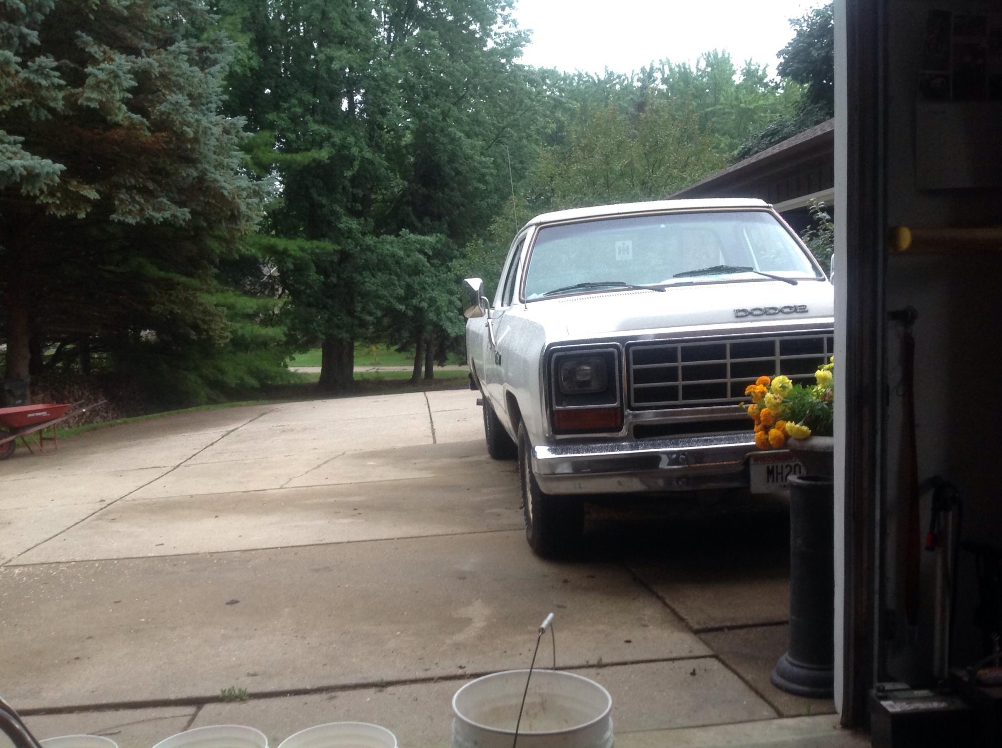

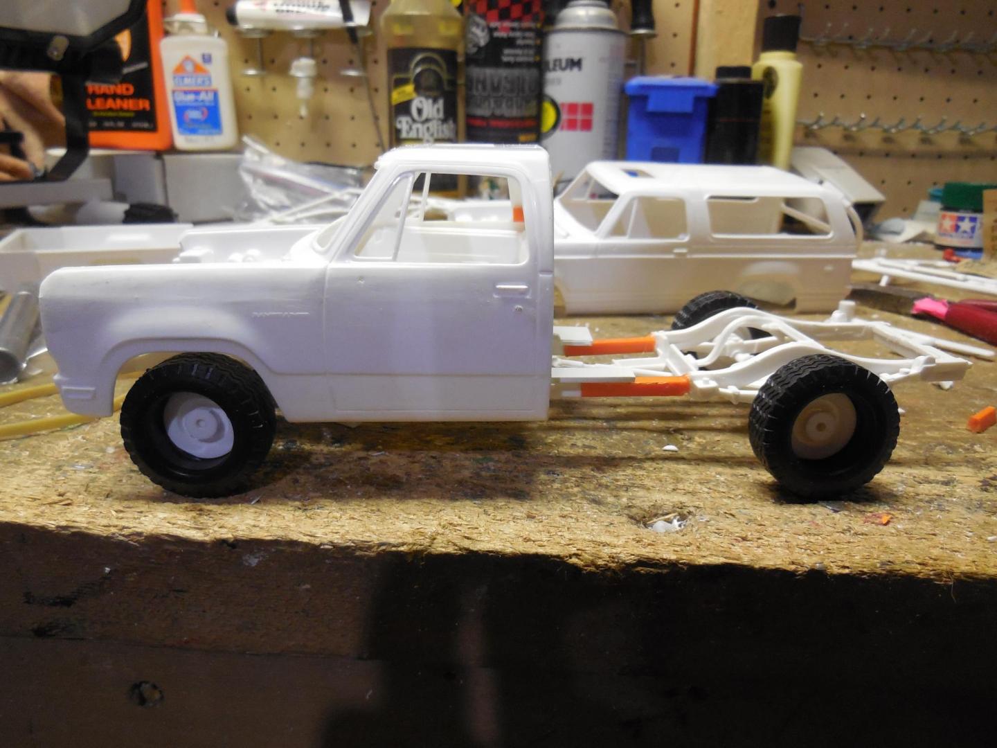

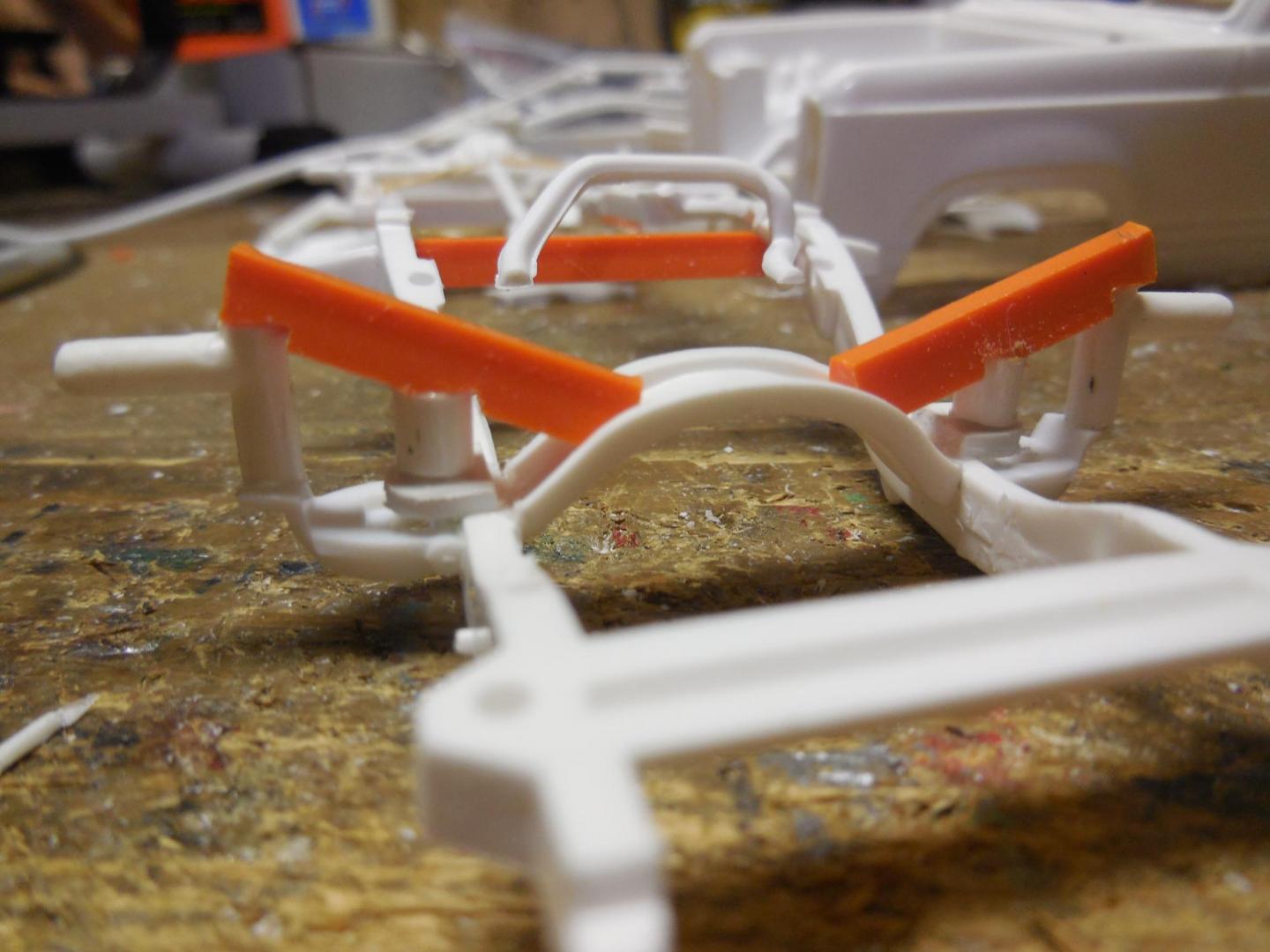

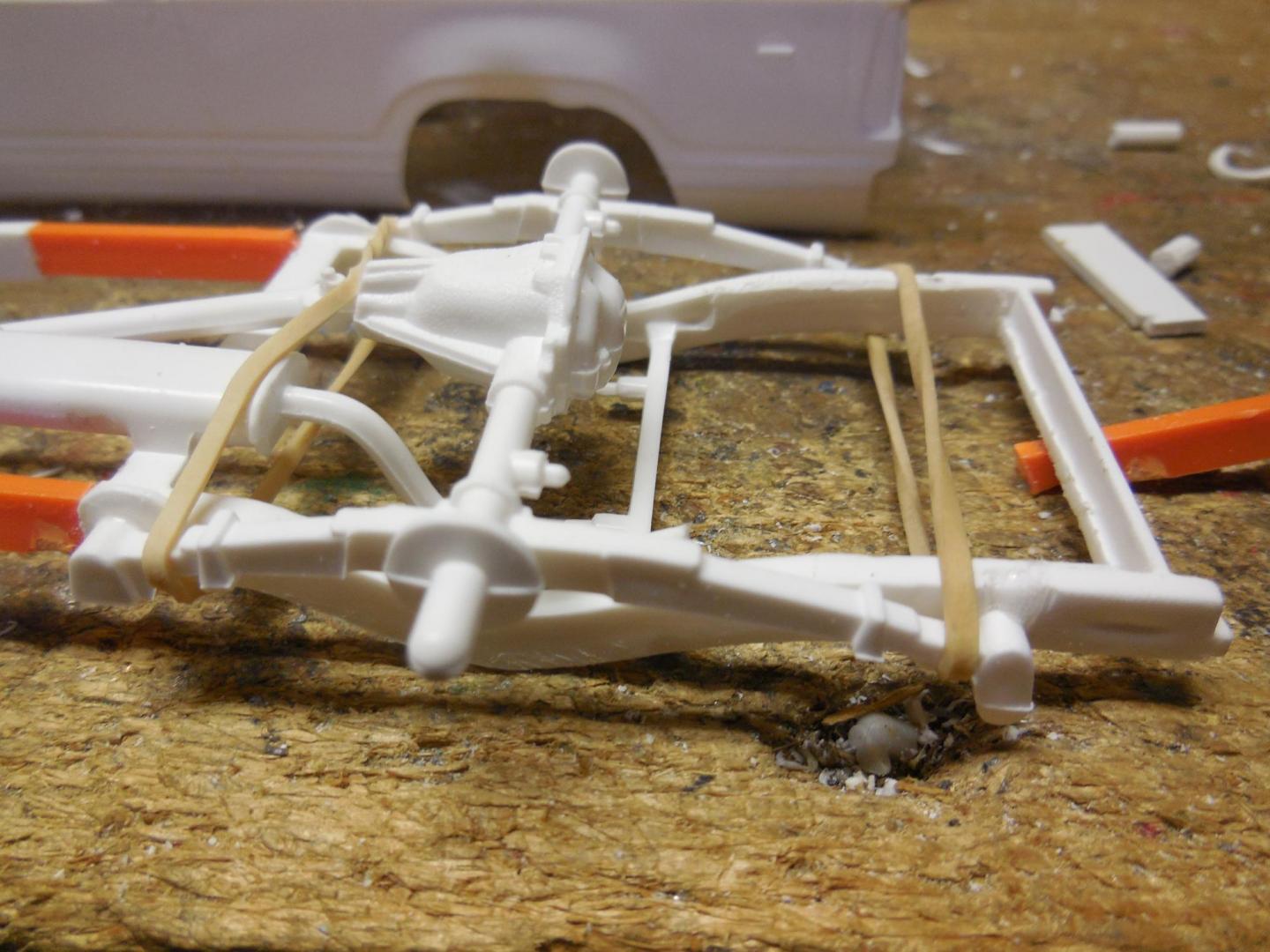

71_Sears Posted January 9, 2017 Author Posted January 9, 2017 I got some more stuff done tonight including front and rear suspension, bench seat and removing the upper and lower trim from the cab. Let the pics speak for themselves. Comments and constructive criticism is always welcome! Took a side shot of the real truck today as well as chassis pictures for suspension reference.The frame was cut in two and lengthened about an inch or so to get the proper 131" wheel base. Then the leaf spring mounts were cut and the leaf springs glued to the side of the frame.Next came the task of scratch building proper 2 wheel drive front suspension.

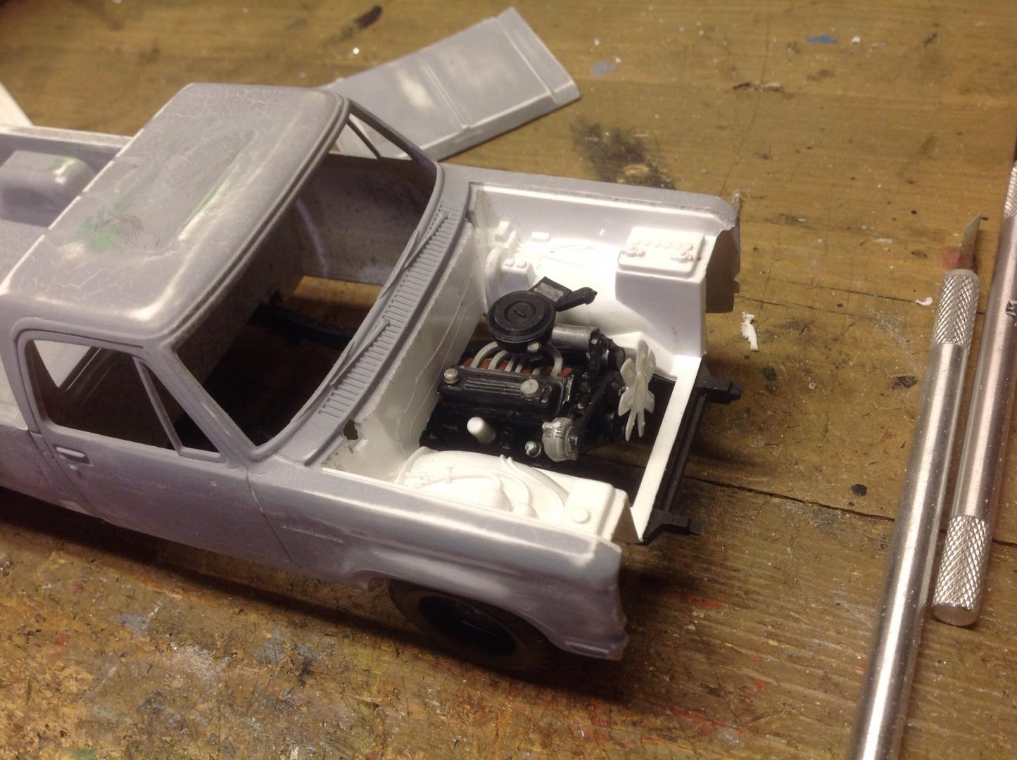

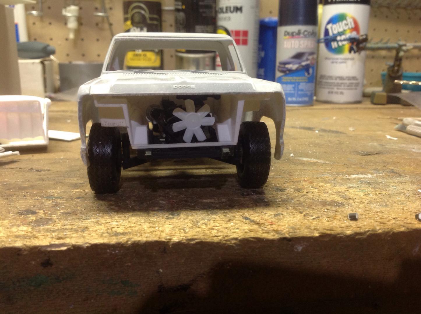

71_Sears Posted January 9, 2017 Author Posted January 9, 2017 I let the front suspension tack up before I put the tires on to make sure it sat good on a flat surface. The cab pictured has the trim removed. All the pictures I had when I started the build yesterday were no good thus I don't have any cutting the body up, but I do have a second one to chop up still that I will take pictures of the procedure.The 1/25 scale slant 6 is a bit small in this truck, but isn't a 225 slant 6 small to begin with?! I will make motor mounts and a higher trans mount to raise the engine up as much as I can to make the engine not seem so small unless someone knows of a 1/24 scale slant 6.. Rims will be from Fireball Modelworks since they have the closest 1/24 Mopar steelies and dog dishes to my truck.

71_Sears Posted January 10, 2017 Author Posted January 10, 2017 You're off to a great start. There is something very rewarding to building a model of your personal ride, especially if it's your first car. You also can go out in the driveway to verify any detail you need to. Your trucks body looks like it's in pretty good shape for a truck in your part of the Rust Belt. Yes, it is by far the nicest one I've seen also considering it was an Illinois DOT truck since 1992 at least. Only 85k on the odometer, I definitely plan to keep it going till it does and then some! I'm contemplating trying to replicate the dented fender and the rust spot on the bed side..

71_Sears Posted January 11, 2017 Author Posted January 11, 2017 That is a nice pick up truck you have ! Looks to me like you have a handle on what you need to do.And how to do it. Looks good from here. Be Well GatorThanks for the interest! It's nice knowing I have access to as many pictures as I need since its sitting in the driveway!

71_Sears Posted January 12, 2017 Author Posted January 12, 2017 Dan,Only the grille! I can't mold bodies and such, but engines and transmissions as well as grilles I can. So you do a good job on that grille, I'd be willing to mold it! -Need any Mopar engines and or parts, PM me I have a TON of that stuff already molded up ready for trading purposes!!!Ok, sounds good. Do you know of anyone that does a 1/24 scale slant 6 by chance?
426-Hemi Posted January 13, 2017 Posted January 13, 2017 Let me know!!!! As for the Slant 6, nope the last I knew a Slant 6 made in 1/24th scale was by Ross Gibson.... I can get close, with one of them I have, but its not exactly 1/24th or 1/25th..... PM me on it tho....
71_Sears Posted January 13, 2017 Author Posted January 13, 2017 Let me know!!!! As for the Slant 6, nope the last I knew a Slant 6 made in 1/24th scale was by Ross Gibson.... I can get close, with one of them I have, but its not exactly 1/24th or 1/25th..... PM me on it tho....Will do! I'm contemplating pulling my engine apart and adding some styrene in all the joints where the parts comes together to make it a bit bigger. I will see tonight when I get some bench time!

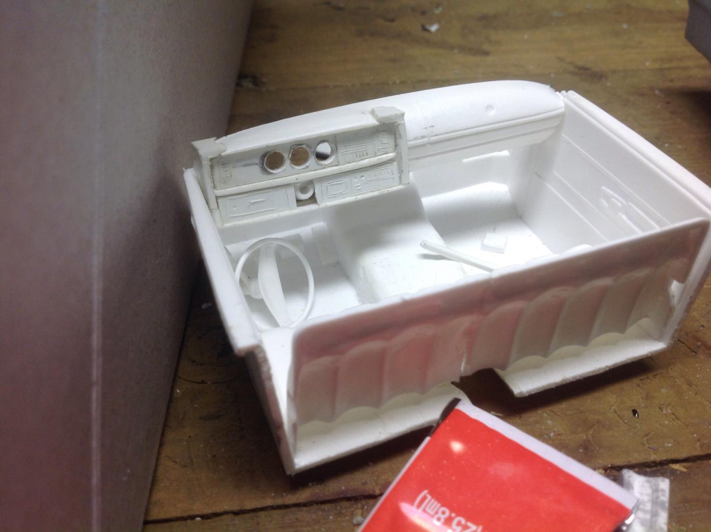

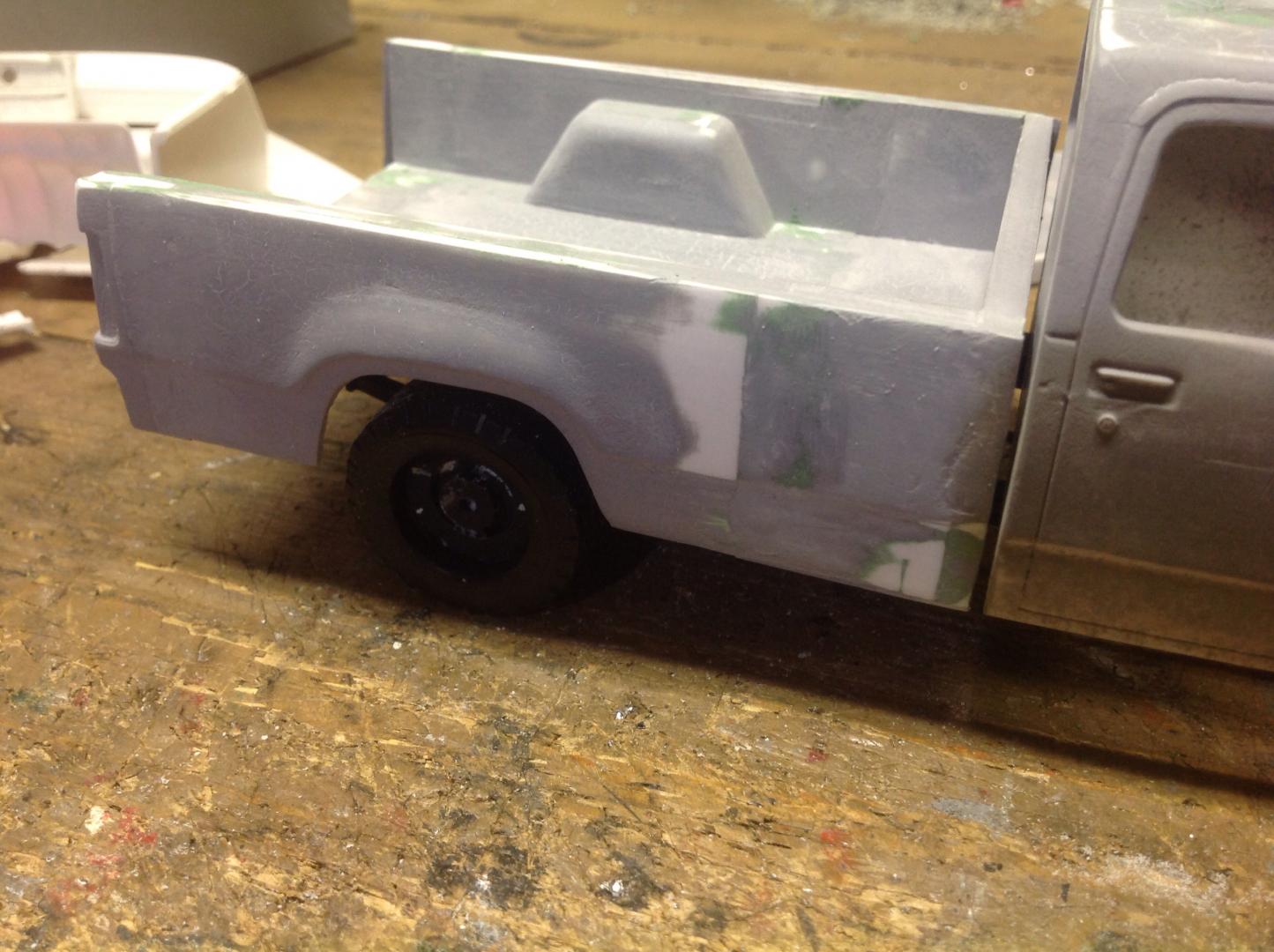

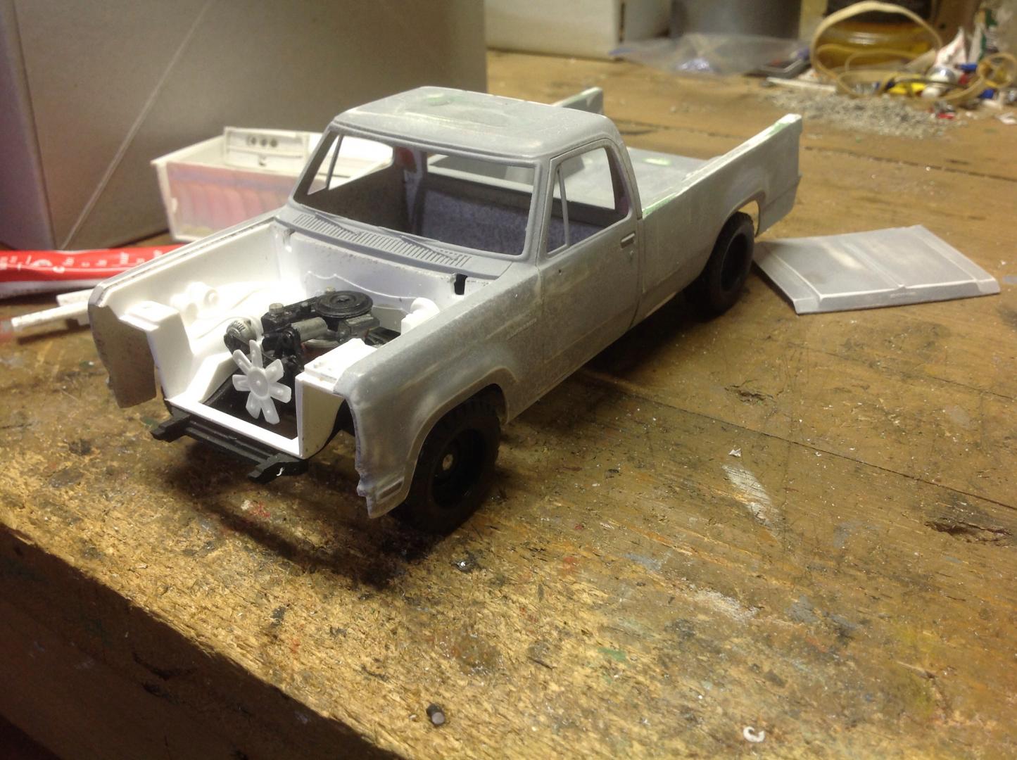

71_Sears Posted January 17, 2017 Author Posted January 17, 2017 Got some more work done yesterday with very limited time so I didn't get a chance to get pictures, but I modified the engine to make it more or less 1/24 scale, started working on the dash, bed floor, and the bed sides. Sounds like a lot in an hour, but just little things. I just had to paint the engine again, and then started tooling around with the dash which proved to be a bigger project than 2 hours worth of time. So I moved on to the bed floor and I finished that up minus filler and sanding it down and the strips that run the length of the bed floor. I will have to make a hobby shop run for strip styrene to tackle that and the front grille. The bed sides got the trim removed and the front portion of the passenger bed side added on. That's where I ended last night. I hope to post more pictures soon.

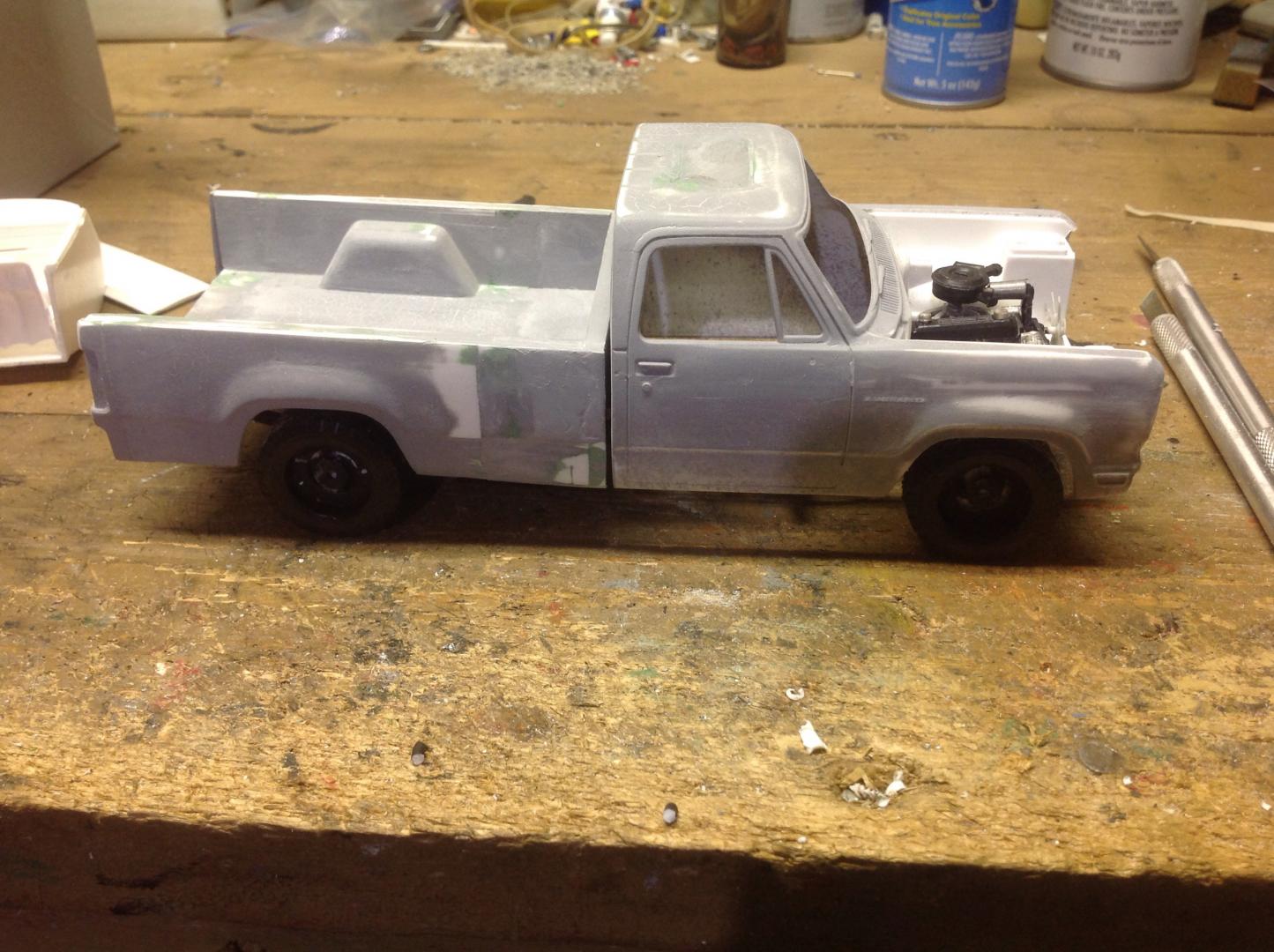

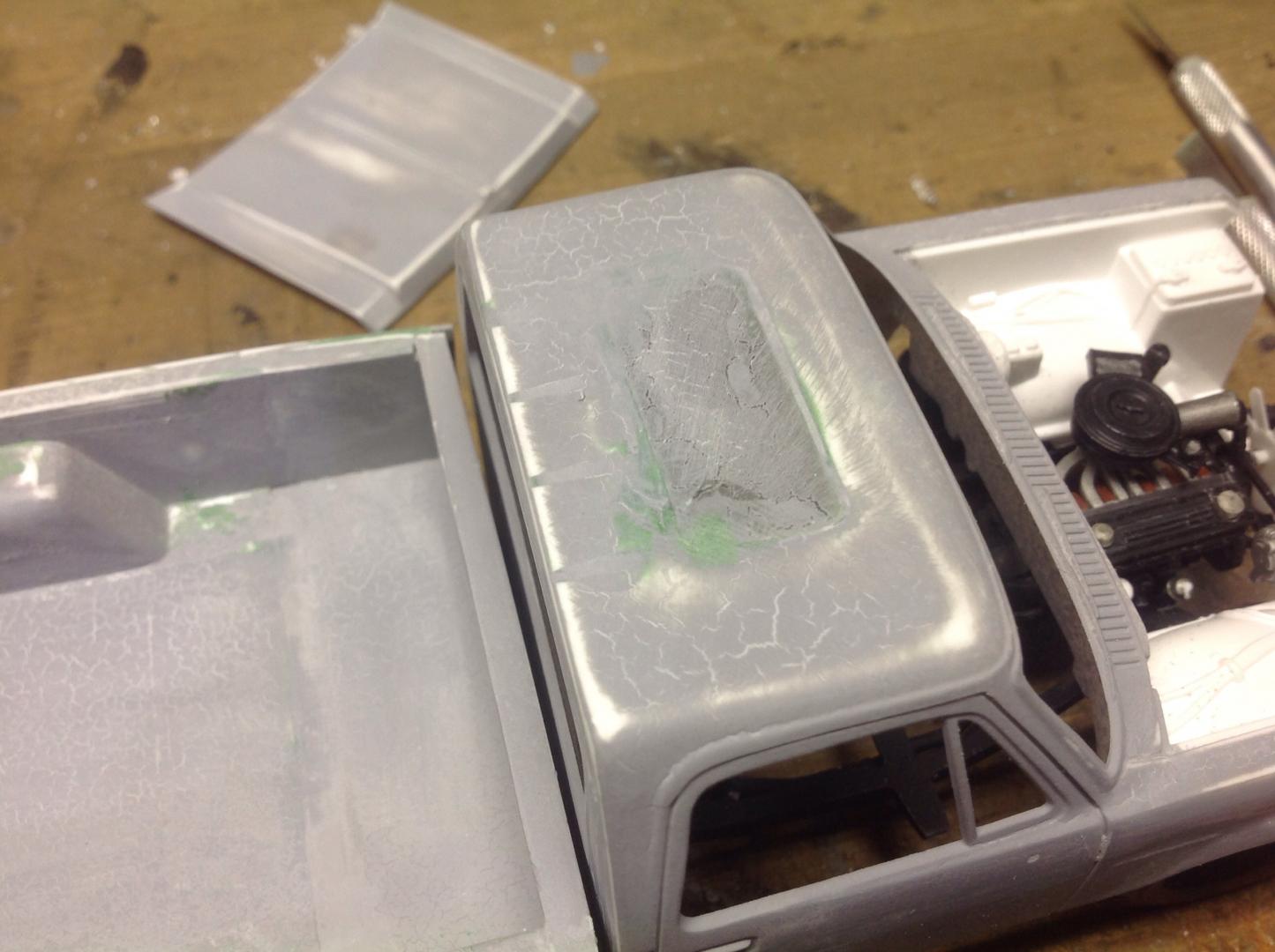

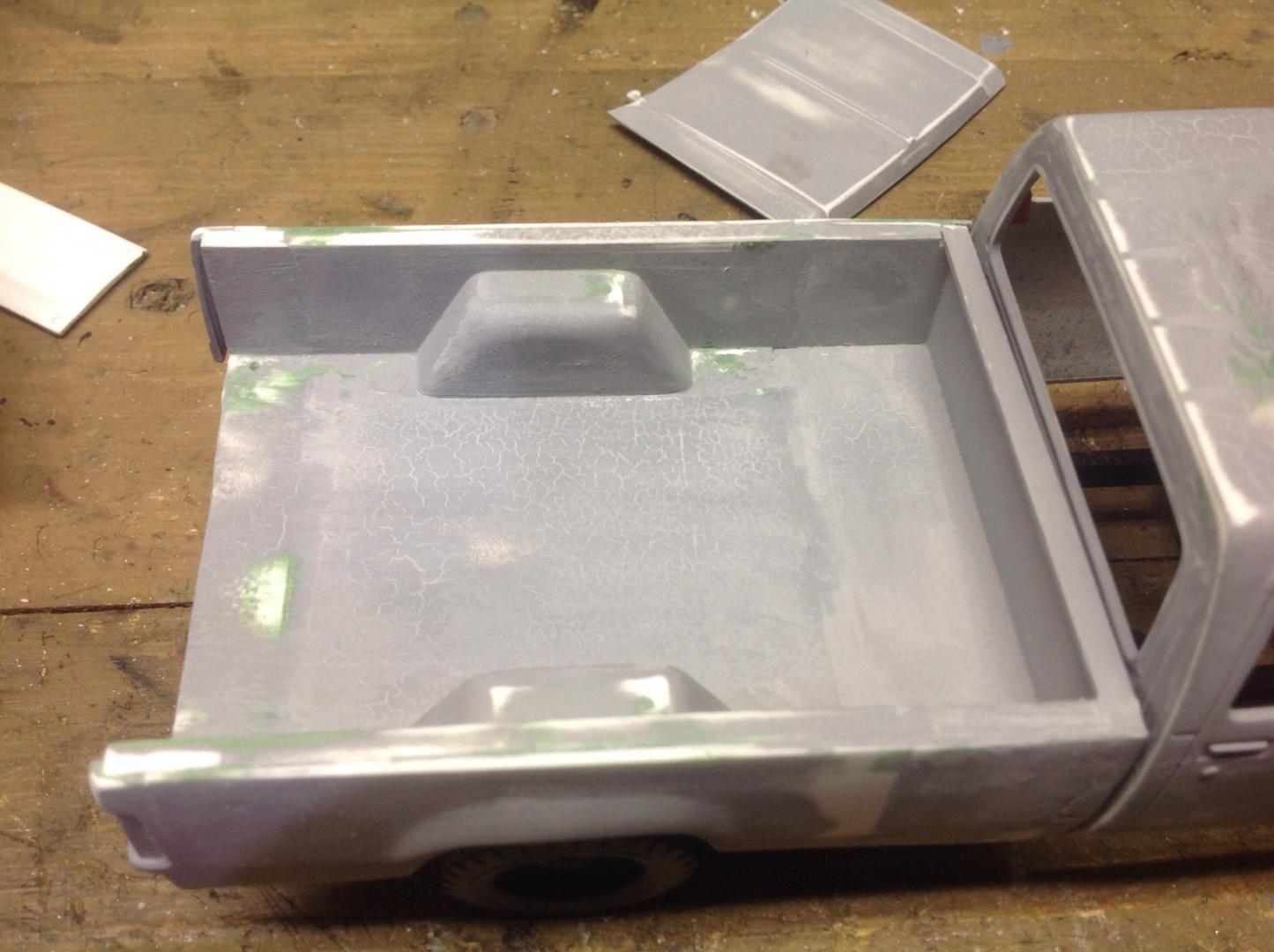

71_Sears Posted March 12, 2017 Author Posted March 12, 2017 Well, I've been lacking to do an update for several months now. Before I put the truck back in the box for a while I finished making the bed and bed sides and started on the dashboard. I primed the whole truck and the primer cracked all over the place so it went into the box. Just this past Friday I pulled it back out with new interest in fixing the cracked primer and other parts I wasn't satisfied with. I redid the dashboard once again and filled in more holes and pits. Here's where I am right now and hope to get primer on the body in the near future as I continue to make progress.
leafsprings Posted March 12, 2017 Posted March 12, 2017 NIce build, it does get frustrating at times when you discover many versions of pickups were simply not done, you literally have to create them on your own from the few similar kits that were offered. I like the subject, a base model without all the fancy trim, moldings and custom wheels.
