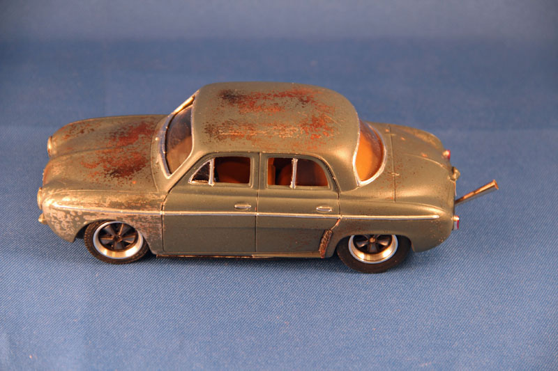

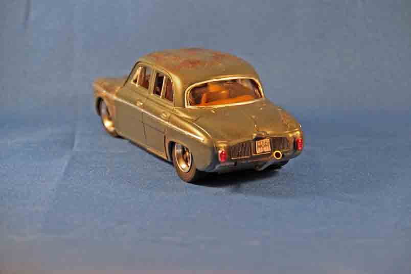

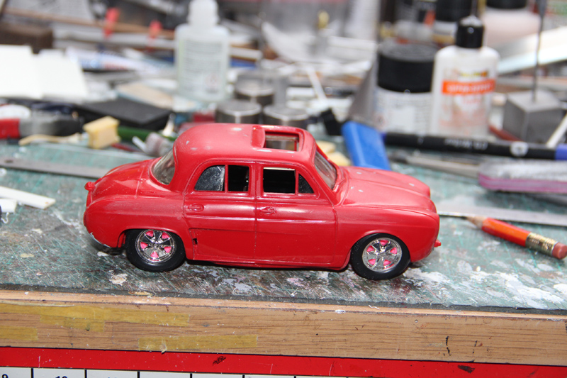

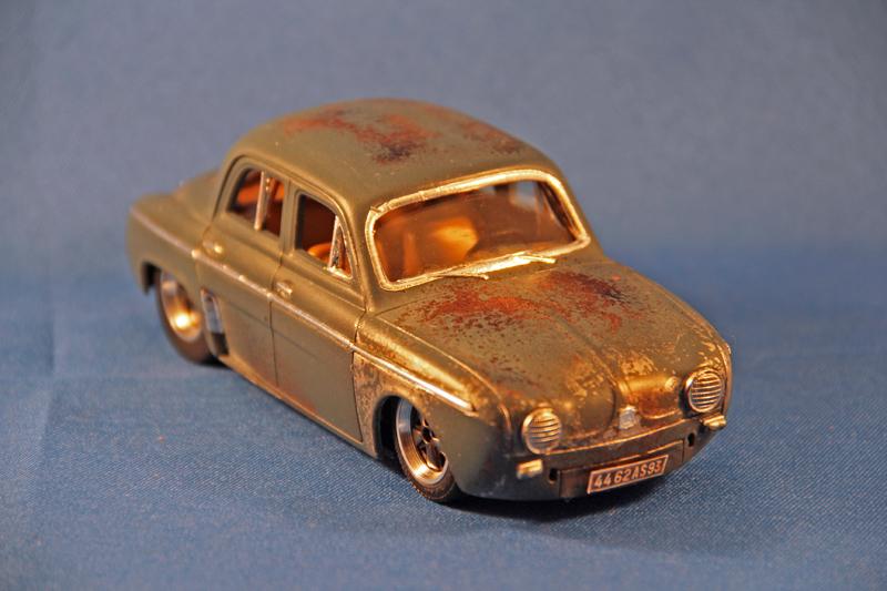

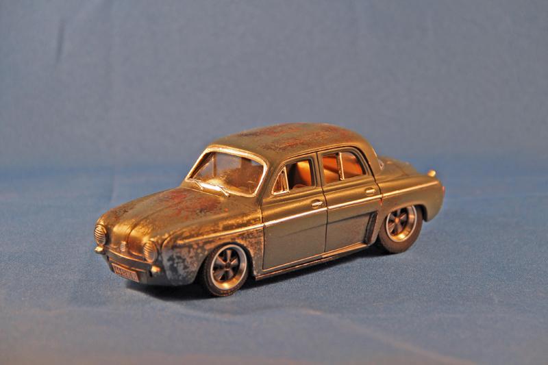

carsntrucks4you Posted February 7, 2017 Posted February 7, 2017 (edited) Inspired by a Renault Dauphine with Yamaha FJ1200 engine I modifeid an old Hubly Renault Dauphine. The Hubley Chassis was replaced by a new one made out of sheet. The proportions of the roof are a bit strange so that I corrected it to the right shape. Also the belt line wasn't straight, more wavy. I corrected that as well and add a chrome .The rims are modified 15" Fuchs with 15" rings from Scale Production. The scruffy look of the paint was done wit Hairspray and salt technique. Edited February 7, 2017 by carsntrucks4you

Alan Posted February 8, 2017 Posted February 8, 2017 On 2/7/2017 at 8:12 PM, carsntrucks4you said: Inspired by a Renault Dauphine with Yamaha FJ1200 engine I modifeid an old Hubly Renault Dauphine. The Hubley Chassis was replaced by a new one made out of sheet. The proportions of the roof are a bit strange so that I corrected it to the right shape. Also the belt line wasn't straight, more wavy. I corrected that as well and add a chrome .The rims are modified 15" Fuchs with 15" rings from Scale Production. The scruffy look of the paint was done wit Hairspray and salt technique. Cool little build ....... can you go into detail about the hair spray and salt ?

carsntrucks4you Posted February 9, 2017 Author Posted February 9, 2017 On 2/8/2017 at 6:54 PM, Alan said: Cool little build ....... can you go into detail about the hair spray and salt ?That's simple. I paint the body with a various brown, black from Tamiya and AK Interactive True Metal Iron. The I applied on several spots hairspray and salt. After that I spayed mid blue over all. After the paint hat tried I remove the salt with an old tooth brush, a side effect is that you also get some scratch marks were the hairspray was. Finally I sealt it with a coat of semi gloss clear coat from Gunze -Sanyo.I hope that helps. Check out AK-Interactive side for more tips and tricks about weathering
