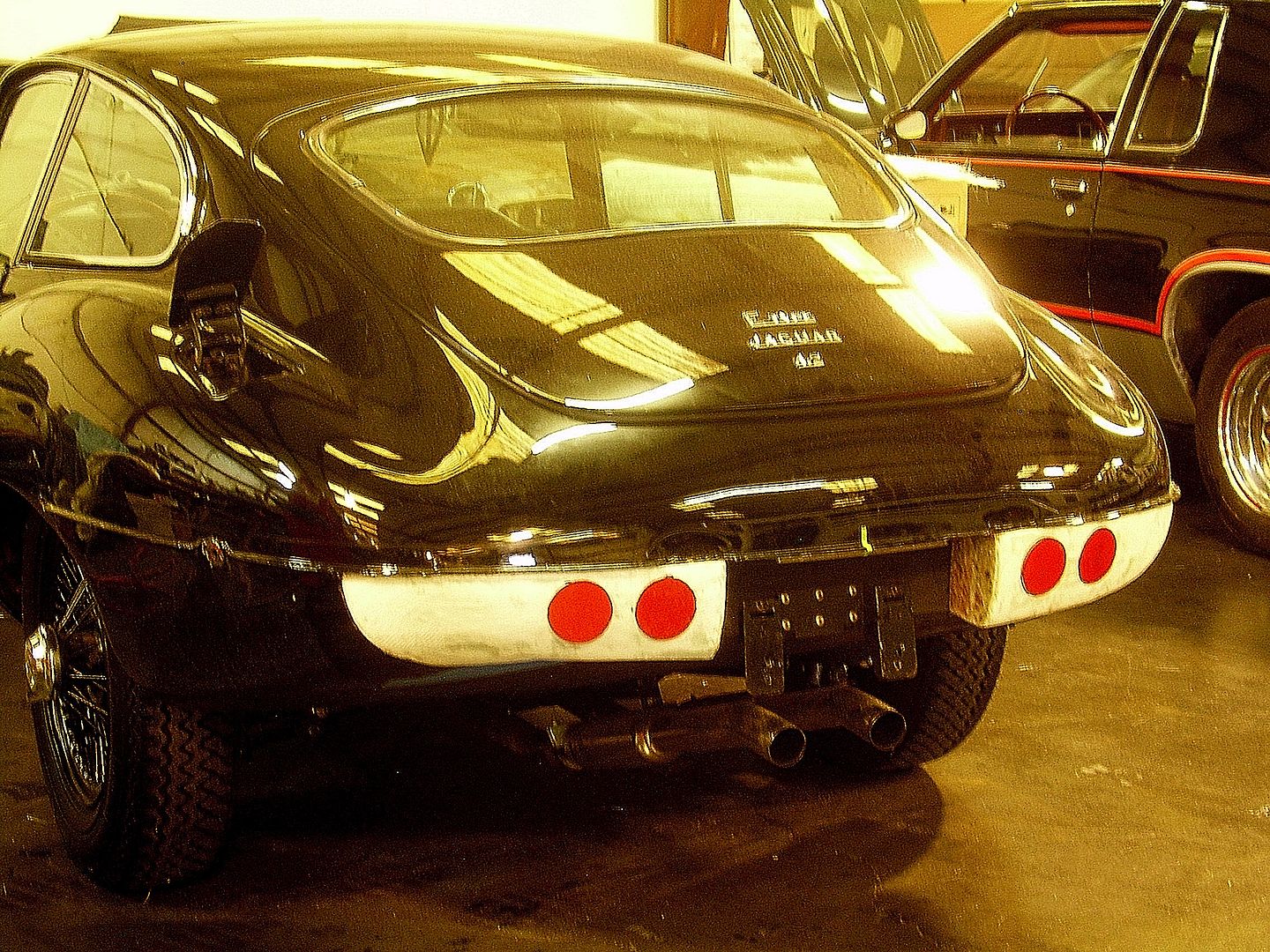

Ace-Garageguy Posted February 12, 2017 Posted February 12, 2017 (edited) You're not limited to expensive "tooling" foam either. Below, I'm using cheap polyurethane refrigeration insulation foam to rough-sculpt some custom bits for a Jag E-type. After the shapes are close, the surface is fiberglassed, and a thin application of bondo is used to develop the final contours. You make molds at that point, and can reproduce as many copies as you need. This technique also scales down to work on models perfectly. Edited February 12, 2017 by Ace-Garageguy
