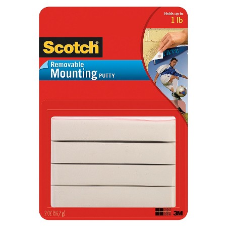

STYRENE-SURFER Posted February 15, 2017 Posted February 15, 2017 Ive been using Scotch removable double sided tape. it dosent work for every type of mockup, but you can cut small pieces the size of your part to temporarily hold it in place. Ive also used just about everything mentioned here: had no luck w/white glue, tried Testors window glue and found the residue difficult to remove. Sometimes I'll just use a blob of Bostik Blu-Tack. By the way the Scotch double sided tape is great when you are trying to make identical parts from sheet styrene, use it to hold two pieces together and cut them out at once or make a copy of a finished part by using the tape to hold it down to another sheet, rough cut it out and cut sand or even drill holes to match the original
