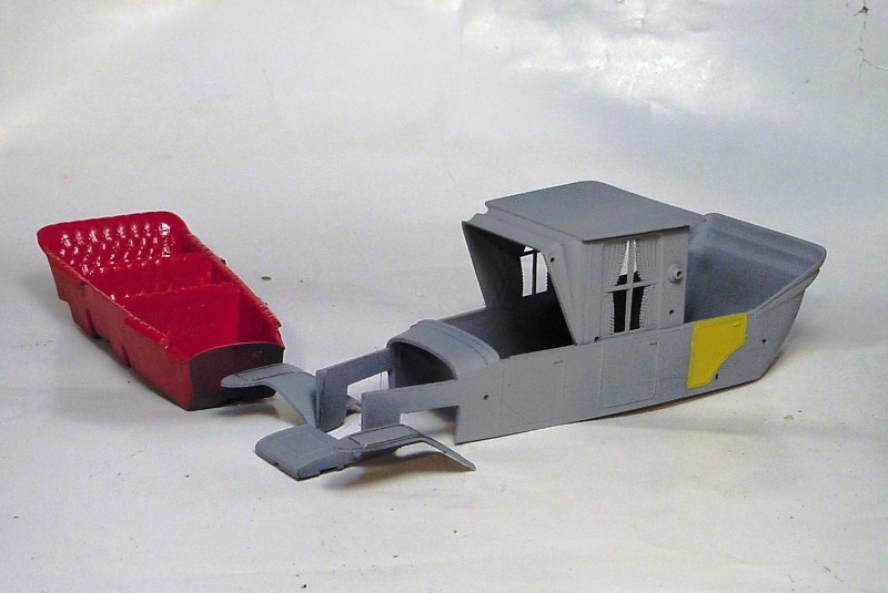

gtx6970 Posted February 15, 2017 Posted February 15, 2017 Spent a few days cleaning up flash ( and there was lots of it ) Got the body in primer last nite. Then taped it up to get the yellow for the rear doors painted this morning. . Interior is just testors flat red ( lighting makes it look shinier than it is ) Im also doing the bare metal foil trick on the fender beading pre-paint. Once its all painted, Ill take some lacquer thinner and clean it off prior to clear coats This was one of my favorite shows as a youngster . And Ive had this blueprinter version of the Koach and Dragula for years ,,,waiting patiently. And there day has finally come.

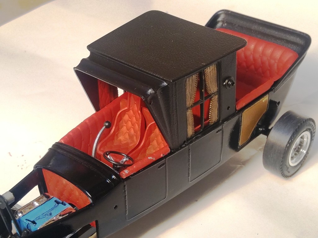

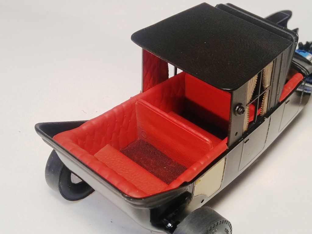

gtx6970 Posted February 16, 2017 Author Posted February 16, 2017 Thanks fellas, Its a pretty simple kit ( extremly simple actually ) Got the body painted yesterday. Its duplicolor basic black with Upol urethane clear. ( I dont care for the duplicolor rattle can clear ) Ended up re-taping it and resprayed the rear doors in a light gold , as I didnt care for the yellow that the instructions calls for. Top of the body and the folded rear cowl is sprayed in duplicolor flat black lacquer . And the Interior is just Testors flat red with embossing powder for carpeting. As of this morning ,,,,the Body, chassis and interior are now glued as one unit

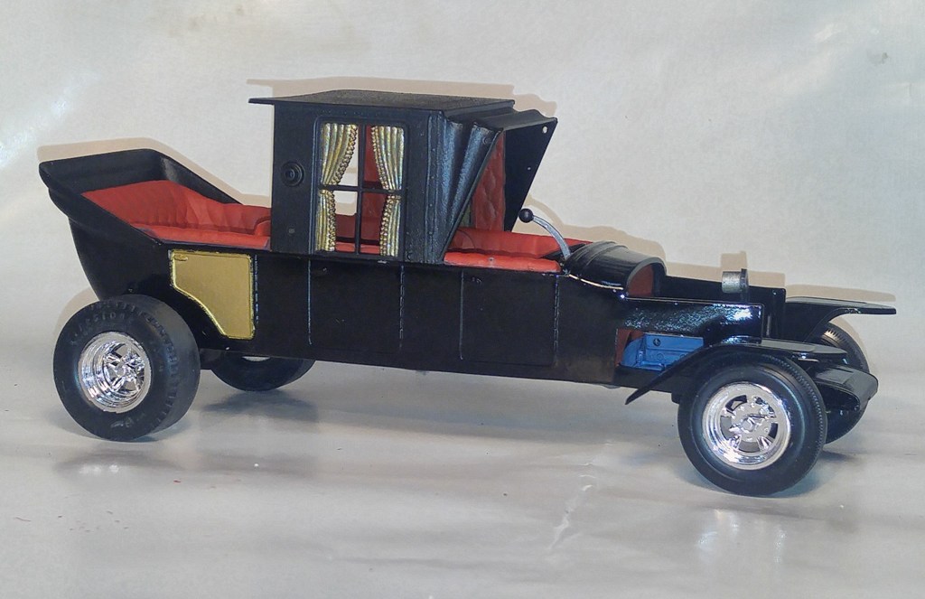

gtx6970 Posted February 17, 2017 Author Posted February 17, 2017 (edited) I use the instructions as a placemat and a loose guideline lol I just bought the "Graveyard Duo" kit that was just released by Round2. I've always loved these cars. However the engine in both needs to be a Ford engine w/ Cobra valve covers to be true to form. Jesse, The Koach does have the Cobra valve covers ( dont remember if the Dragula did or not , and if it does you cant see them anyway once the body is on ) But the engines are so far under scale in both its unreal. And if one decided to build a drive train in a more correct scale I don't think the body would fit down over them . Thats one of the reasons I don't think either car would make very good parts kits. Ive been on a simple kit build run lately. The Koach isnt done yet as I'm going to do the wind shield frame with the chrome pen when my order arrives . But I like this picture . My daughter did a snap kit build of the Polar Lights 66 Batmobile and its in the other side if this case . Once completed, I'll take a better group photo of them all I present ( and in my best Fred Gwynne voice ) I present the cars of my yuth. Edited February 17, 2017 by gtx6970
