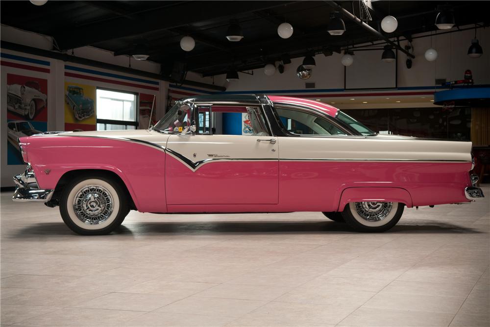

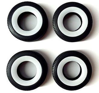

sdbos777 Posted February 17, 2017 Posted February 17, 2017 I'm building a 1955 Crown Victoria for my mom - it was her first car. I've got the AMT 1956 Crown Victoria, the 1955 resin body from Hendrix, a resin continental kit, and wide whitewall tires. (Pics attached of all these). What I need are 1955 wire wheels to go with it, as in this pic of a 1:1 55 Crown Victoria: --> Where can I get 1955 Crown Victoria 1/25 wire wheels like these? I need a set of 5, since there's the continental kit. A set of aftermarket wheels would be great, but also if there's a full kit out there that includes these wheels, that would b helpful too.

Ron Hamilton Posted February 17, 2017 Posted February 17, 2017 The AMT '62 Thunderbird Sports Roadster has a set of Kelsey Hayes wire wheels that you need. The kit only has 4 though.
john sharisky Posted February 18, 2017 Posted February 18, 2017 (edited) Your photo shows replicas of the '63 Ford Thunderbird Sports Roadster wheels (not covers). These wheels now seem ubiquitous on (over)restored late '50's and early '60's Ford products. Your Mom sounds like a real hepcat for owning such a fancy Crown Vic! I'll bet that she had these cool Ford accessory wheel covers: (I took this photo) Unfortunately, The Modelhaus offered REALLY nice castings of these wheel covers. John Edited February 18, 2017 by john sharisky photo credit
sdbos777 Posted February 18, 2017 Author Posted February 18, 2017 Thanks John. My mom loved the car - her father, my grandfather, got it for her for her 16th birthday. I have no pictures of the original car from the 50's, so I don't know *exactly* the rims it had. She doesn't remember a lot of these details about it, so it wouldn't be terrible. My dad, who she was dating at the time, does remember that it had wire wheels, though, so that's why I'm looking for them.If I could find something close to the original that would be great. But the Thunderbird rims are pretty close. Does anyone have some old Modelhaus castings sitting around? Or know who else might make the wheel covers John shows?Also, what would these be called, so I can search on them? "55 crown victoria wire wheels" is too vague.
