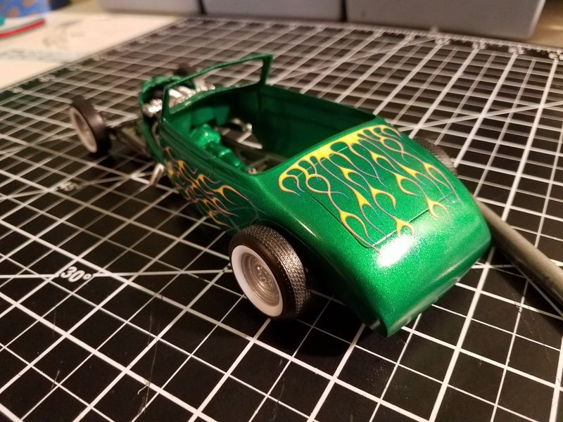

Jantrix Posted March 19, 2017 Author Posted March 19, 2017 Here is a little hint for you. When you make your own decals on a inkjet printer, they give you a fixative to spray over the decal. That fixative is most often a fast drying lacquer. You can clear coat with just about anything as long as you go very light and let it dry. 10 minutes is not enough. Over night for lacquers is about right. One very very light coat then another and build up about three light coats. That way the solvent in your final coats will not dissolve the top coats and cause them to wrinkle. Be patient. If you get in a hurry trouble will follow. Here she is after decals. Paint is smooth, decals are flat. I'll let them dry and set until next weekend. Then I will follow Pete's advice and give it a go. Three light coats about 20 minutes? apart and then an overnight wait.
