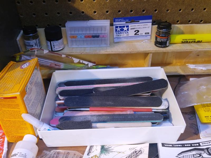

My wife and mother in law used to own a hair / nail tanning salon.
When it closed up I got a box full of some new and mostly used nail sanding files , it all kinds of grits . Im set for life

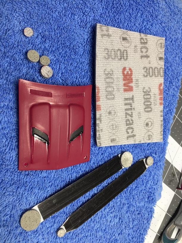

I made these sanding sticks from a 3M Trizact sanding pad, double faced tape and metal strapping. A popsicle stick would work just as well. I like the fact that I can punch any size circle I want. This 3M stuff is nearly 1/8" thick, so it can get in between the ribs on this hood.
