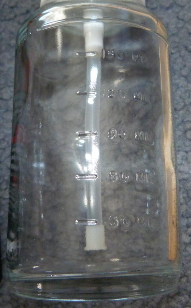

Nells250 Posted March 5, 2017 Posted March 5, 2017 Hi all Even though I have been building kits on and off for decades, I do not have an airbrush. I simply cannot afford one, and frankly cleaning them makes me nervous. Having said that, a 1:1 Jeep guy we know mentioned the Perval sprayer system, and recently I found out they can be purchased at Home Depot for only $5! Info can be found here ----------- >>> https://preval.com/all-products/preval-sprayer/ A peek at the website shows they sell packs of smaller paint containers, which look better suited to model use, as the bottle that comes with the small kit is a rather large glass one (see pic). Has anyone here ever used this system to spray their models? I'd like to know more about them before trying mine out. I especially need to understand any cleaning processes, as I seriously doubt the propellant will only last for one model!

Dodge Driver Posted March 7, 2017 Posted March 7, 2017 (edited) Info can be found here ----------- >>> https://preval.com/all-products/preval-sprayer/ A peek at the website shows they sell packs of smaller paint containers, which look better suited to model use, as the bottle that comes with the small kit is a rather large glass one. The small touch-up jars you linked to interest me. The Preval sprayer is back on my radar, as I'm very airbrush averse myself. Edited March 7, 2017 by Dodge Driver
