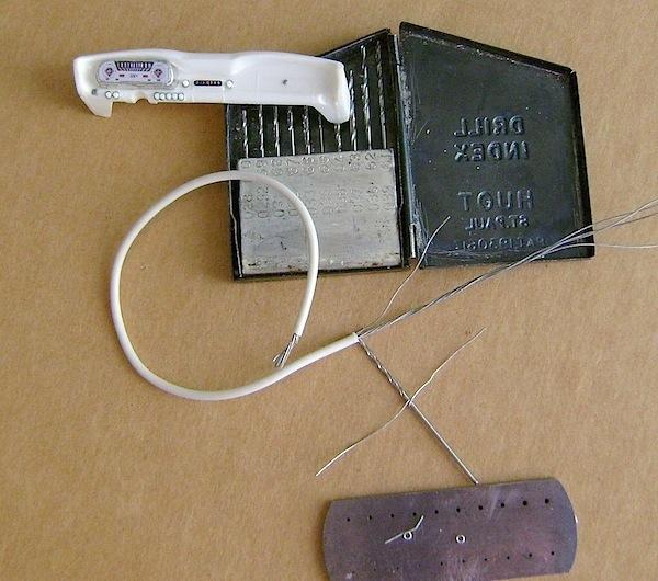

Russell C Posted March 7, 2017 Posted March 7, 2017 As in something that brings life to otherwise featureless knobs on dashboards. At the upper left is the non-painted dashboard for my Ranchero gluebomb restoration. At the very least, I figured it needed something to make the radio and other knobs stand out, and I don't have the painting skill to make the metal rings at the bases of such knobs all a consistent size. So, I created the rings out of thin scrap aluminum wire from who knows what dead electrical device I used to have. The basic procedure is to loop the wire around something cylindrical -- a drill bit in this case -- to form a perfect circle ring, then mash it flat, and use a razor blade to cut through (I used a stainless steel drill size guide as a "cutting board" here) where the wire overlaps itself. Mash it flatter if necessary, and it should fit snugly around radio knobs, antenna bases, etc. I glued these down with Tenax liquid cement applied with a very fine brush. Here, the 5 knobs were too close together to simply place the whole rings over them realistically, so I placed full circle rings on the two outer knobs and the one central knob, and then cut other rings into thirds and located them as needed. Eyeball them from a half inch away and you can see how they aren't perfect, but from regular viewing distance, you wouldn't know they aren't all full circles, and they do all appear to have a consistent size, and that was the entire objective. 1

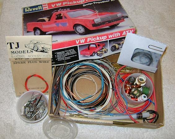

Russell C Posted March 8, 2017 Author Posted March 8, 2017 The "who knows what dead electrical device" must have been very old to be using aluminum wire. ... Beats me, actually, I've been collecting bits of wire since the early '80s, and I've ended up with lots of varieties such as the more or less black steel wire that I use for spark plug wire, copper that I mostly use to pin parts together, and various diameters of aluminum wire. The advantage over pre-made store-bought rings is that I can create a ring of any diameter using wire of any diameter.
