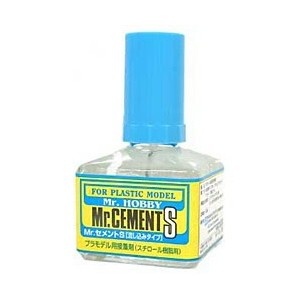

Brett Barrow Posted March 20, 2017 Posted March 20, 2017 (edited) Tamiya's liquid cement is pretty good stuff, as is Tenax 7 if you can find it. Tenax is out of business as well. I was never a big fan of the hotter/faster glues like Ambroid & Tenax (they tended to etch Japanese plastic and I was building a lot of Hasegawa planes at the time), I always preferred the milder/slower ones like Testors & Tamiya Extra Thin, but lately I've been using some Mr Cement S and I really like it. Not easy to find in the US, but most of the Gundam-centric sites carry it. It sets up really fast. You can sand a seam in a couple hours. I use it a lot now, along with Tamiya and the Model Master needlepoint when I need a slower set time. Edited March 20, 2017 by Brett Barrow
