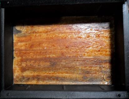

talon63 Posted April 8, 2017 Posted April 8, 2017 While this isn't a steering wheel, I use the same method to create a wood finish on those as well. I lay down a base of tan or other light color, then apply darker color with furniture touch-up markers. There is no clear coat applied to this, it's how the markers dry. This one has been slightly weathered using a dab of flat black and knocking off some of the shine.
