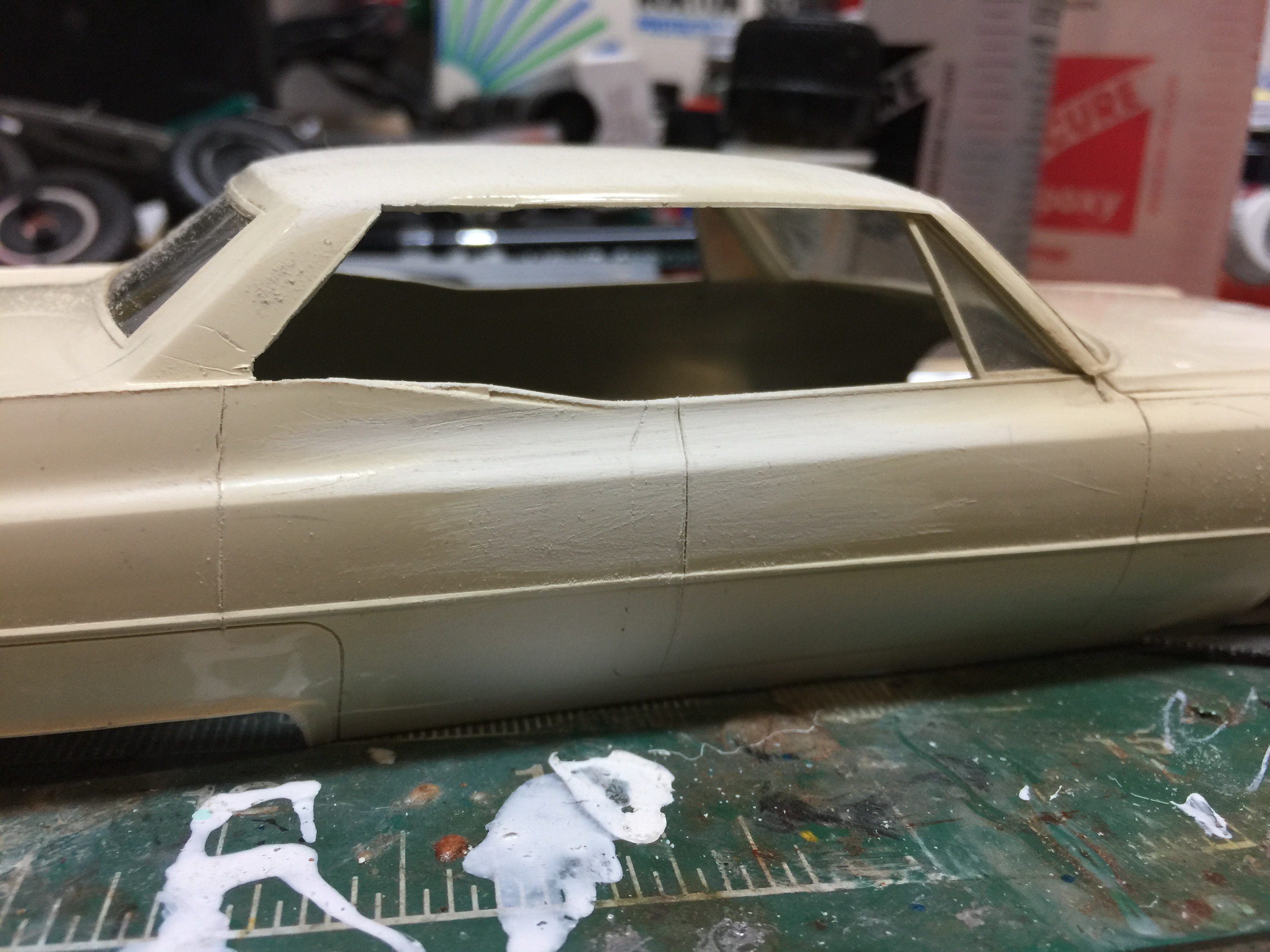

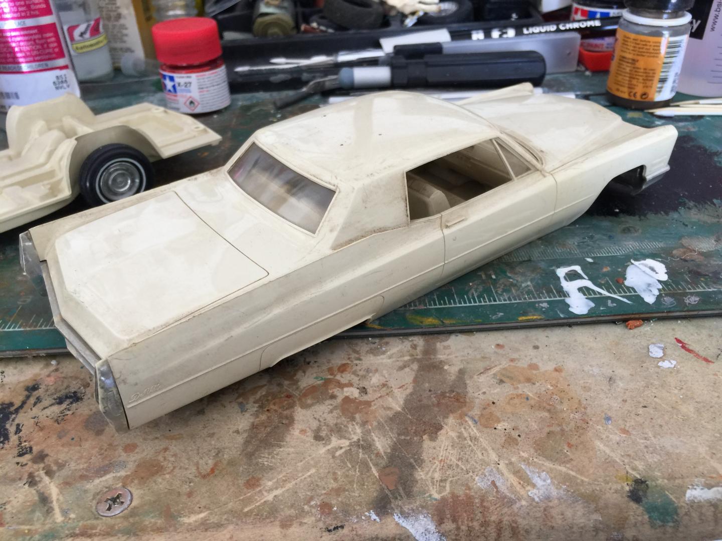

cpspoogie Posted April 18, 2017 Posted April 18, 2017 Doing this for my cousin, his first and favorite car. Not one company made a Sedan DeVille kit, so I had to take this promo car and modify it. Initial cuts and sanding pics here.

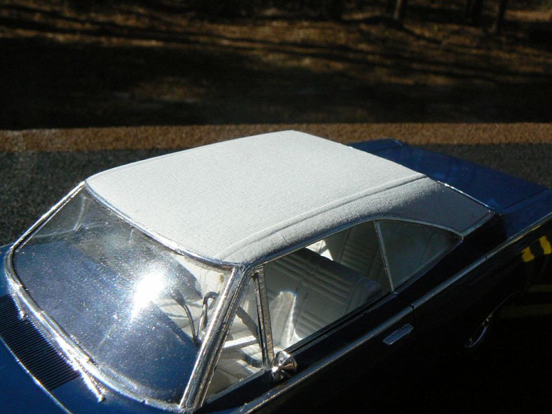

microwheel Posted April 18, 2017 Posted April 18, 2017 The Model Car Garage offers a true 1/25 scale black vinyl top material that works and looks really good. Vinyl Top Kit from the Model Car Garage I have used it on a few of my builds including my last one, a 68 dodge dart build. You can find it in the under glass area here 68 dodge dart custom with vinyl top Its a peel and stick material that trims up easy with a xacto knife. It does take a little patience to get it loose from the wax backing paper, but with a little patience and work it looks good and to the right scale and is a true vinyl material.

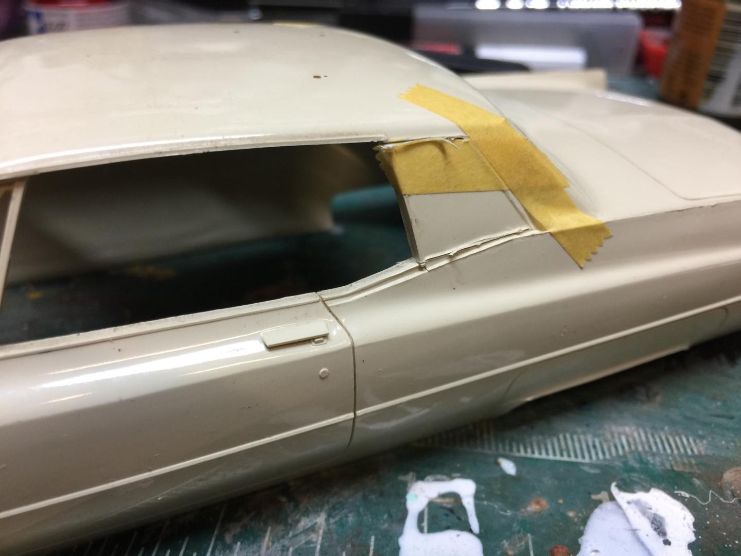

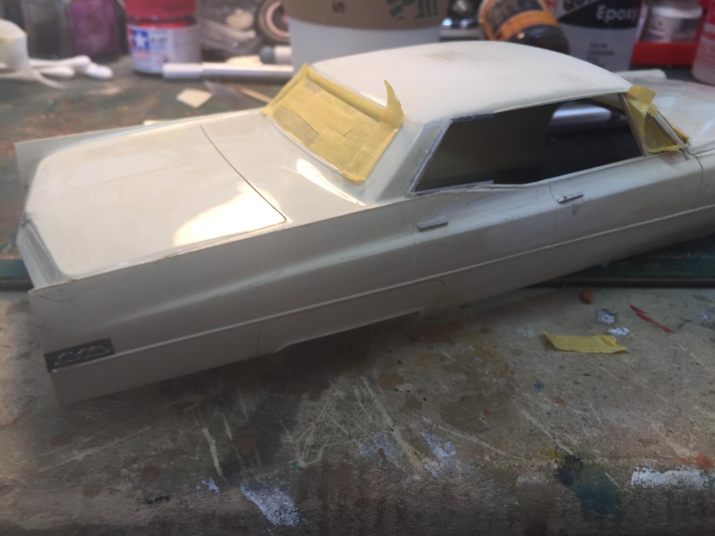

cpspoogie Posted April 18, 2017 Author Posted April 18, 2017 Just finished making new door handles and window trim from old tie rods. Primer is on.

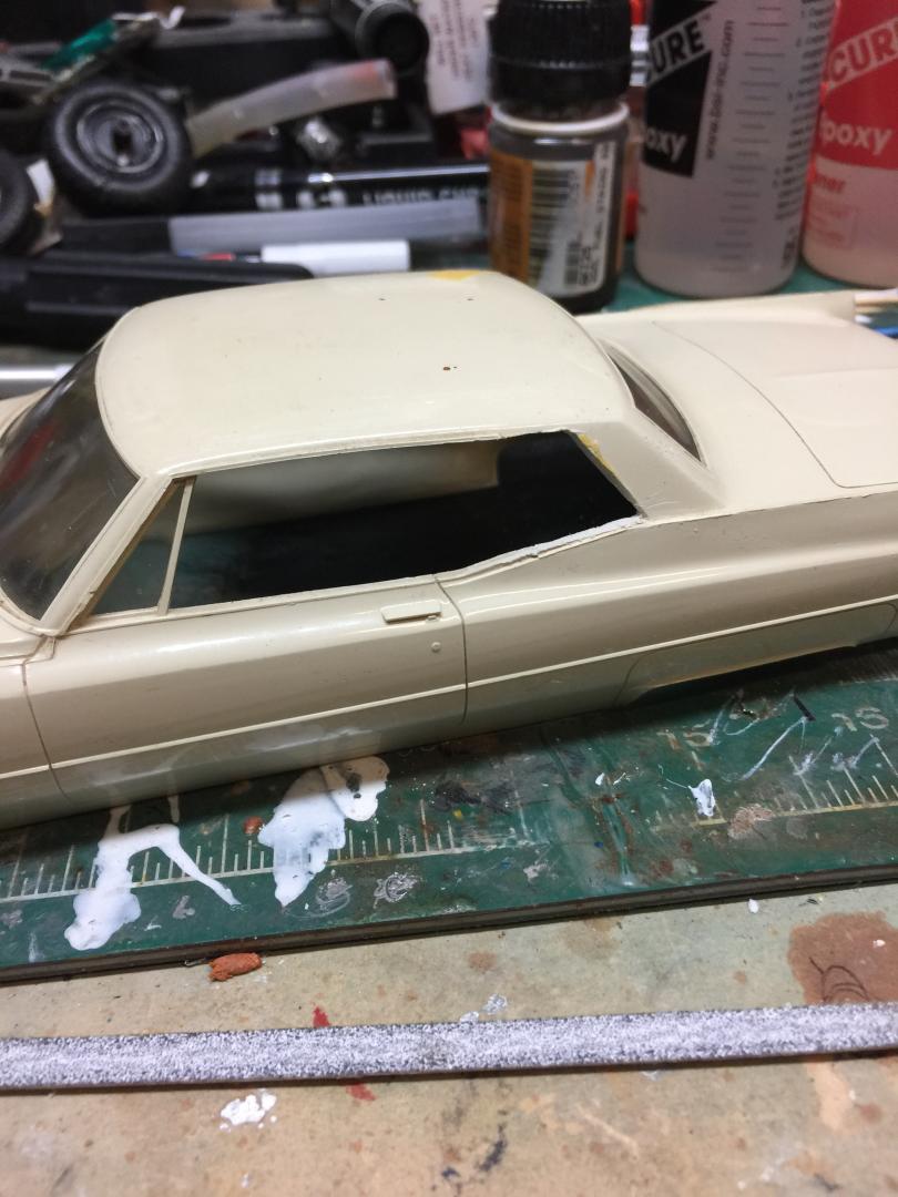

MrObsessive Posted April 19, 2017 Posted April 19, 2017 (edited) Chris, very nice conversion to this four door! If there's one little teeny-tiny nit I could pick--------it's the shape of the C pillar itself. If you take a look at the pic below, you'll get a peek at what I'd like to point out................. The leading edge of your C pillar should extend just beyond the shut line of the door, not be in line with it as you have on your model now. On the 1:1's manufacturers did it this way to enable the rear glass to have enough room to go down fully in the door, particularly with the hardtop styling of this type of car. You won't have opening doors, but on the 1:1 the door would shut against the structure of the body (body door jamb), which would support that part of the roof. This is just a guess, but maybe broaden the C pillar three or four scale inches? Excellent car you're doing and something you hardly see on the roads anymore! Edited April 19, 2017 by MrObsessive

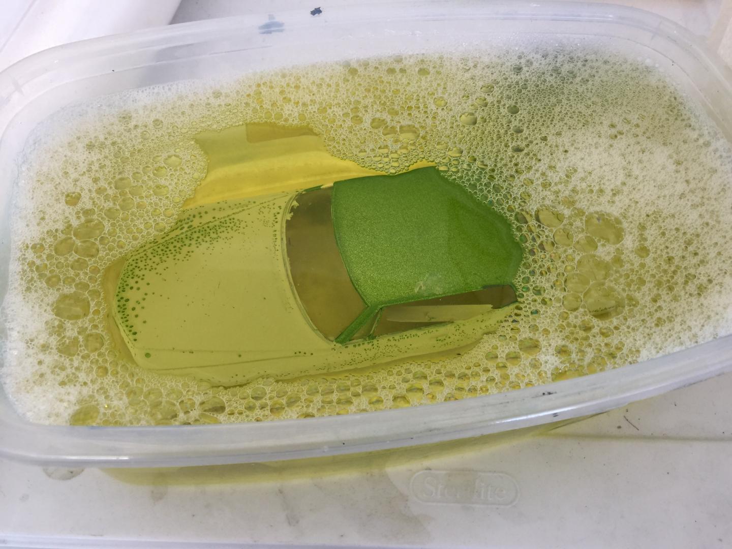

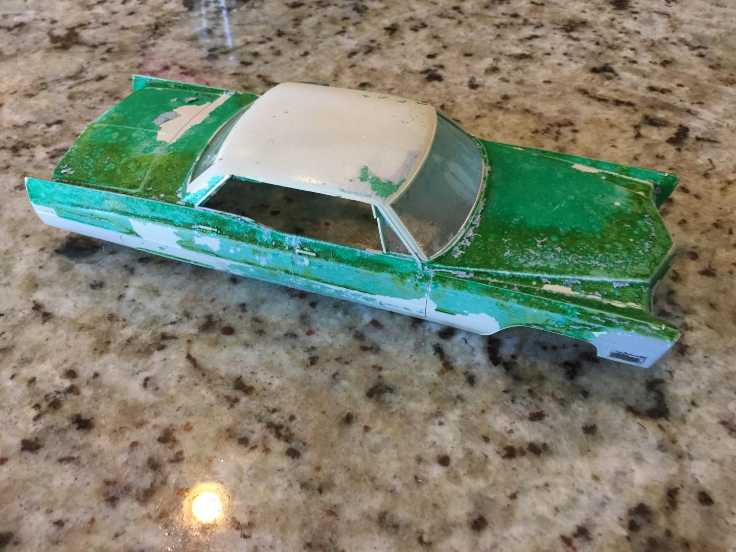

cpspoogie Posted April 21, 2017 Author Posted April 21, 2017 Thanks all, and yes MrO, you are absolutely right! I did not pay enough attention to that detail. My first Conversion to four door, so I've definitely learned from this one. Luckily it's not a contest build, so my cousin won't mind ha! I really appreciate all the comments, tips and advice from all of you! Unfortunately I had to dump the whole thing in the strip bath (looks like pee but it's Totally Awesome Cleaner from the dollar store). I chose the wrong paint and have since ordered the correct factory paint. More to come.
cpspoogie Posted April 23, 2017 Author Posted April 23, 2017 After two days in the bath, it still needs more stripping.

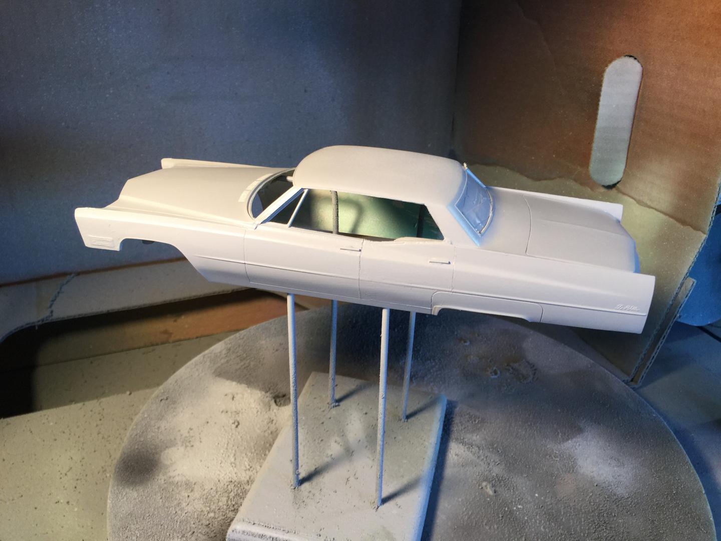

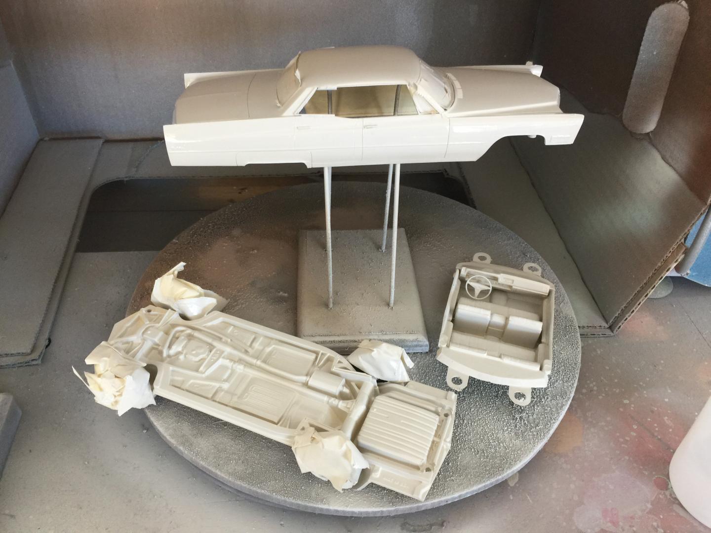

cpspoogie Posted April 27, 2017 Author Posted April 27, 2017 (edited) Stripped and re-primered. Waiting on factory paint and model "vinyl" top material. Edited April 27, 2017 by cpspoogie
cpspoogie Posted April 29, 2017 Author Posted April 29, 2017 Thanks Curt. I'm not real happy with the new door lines, but it was the best I could do. I've seen some really fantastic four to two door conversions, but I couldn't make it flawless. Oh well...I certainly don't claim to be a pro and I learn from every mistake. And all of you guys. Thanks! Chris
Can-Con Posted April 29, 2017 Posted April 29, 2017 Something else you should consider is the doors on a 4dr were shorter than a 2dr. That's giving you some proportion problems.
Ron Hamilton Posted April 30, 2017 Posted April 30, 2017 Interesting conversion. I bought a '68 caddy Coupe De Ville promo that had the A-Pillars broken. I can fabricate new pillars, so that will not be a problem.After seeing yours, I may try my hand at either a Sedan Deville, or a Fleetwood brougham, as I have a derelict '68 convertible body and another promo chassis.Keep up the good work.
cpspoogie Posted May 1, 2017 Author Posted May 1, 2017 That will be cool, Ron. It's not easy to do, and in retrospect I should have used a scoring tool for the new doors. An XActo is just too fine a line. For Can-Con thanks, I know these doors are shorter of course. I just eye balled them.

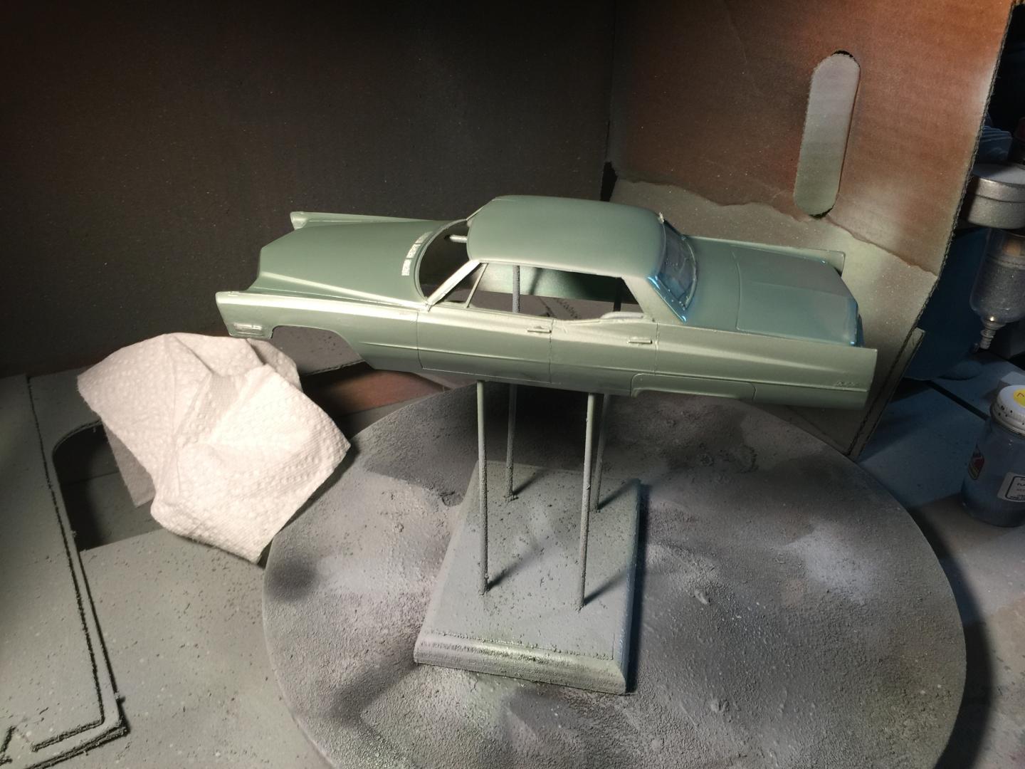

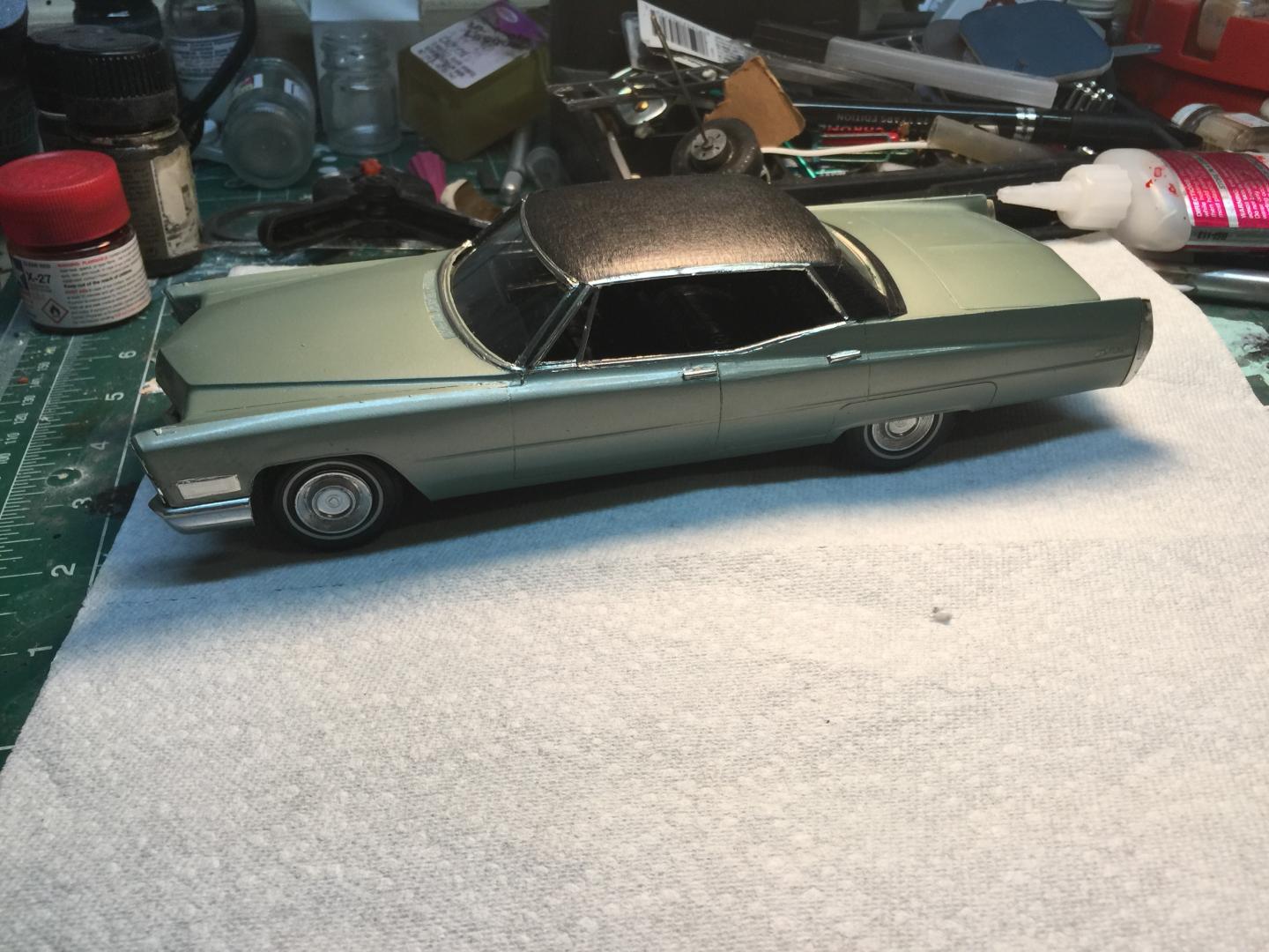

cpspoogie Posted May 2, 2017 Author Posted May 2, 2017 98% complete. Put vinyl top and drivers side BMF on. Definitely not contest level, but it's a gift for my cousin and I know he'll love it.
