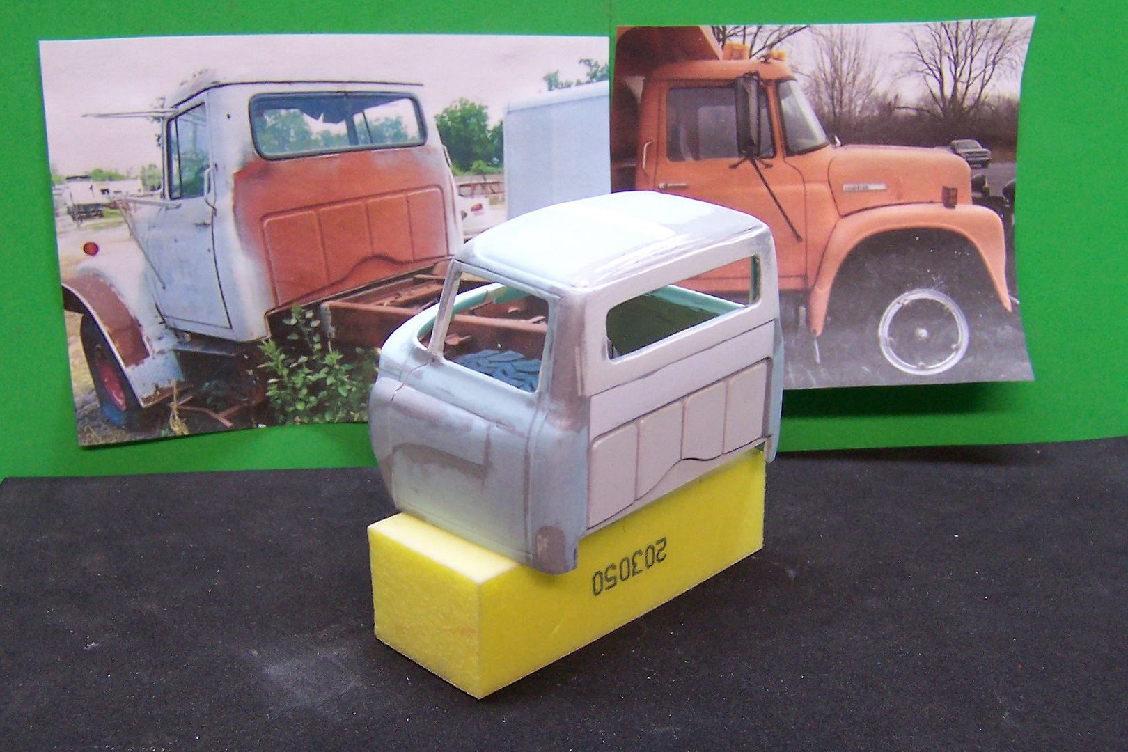

Chariots of Fire Posted May 20, 2017 Posted May 20, 2017 For a long time I have wanted to build an International Loadstar 1600 cab. They were used for all sorts of trucks from dump trucks to farm trucks to school buses and fire apparatus. The thing that has held me back until now is hoping that maybe one of the model companies would come out with one! Why they have never done one of them or a B Model Mack is beyond me. Anyway with some photos and measurements taken of the rig in the photo below I have begun to assemble information in the form of line drawings, checking and improving them as I study the Loadstar from various angles. Each time seems to reveal some little detail that needs adjustment. Looking around the kit stash I came across a 1953 Ford p/u cab that I think might be turned into a Loadstar. Using the dimensions, photos and the line drawings I'm now studying the Ford cab to see where cuts might be made and adjustments done to make the changes. The cab will need to be 1/4" wider overall so some cutting along the top and rear of the cab will be done salvaging the back in such a way that I can reproduce the sculptured effects in the back like the real one. The A post will have to change and by cutting away the fenders and reversing them left for right the sculpture line across the door and cowl can be done (I think!). Photos and descriptions will be posted as progress is made.

Chariots of Fire Posted May 26, 2017 Author Posted May 26, 2017 Began work on the cab. The shape is coming along. The A post is moved. Side sculpture on the doors is in place and I just finished cutting in the sculpture line around the top of the cab. Not quite ready for pix yet but when it is I will be posting.

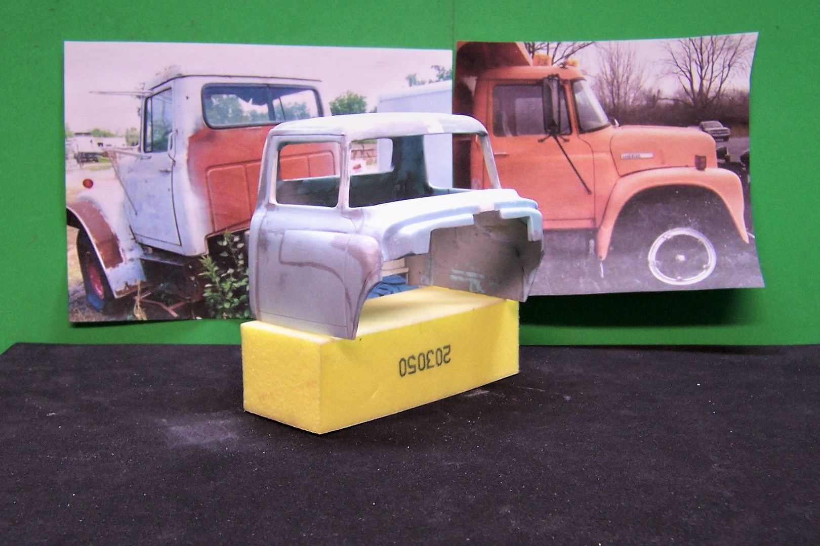

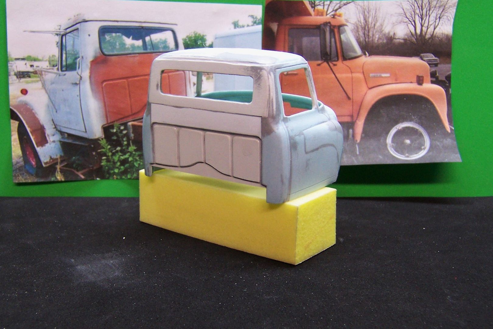

Chariots of Fire Posted May 27, 2017 Author Posted May 27, 2017 (edited) As I mentioned there is now enough done to show some of the work done on the cab. The Revell 1953 Ford pickup kit was the donor for the cab. The front fenders were cut loose and reversed to form the front of the doors. The top and rear of the cab have been modified and the whole thing has been widened out 1/4". There is still some cleanup to do. The interior of the cab needs some cleanup as well to smooth out the seams. Some two part resin will be poured around the interior of the top and the inside of the doors to make good smooth surfaces. The goal is to make the cab with as few hard surfaces as possible so as to make casting easier. Edited May 27, 2017 by Chariots of Fire
