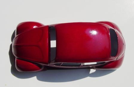

TarheelRick Posted May 27, 2017 Posted May 27, 2017 This is a candy scarlet over a base metallic red.
