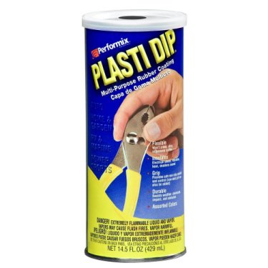

935k3 Posted May 29, 2017 Posted May 29, 2017 I doubt it is much different than plasti dip seen below. It will go bad very quickly before you use it all. I would not waste the money on it.
peteski Posted May 29, 2017 Posted May 29, 2017 It won't work very well. It is a solvent-based rubber material which will shrink as it dries (hardens). Unless the mold is very thin, the drying process will be very long and the shrinkage will be very noticeable. RTV rubber mold material hardens by a chemical reaction (not solvent evaporation), so there is no appreciable shrinkage and it will set in thick layers.

Mike Chernecki Posted May 31, 2017 Posted May 31, 2017 If it is anything like Plasti Dip, it will dissolve any plastic it comes in contact with.
Art Anderson Posted May 31, 2017 Posted May 31, 2017 If it is anything like Plasti Dip, it will dissolve any plastic it comes in contact with.Here's a link to Flex Seal's MSDS (Manufacturer's Safety Data Sheet). Note that its solvents are petroleum distillates--which generally are death to polystyrene plastic. http://www.mcoe.us/view/1668.pdfArt
