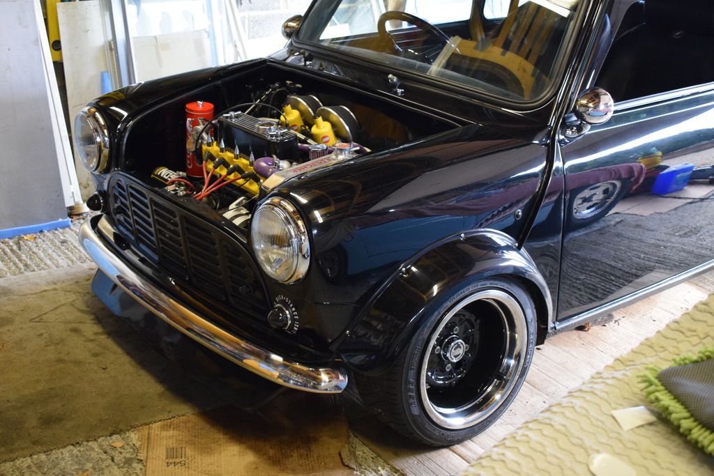

Chris1992 Posted May 30, 2017 Author Posted May 30, 2017 There are some Japanese 14" steel wheel sets available that could possibly be turned down to 13", and a new bead fabricated from thin sheet styrene, too. These look perfect!! I doubt you would even notice the size difference at such a small size, do you have a link to them? Here's a set of 13" staggered Fujimi's (with slick racing tires) that could possibly get you in the ballpark too, maybe by removing the centers and substituting pressed-steel-look centers from something else, as I suggested above. I had actually seen the Fujimi's, and am definitely considering them if I can't get anything closer. Excellent idea regarding swapping the centers though. Thanks very much for the help so far guys! Some excellent suggestions here! The problem I have is that funds are a lttle tight at the moment so I cant really justify buying an entire kit just fot the wheels, as much as I would like too! Here is a pic of my car so you can see what I'm getting at. Not the best photo but you can get the idea.
Foxer Posted May 30, 2017 Posted May 30, 2017 That Mini's paint looks to die for! .. razor sharp reflections.I hope you start an On the Workbench thread so we can watch your build. The fact that this is one of yours make it even better!
Chris1992 Posted May 30, 2017 Author Posted May 30, 2017 That Mini's paint looks to die for! .. razor sharp reflections. I hope you start an On the Workbench thread so we can watch your build. The fact that this is one of yours make it even better! Thanks dude! I appreciate it. makes all the hard work worthwhile I shall do indeed! When I get some free time to actually make a start lol. I've already started a mkIV Toyota Supra Tamiya kit which will be a replica of my dad's car, so I'll get that one out of the way first. Not to mention that I'm still working on the real car!

peteski Posted May 31, 2017 Posted May 31, 2017 (edited) That is one awesome looking Mini Cooper (and cute as hell too)! I drive a Scion xB (the 1st generation Toyota bB, aka. "the box"). It is a small car on American roads full of giant SUVs. Couple of years ago I was driving on a highway when I came upon a stock (unmodified) Mini Cooper like yours. It was so much smaller than my (already small) car. As I got closer I noticed a sticker on the rear window. It read "Yeah, it's got a HEMI". I never laughed so hard!BTW, there seems to be a shark's mouth on the blue vehicle reflected in your Mini - what is that? Edited May 31, 2017 by peteski

Chris1992 Posted May 31, 2017 Author Posted May 31, 2017 That is one awesome looking Mini Cooper (and cute as hell too)! I drive a Scion xB (the 1st generation Toyota bB, aka. "the box"). It is a small car on American roads full of giant SUVs. Couple of years ago I was driving on a highway when I came upon a stock (unmodified) Mini Cooper like yours. It was so much smaller than my (already small) car. As I got closer I noticed a sticker on the rear window. It read "Yeah, it's got a HEMI". I never laughed so hard! BTW, there seems to be a shark's mouth on the blue vehicle reflected in your Mini - what is that? Thanks a lot! I often forget how tiny it is haha. Even here in the UK it looks miniature compared to some of the cars we have on the roads. The car in the reflection is one of my dad's toys; his 1959 Austin Healy Frogeye Sprite. It'e been in the family for generations. The shark mouth was added for a bit of fun for a road trip through France for the Le Mans 24hrs Here's a better pic of it, alongside my Mini before the full rebuild. Thanks again for all the help guys! I knew joining this forum was a good idea
