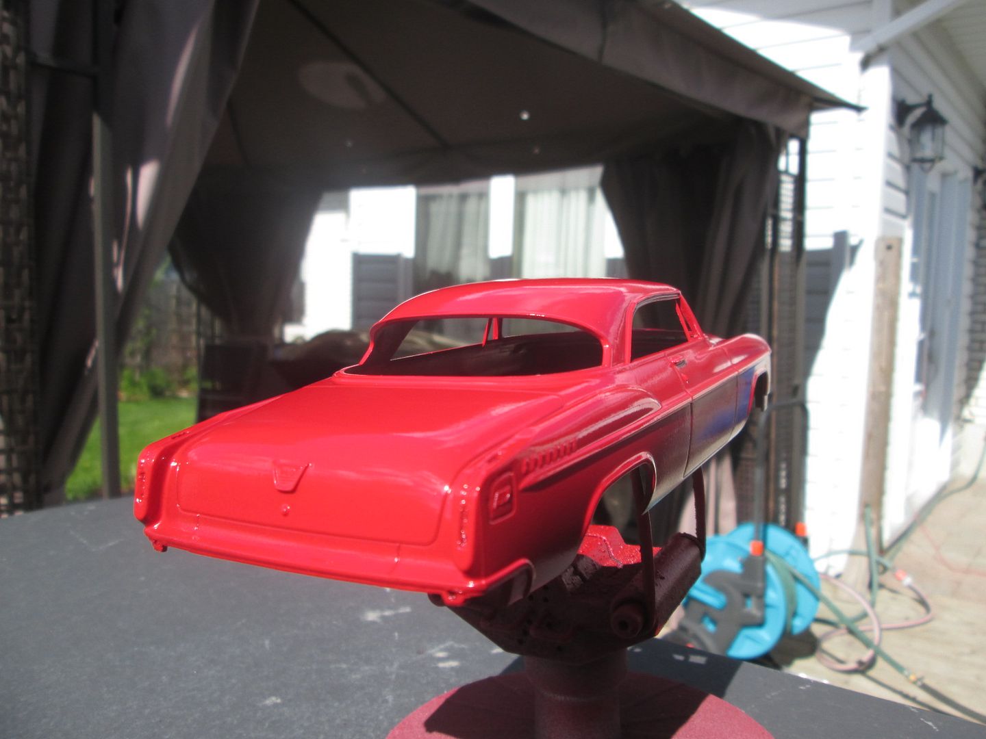

landman Posted June 4, 2017 Posted June 4, 2017 (edited) My cousin brought me his 1955 Chrysler 300 asking if I could do something about his paint. It is a well built model with a hand brush paint job. It has been carefully dismantled, stripped and is now in primer. Edited December 3, 2020 by landman
mod3l Lover Posted June 5, 2017 Posted June 5, 2017 Hey Pat, What do you use for removing paint? David S.
426-Hemi Posted June 5, 2017 Posted June 5, 2017 I'm NOT Pat, but it looks to be Purple Power Cleaner, or a derivative there of.....HEY David!!!!!
landman Posted June 5, 2017 Author Posted June 5, 2017 Hey Pat, What do you use for removing paint? David S. John's correct here. It is Purple Power.

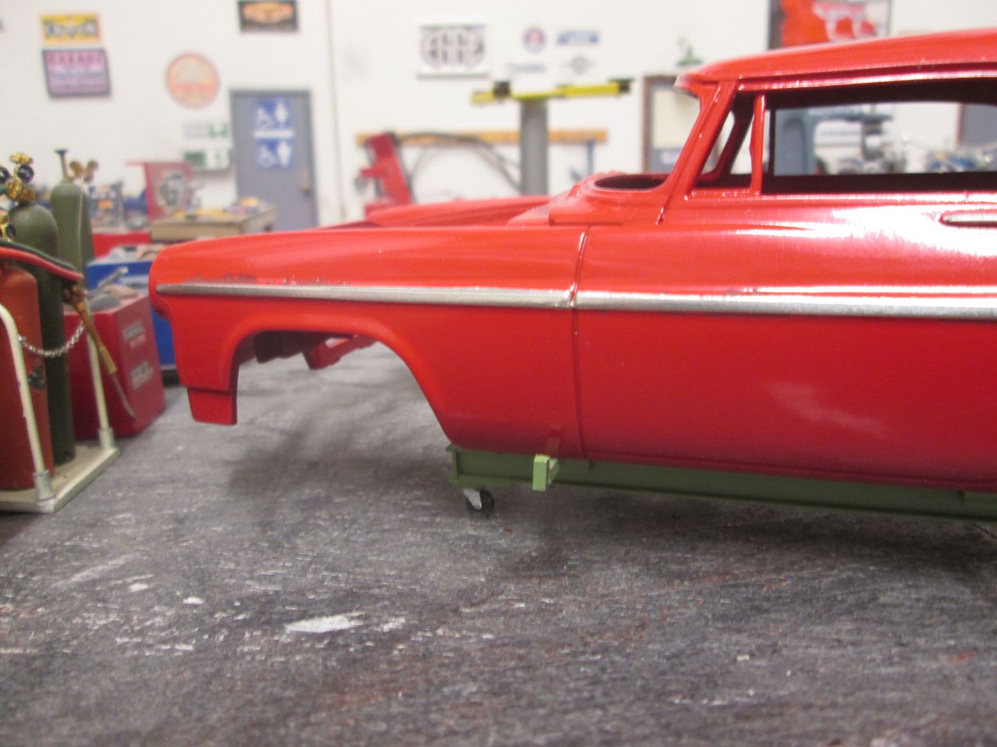

landman Posted June 5, 2017 Author Posted June 5, 2017 (edited) Foiled the emblems then shot it with Duplicolor bright red. Had a run which I wiped off. Looks like it will be salvageable. Edited December 3, 2020 by landman
mod3l Lover Posted June 5, 2017 Posted June 5, 2017 Thanks for the replies! I have tried brake fluid and wasnot happy with how that turned out. It looks real nice Pat! And howdy John!! David S.
landman Posted June 5, 2017 Author Posted June 5, 2017 (edited) Gave it another coat. This time Krylon. Edited December 3, 2020 by landman
426-Hemi Posted June 5, 2017 Posted June 5, 2017 Pat,That sure is looking GOOD!!!!! NICE repaint!!!!! Going all red I take it (using Krylon) and then just BMF'ing all the trim? Thats gonna look some sharp!
landman Posted June 7, 2017 Author Posted June 7, 2017 (edited) Started on the foil. Pulled up some paint. Either I'm burnishing too wide or it isn't cured or worse I have poor adherence. I'll give it a few more days. Edited December 3, 2020 by landman
Curt Posted June 7, 2017 Posted June 7, 2017 My guess would be the Krylon isn't playing nicely with the Duplicolor.
landman Posted June 7, 2017 Author Posted June 7, 2017 My guess would be the Krylon isn't playing nicely with the Duplicolor. Very likely.
426-Hemi Posted June 7, 2017 Posted June 7, 2017 Yep Krylon is the culprit here..... its reacting with the Duplicolor! (Not adhering) That paint, UNLESS your using it as a base, and then scuffing it to be a flat, to then spray over it with the SAME color, doesn't play well with others...... ALSO it can react to the adhesive on the BMF too! Believe it or not, it DOES...... Somehow that little adhesive leaches into the paint under it, as there had seemed the last time I tried using a adhesive backed stripping, on Krylon paint, lifted as the stripe was trimed and the trimmings removed, took the paint with it! So a couple things could be an issue here, BUT Krylon paint is the start of both issues! I'd almost BET money I ain't got on it...... Reason I'm trying to get rid of as much Krylon paint as I can that I have..... It doesn't do well for craft uses.....
