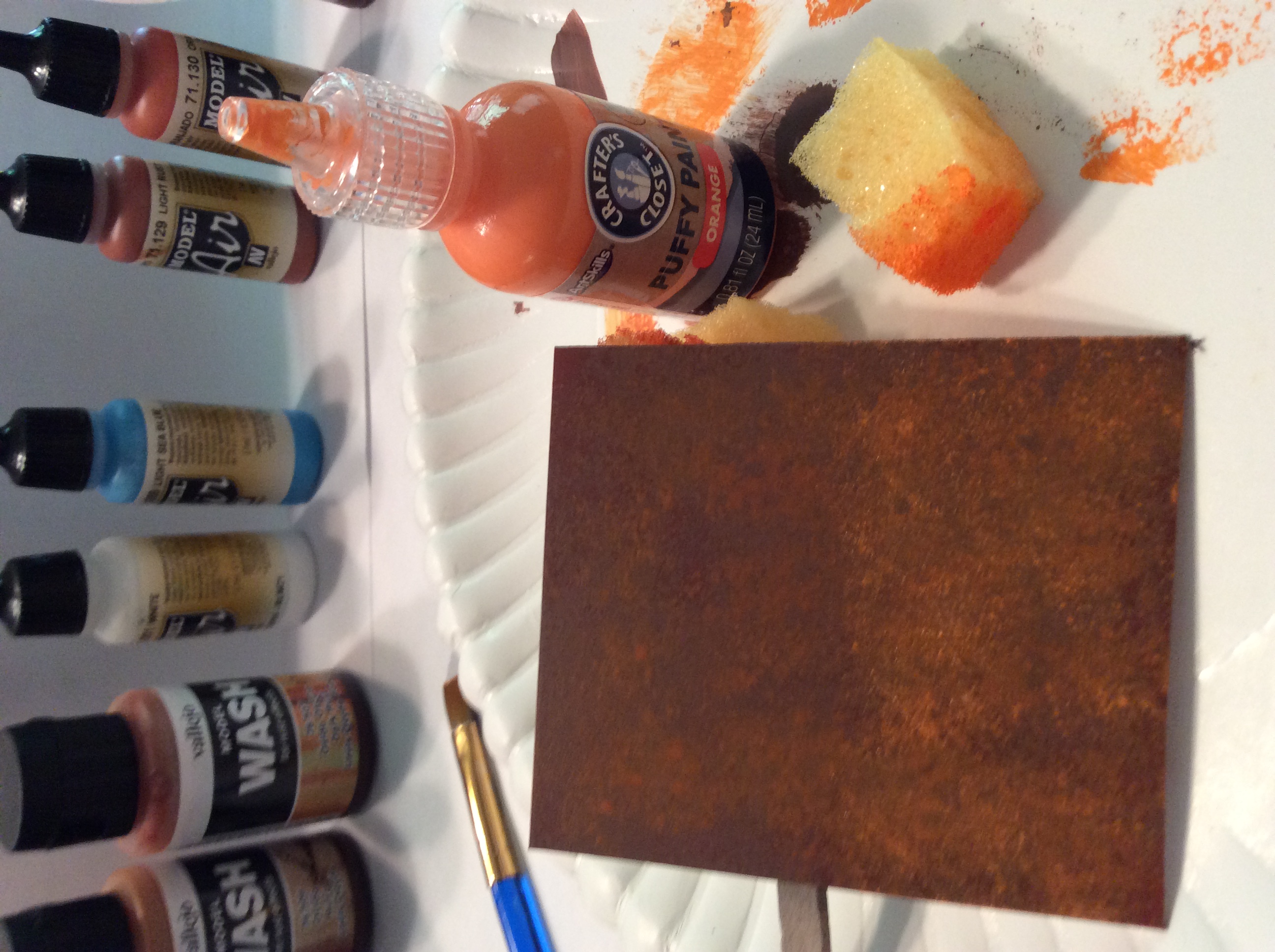

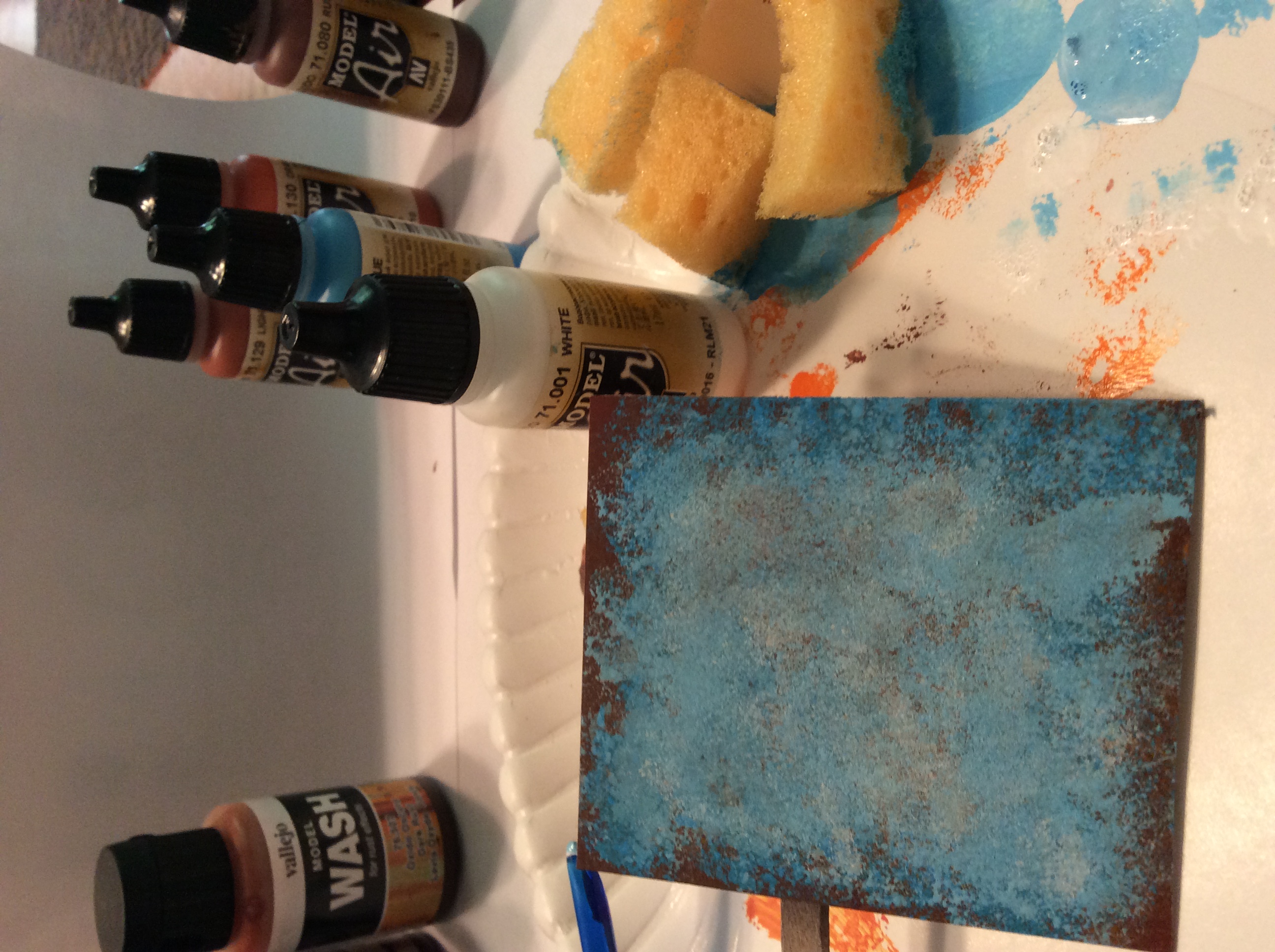

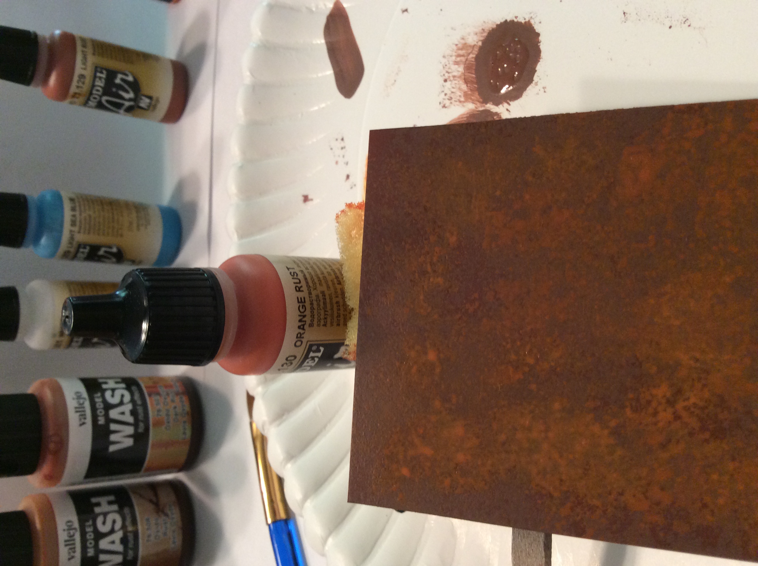

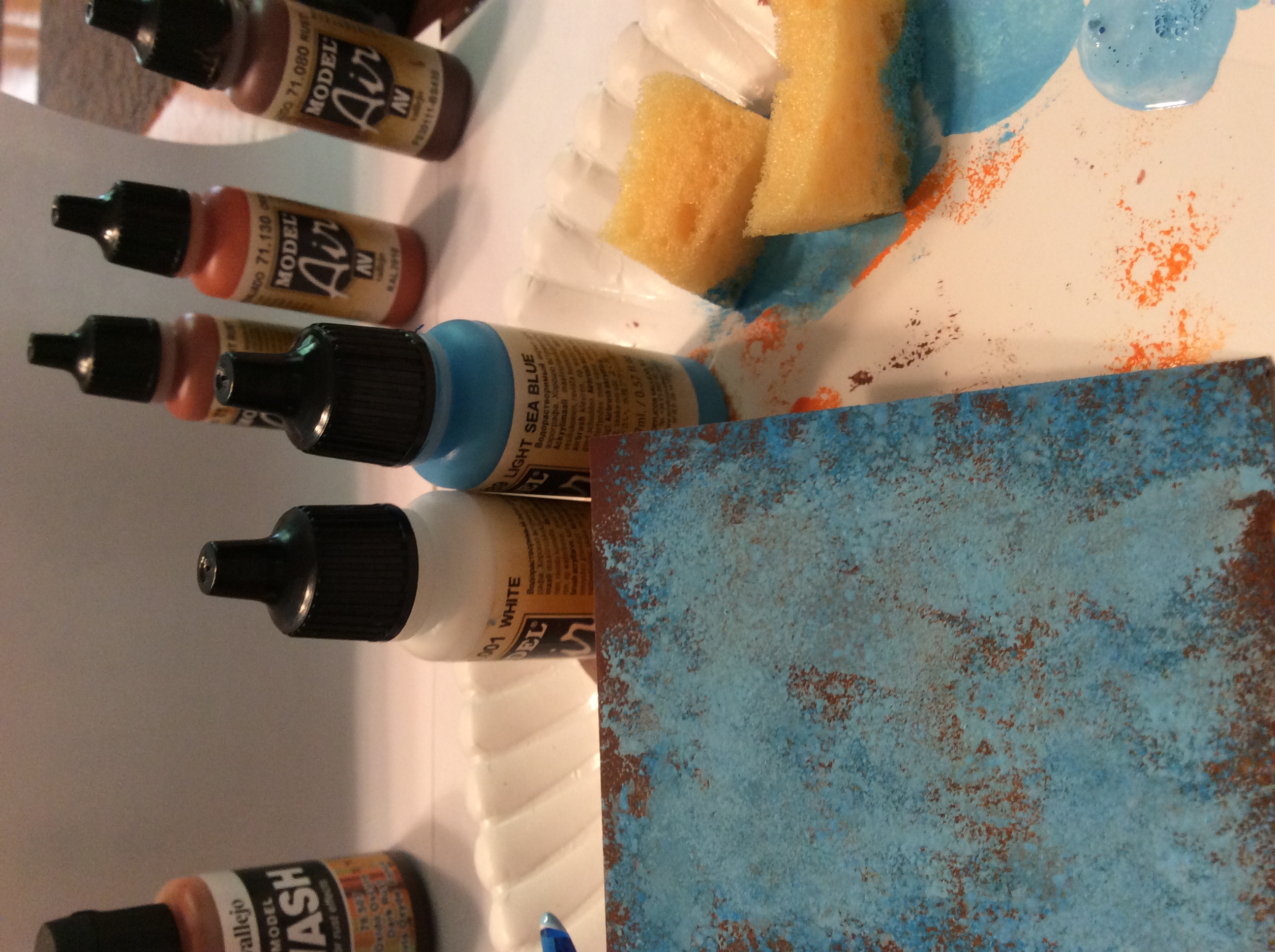

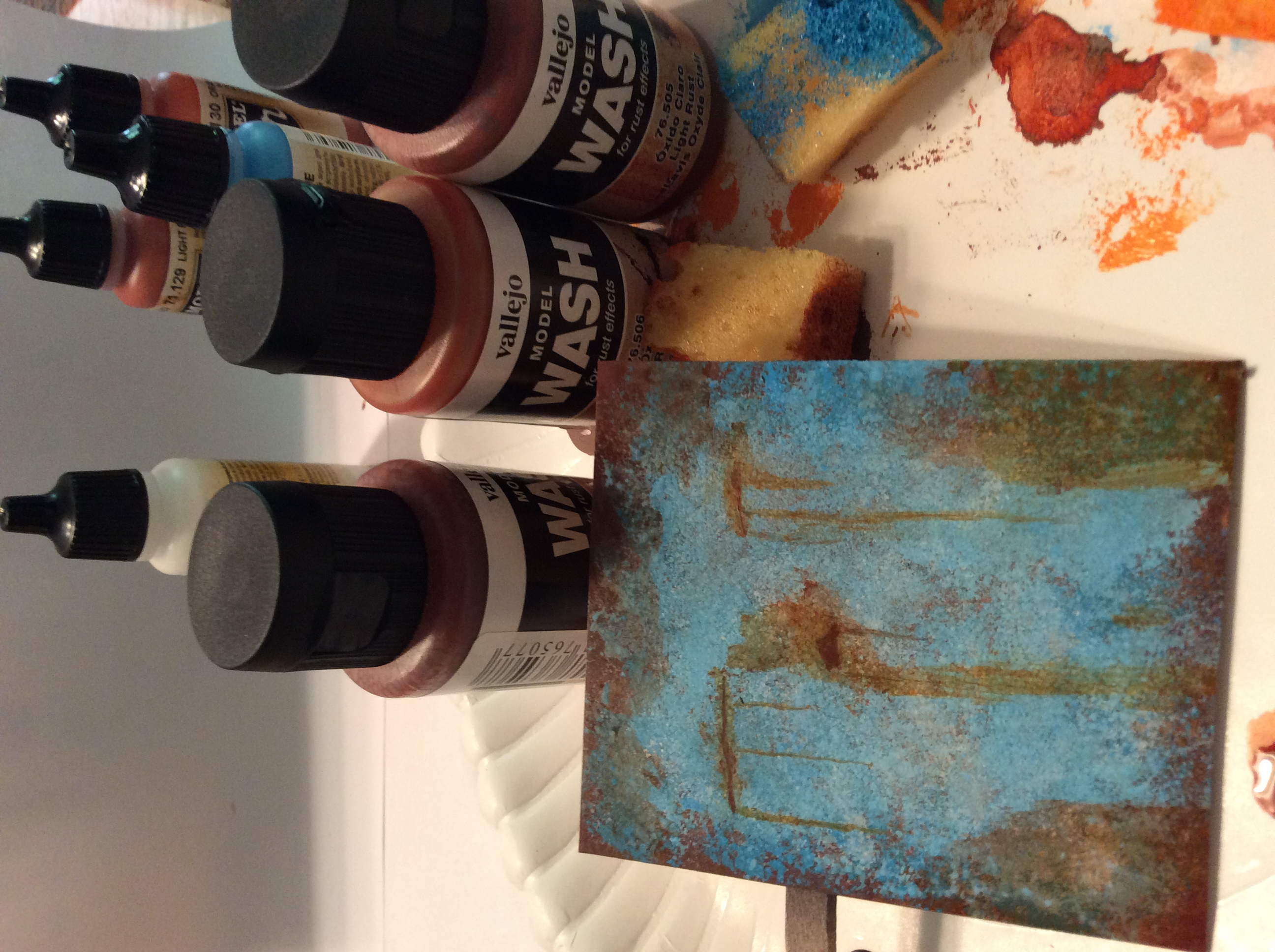

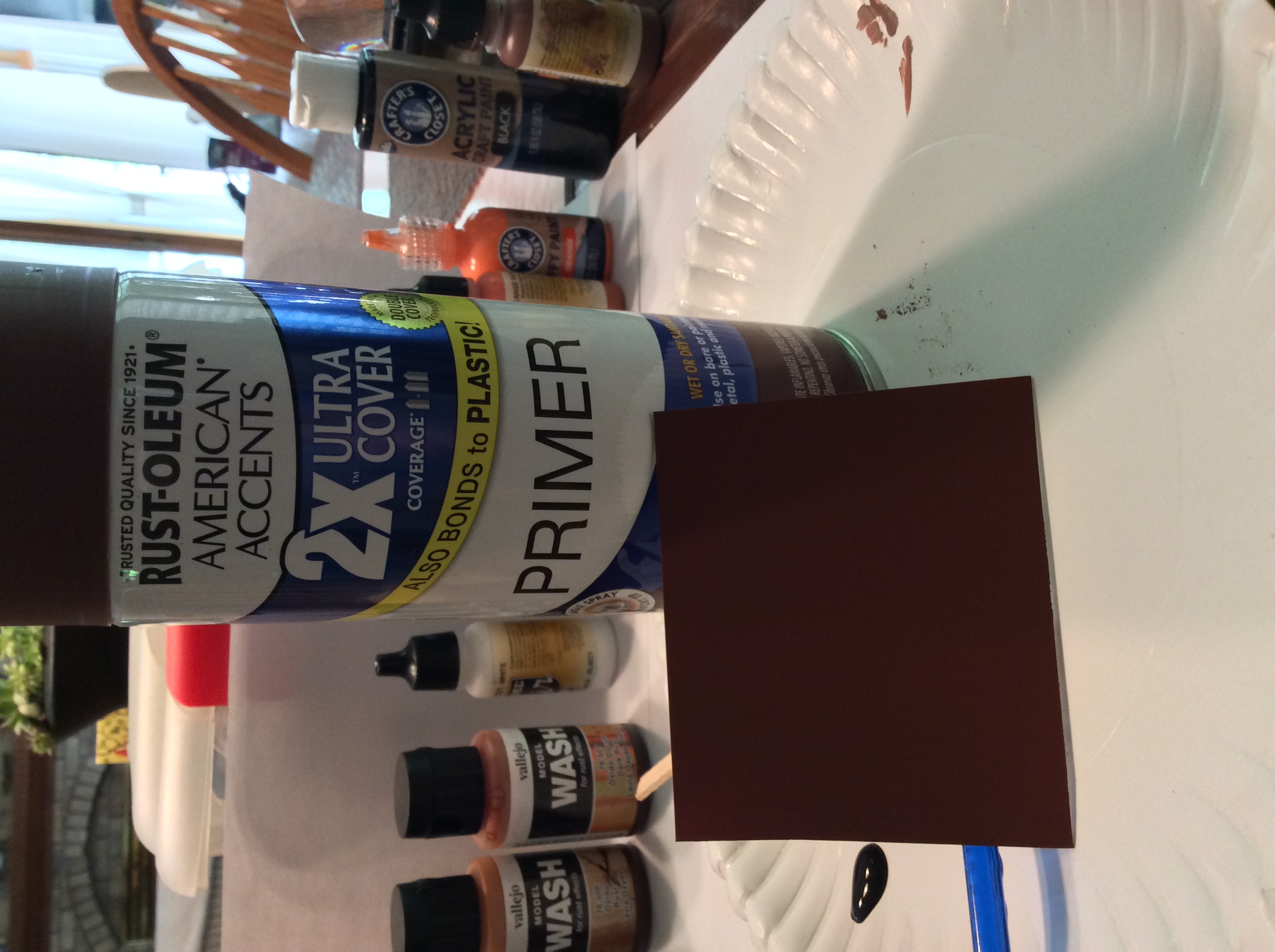

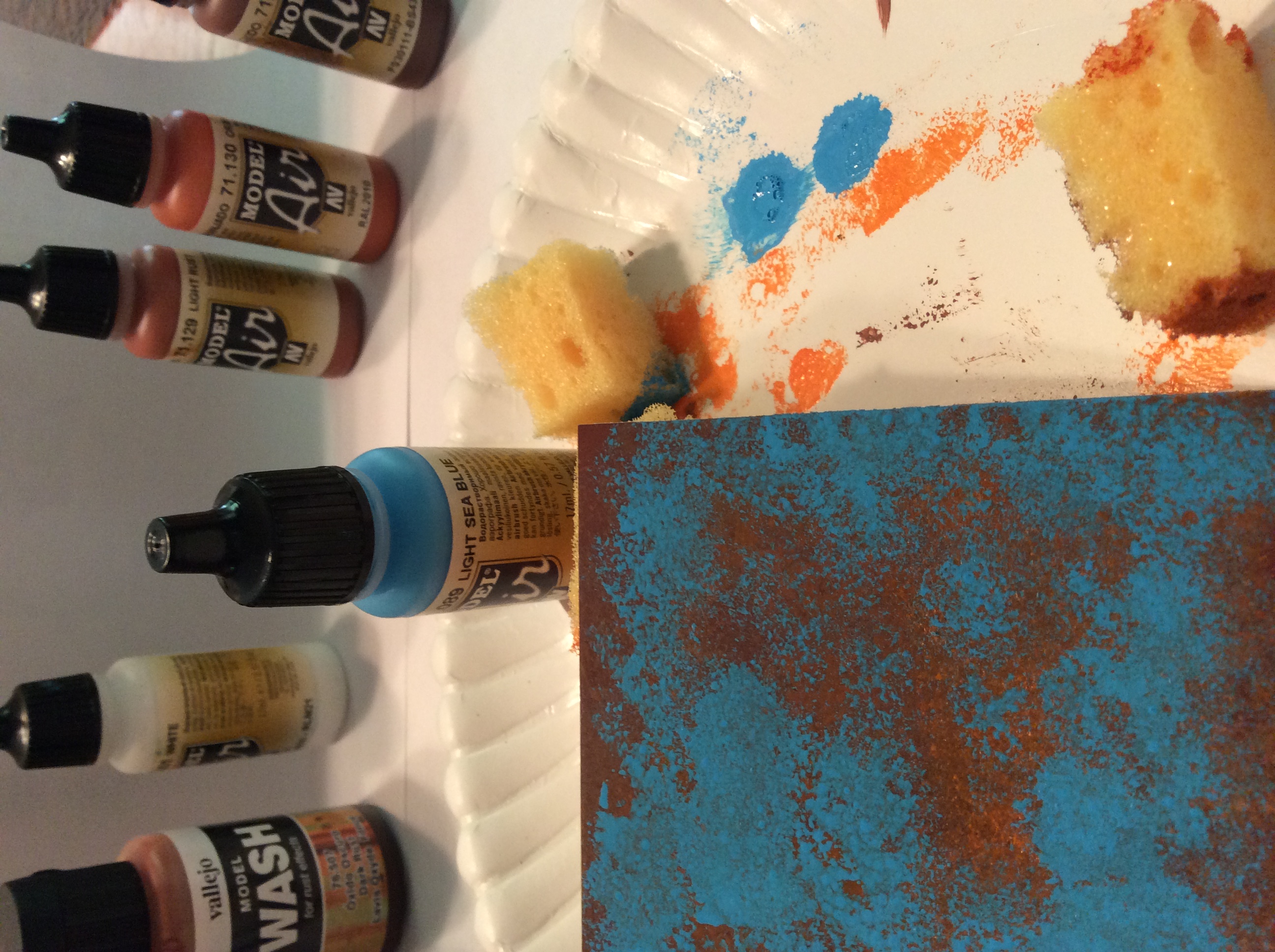

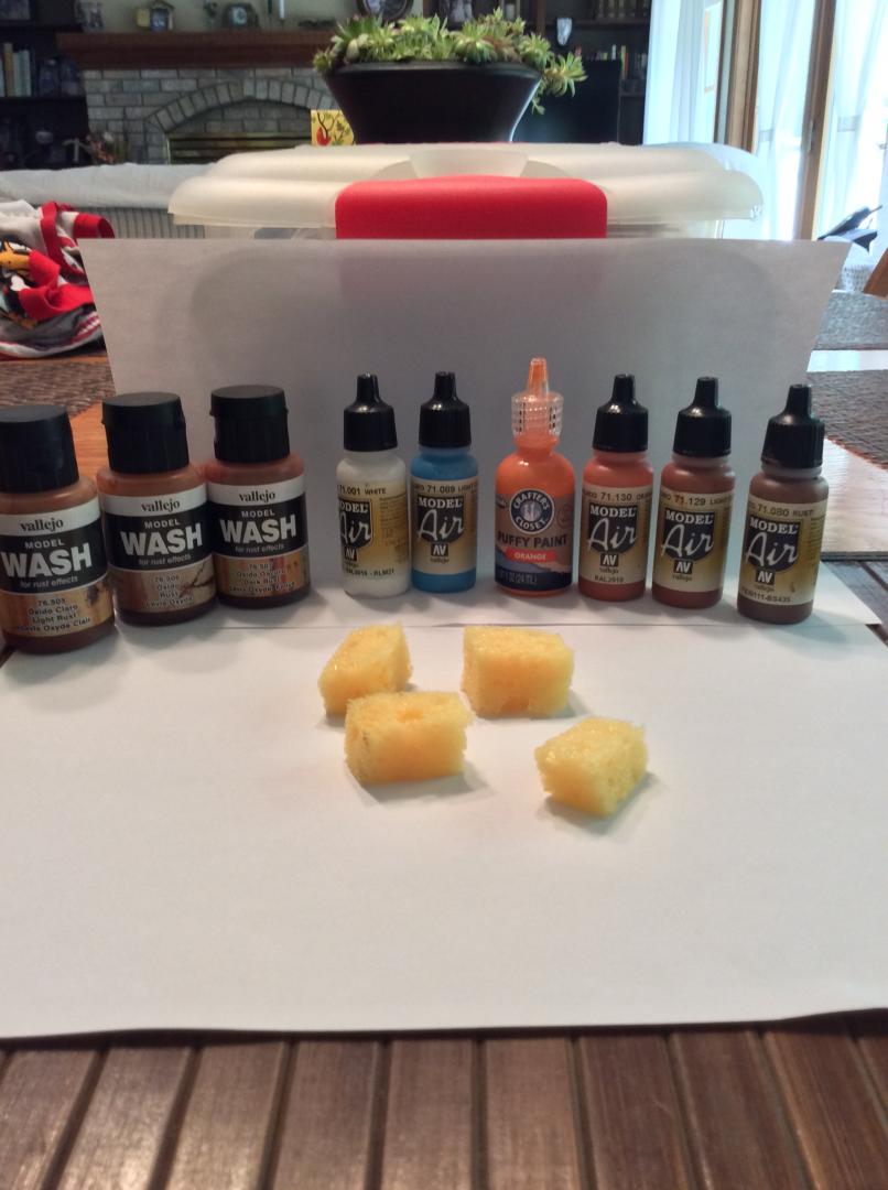

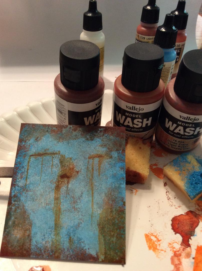

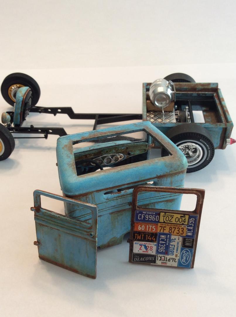

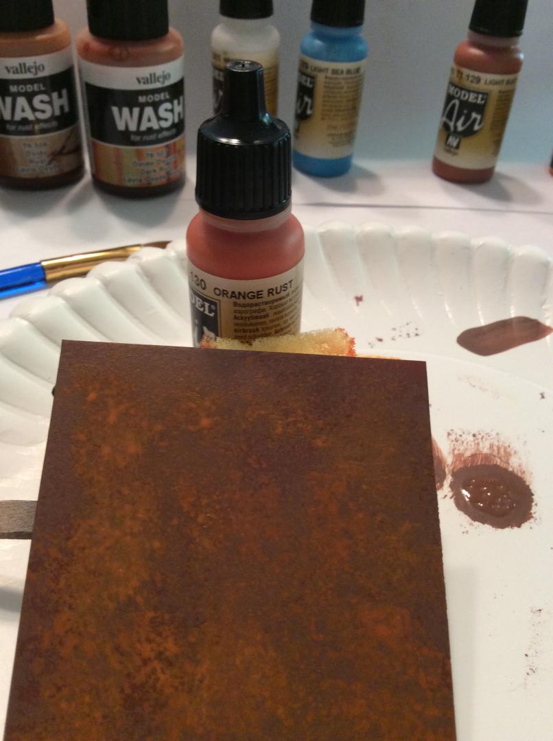

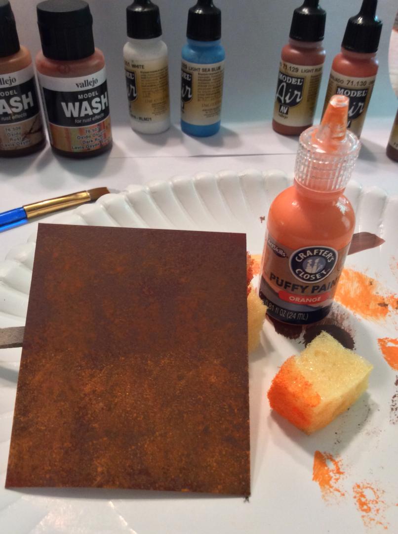

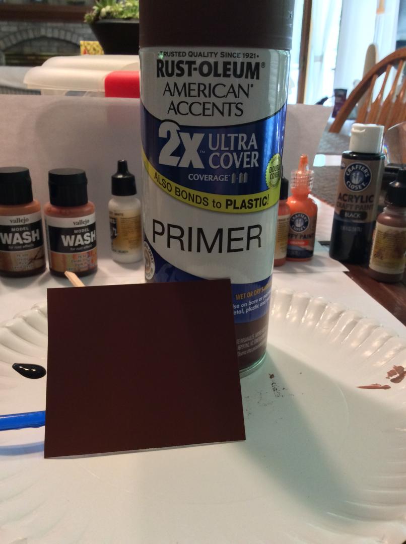

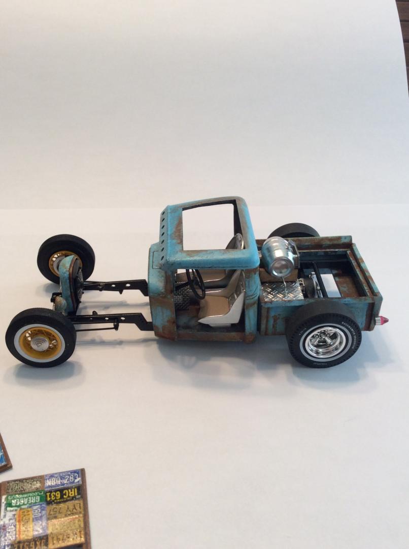

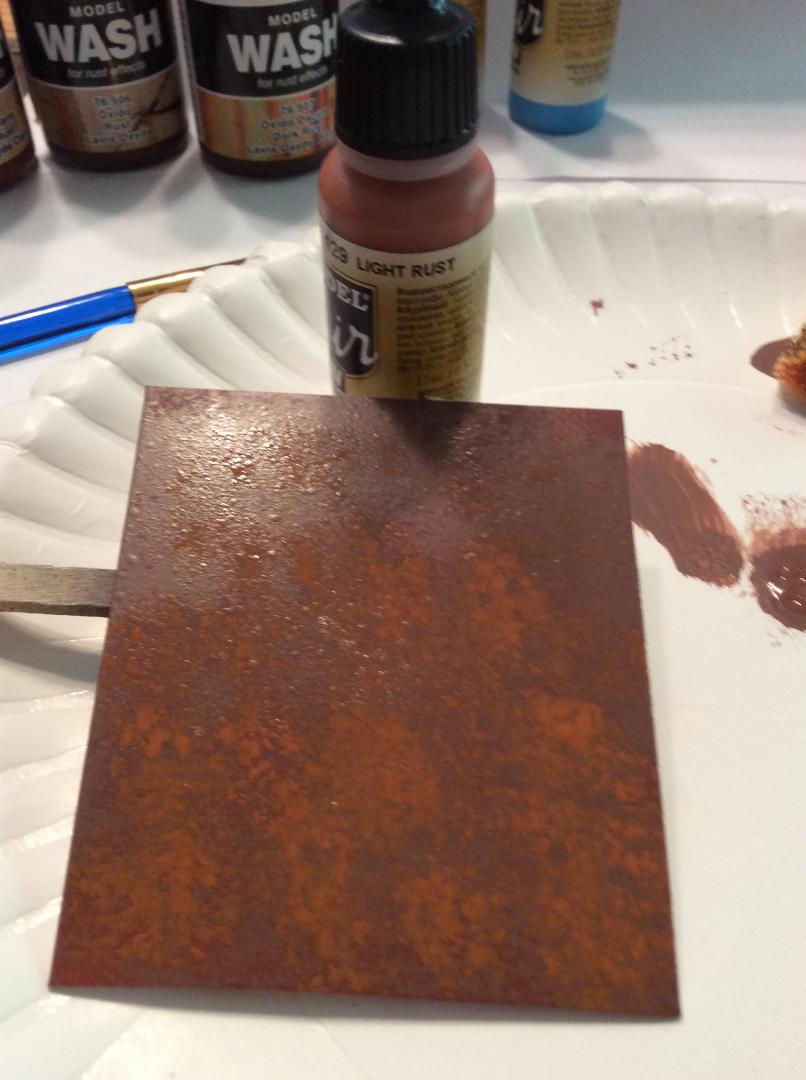

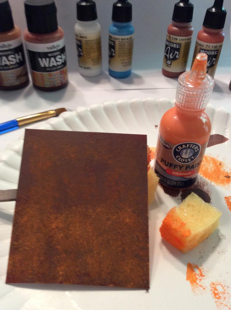

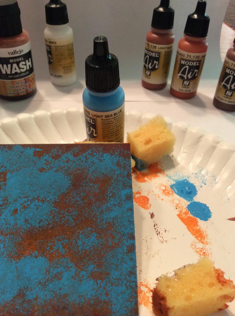

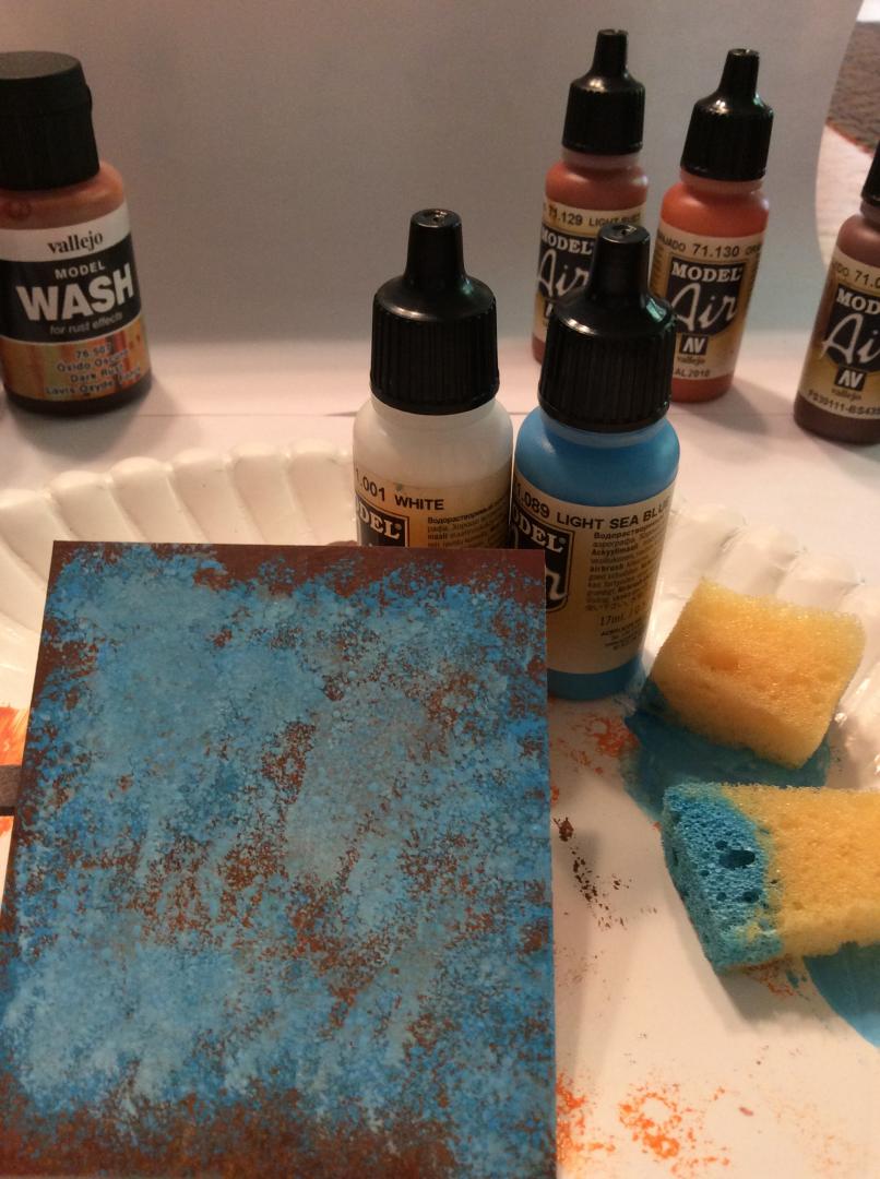

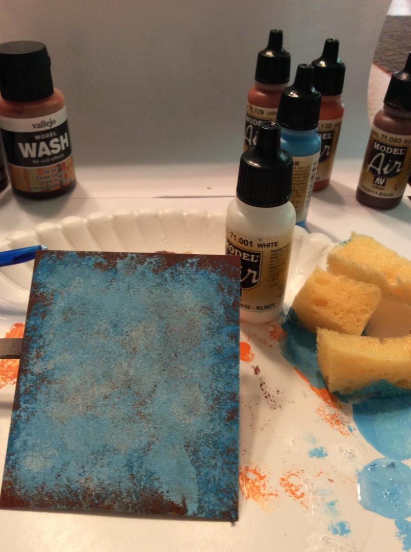

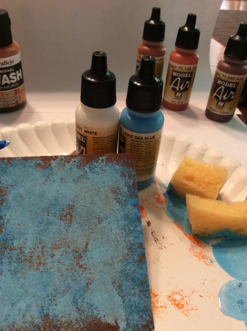

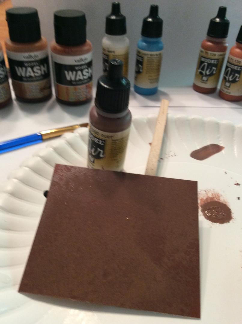

lou s Posted June 15, 2017 Posted June 15, 2017 (edited) Rust paint job using water based paints and a sponge.easy to do with good results.never cover previous coat.if using a hair dryer it only takes about a half hour start to finish. Step 1 primer step 2 rust step 3 light rust step 4 orange rust step 5 orange step 6 blue step 7 50-50 blue white step 8 75-25 white blue step 9 white step 10 washes bottom left dark rust,bottom right light rust,top rust,and streaks light rust. Edited June 15, 2017 by lou s

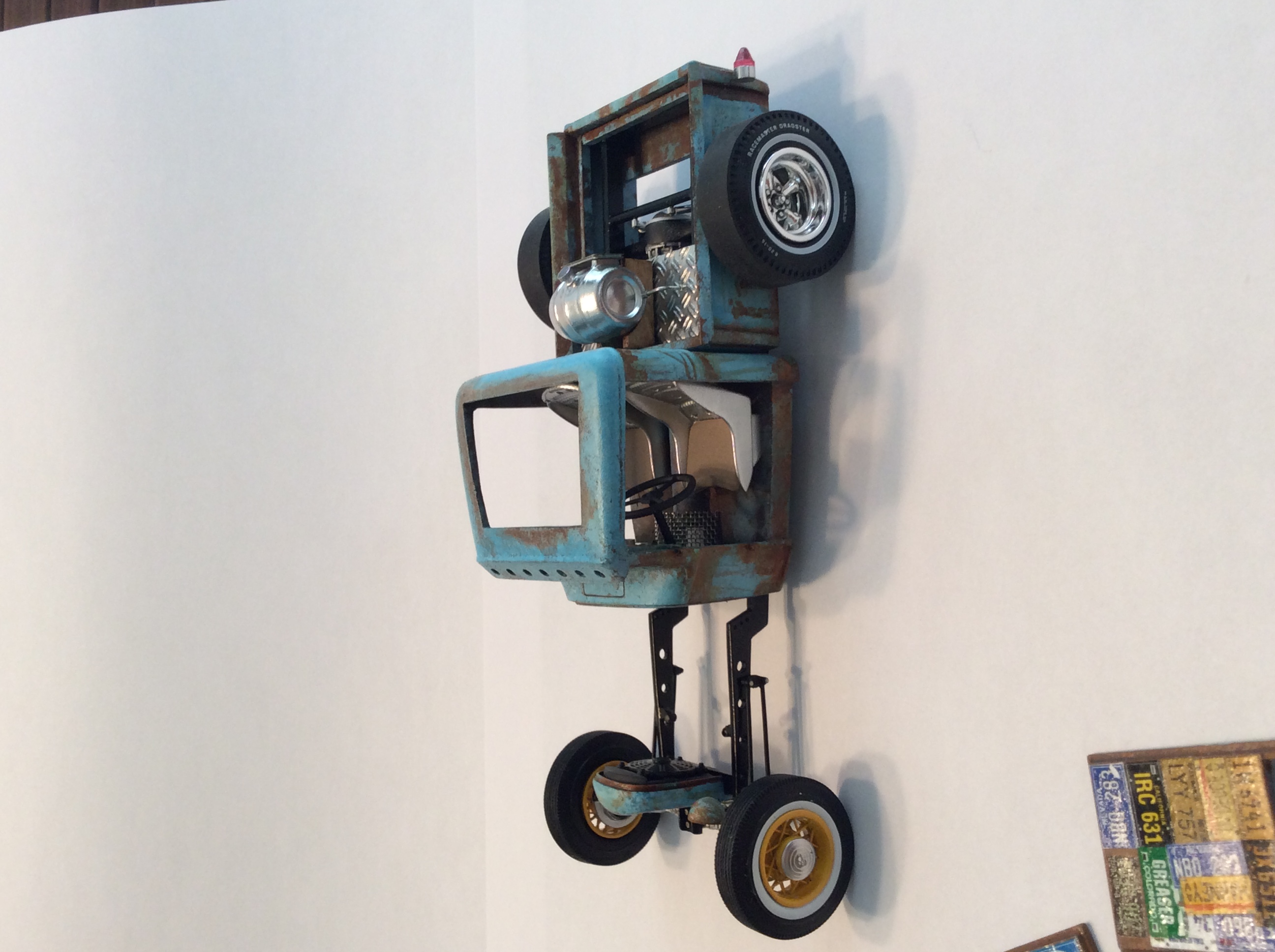

BigTallDad Posted June 20, 2017 Posted June 20, 2017 Great tutorial.You used several shades of blue during the process; is this because you were weathering a blue model?What if the model was a different color, let's say yellow?
lou s Posted June 20, 2017 Author Posted June 20, 2017 I used different shades of blue to try and duplicate fading and weathering of the oringinal blue paint job. If you wanted to use on another base color like yellow I think you would use the same proses .start with the yellow and then lighten it up or dilute the yellow as you go to replicate a sun/ weather beaten paint job.
