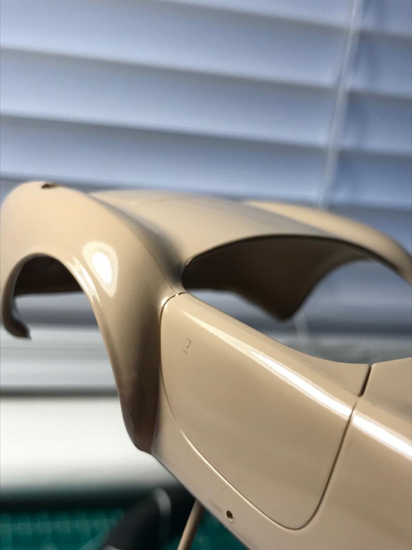

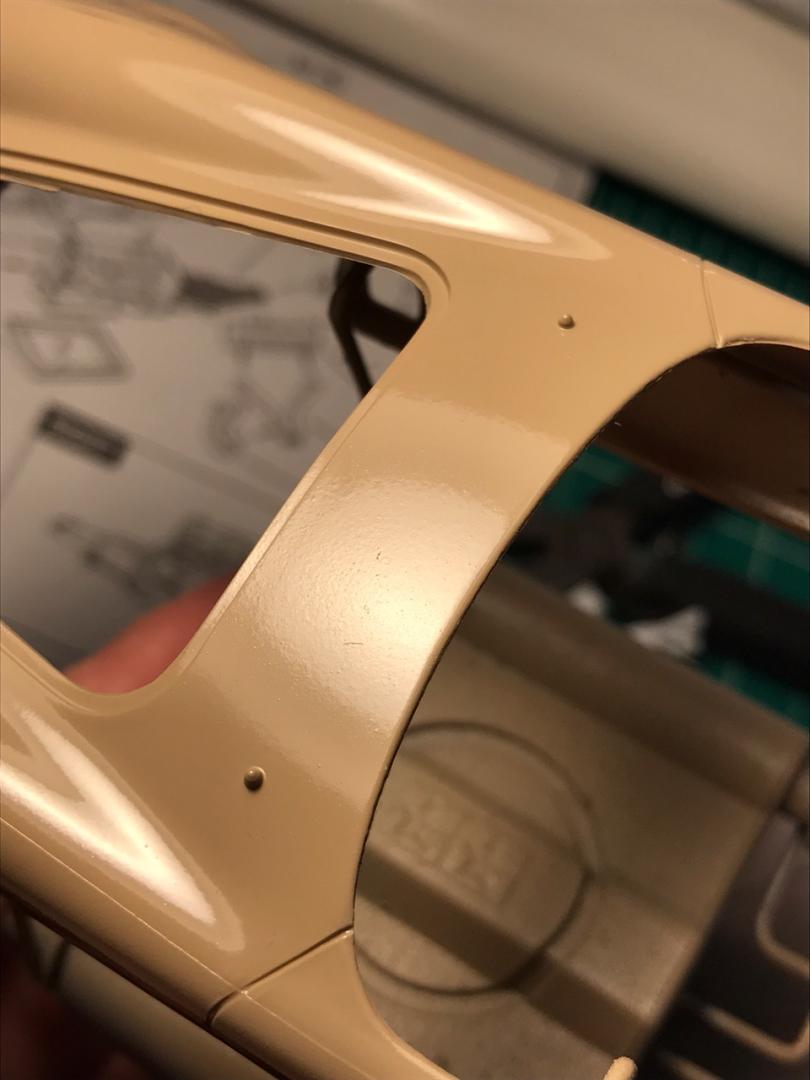

1hobby1 Posted June 16, 2017 Posted June 16, 2017 Hello All, So this is a question that I am sure has been asked before but I am looking for some advice on this. To start I use the Don Yost method, I use the small Testors enamel bottles mixed 50/50 with lacquer thinner and spray anywhere from 30-40psi through a Paasche model H and Harbor Freight compressor until the body is covered. I do have some spots that seem to have some orange peel and even some dust. Other spots look good, for me at least haha. I plan on clear coating the car with Rustoleum automotive enamel clear. My question is, is it ok to sand out the imperfections starting with 4,000 or 6,000 grit working up until 12,000? Or should I clear the vehicle as is and polish it after? Has anyone ever had this happen and resolve it? Thank you!
High octane Posted June 16, 2017 Posted June 16, 2017 While I haven't seen the Don Yosst video for a few years, I thought that the mix ratio was more like 66%/33% if I'm not mistaken. Also, I would let the paint dry thoroughly and then polish out the body using 4,000 thru 12,000 grits before washing it and spraying my clear. I also use a tack rag before I start spraying the body as well. I hope this helps.
BigTallDad Posted June 16, 2017 Posted June 16, 2017 The paint should be as perfect as can be before you clear it.
Snake45 Posted June 16, 2017 Posted June 16, 2017 To be very honest with you, your best move at this point would be to strip all your paint, sand off all those molding lines, and then paint again. Whether or not you try to fix your paint "blemishes" and then clear-coat, when you polish, you're going to eventually "rub through" on those molding lines, and then you'll have to fix THAT. And even if you don't, the molding lines are so apparent to the eye that no one is going to notice any dust or other paint-boogers. You've got the right paint equipment, and are well along toward mastering the "right technique." (I use a variation of the Yost method myself, to spectacular effect.) But the best paint job in the world can't cover up bad bodywork. You seem to have the talent and the skill to do good work. With just a little effort, you could be doing GREAT work. I know this post might seem at first to be a bit of a "downer," but I am trying to help and encourage you here. Really!
Miatatom Posted June 16, 2017 Posted June 16, 2017 I agree with Snake. Polishing will make the paint look like a million but the mold lines will be even more noticeable. Also like Snake said, yes, you'll probably sand/polish through the paint there too. I've stripped quite a few bodies in my time and will probably do so again. You really did a great job of laying the paint down for a first timer. Attention to detail with good body prep will make you a great builder.
High octane Posted June 16, 2017 Posted June 16, 2017 Now that I looked at your photos again, I see what the guys are saying about the mold lines and they are right. They gotta go.
StevenGuthmiller Posted June 16, 2017 Posted June 16, 2017 Now that I looked at your photos again, I see what the guys are saying about the mold lines and they are right. They gotta go.Yeah, that's the first thing that I noticed.The paint looks pretty good, but it really makes no sense to put a lot of effort into the paint with all of those mold lines.Kind of defeats the purpose. Steve
Snake45 Posted June 16, 2017 Posted June 16, 2017 Yeah, that's the first thing that I noticed. Steve Yup. See what I mean? It's the first thing a skilled/experienced modeler sees, and after that, he's not too interested in the rest of the model. In any kind of contest or competition, those mold lines will take you out of consideration instantly. Very soon, YOU will be one of those guys who sees and can't stand those mold lines, too. As I said, you've got the right equipment, you've got the skills, and apparently you've got the desire to do a good job and produce a GREAT model. Drive on!
1hobby1 Posted June 17, 2017 Author Posted June 17, 2017 (edited) Thank you for all the advice. I am definitely still going to try and polish it off. Just want sure if it has been done before without ruining the paint. More than likely I am going to mess up and that will lead to me stripping and removing the mold lines and repainting haha but at least this will be good practice for if it happens again.I greatly appreciate all the positivity on the post and the help. I will upload after photos of the process. Thank you once again! Edited June 17, 2017 by 1hobby1
Muncie Posted June 18, 2017 Posted June 18, 2017 Thank you for all the advice. I am definitely still going to try and polish it off. Just want sure if it has been done before without ruining the paint. More than likely I am going to mess up and that will lead to me stripping and removing the mold lines and repainting haha but at least this will be good practice for if it happens again.I greatly appreciate all the positivity on the post and the help. I will upload after photos of the process. Thank you once again!That's a good plan - the Testors enamels are really soft and the mildest polish will be best - maybe even as mild as something like Meguiers cleaner-wax. It should shine up good without clear, but if you go that step, any polish or wax will need to be cleaned off with a good detergent (dish soap) for the clear to stick.

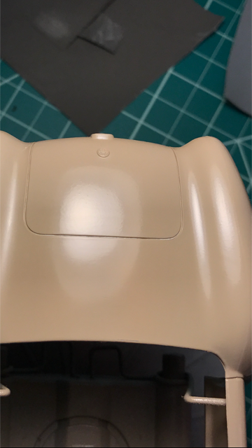

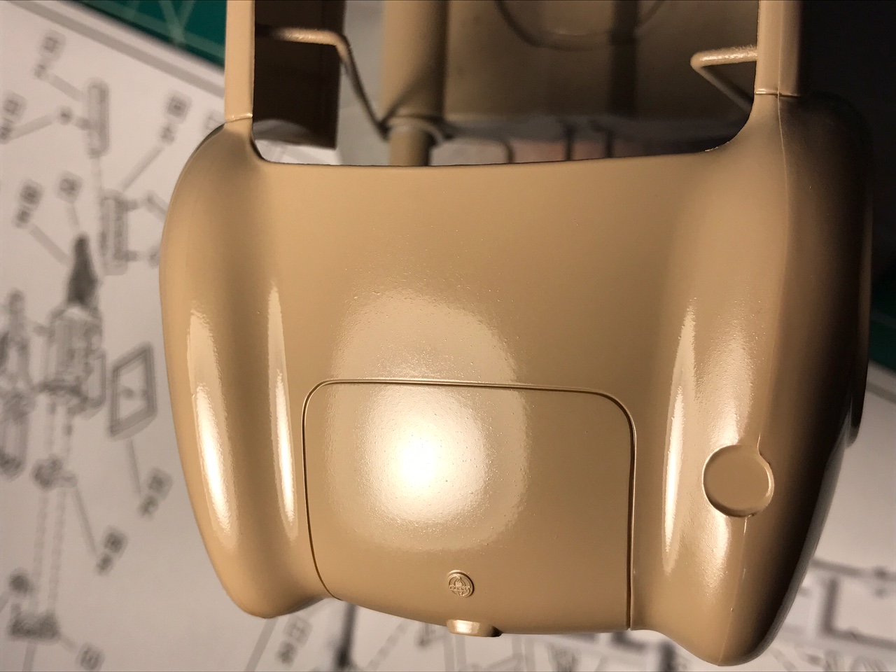

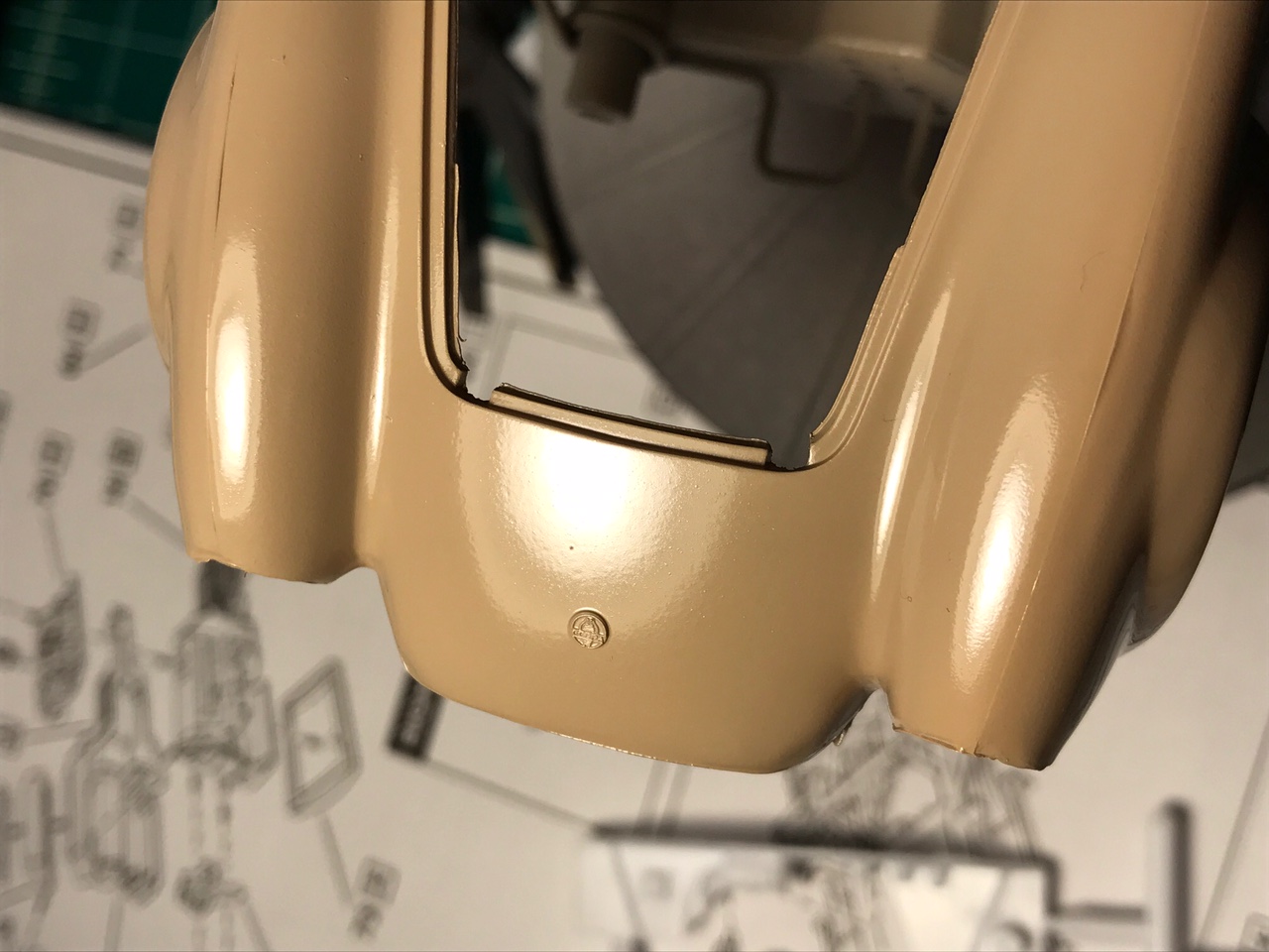

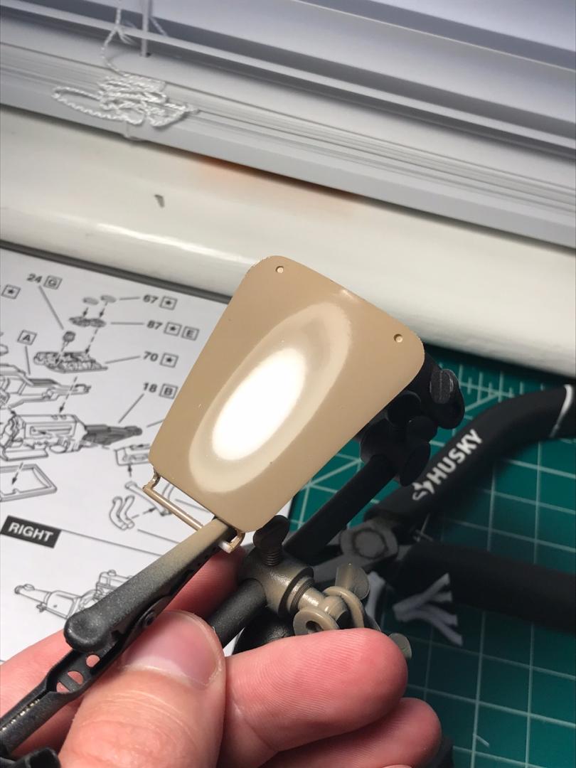

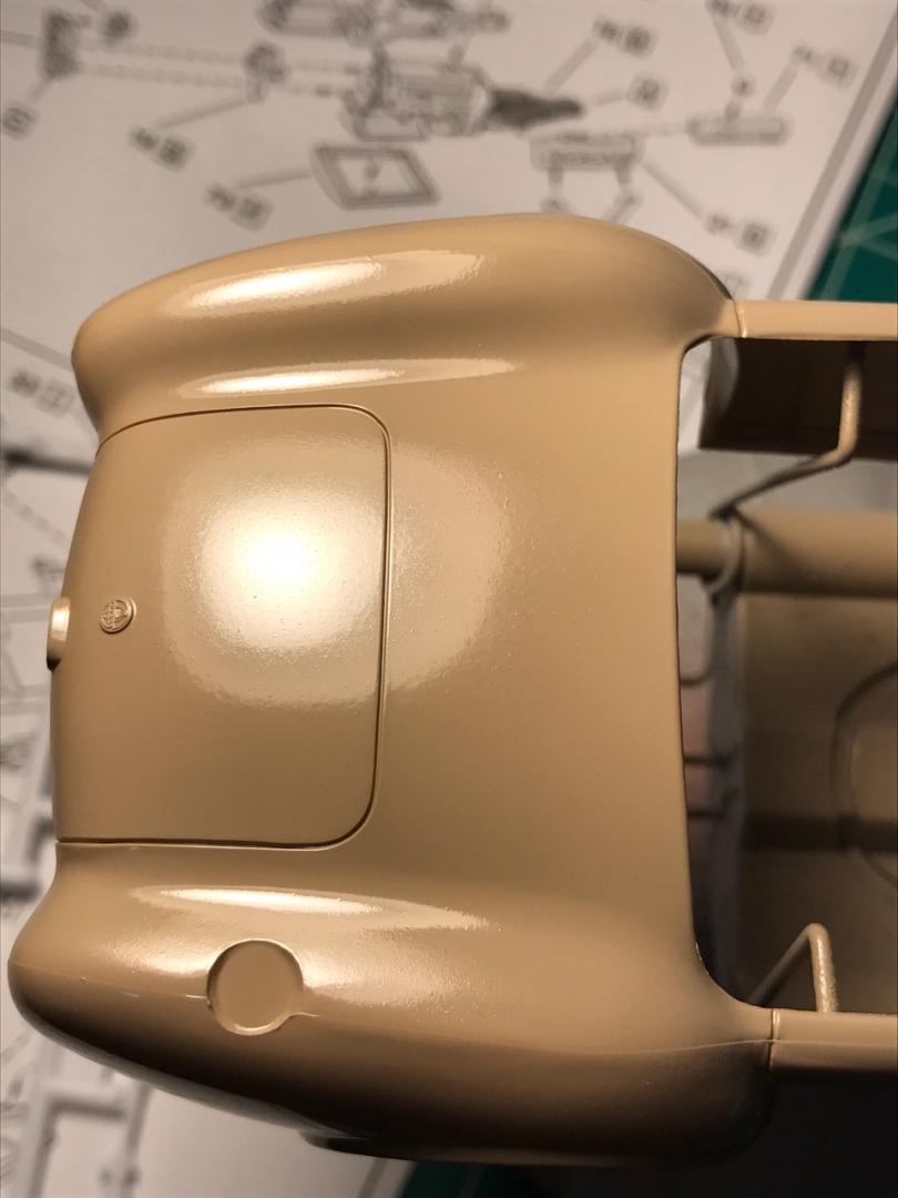

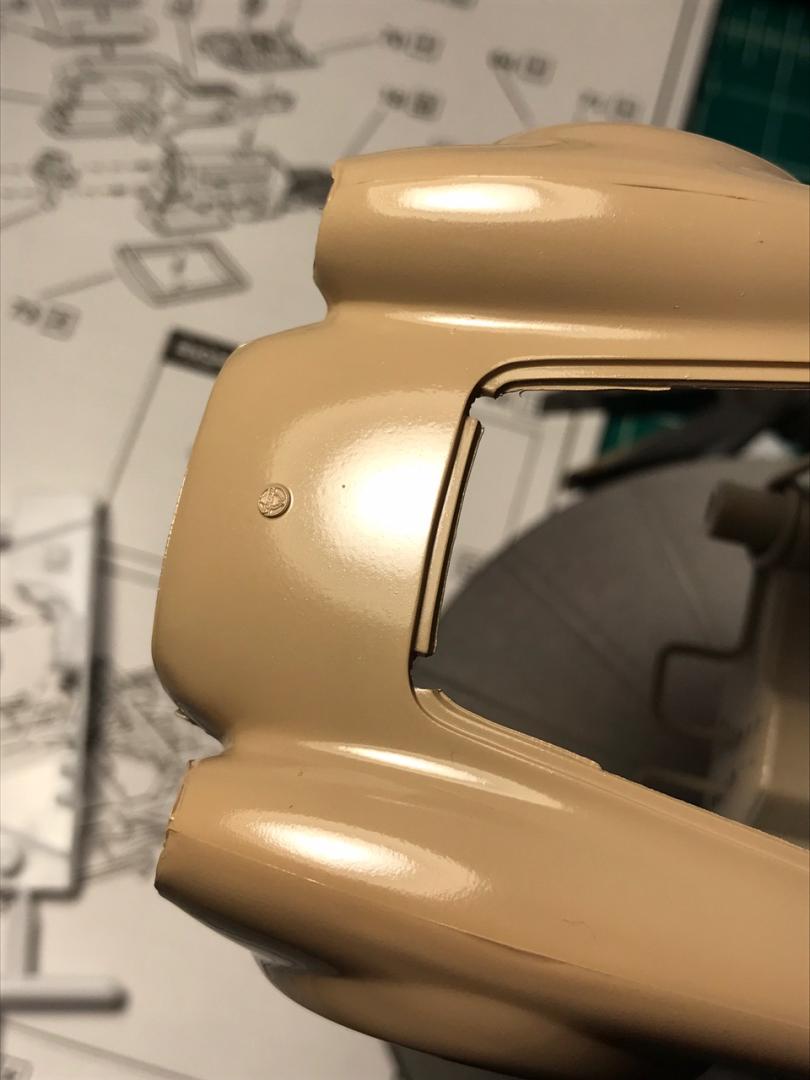

1hobby1 Posted June 23, 2017 Author Posted June 23, 2017 (edited) So last week I went ahead and started wet sanding and polishing and I think it made a difference. On this picture I did not polish the trunk, but I did polish the space between the trunk line and where the back of the seats would be placed just to see the difference with the orange peel and small dust particles. I since then have washed the body and started to apply the stripe decals. Once I finish with the decals I move on to clear. I am thinking Testors Clear since I know it is decal friendly.... however I also have Rustoleum Clear that I might use, not sure how friendly it will be with the decals. Thank you all for advise and help! Edited June 23, 2017 by 1hobby1
vamach1 Posted June 23, 2017 Posted June 23, 2017 Not sure if you covered the Cobra emblems with foil. The paint will build up and be hard to remove. The respray looks much better.
