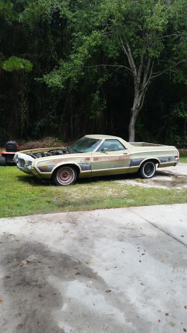

Super28 Posted July 14, 2017 Author Posted July 14, 2017 Wow! Thanks for all the input! I really appreciate it. I've worked with Bondo and Glazing putty on real cars before,. Never thought about using it on models, them being plastic and all. My other hobby is my last "hurrah" in building a street rod. I've built several over the years and my dumb butt sold them . Got the itch again and decided on a 1972 Ford Ranchero. Off frame rebuild. Thanks again for the info

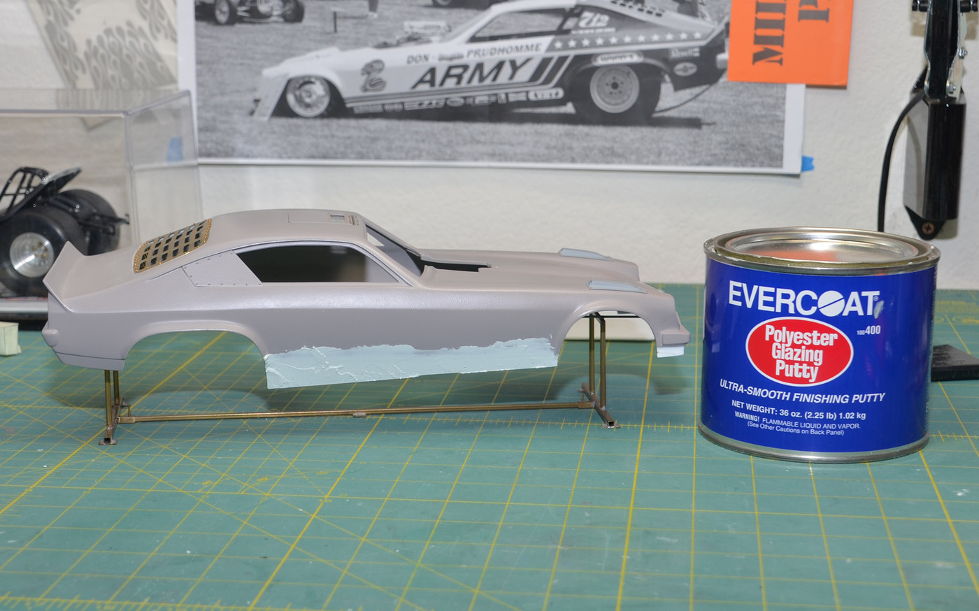

George Bojaciuk Posted July 14, 2017 Posted July 14, 2017 I use Evercoat Eurosoft....love it! Sands easily! Quarter to dime rule on mixing. Mark Gustavson mentioned this stuff in an article and I have not looked back since. No shrinkage or issues down the lane!
BigTallDad Posted July 14, 2017 Posted July 14, 2017 I use Evercoat Eurosoft....love it! Sands easily! Quarter to dime rule on mixing. Mark Gustavson mentioned this stuff in an article and I have not looked back since. No shrinkage or issues down the lane!I'm old school math; can you define the ratio in terms of numbers, such as 3:2 please?

George Bojaciuk Posted July 14, 2017 Posted July 14, 2017 The can states 1/4 putty from the can to 1/4 of the tube of BLUE hardner. From my experience 3:1. If you dig out a blob with a tongue depressor and it's about the size of a quarter, add a dimes worth of hardener. The color should be a light blue, when mixed. If you use too much catalyst (blue), it will harden rapidly, not leaving you time to work with it. Too little and it will take a while. The proper mix will give you a good 20 mins work time. Let it set overnight before you sand for the best results. 2lb can was about $29.00 with a tube of hardener.Autobody Toolmart.com has it. Any good auto store will carry it as well as an automotive refinishing supply shop. When I worked at Eastwood, we had it on the shelf. I've done wheel flares and hood scoops and never had it shrink or crack. Love this stuff. Sands easily. My '70 Motion Chevelle had it on the hood and to this day, it looks great! Squadron Green stuff always disappointed. My rule of thumb is...if it is single stage, it uses a solvent to cure. As that evaporates, it will shrink. A two stage uses a chemical reaction to cure. If using on metal, prime the metal first as any chemical cure produces heat and heat causes condensation. Trapped moisture will cause rust. The two stage does not rely on evaporation and there is no shrinkage.One of the party bonuses working at Eastwood! Get to know about this stuff.

oldcarfan Posted July 15, 2017 Posted July 15, 2017 Evercoat is the superior of the two, but if you're like me, and only use a small amount before it goes bad, it isn't worth it. I usually get Bondo two-part because it's cheaper. While you're there, get a tube of Bondo spot putty. Once you've got the body work done and shoot that first coat of primer, you'll probably find a few scratches or sand marks you missed. Spot putty works great for that.
George Bojaciuk Posted July 15, 2017 Posted July 15, 2017 I mix on business cards, not in the can. Only take what I need. My original can lasted years. Always made sure the lid was on tight. Occasionally, I'd check for separation and mix it up. The blue hardener tube (actual container) broke down over time and cracked. I just picked up another tube for only a few bucks. I finally threw my original putty away, since I had access to a fresh batch. I'd say I had it about 10 years. I've used it on home projects, as well.Use what you want and what your budget allows. Just sharing my personal experience with both types of fillers. If I spend many hours working on something, I don't want it cracking 6 months from now. Had it happen and it's most frustrating.My Motion Chevelle appeared on the cover of my book....around 1997... As I said, it still looks good more than 20 years later. (It was a magazine article car prior).You can get epoxy primer in cans. However once you activate the can, you have a window in which to use it. The can uses an internal bladder which you puncture to activate the two components. Freezing the can may get you a week's use since lowering the temp slows the chemical reaction. Again, on plastic, you don't need epoxy primer.If you go to Eastwood's site and search for "epoxy primer", there is a nice explanation and a video by Kevin Tetz. Nice guy, as I got to meet him and chat at our car show. There are a lot of great videos on the Eastwood site as well as YouTube.
