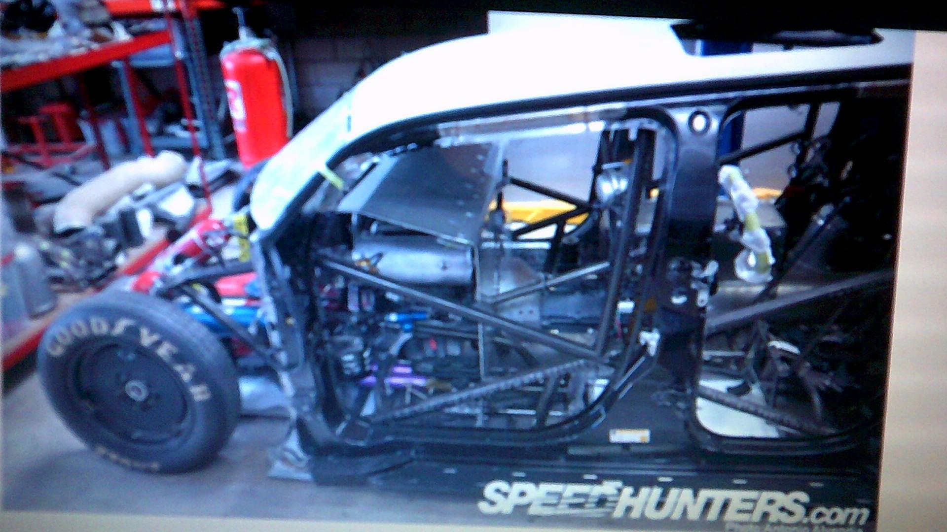

misterNNL Posted July 19, 2017 Posted July 19, 2017 I have tried to find unsuccessfully to find the under construction photos of the Southern Cal Speed Shop Bonneville HHR.I was able to locate some specs and images of the finished car by searching under the name Canepa.This car ran over 200 MPH using a turbo charged version of the 2 liter Ecotec engine.

signguy2108 Posted July 21, 2017 Posted July 21, 2017 (edited) The socal car was built in conjuction with GM performance engineering. Here is a couple of pics from speedhunters.com I always wanted to build a bracket car that looked like this. love it! Edited July 21, 2017 by signguy2108 wrong pic

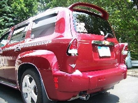

Russell C Posted July 21, 2017 Posted July 21, 2017 For a different angle, this outfit offered retro '55 Chevy-looking add-on taillights. But unless my search skills let me down, no company put out a particularly spiffy looking retro custom headlight/front fender swap. Might beg for some kind of clever design work.
