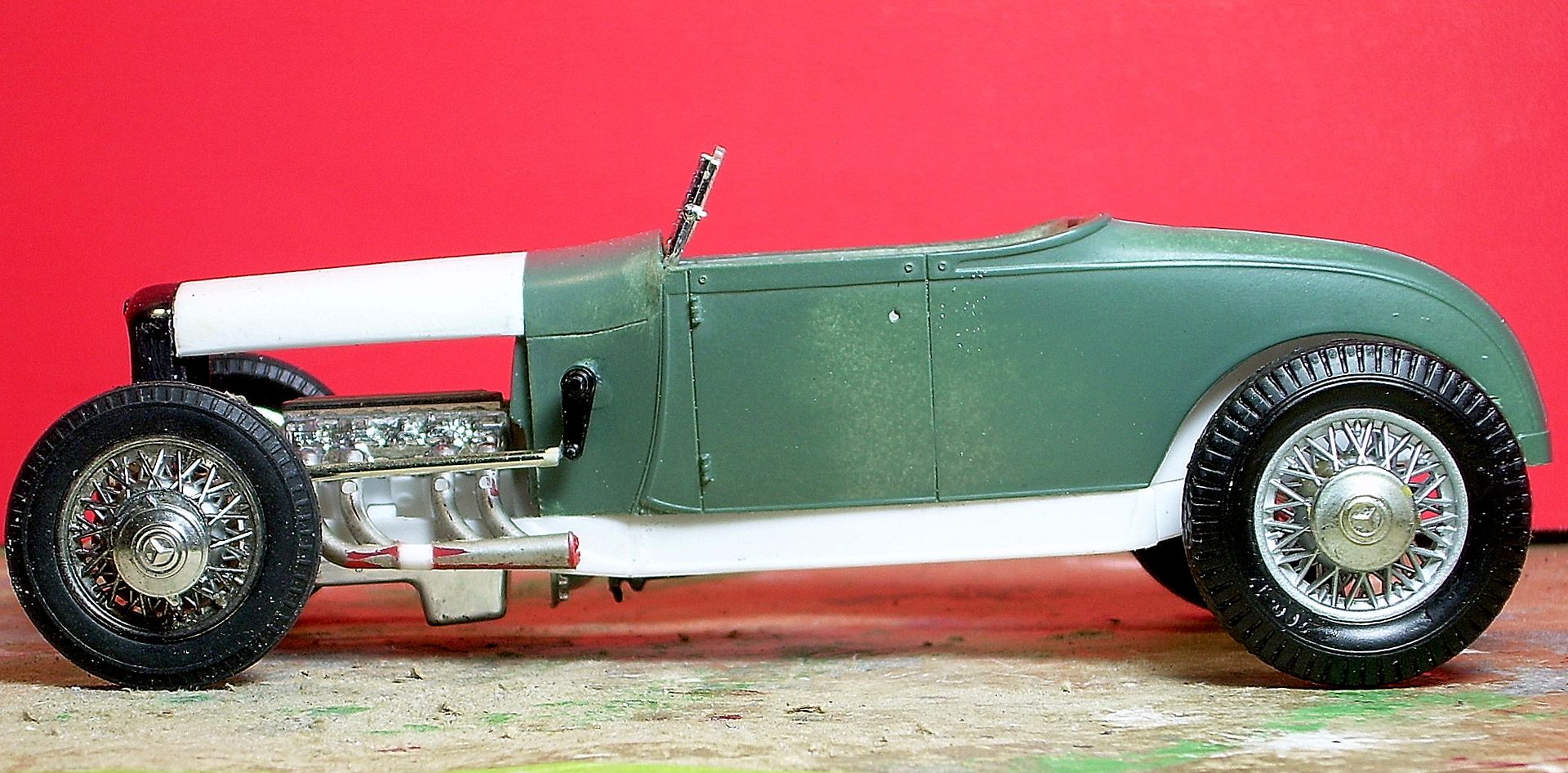

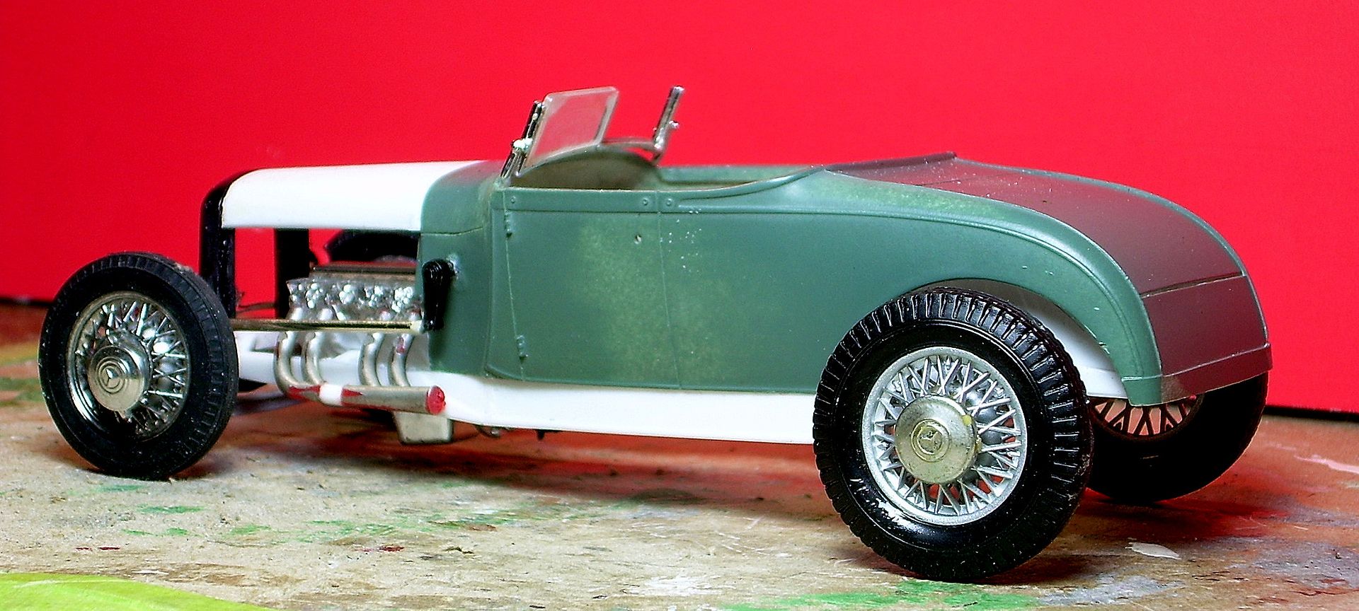

Ace-Garageguy Posted August 15, 2017 Posted August 15, 2017 All the above info is true and correct, but it's most important to remember LOTS OF LIGHT and USE A TRIPOD & THE AUTO-TIMER (to prevent jiggles)...no matter WHAT kind of camera you have. These shots were taken with a very cheap and "obsolete" ($15 used) 4.1mp "point-and-shoot" Nikon that only has "macro" and "zoom" extra functions. This is the el-cheapo lighting setup...three swingarm lamps with 100-watt equivalent compact-flourescent bulbs...

Ace-Garageguy Posted August 15, 2017 Posted August 15, 2017 (edited) Great photos! Thanks for the tips + I love the track roadster! What nose/grille did you use? It almost looks like the old Monogram indy car, or is it scratch built? You are correct sir...it started life as the old Monogram Indy Kurtis nose...and thanks for the compliments. One of the tips I read on here about taking photos of model cars was to get down on the models level. IOW, don't shoot all the pics from above the cars belt line. Excellent advice also. This was shot with the lens just about centered at the beltline... ...while this was shot at approximate eye-level of a scale human... ...and this was shot considerably lower. Edited August 15, 2017 by Ace-Garageguy

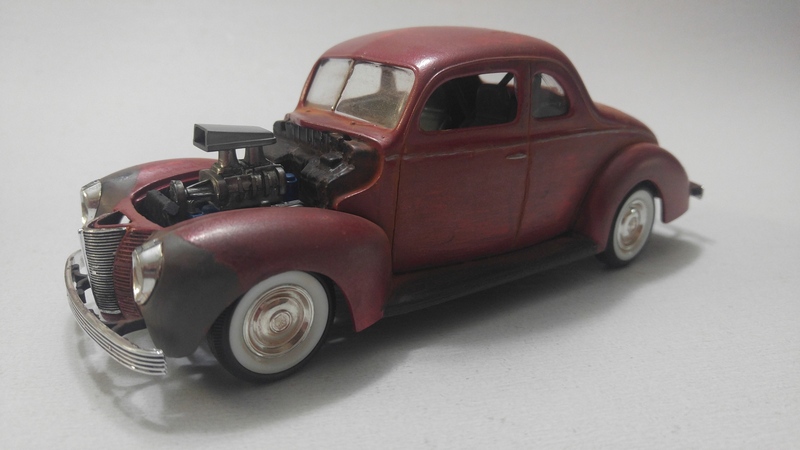

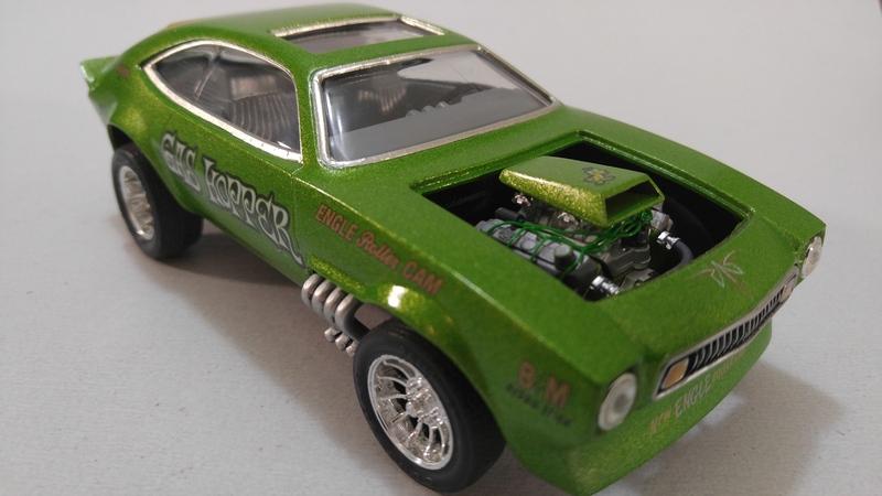

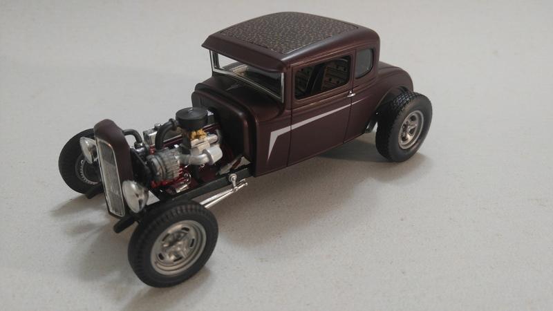

Jantrix Posted August 17, 2017 Posted August 17, 2017 (edited) Some great advice here, but lets not assume you need a photo booth and a camera to share your work. These were done with my Samsung Galaxy S6 smart-phone sitting on a couple books, against a piece of poster board with some extra lights added. For an amateur they are pretty good and just for sharing with you folks I can't really justify spending more. Edited August 17, 2017 by Jantrix
