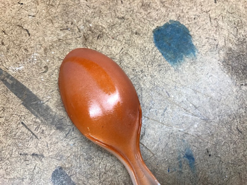

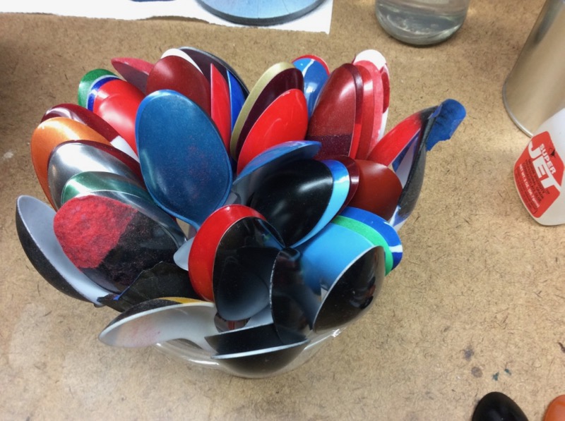

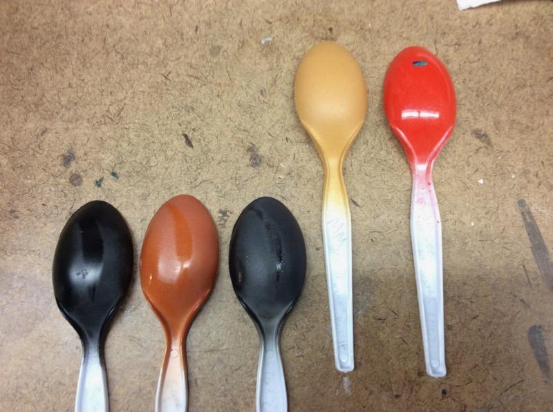

First, spoons.  I very often test paint on plastic spoons.  I bought a box of 1000 styrene spoons and have bene using them for years.  Lately, the spoons show a glossy/not glossy pattern on them - see the photo below.  This is with MANY different brands of paint, so I assume it is something to do with contamination in the plastic of the spoon.

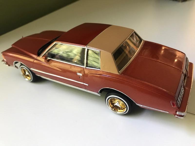

I tested the Dark Camel color from Scale Finishes on a spoon, and it exhibited the problem.  After I applied the paint to the car, I noticed the same problem.  See the photos - there are non-glossy patches on the body.  This is after several light/medium coats of the paint, and it looked fantastic wet.  As it dried, it got blotchy.

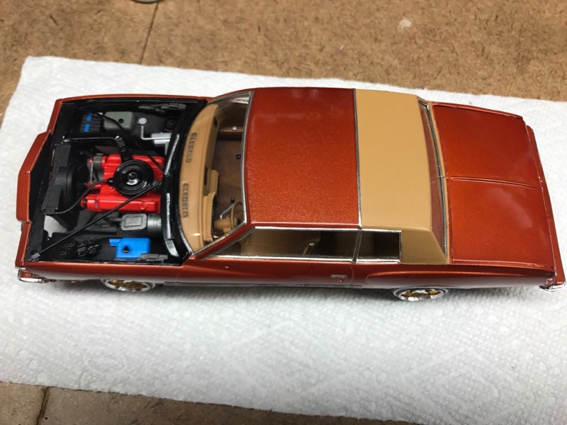

Notice the picture of the hood, though - it looks great.  Yeah it's orange-peely but this is before any gloscoat or sanding/polishing.
--> What is going on with this blotchy paint!?  Does anyone have any insight?
Hoping that gloss coat would make it look right, I took my test soon and put on TWO medium/heavy coats of alclad clear kote, then a very heavy coat.  When wet it looked like glass, but after it dried - blotchy.  So it seems that no amount of clear coat is going to fix this.

Thanks 935K3.  Humidity is unlikely I think, though.  I paint in my basement and humidity is fairly constant there.  And the spoons exhibit the same pattern, many days apart.  I've done a fair amount of woodworking and understand blushing in lacquer finishes.  This isn't blushing.
Is this being sprayed directly on the plastic or you spraying it over primer?? I am wondering if your first coat is a little too heavy and the solvents could possibly be a little too Hot for the plastic and it's crazing the plastic just a little bit. I have had crazing issued on my models before and I tend to mist a few first coats and then I can a little heavier coat after that. Also is it just the Scale Finishes paint your are seeing this on or is it also different brands of model paint?
What are you using to thin your paint? Both the roof of the model and the spoon appear to have solvent crazing.
A thinner or solvent that's too "hot" will attack the surface of the plastic, causing paint to go dull and "blotchy" as the solvents evaporate out during drying.
The fact that you primered the hood more, and the problem isn't as severe, would be consistent with that. The additional primer blocks the solvent from getting to the plastic...but burying the model in primer isn't the solution, as it obliterates fine details.
In general, the plastic that models are made from has been cheapened recently, and solvent resistance is poor. Many of us have noticed this, and it has been discussed at length.
I would also respectfully recommend two things.
1) Practice your spray technique until you don't get orange peel. It's not necessary, and burying it in clear isn't really the right way to deal with it.
2) Make 100% certain of your materials and techniques BEFORE painting a model you care about.
Another word of advice: spoons may NOT be the same plastic that models are made from these days, and what works on a spoon, though it's widely recommended by "experts", may very well NOT WORK THE SAME ON A MODEL.
Once you get your technique perfected, your paint should look like this with NO clear or polishing.

Thanks everyone.  The consensus is that it is crazing, and that lines up with what I'm seeing here.
Further info:
Primer - the car body was primer'd with Tamiya white primer.  The hood and trunk had more primer, as they had been filled/sanded and the body had not.  I think they had enough primer to prevent the crazing problem.  I do not usually primer the test spoons, so the paint usually goes right onto the plastic.
Test spoons - The problems actually show up on only A FEW brands, not all.  The shot below shows three spoons with the problem - those brands are Rustoleum Satin Black, Scale Finishes Dark Camel, and Quick Color black (this one actually bubbled after I sprayed it).  The top two are Model Master "wood" color enamel jar paint, thinned with MM enamel thinner for the airbrush; and Model Master spray can Hemi Orange.  All of these spoons were sprayed recently, but the top two don't have any problems.  My bucket of spoons, all from the same box of styrene spoons (I researched spoons and got styrene, the same thing models are made of), and I never had this problem until I started branching out from Testors/Tamiya paints.
Humidity - my basement is pretty much a constant 63% humidity.  Not low, but not too high.  I use 65% as the threshold above which spraying starts to become risky.
So, it seems that some brands of paint are hotter than the others, and have more of a crazing problem.
What I plan to do is:   strip the car body, re primer with enough to seal the plastic well, reshoot with Scale Finishes Dark Camel.
--> Does anyone know of a better way to "seal" the plastic, other than multiple coats of Tamiya primer?
Further info:

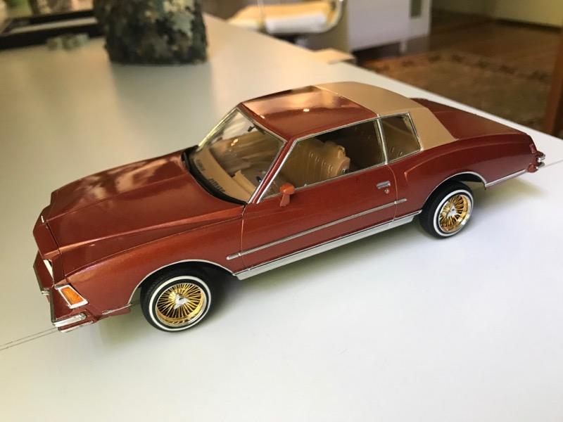

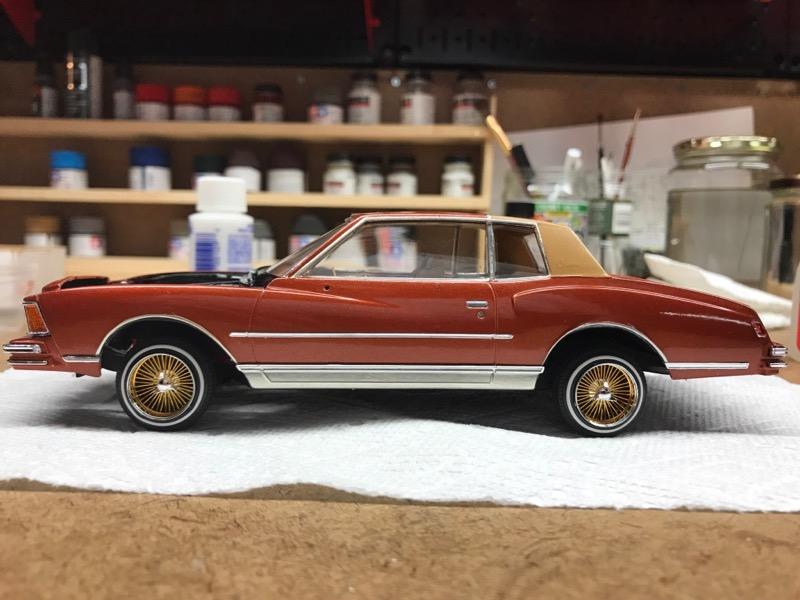

In the end the Monte Carlo came out ok.  After stripping it all back, I redid the finish.  The layers are:  Tamiya primer, Zissner-Bin, color coats (scale model finishes Dark Camel), Alclad clear coats, micro gloss polishing compound, "the treatment" model wax.  The primer/color/clear were pretty heavy coats, with sanding in between to even it out.  The Zissner especially needed flattening - it was beyond orange peel, it was "lumpy".  In the end the finish came out very nice. It is very brittle, though.  The slightest contact tends to chip the paint.  Does anyone know if Scale Model Finishes is usually this delicate?  I'm dissuaded from using them again.  Below are pics from done/nearly done.
