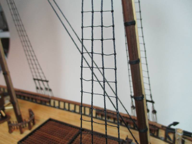

Here the top half of the main mast shrouds, with ratlines;
Looking better;

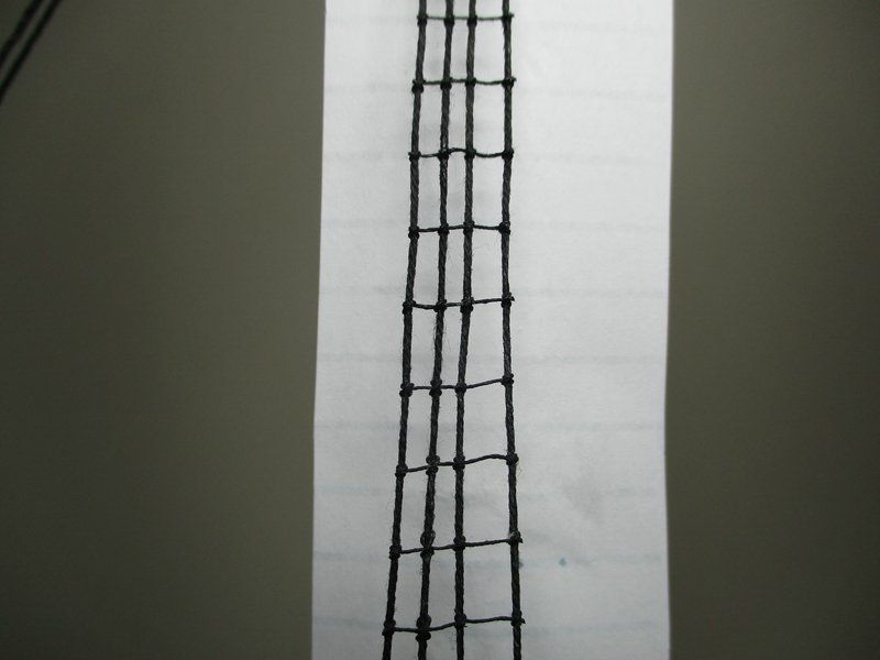

The direct result from the previous mistakes, the long shroud lines are starting to sway, the vertical run has been pinched, causing the line to have a curve.  Not good;

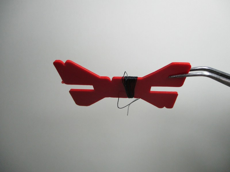

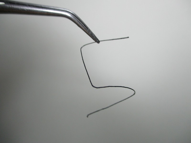

Here a problem I've discovered.  This is the crummy way some ship kits spool the thread needed;
-IMG_1855.thumb.jpg.2f5d9b232bae40e9dab7
Result is, a really kinky piece of thread that is just about impossible to easily correct.  I refuse to iron a thread that's about 2" long;
-IMG_1857.thumb.jpg.626c825a705d7a44f4e7

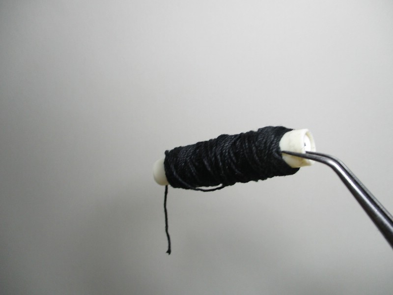

This a better way to have thread from a spool, no kinks;
-IMG_1856.thumb.jpg.ca64a622a2cb7de7c318

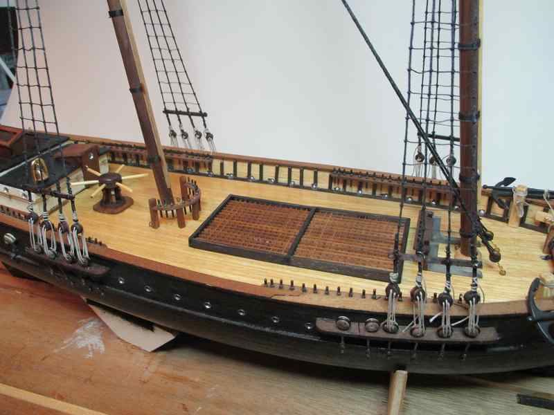

New pics today;

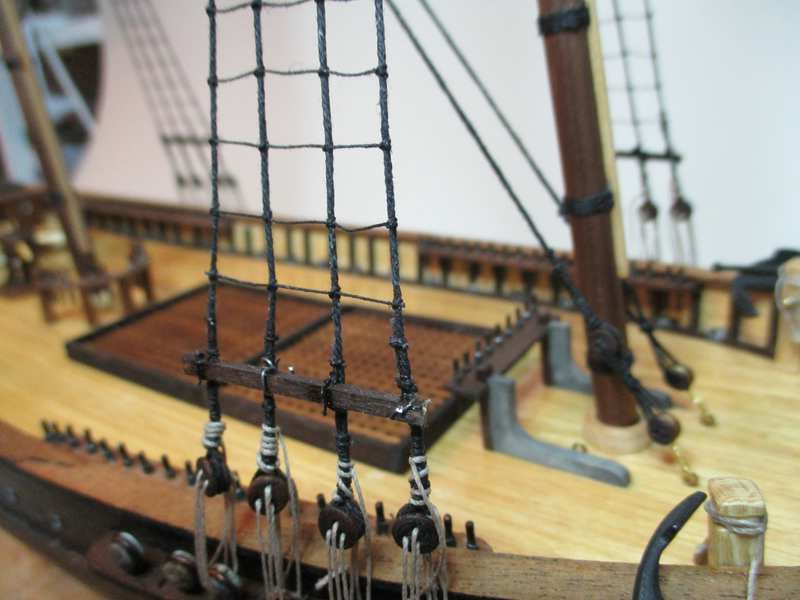

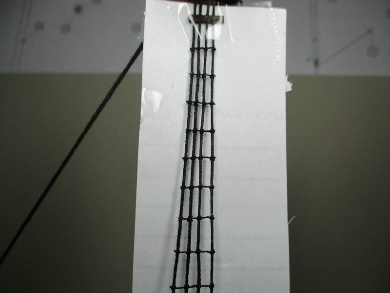

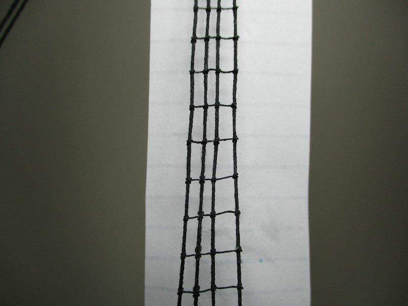

Finally the ratlines for the lower mast segments are finished.  In the beginning, the 1st try left lots to be desired.  Lousy knots, and from tying so many, 132 knots per segment,  the main shroud lines had started to run crooked.  Not good,  here the 1st segment, this is the left side;
-IMG_1854.thumb.jpg.5f8b6809c4bfdde371ef

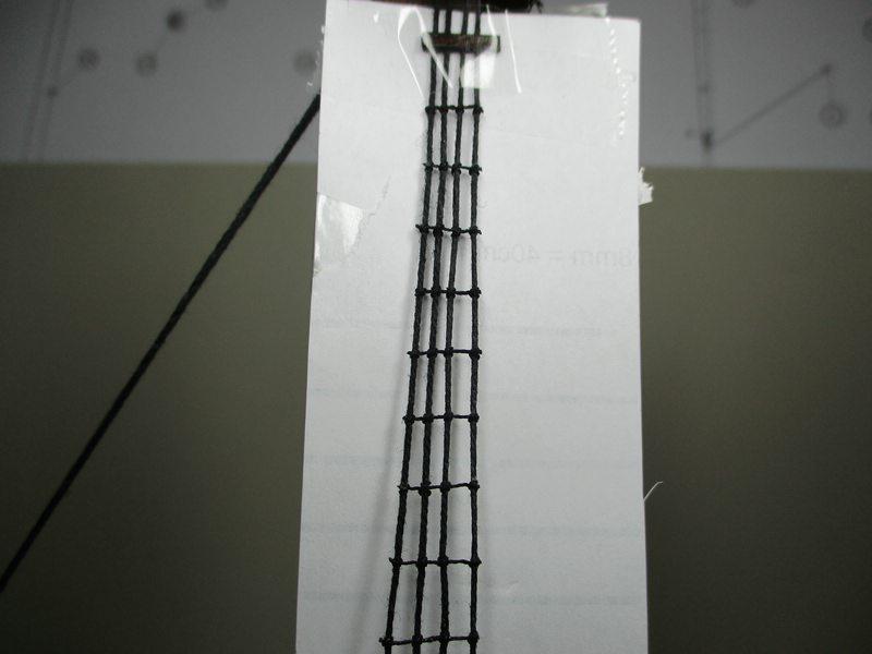

Then it hit me.  I'd forgotten to add cross-bracing.  Just like on real ships, these kept the vertical spacing correct right on up to the top.  This bracing allowed me to give each knot a good tug to get them good, tight and small;
-IMG_1862.thumb.jpg.0511ebff60aee3435ab3
Now they look a lot better.  I'm happy this part is finished, I took my time, one of them took me 3 days to do, another was done in one day.  I like them now;
-IMG_1867.thumb.jpg.a002c7d0c913cd50ee3f

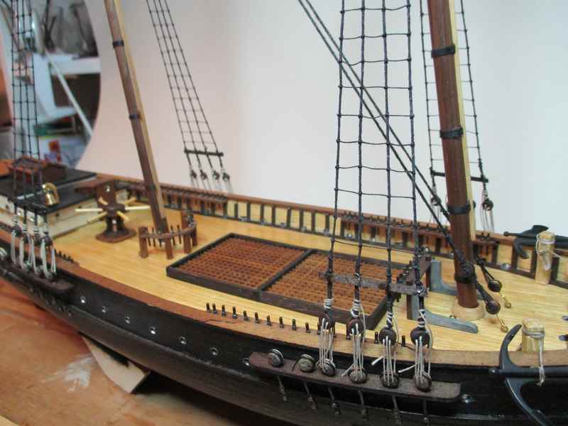

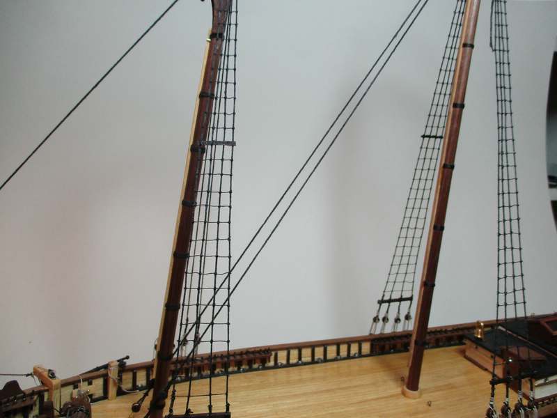

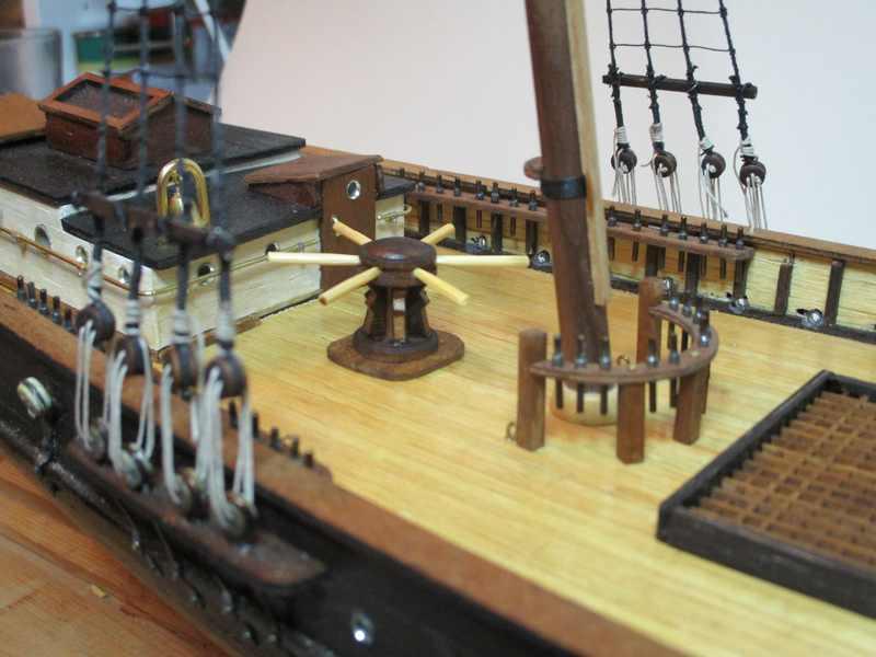

All four lower segments done, time to finish up and mount all of the deck furniture;
-IMG_1864.thumb.jpg.478b5111ace3f535bd6d
-IMG_1865.thumb.jpg.1c716dd2e302ae1bbfff
-IMG_1866.thumb.jpg.6dd2ad2ce780650df938
-IMG_1868.thumb.jpg.af810f8a3cc5b360f25f
Starting to look like a ship now.  In real life the vessel would already be afloat.  Next up is mounting the upper mast extensions....and more ratlines.  Ugh.  They'll be smaller though and not quite as intense, I don't mind at all.

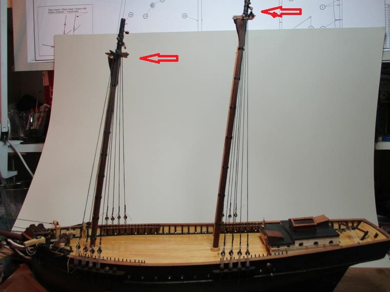

Today the upper level ratlines and shrouds were started.  Same procedure as below, just a little bit lesser involved.  This level allowed the sailors to get up higher to handle the upper sails.
Here the area shown with red arrows;

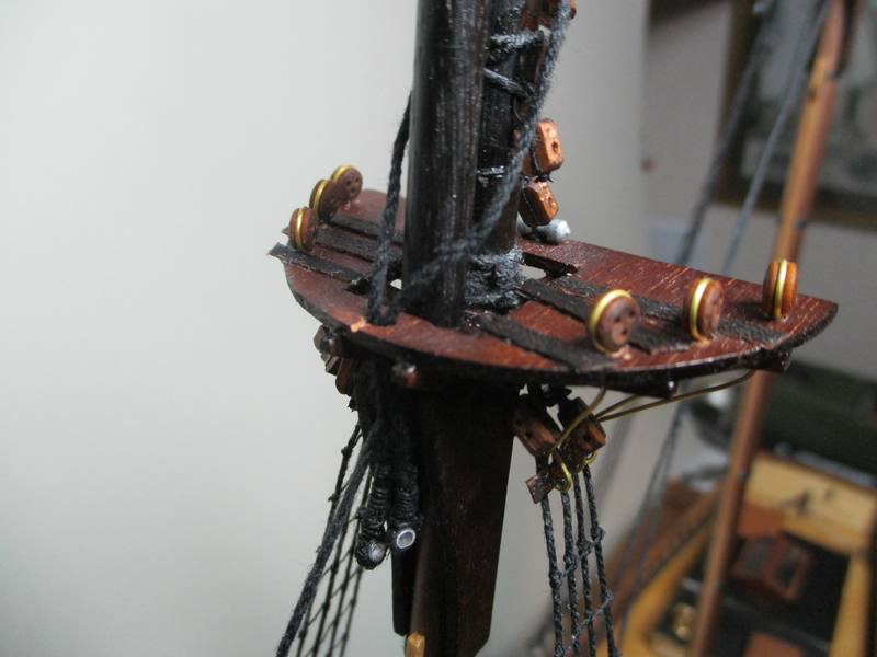

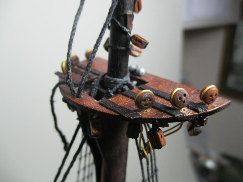

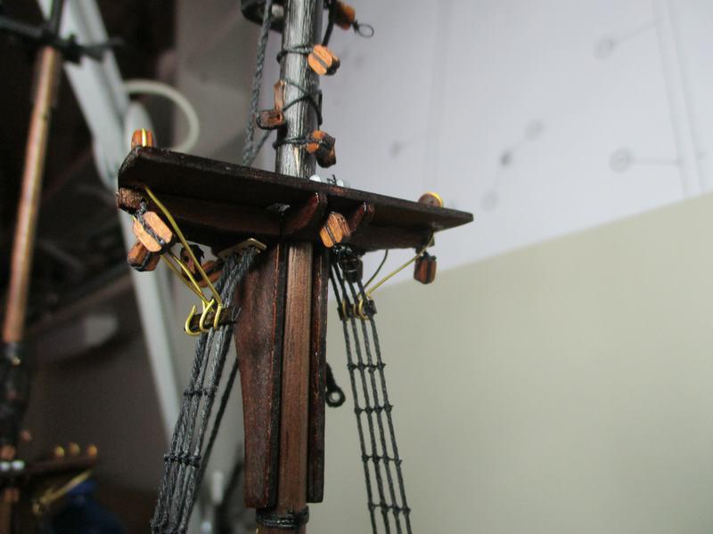

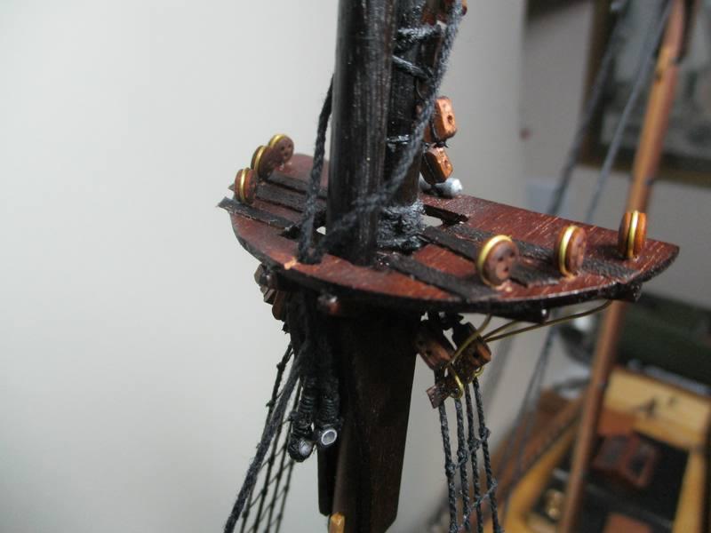

The dead-eyes were made up with brass wire. and attached to the top of the lower shrouds;
-IMG_1871.thumb.jpg.e769edbfc3278ed86241
-IMG_1872.thumb.jpg.d19604ec68709e91b1b6

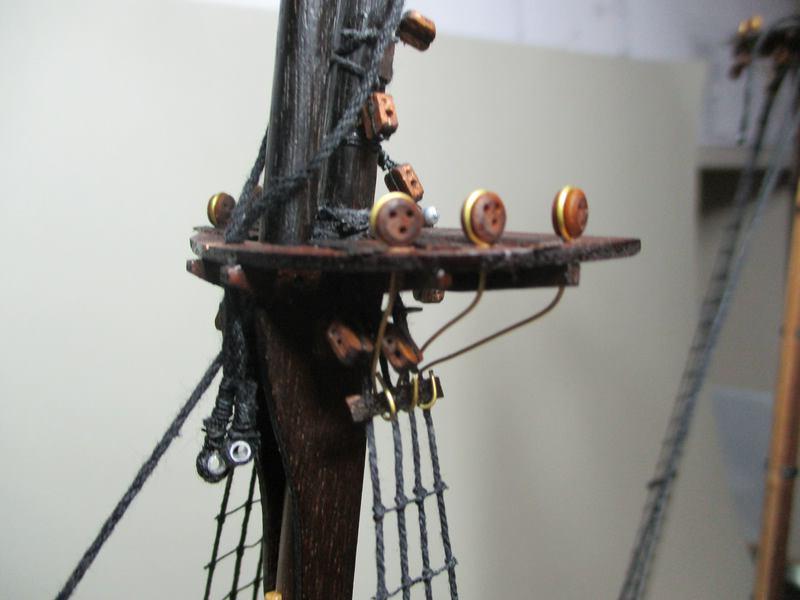

I think the ends should be crimped tighter around the bracing;
-IMG_1873.thumb.jpg.b181ed81420b388bb4ef
-IMG_1874.thumb.jpg.e118825d9b7c63af2b2b
Also, no way was this done with shiny metal wire.  I'm thinking maybe a little gray-looking metalizer paint might help out.
Instead of paint you might want to chemically darken the brass wire.  It will look good (weathered) and more durable than paint.  I don't know where to find chemical blackener in your country but in USA we have several sources. Model Railroad shops sell A-West Blacken-it solution and also Micro-engineering rail weathering solution. Both will give aged look to brass.  There are also various weathering/blackening solutions available from Jax Chemicals.  That is what I use.
I agree Peter.
I've used so far 2 different methods for brass blackening on this model.
I'll do the brass wire with a plating process.  The shiny brass just doesn't get it with this era of ship.
