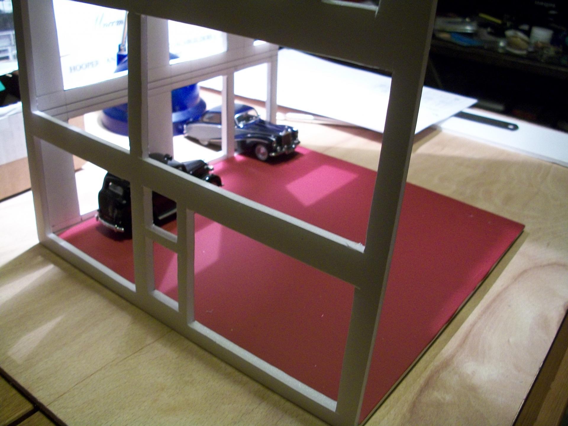

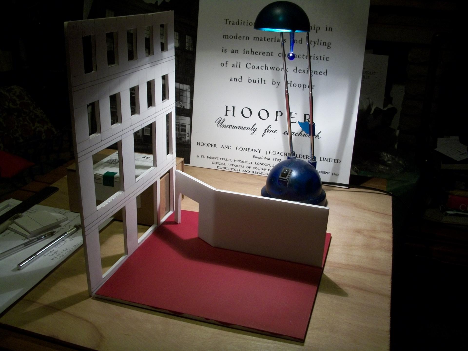

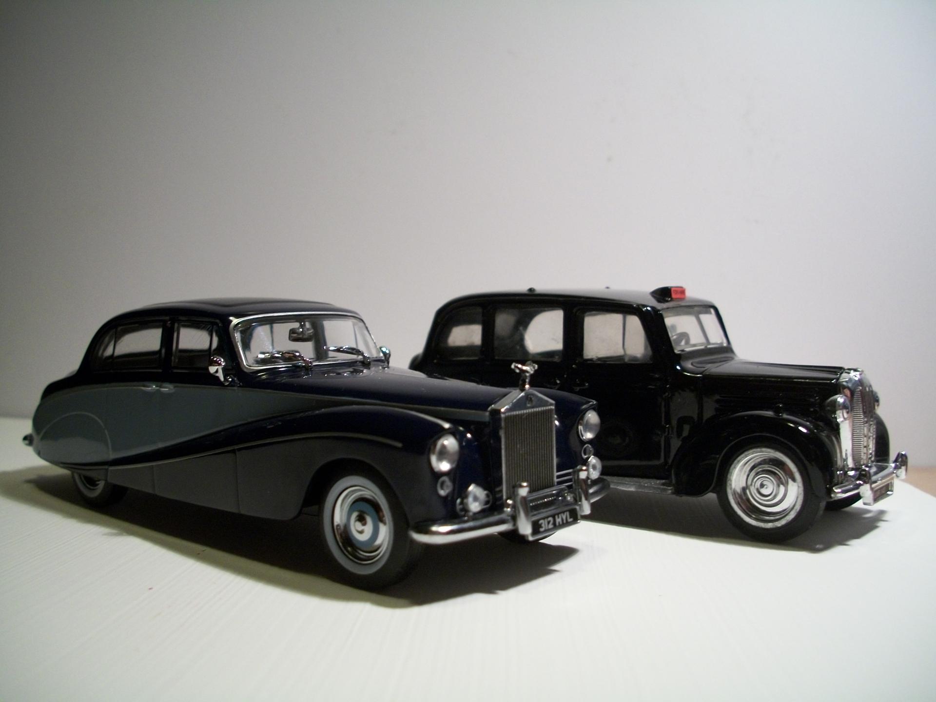

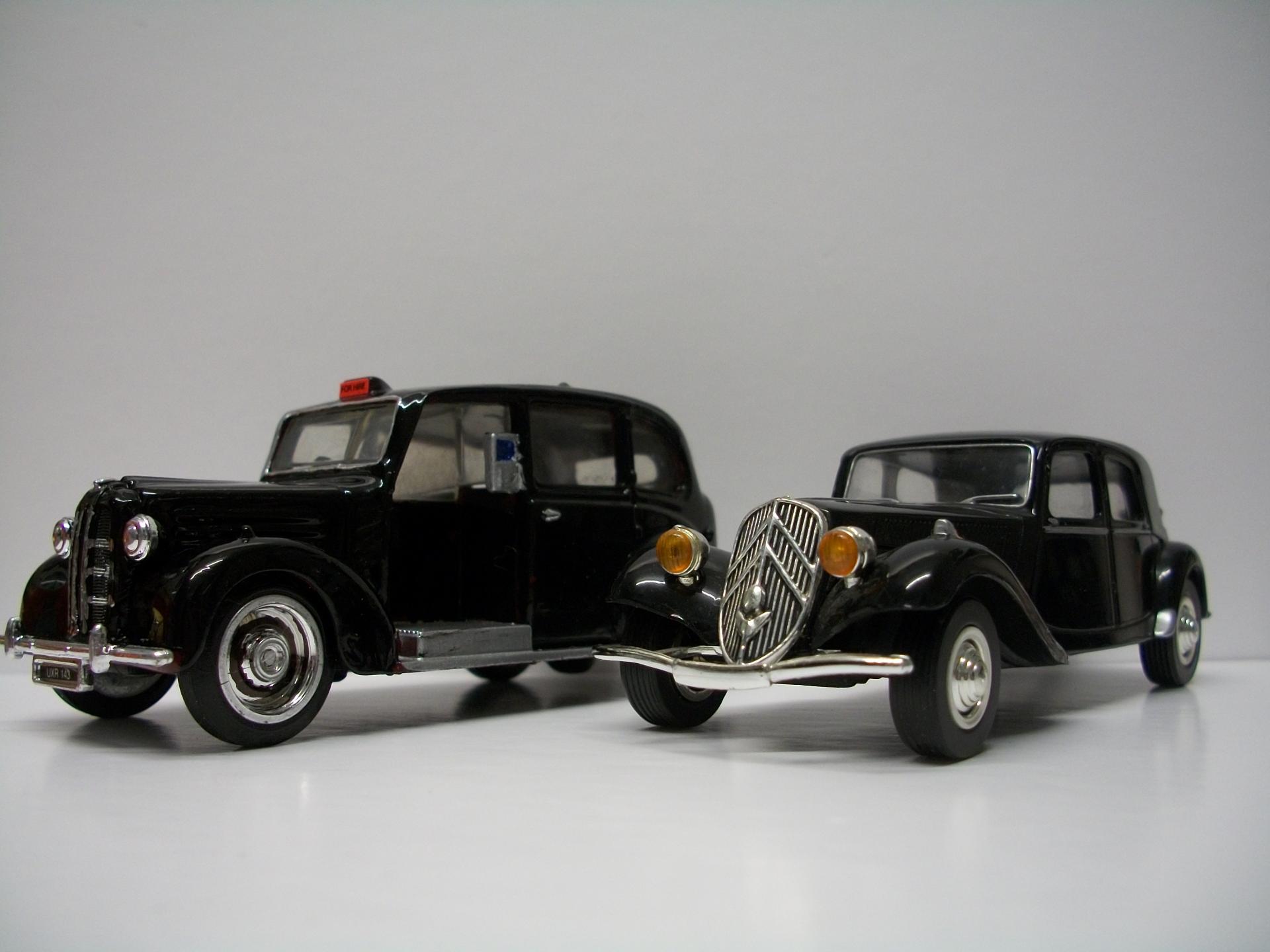

Anglia105E Posted February 21, 2019 Author Posted February 21, 2019 Here are a few photos to show the work in progress with the 1:43 scale Hooper & Co diorama. Also, the first of two Austin FX3 Taxi's arrived today, and this is shown alongside the Hooper Empress Rolls-Royce Silver Cloud I. There will be a second FX3 taxi that is maroon in colour, so will need painting black. You can see the partition wall being constructed that will form the office area of the ground floor. This also has the access doorway to the vehicle lift that takes motor cars and horse drawn carriages up to the first floor. The crimson red polished floors will have a second coat of crimson acrylic, as well as a coat of yacht varnish to produce the finished shine. The shorter section of the partition wall to the left in the photo, will be folded round to the ninety-degree right-angle position. All the window apertures have been cut out now, so the next stage is the clear acetate panels behind the window apertures. Decided I shall try 1:43 scale figures from Shapeways to see if they are good enough for the photography later. Thanks for looking everybody and I shall continue posting on this topic while the work is ongoing. David

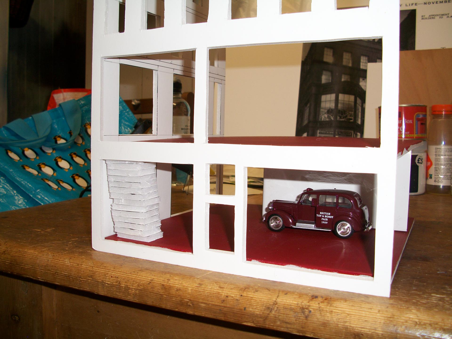

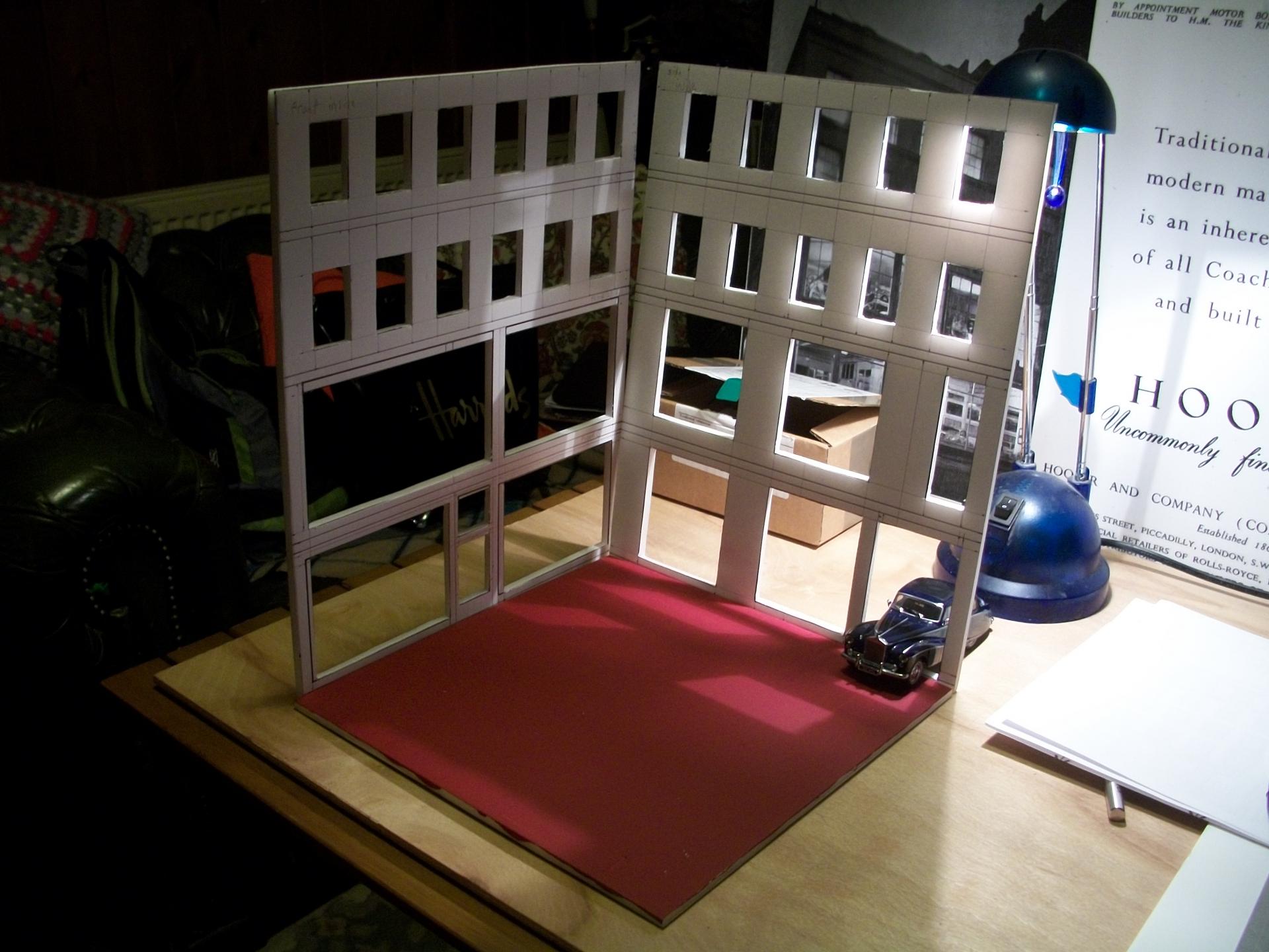

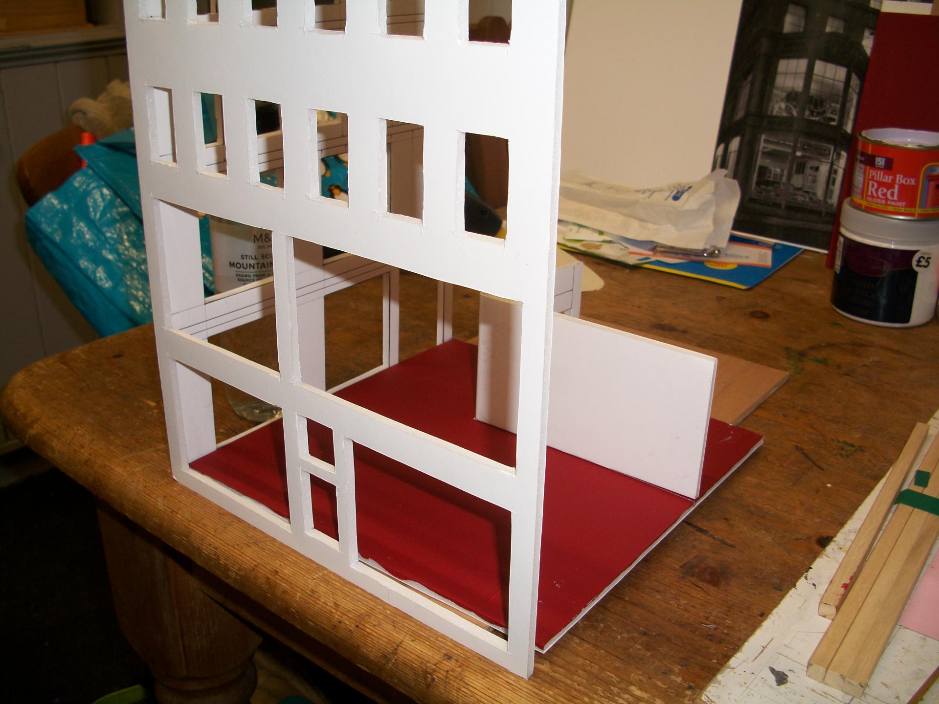

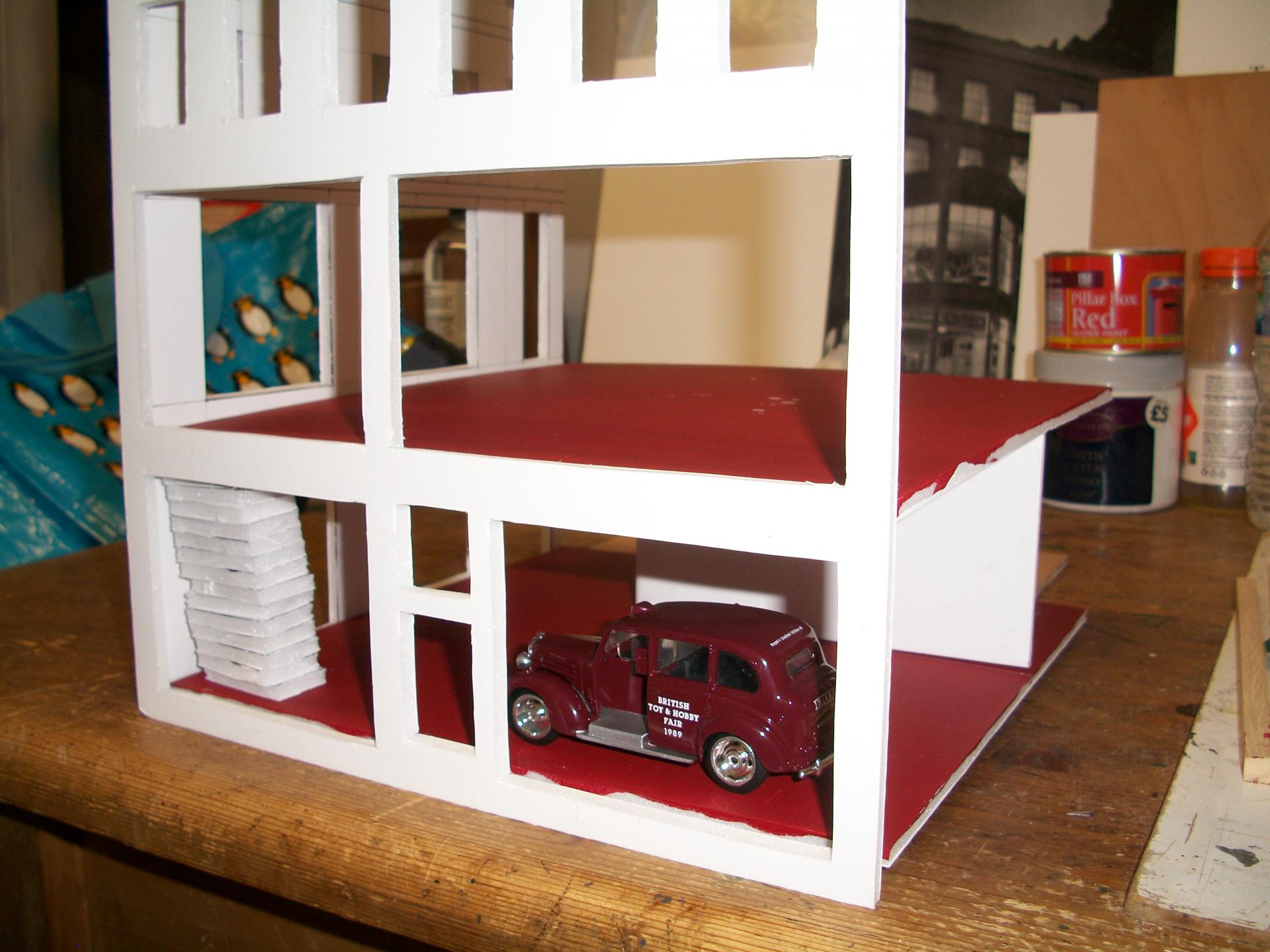

Anglia105E Posted February 22, 2019 Author Posted February 22, 2019 Construction work continues on the Hooper building. Here is a mock-up of the ground floor, first floor, office partition wall and the two main outer walls. The office partition wall has a rounded corner to it, and a supporting wooden post on the inside of the corner. Hot glue gun is being used to attach the edges of the foamboard. These images are done with flash photography, but later the diorama will be photographed without flash. The maroon taxi cab is there purely to visualise scale and proportion. David

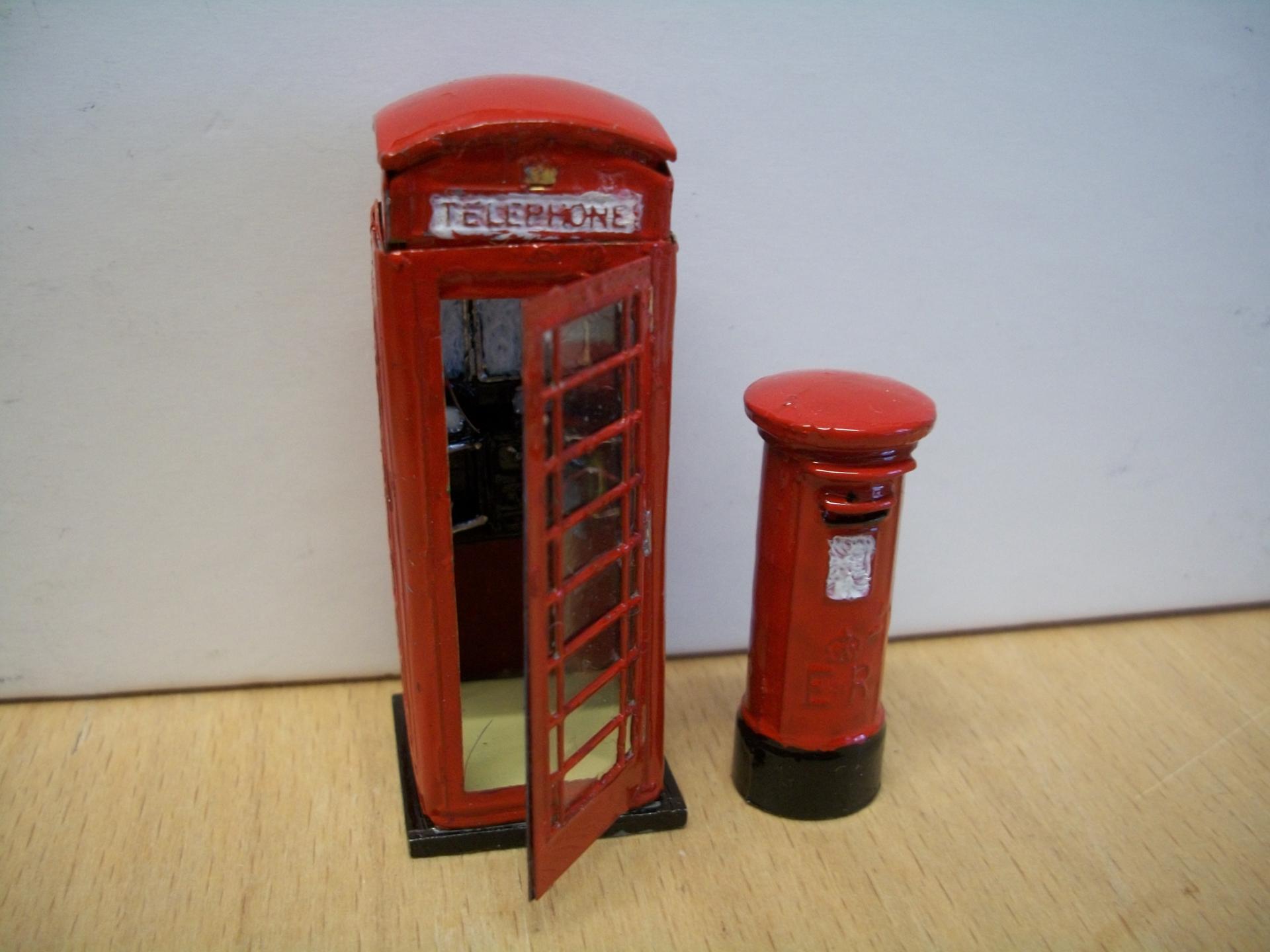

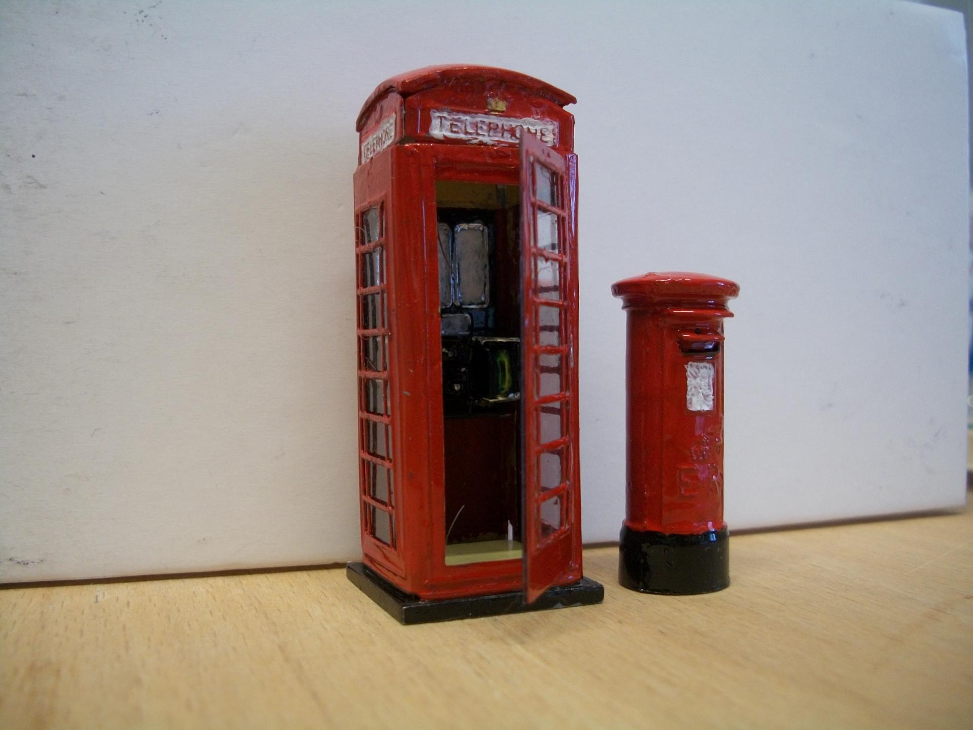

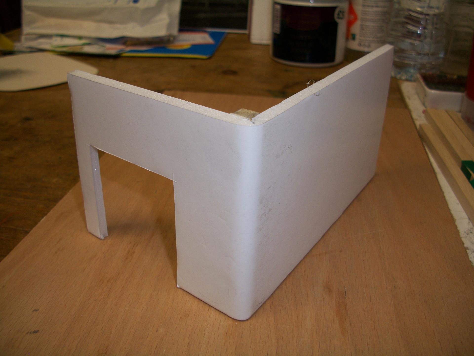

Anglia105E Posted February 22, 2019 Author Posted February 22, 2019 Thank you Gary...... I have decided to make a second partition wall, because I can see that when a motor car has entered the vehicle lift area there is not sufficient space for the office! Bringing the larger part of the wall further towards the main front wall of the building should put that right. Also, the corner is not a perfect 90 degrees right-angle, so I can do better! The 1:43 scale telephone kiosk is now completed....... built from a kit of etched brass parts, tin / lead alloy and clear acetate, making it considerably heavier than the balsa wood 1:24 scale telephone kiosk. David

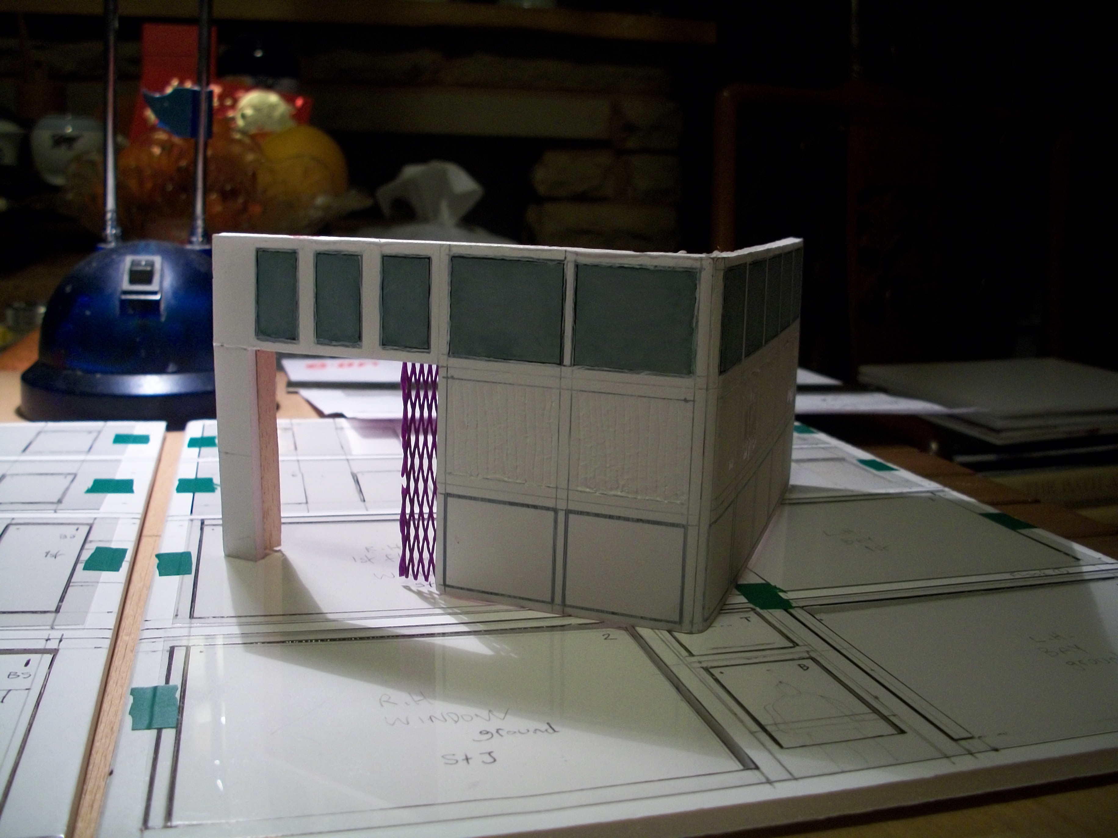

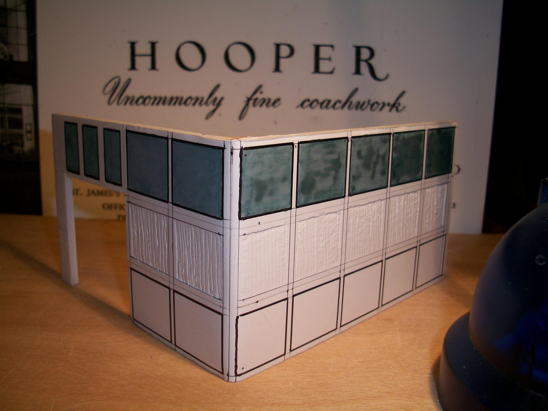

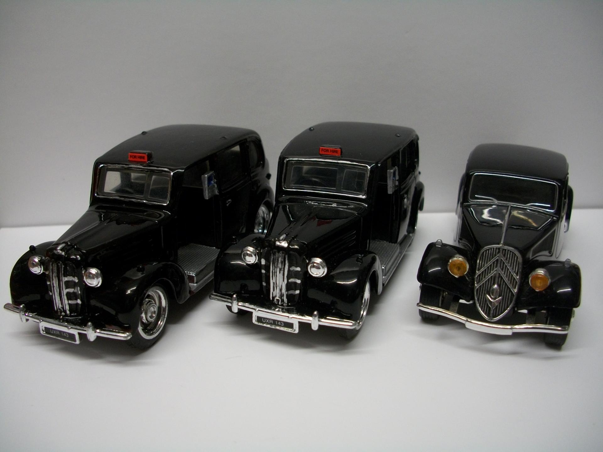

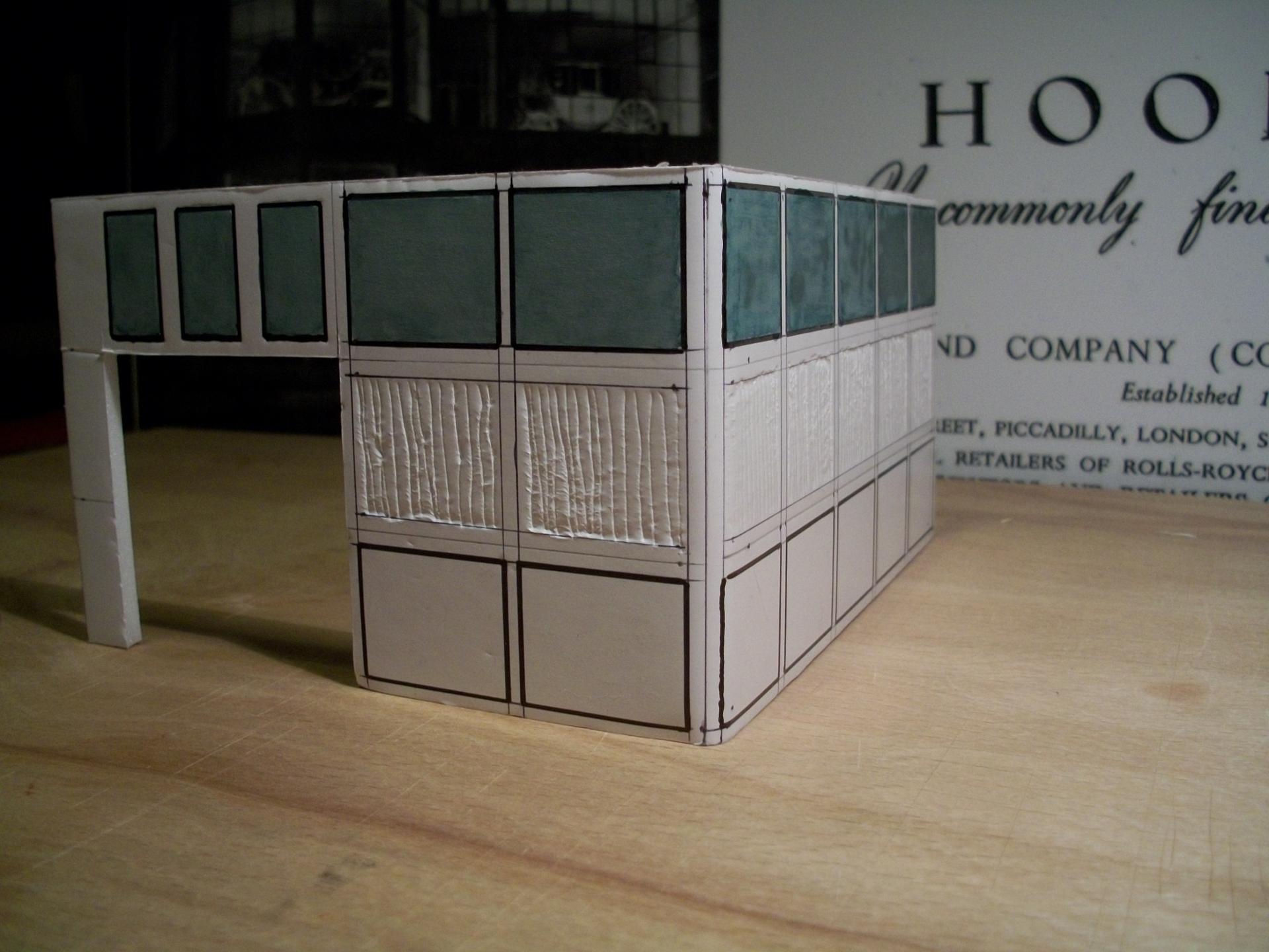

Anglia105E Posted February 25, 2019 Author Posted February 25, 2019 The second office partition wall that I constructed for the ground floor showroom space has turned out to be much better than my first effort. There are three levels to this partition wall, the lower one is wooden panels, the middle one is pleated white curtains and the top level is window panes. There will be some white acrylic paint going over most of the partition wall and then I shall see how it looks inside the lower floor position. The two Austin FX3 taxi cabs are now both painted black and have some additional detailing done. Picked up a nice 1:43 scale 1954 Citroen 11CV as a diecast model for very little money, so it was quite a lot cheaper than Ebay in this instance. David

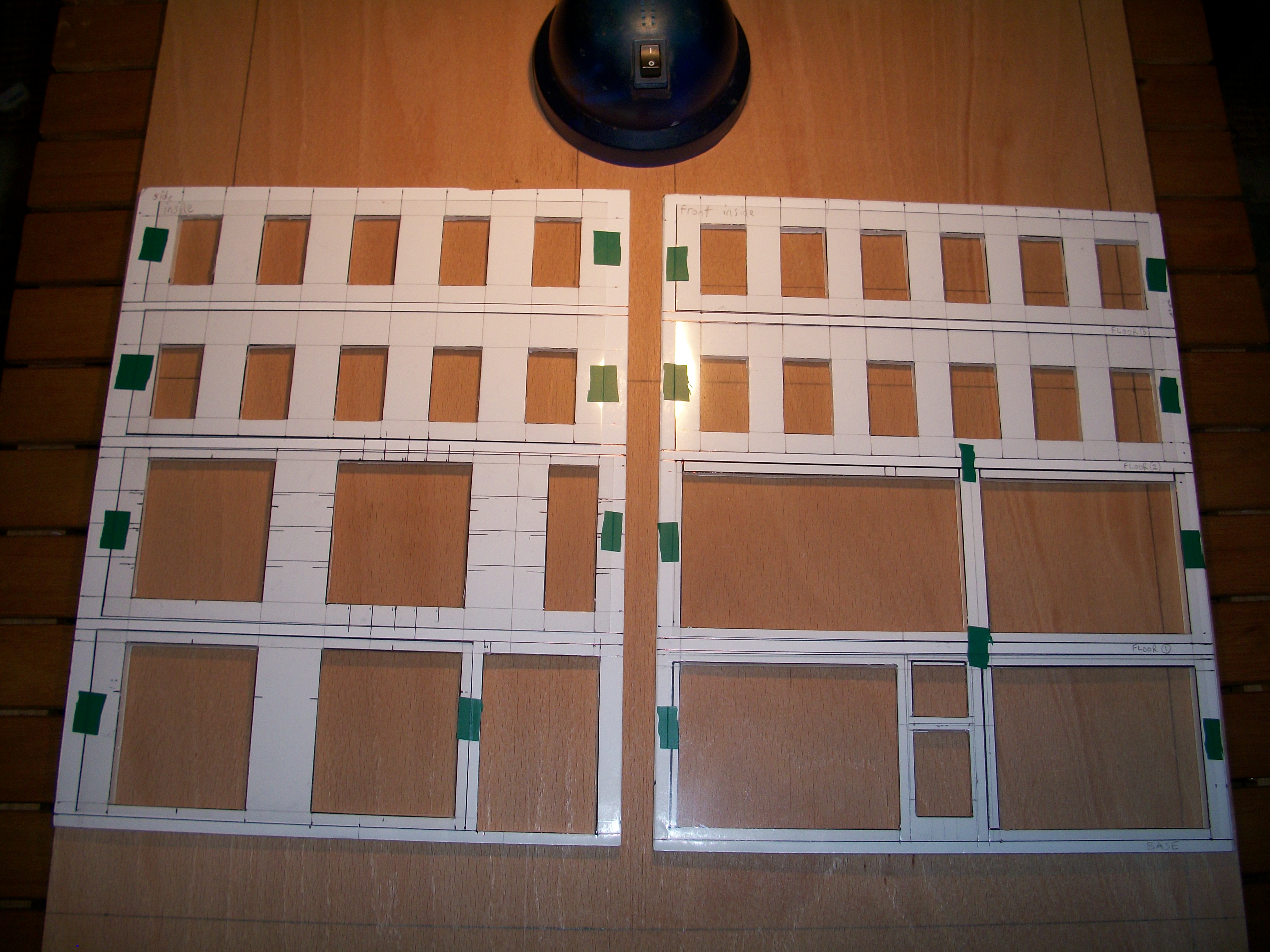

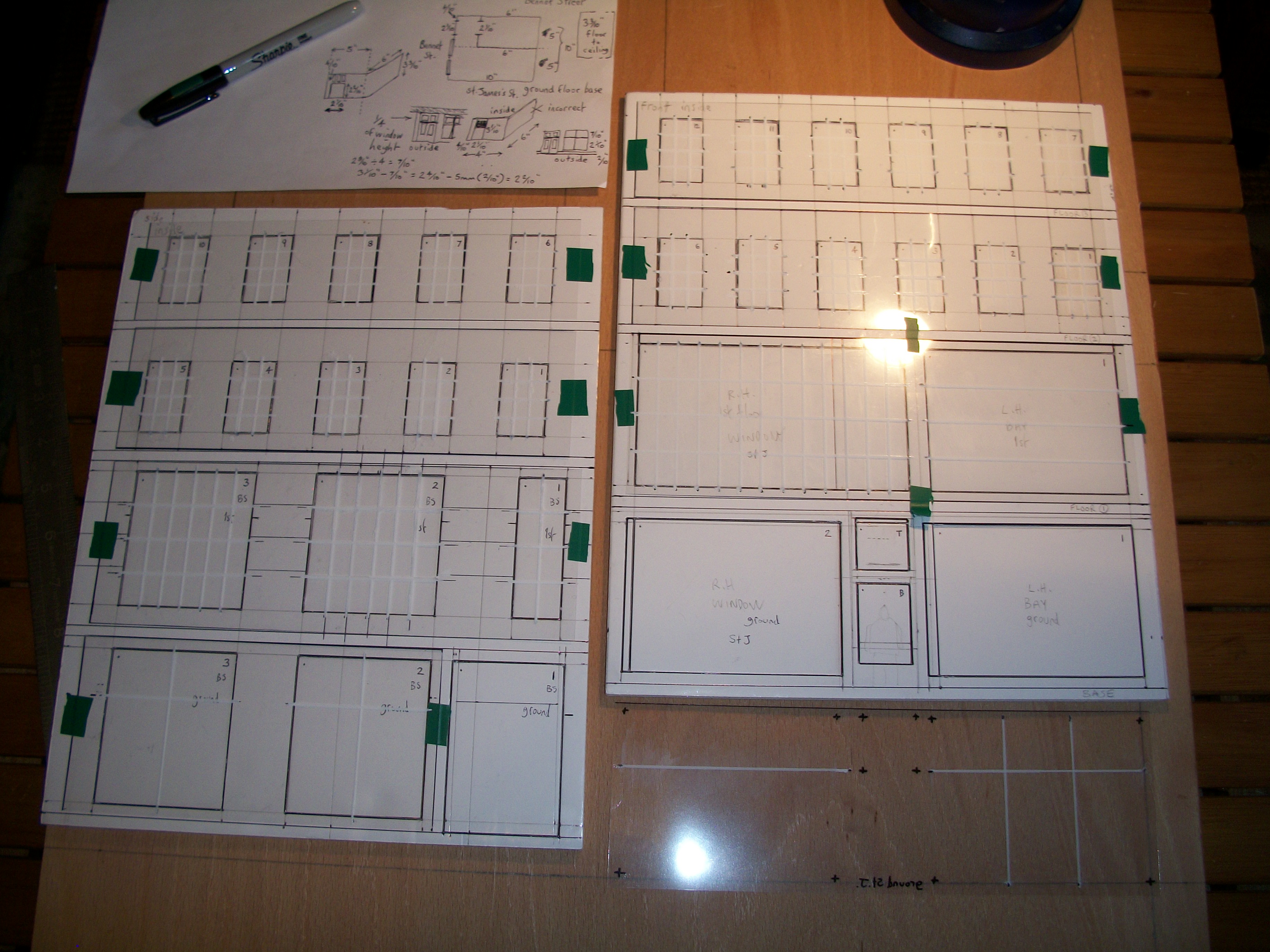

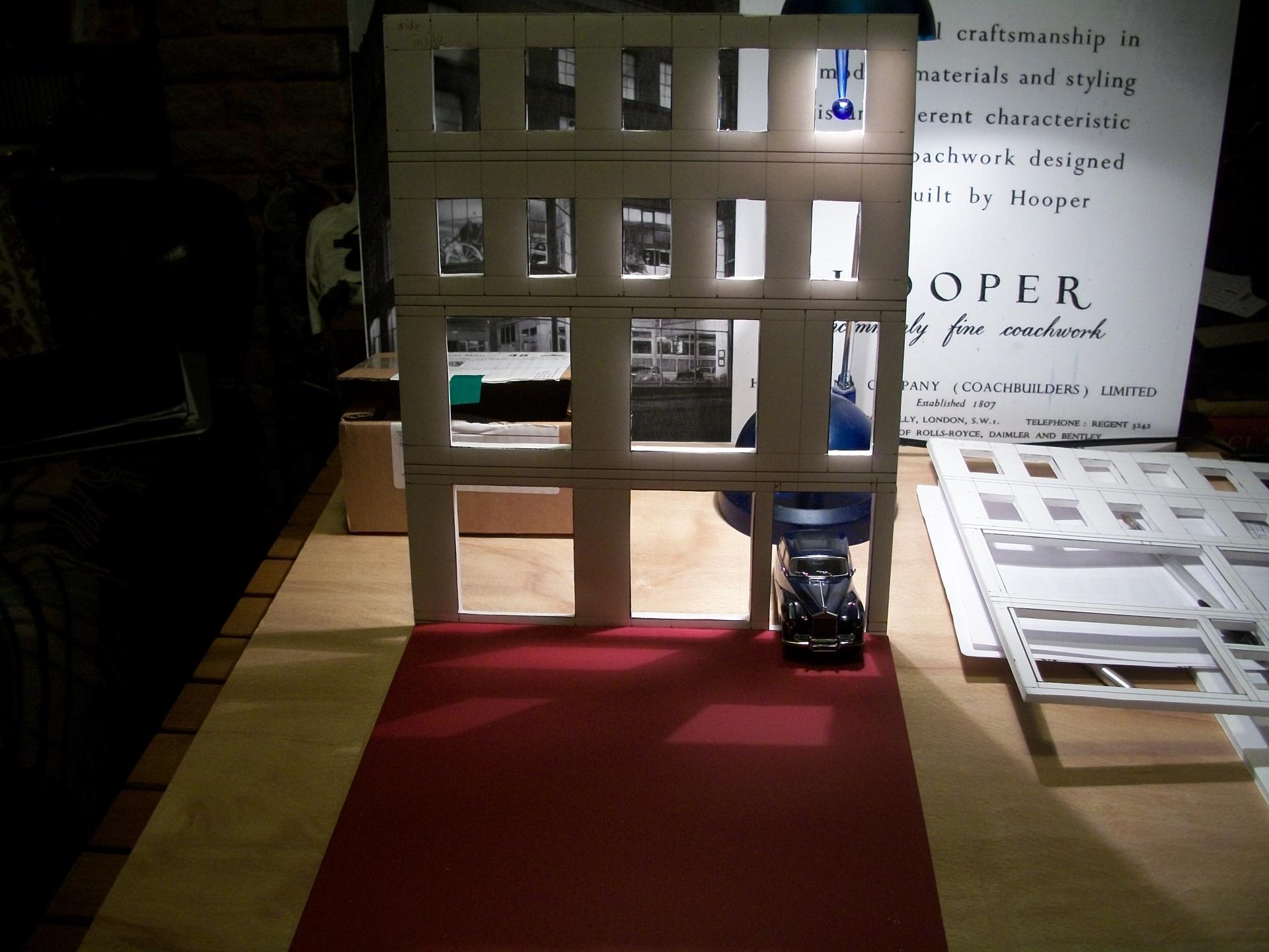

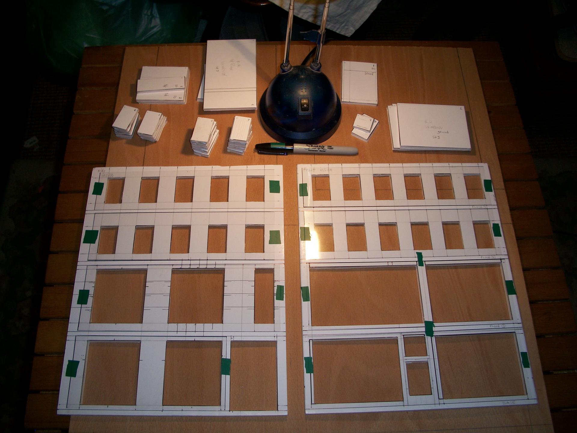

Anglia105E Posted February 28, 2019 Author Posted February 28, 2019 Work is going on with the complicated arrangement of windows in this building. The acetate transparencies have been cut to size and taped into position, ready for the white line painting, when the special Pentel white cellulose paint pen arrives in the post. Having saved all the blocks of foamboard that I cut out of the window apertures, and also having had the foresight to mark each block with a number indicating it's position and orientation, the blocks have been inserted back into their original holes and I shall be able to paint the lines straight across the wall panels, without the clear acetate sheet dipping into the apertures. The vehicle lift door entrance now has a sliding metal shutter, which in a previous life was a flexible protective sleeve that was placed over a Zero Paints bottle. In addition to the complex array of windows that you see in the photos, there is the bay window module that has to be constructed separately, to mount on the outside of the ground floor and the first floor levels. David

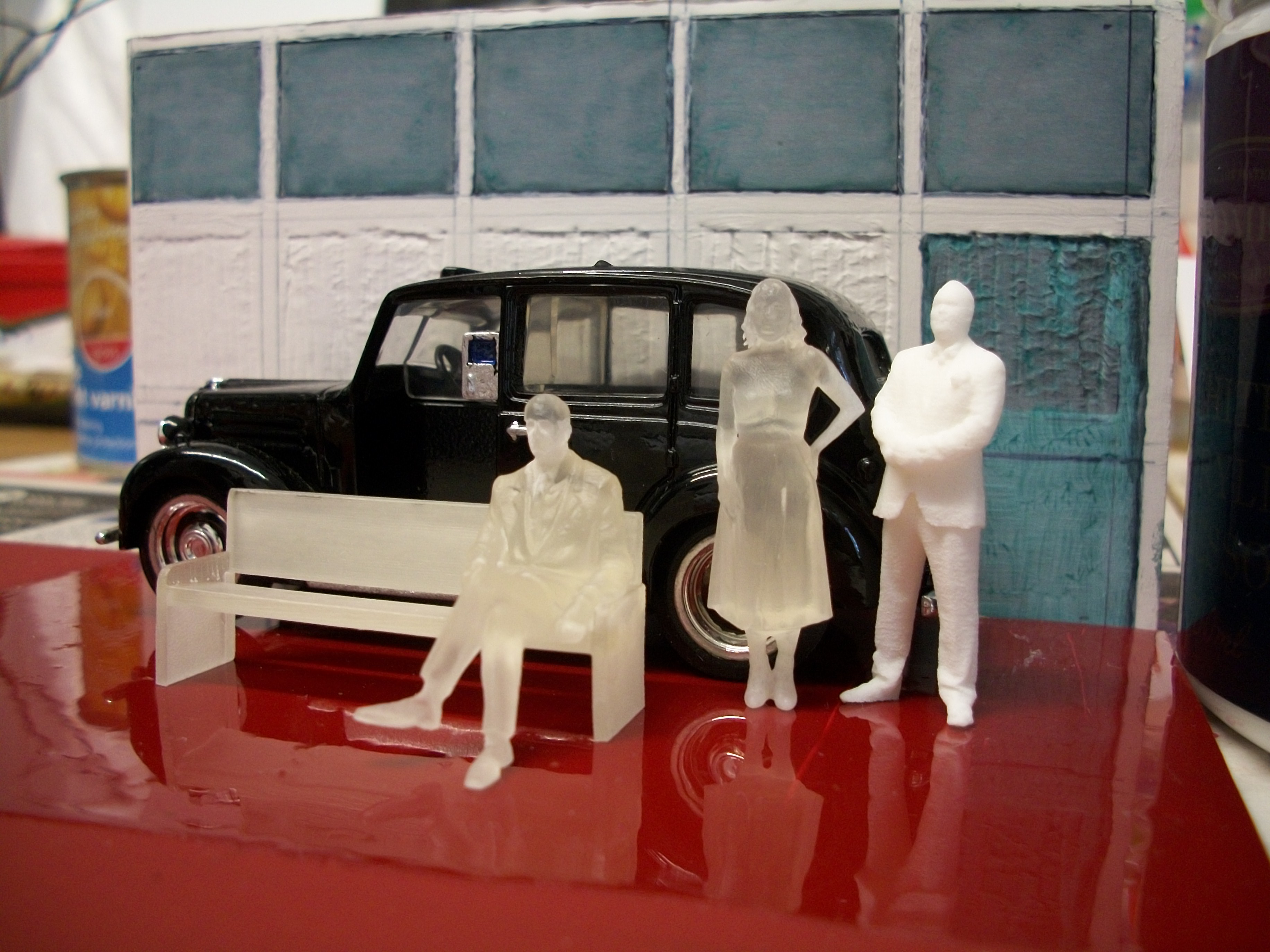

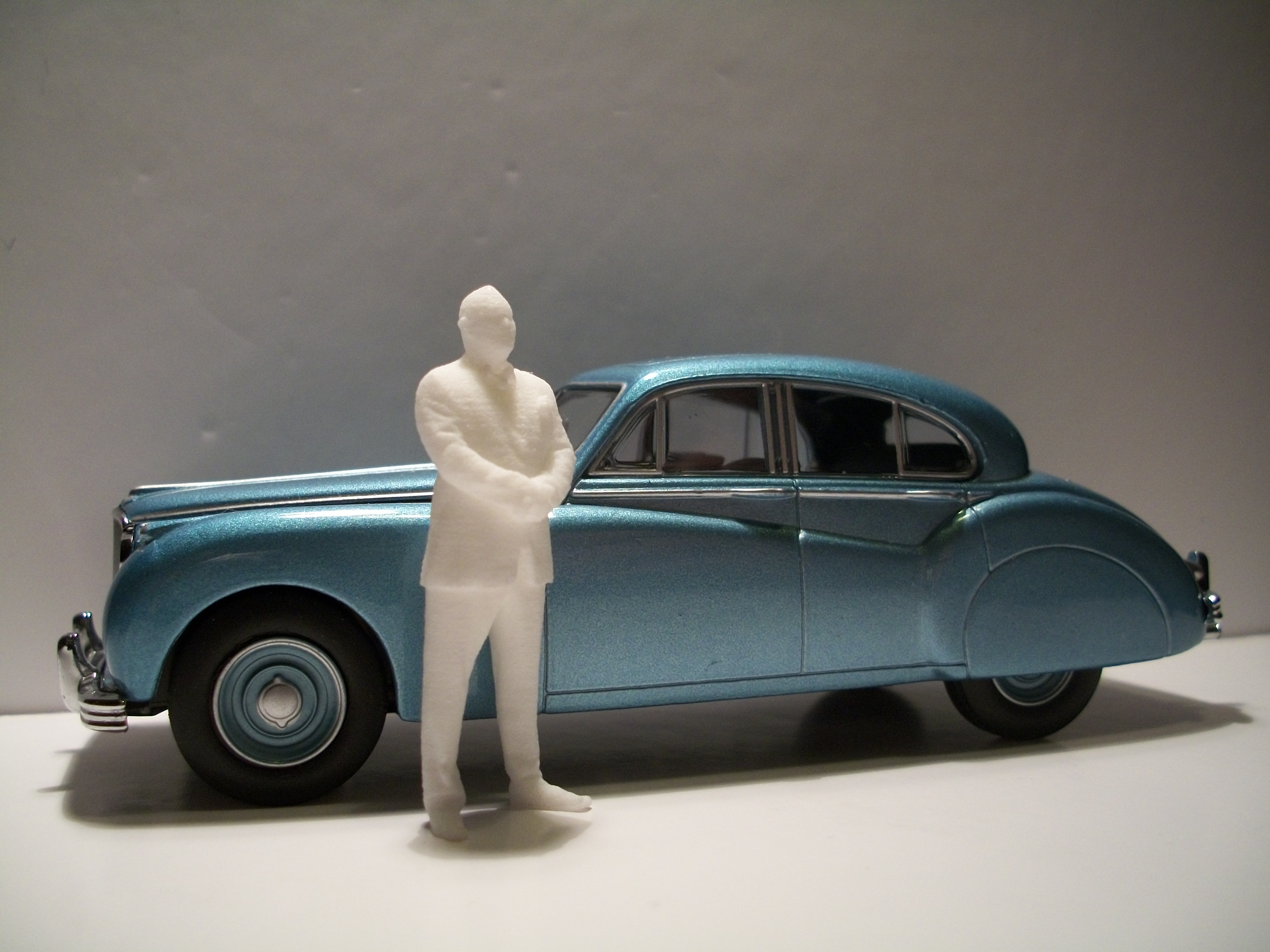

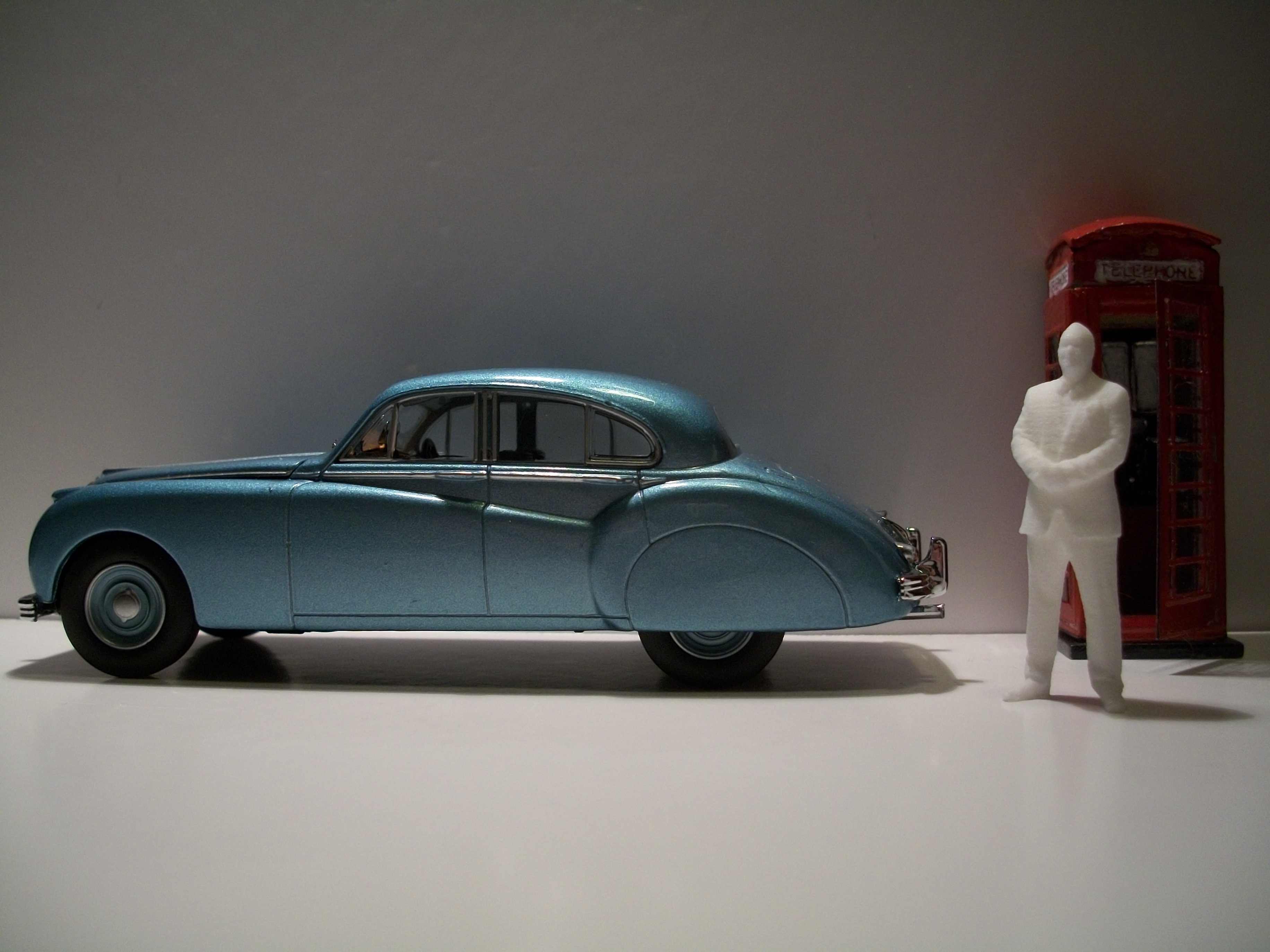

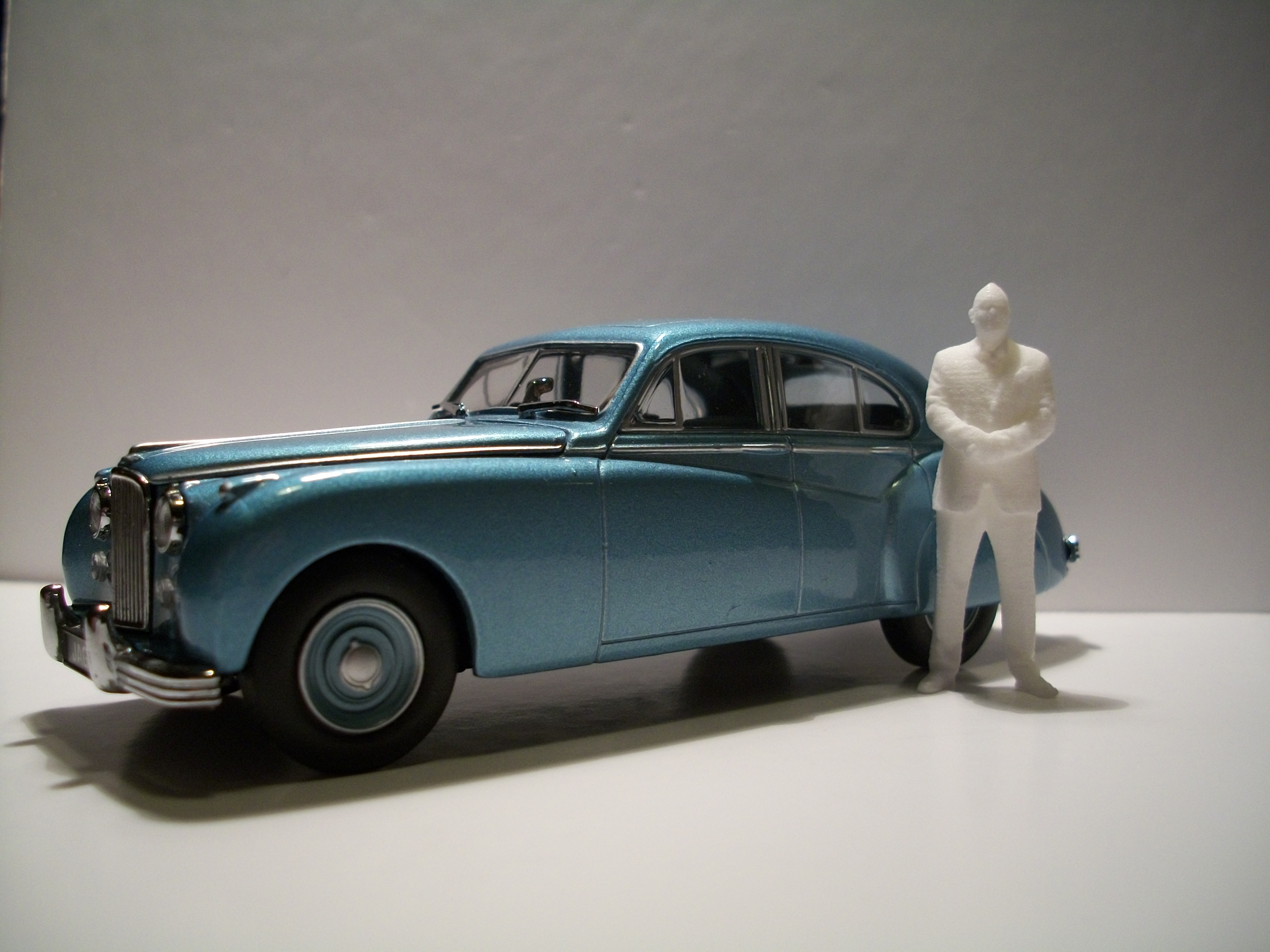

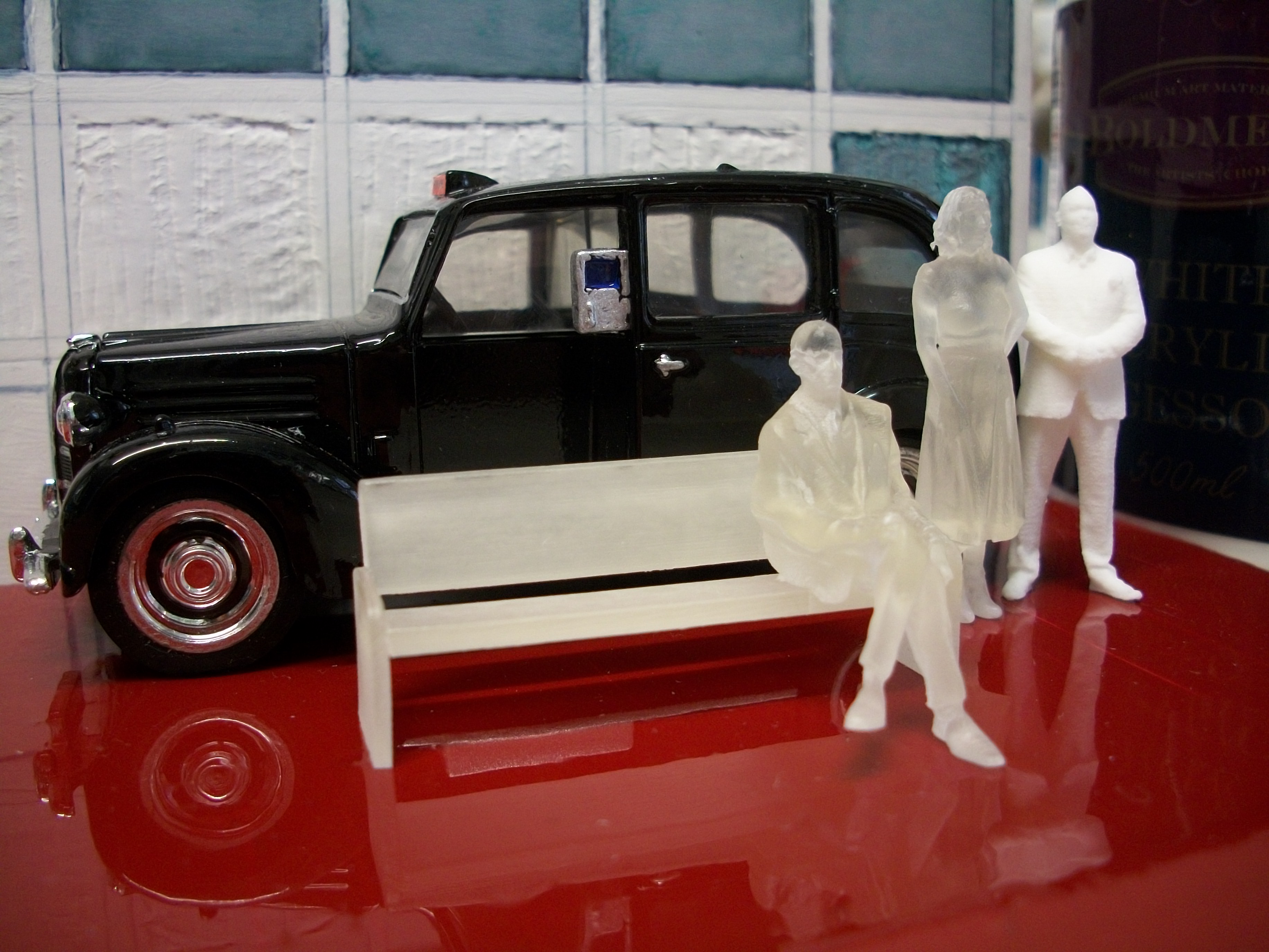

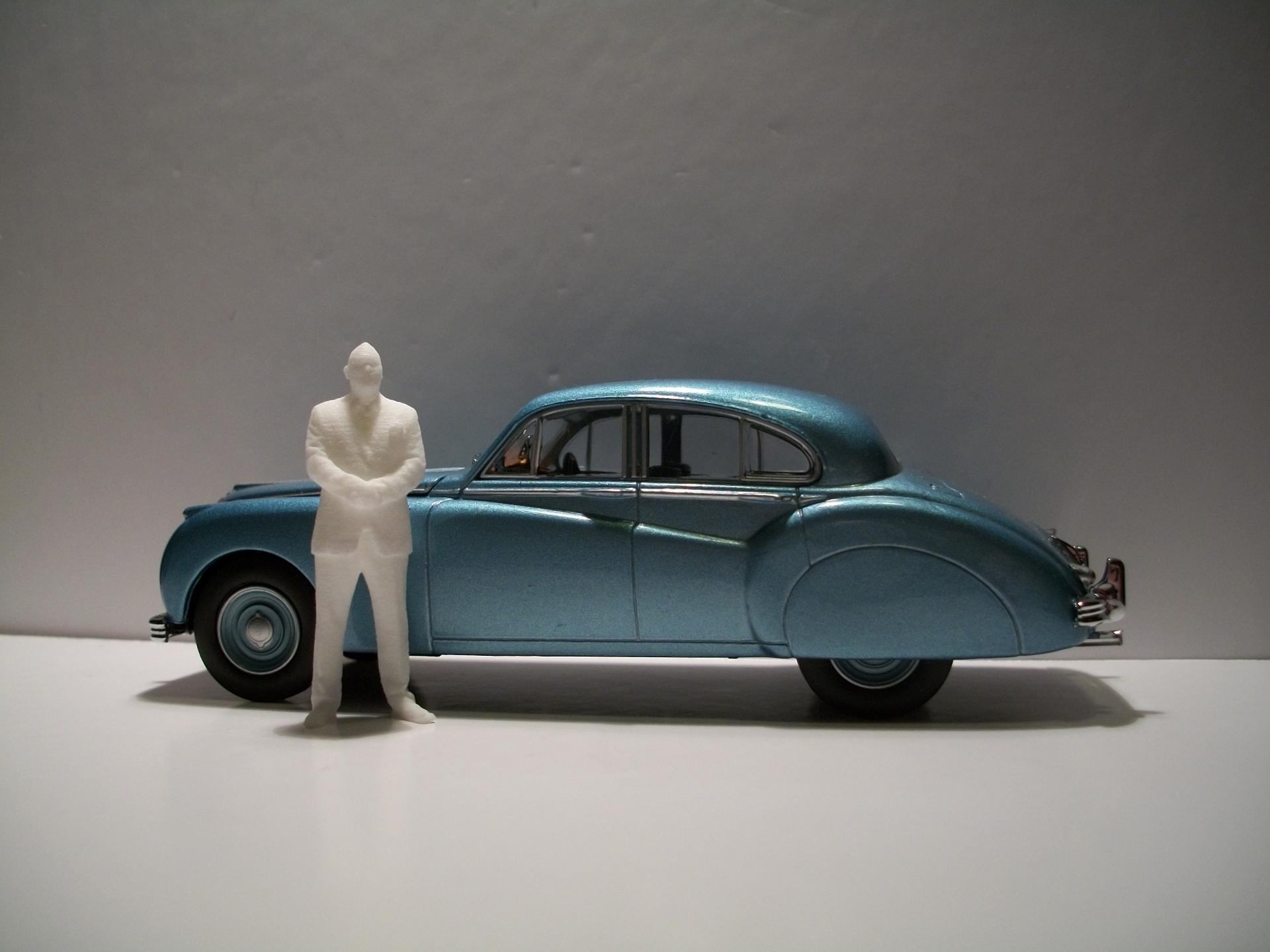

Anglia105E Posted March 2, 2019 Author Posted March 2, 2019 The 1:43 scale 3D-printed figures have arrived from Shapeways in the Netherlands, and these photos show these figures before any painting is carried out. The bald man standing, does fit nicely inside the telephone kiosk and he could turn out to be the proud owner of the Jaguar MK VII in Twilight Blue. There is a seated man on a bench and also a standing lady figure, both of which are printed in smooth fine detail plastic, and this material has a semi-transparent appearance to it. Painting the 1:43 scale figures will be quite a challenge for me I think, as I found painting the 1:24 scale figures fairly difficult. However, I do want these smaller figures to be an important element of the smaller scale diorama so I must find it in me to produce some realistic scale replicas of real people. David

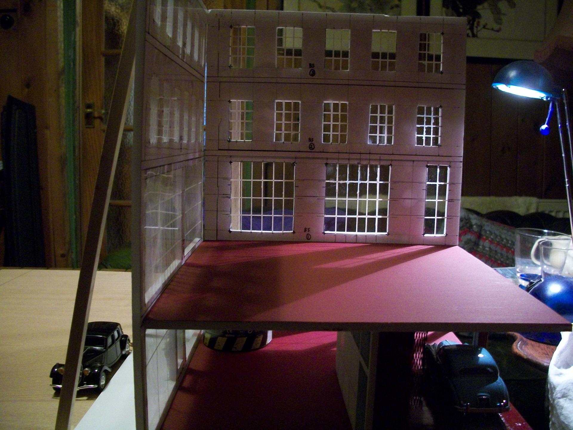

Anglia105E Posted March 2, 2019 Author Posted March 2, 2019 Thanks Yordan, Gary and Pat..... no I don't have a background in engineering or architecture, but when I was a young boy I dreamed of becoming an architect or possibly a car designer one day...... neither of which happened. I thought I needed a Jaguar MK IX or maybe a MK VIII, but decided I wanted the MK VII as it has spats on the rear wheel arches, in the very same style as the Jaguar MK I. Completed the white lining work on all of the window apertures for the two main walls of the building, so now it's all about mounting the acetate transparencies in place, over the window apertures and then applying white acrylic Gesso to the interior of the walls. Sign-writing boards of lettering need to be made up, before the Gesso can be applied to the exterior of the walls. Not too far away from hot glue fixing the partition wall onto the ground floor base. David

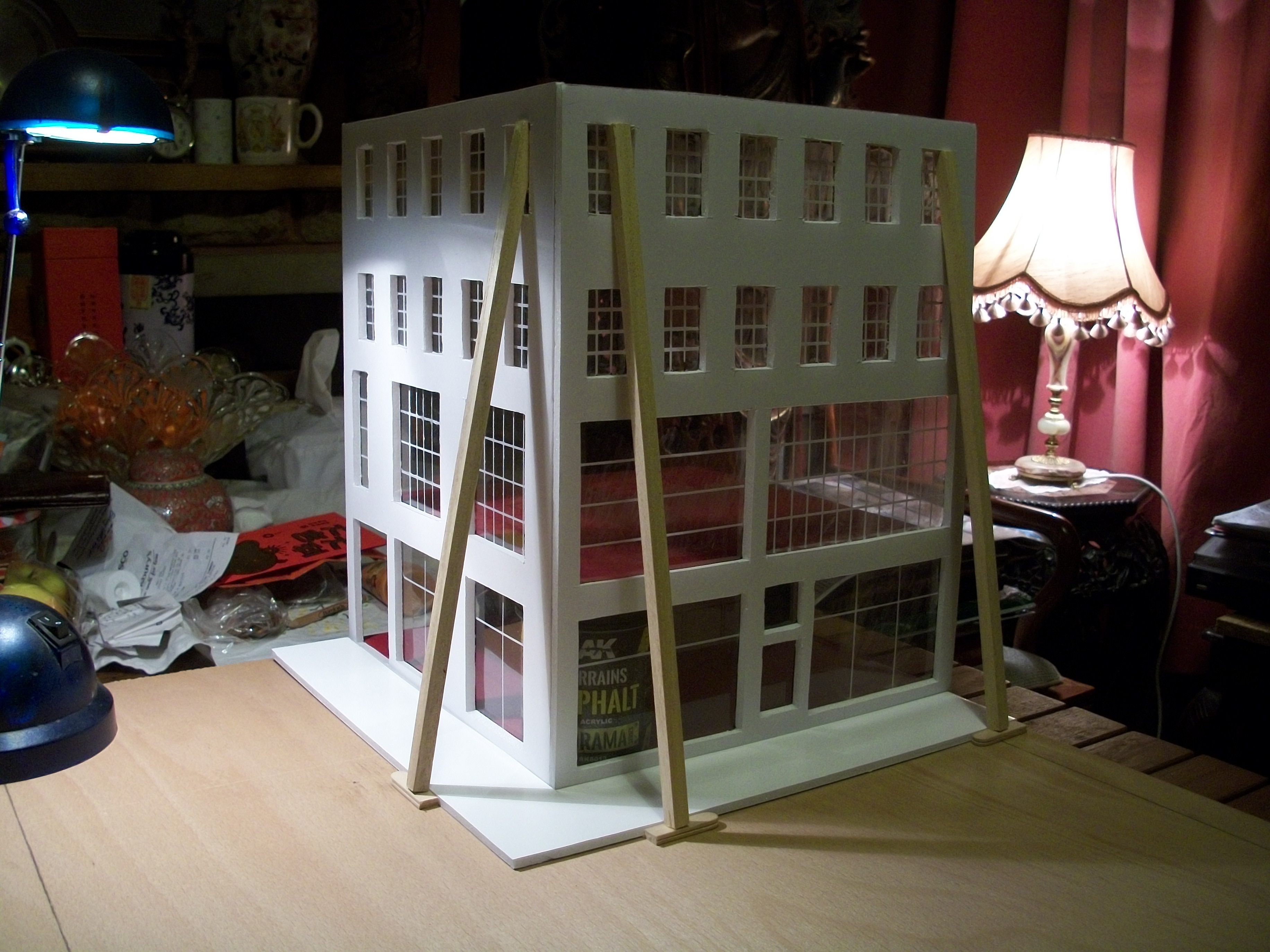

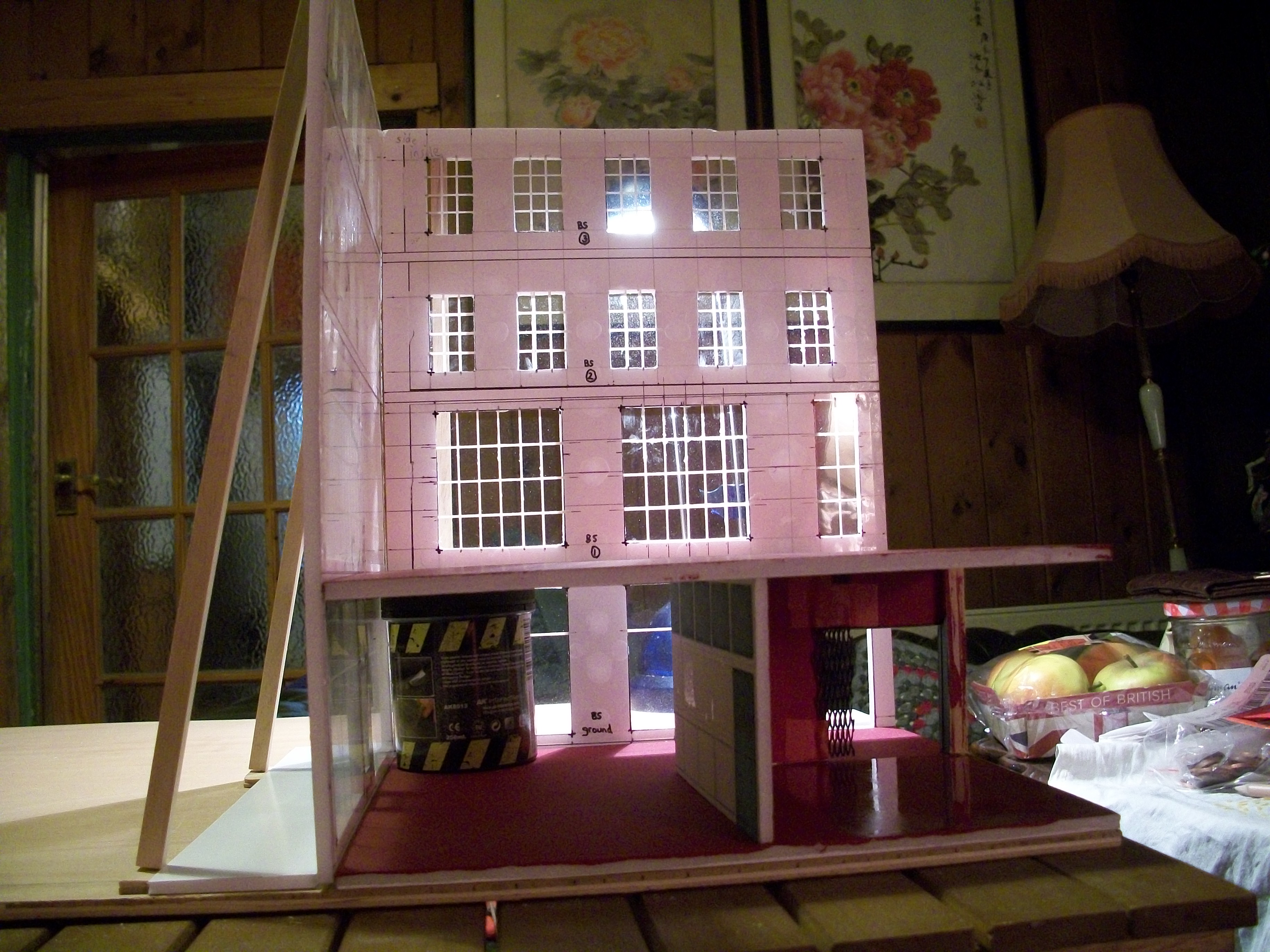

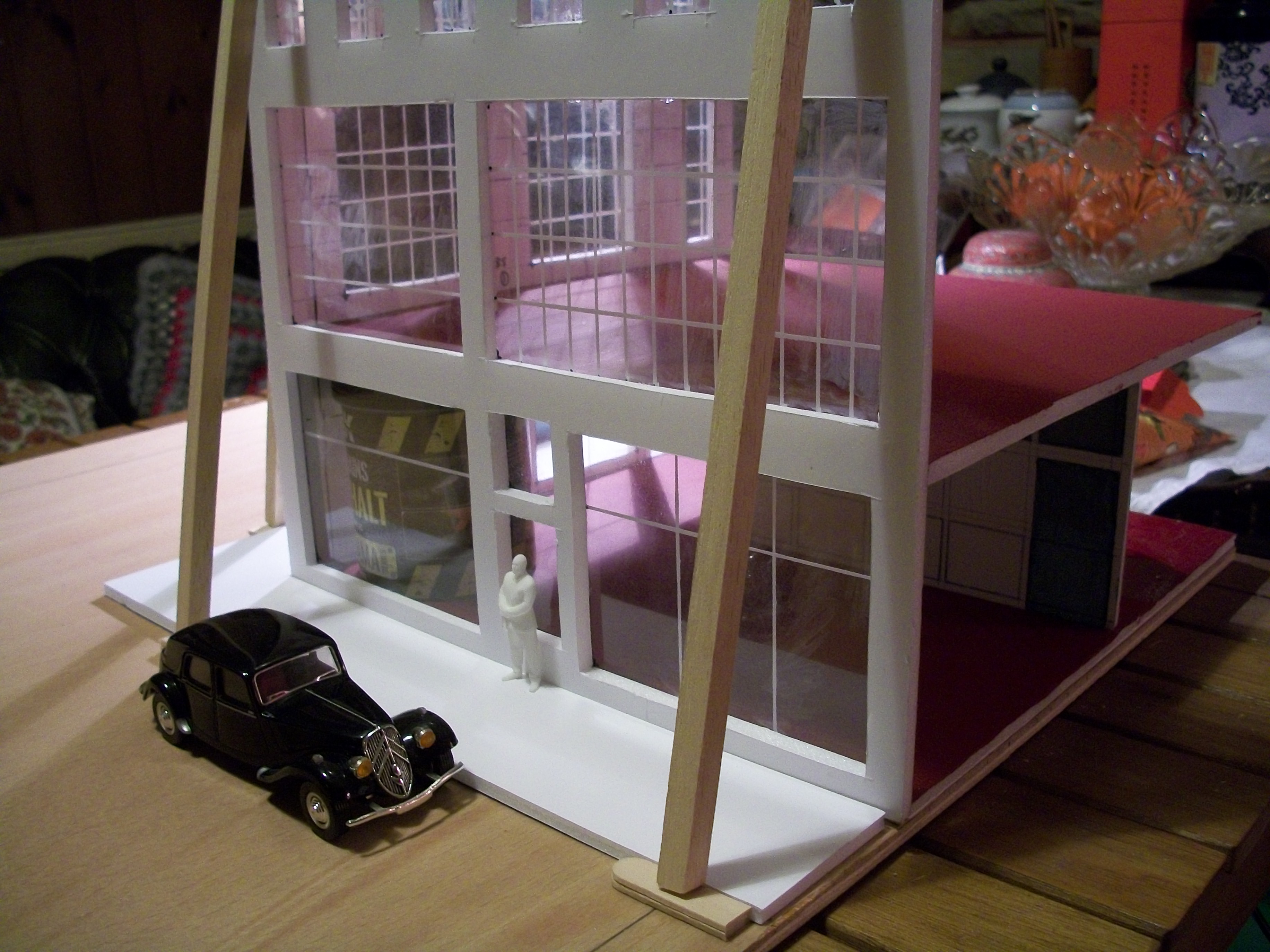

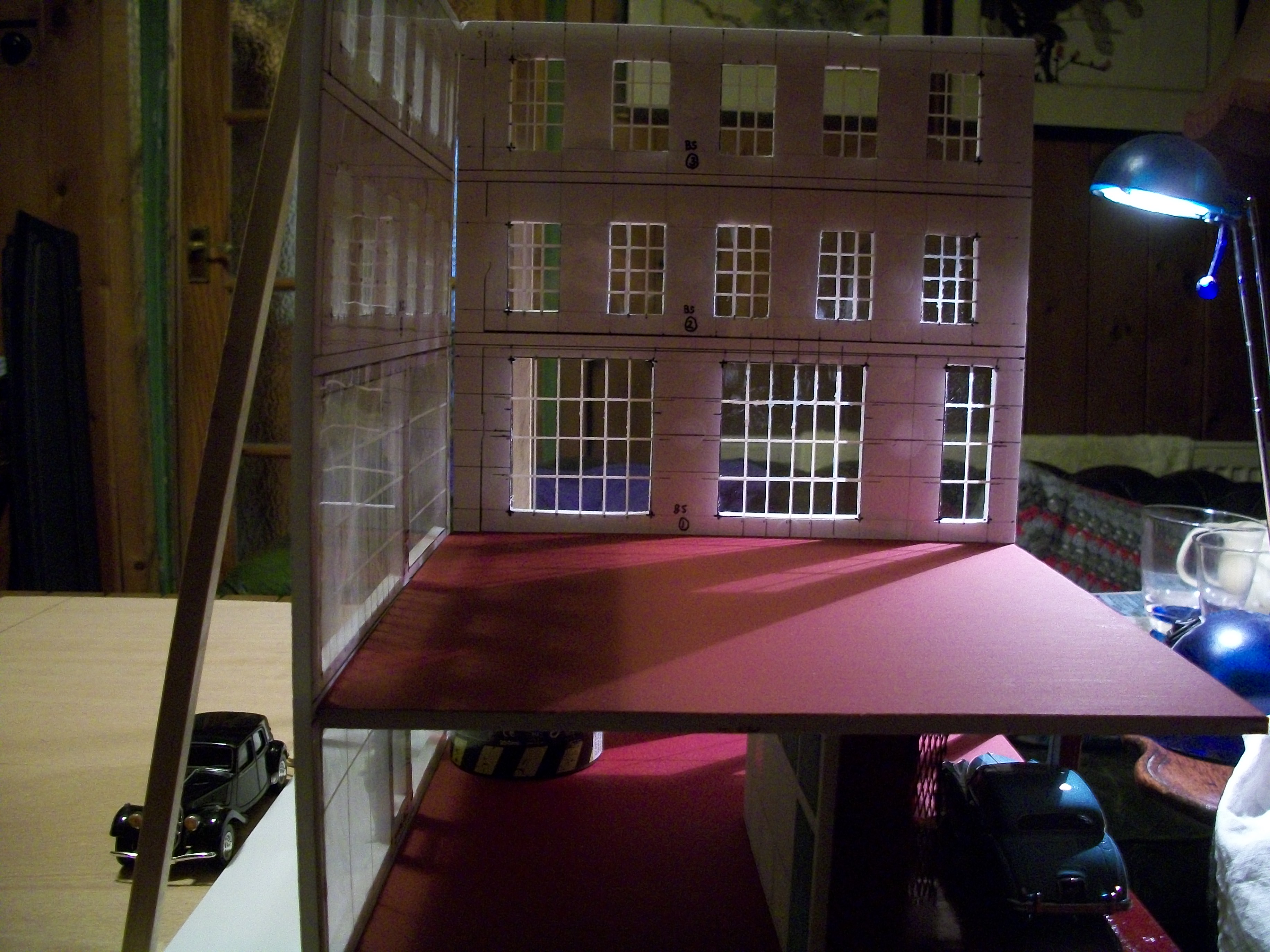

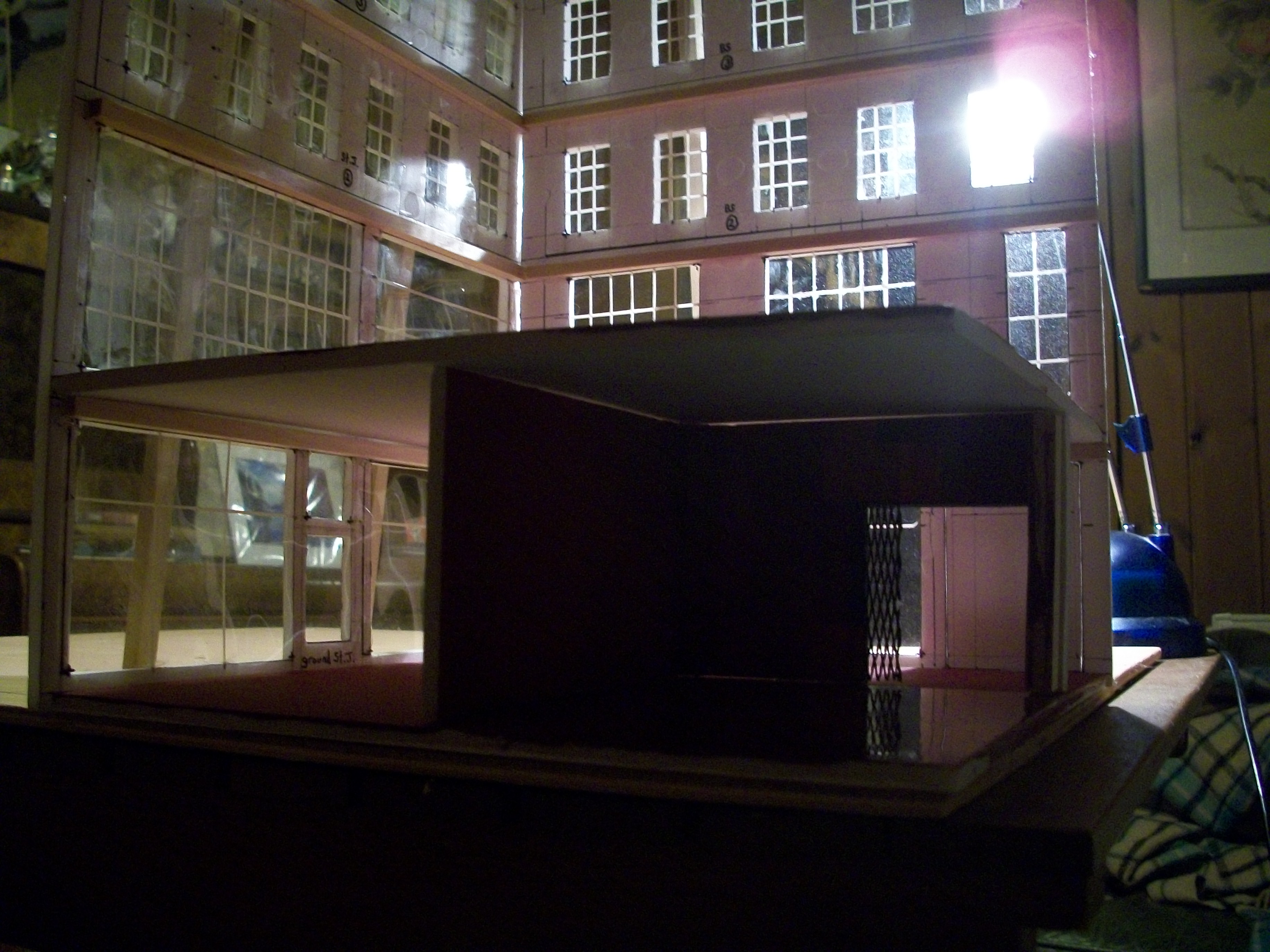

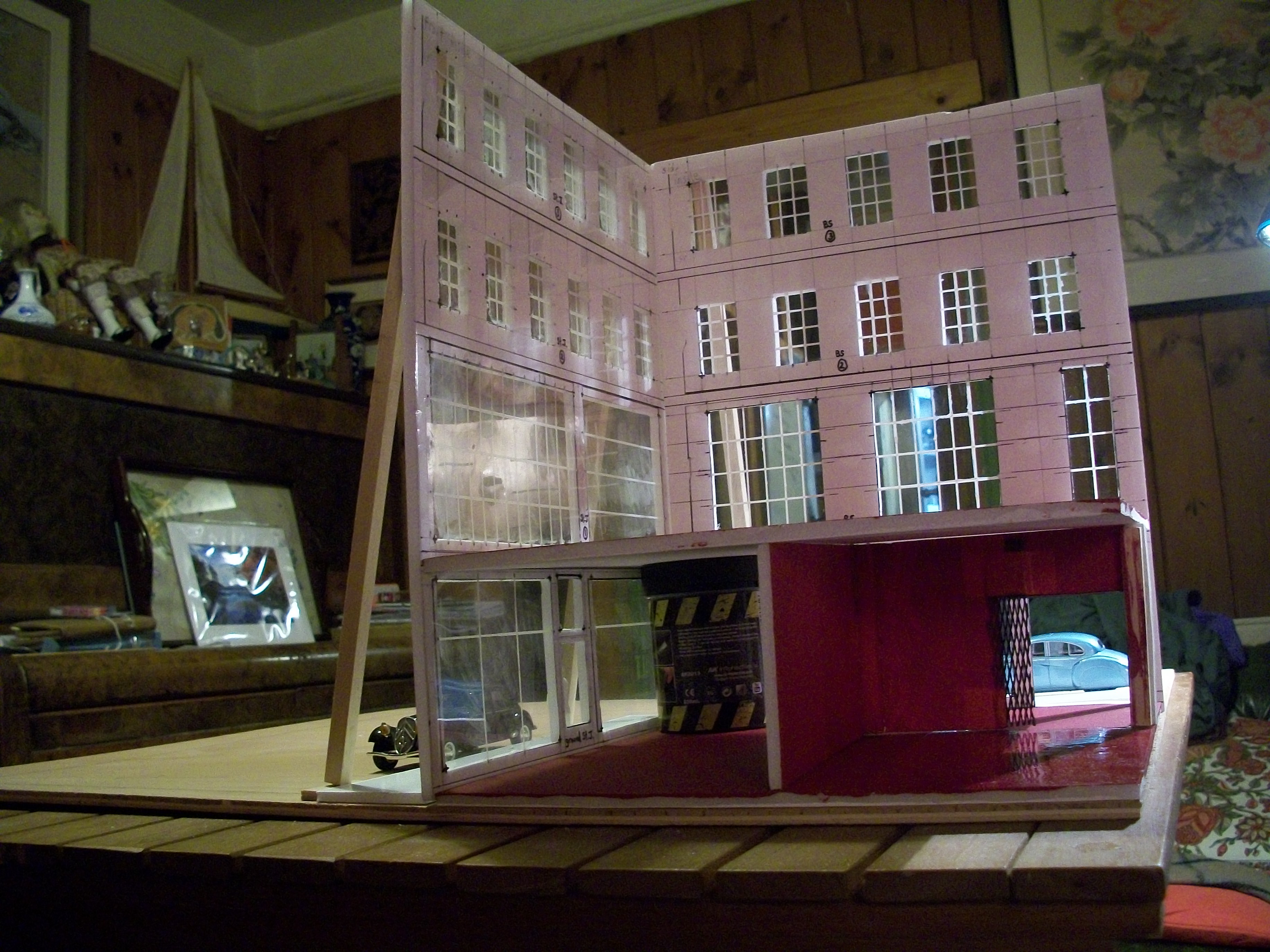

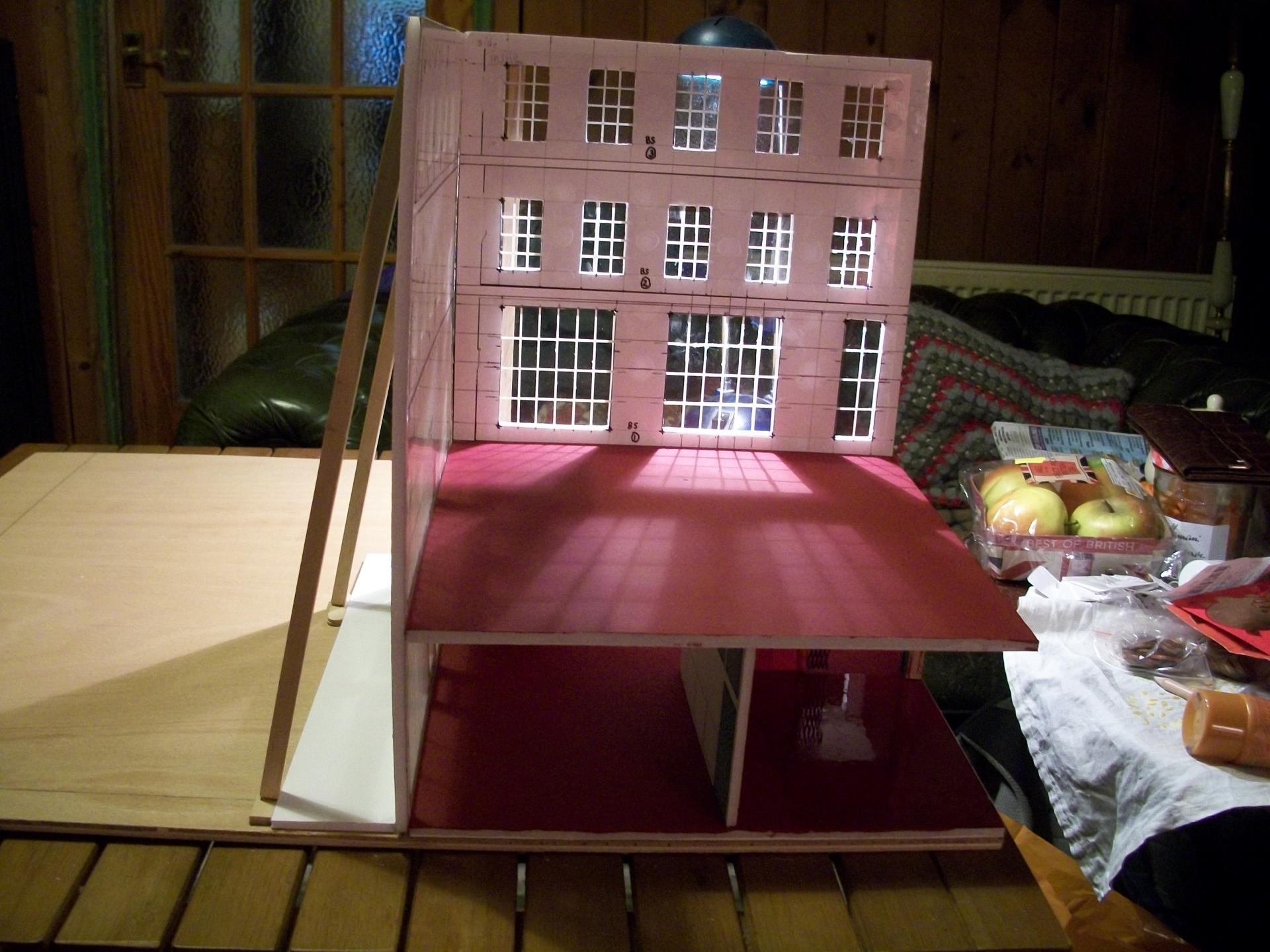

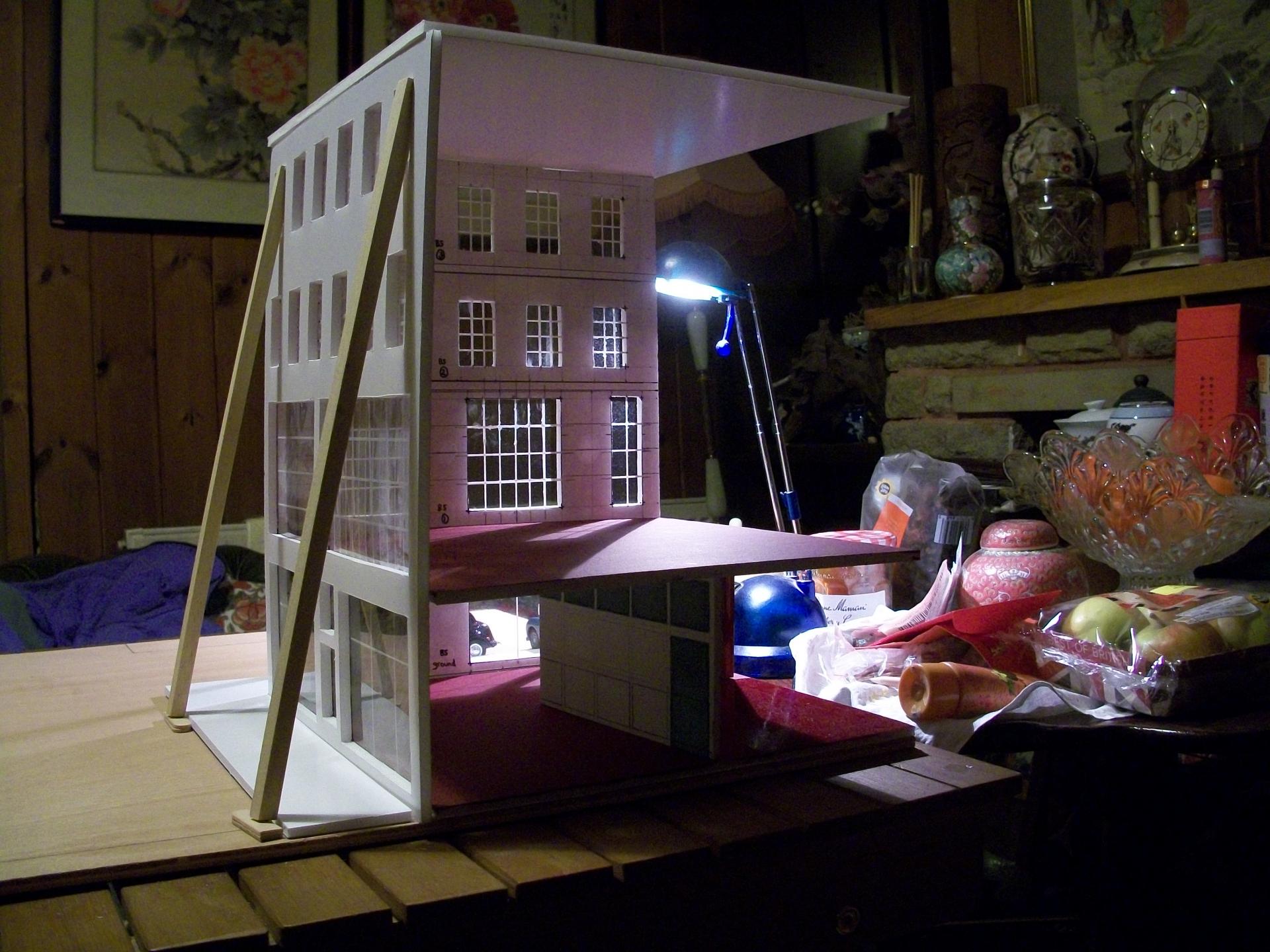

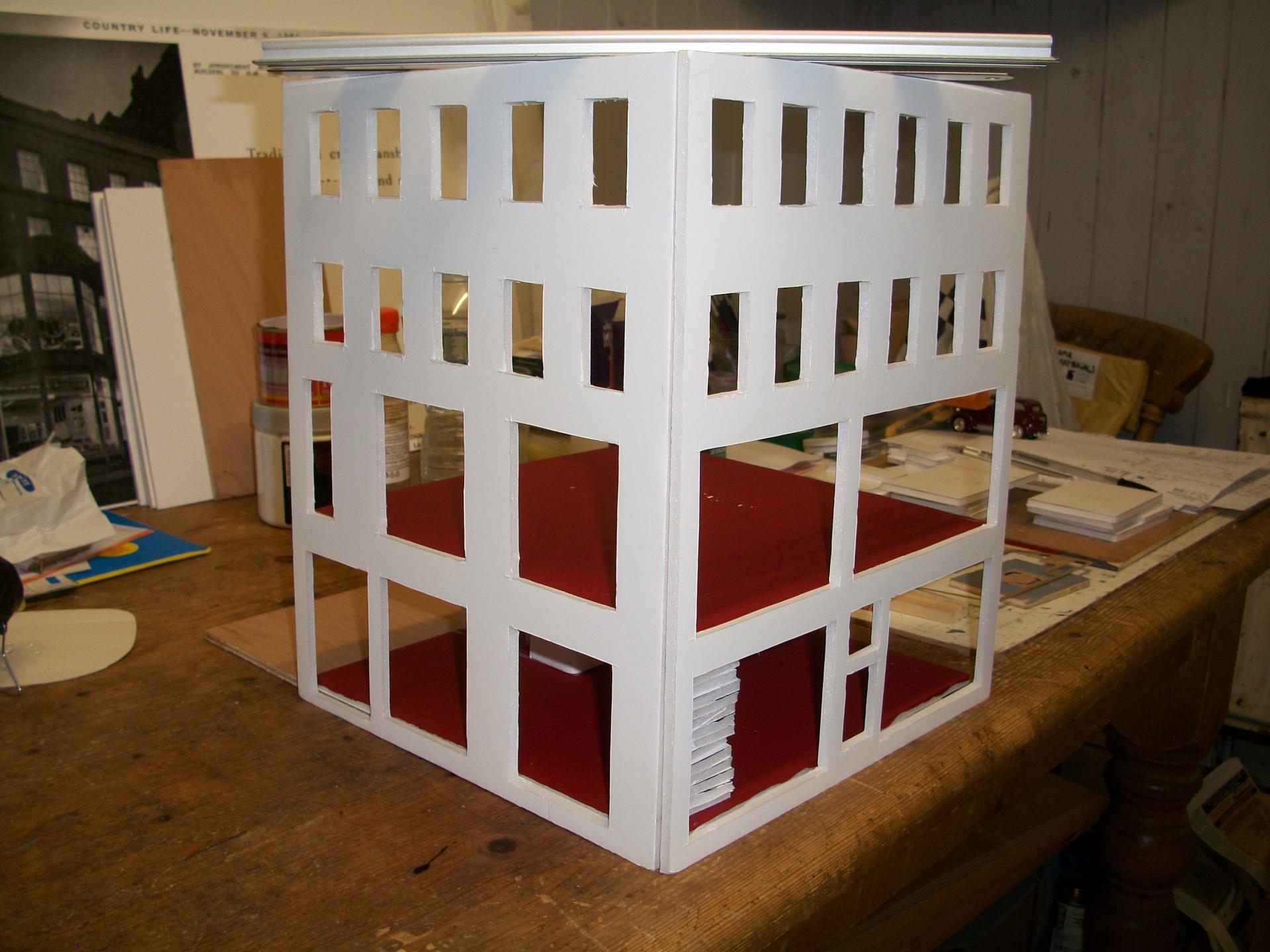

Anglia105E Posted March 3, 2019 Author Posted March 3, 2019 Reached the mock-up stage today, where I could visualise the scale model building with the two main walls standing in place, the ground floor base with the partition wall and the first floor, along with the roof placed on top of the structure. The lighting effect is quite interesting by accident, showing the reflected crimson light on the white walls inside the building from behind. The vehicle lift entrance seems to work, but I'm not sure if I should have the vehicle lift coming up out of the first floor, as I don't have any reference photographs to work from. David

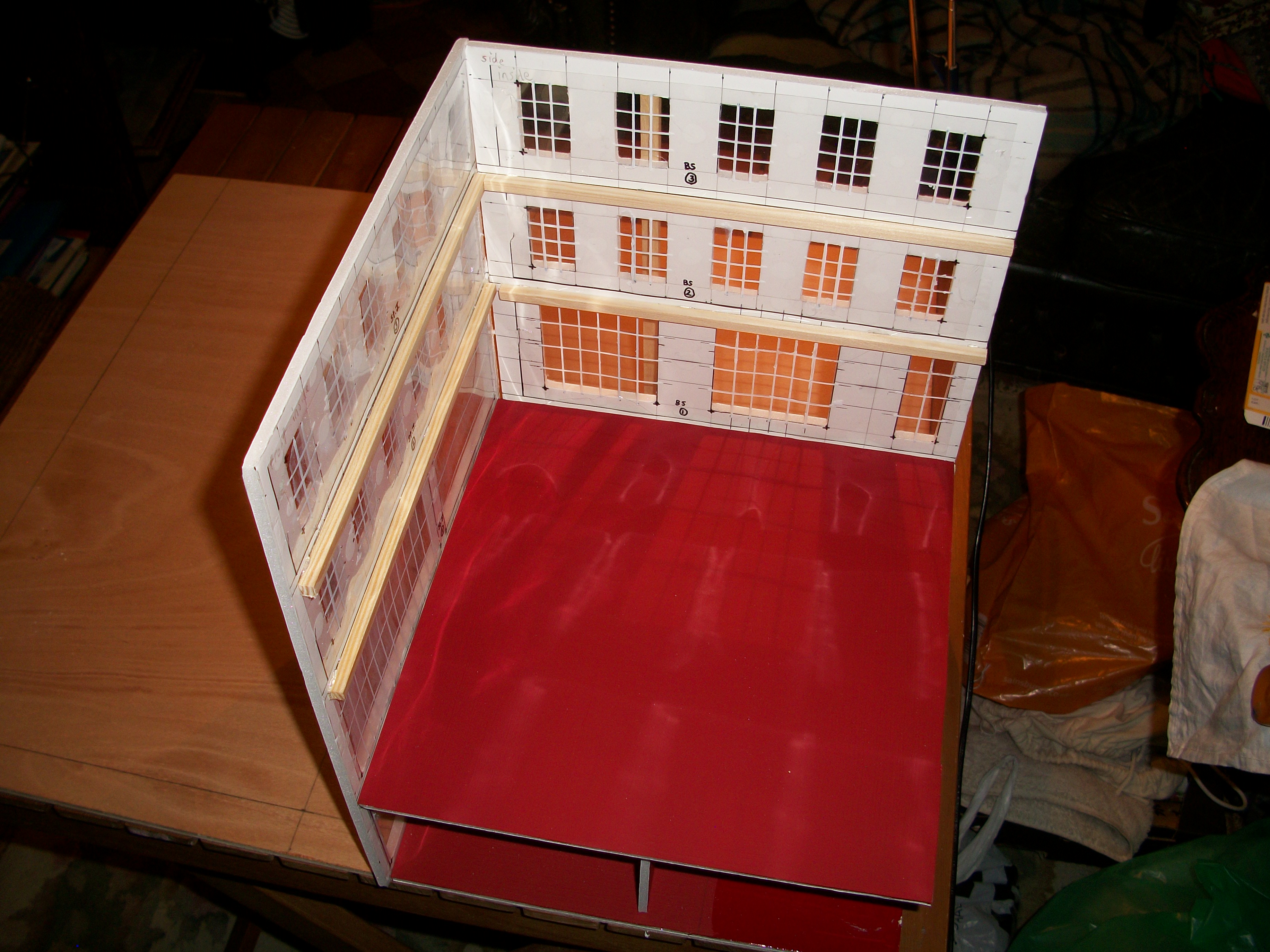

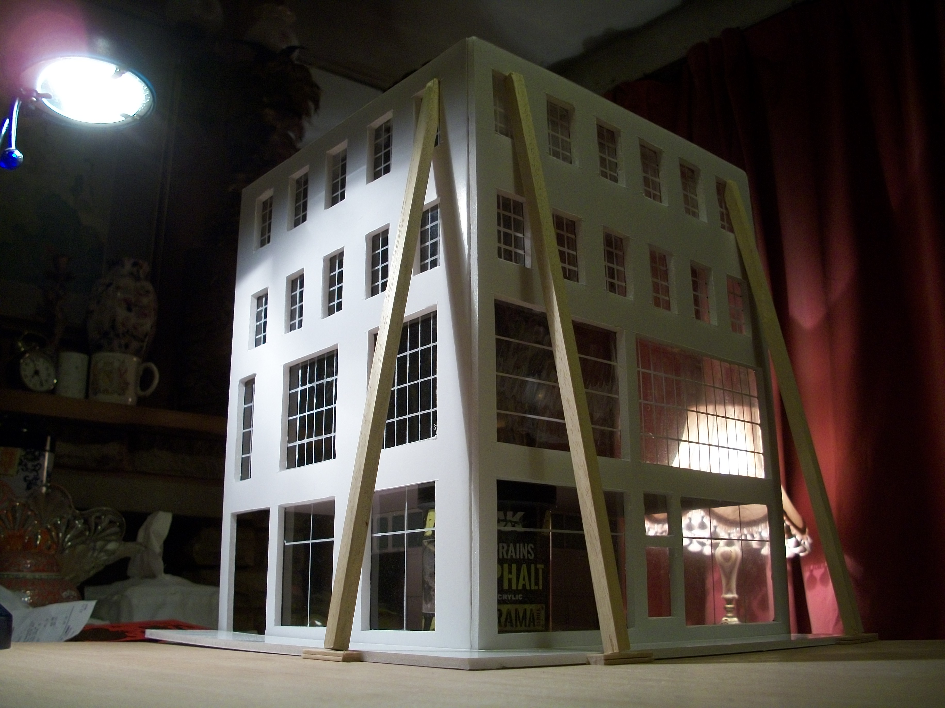

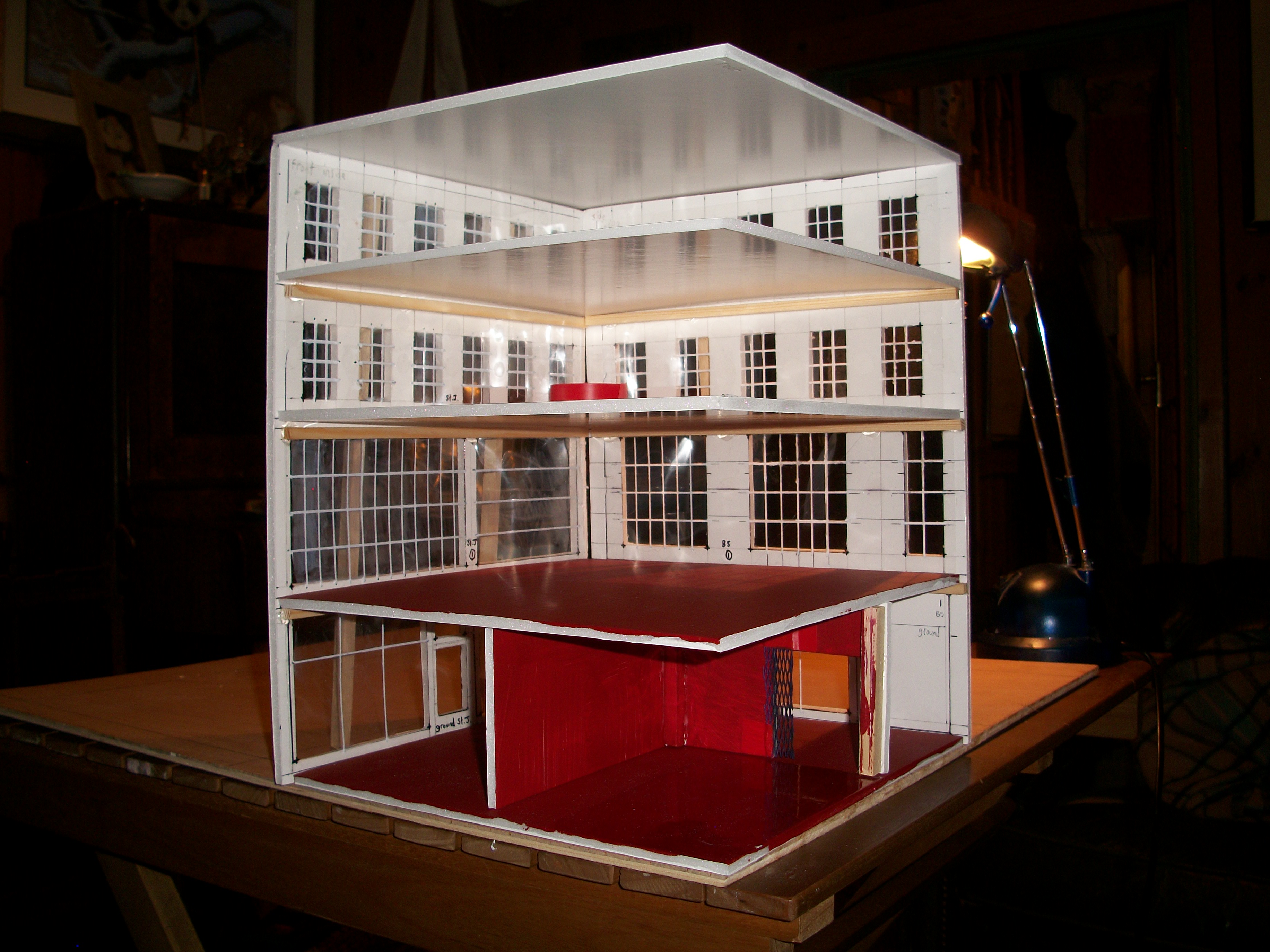

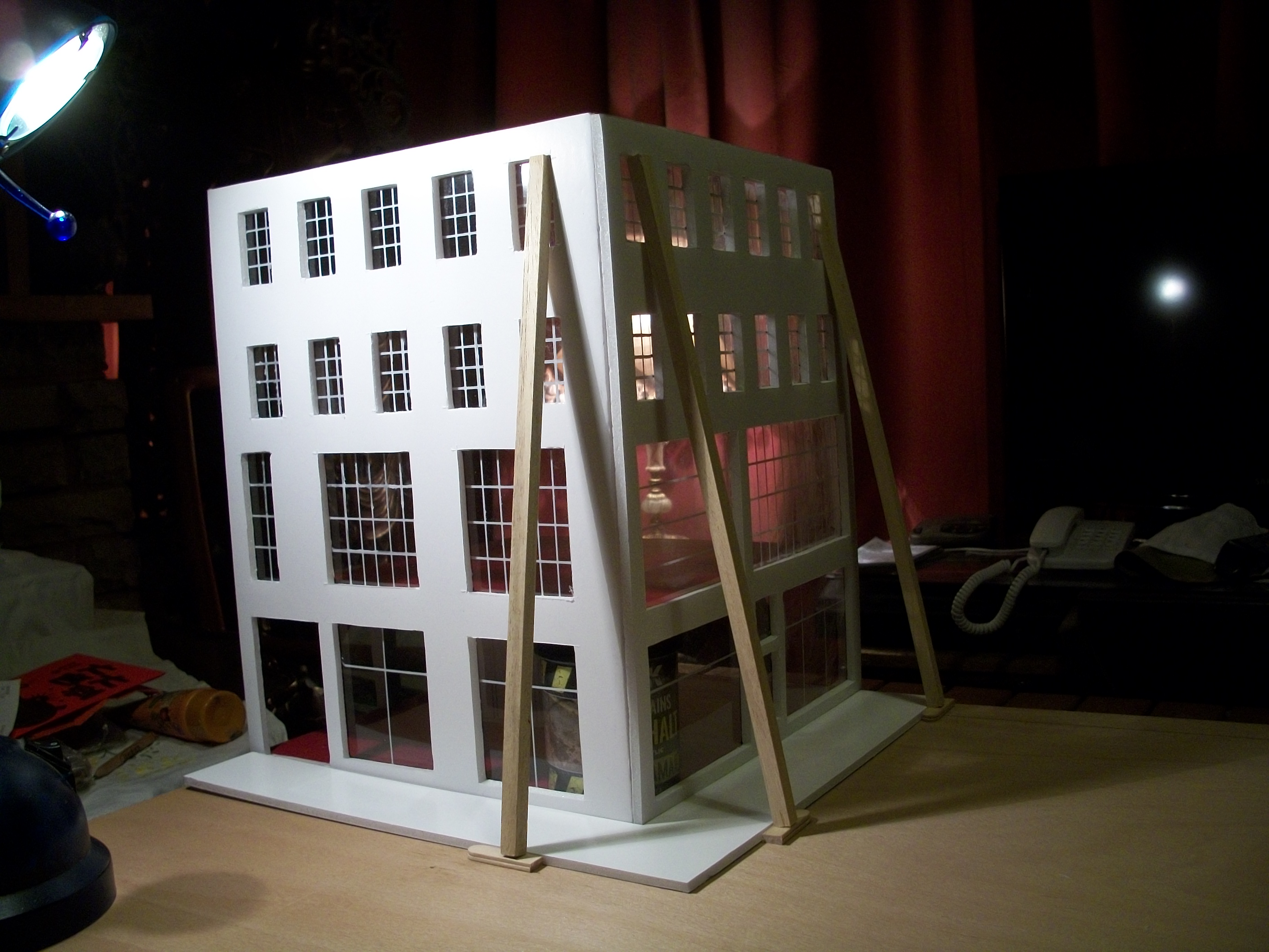

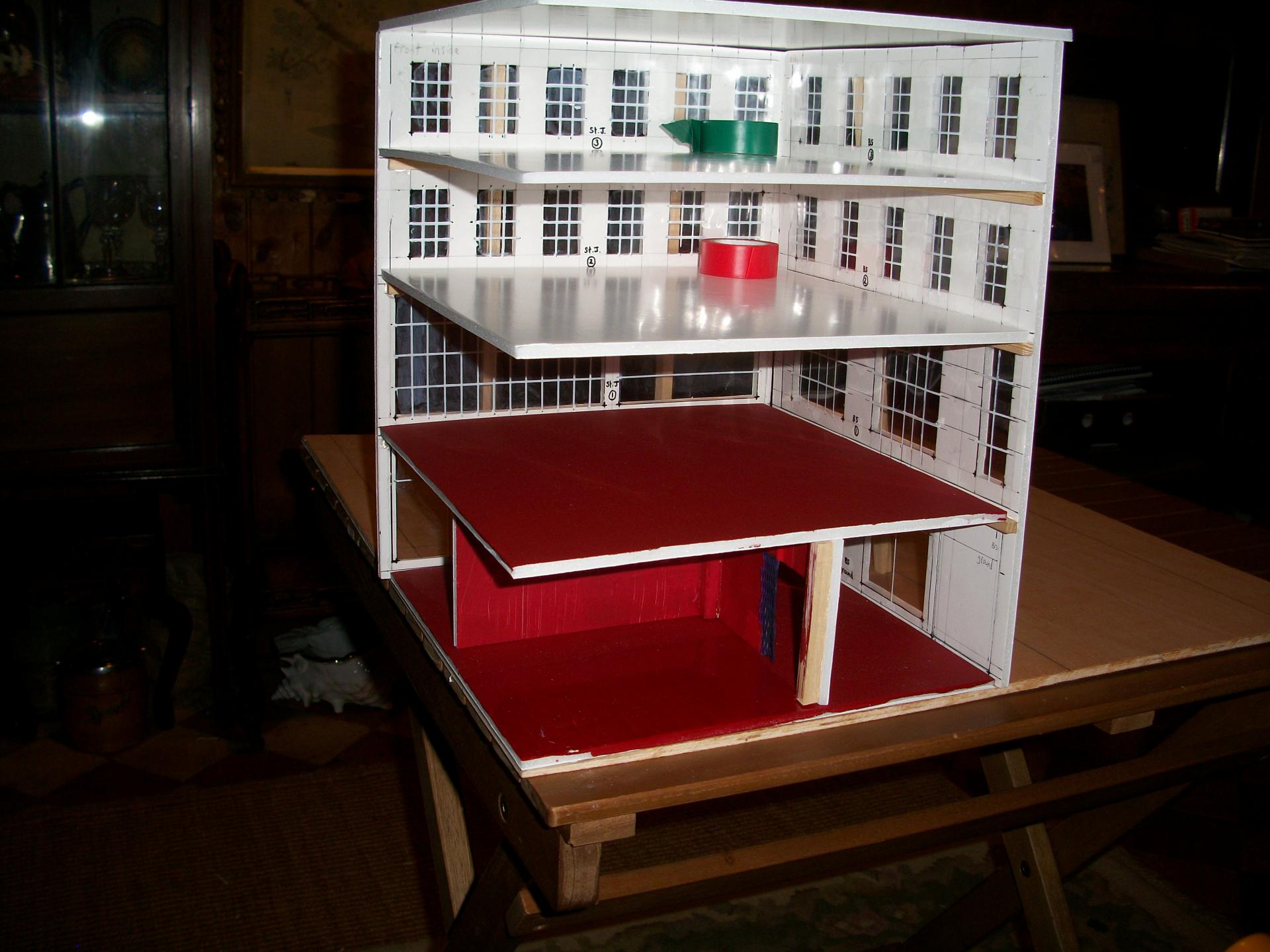

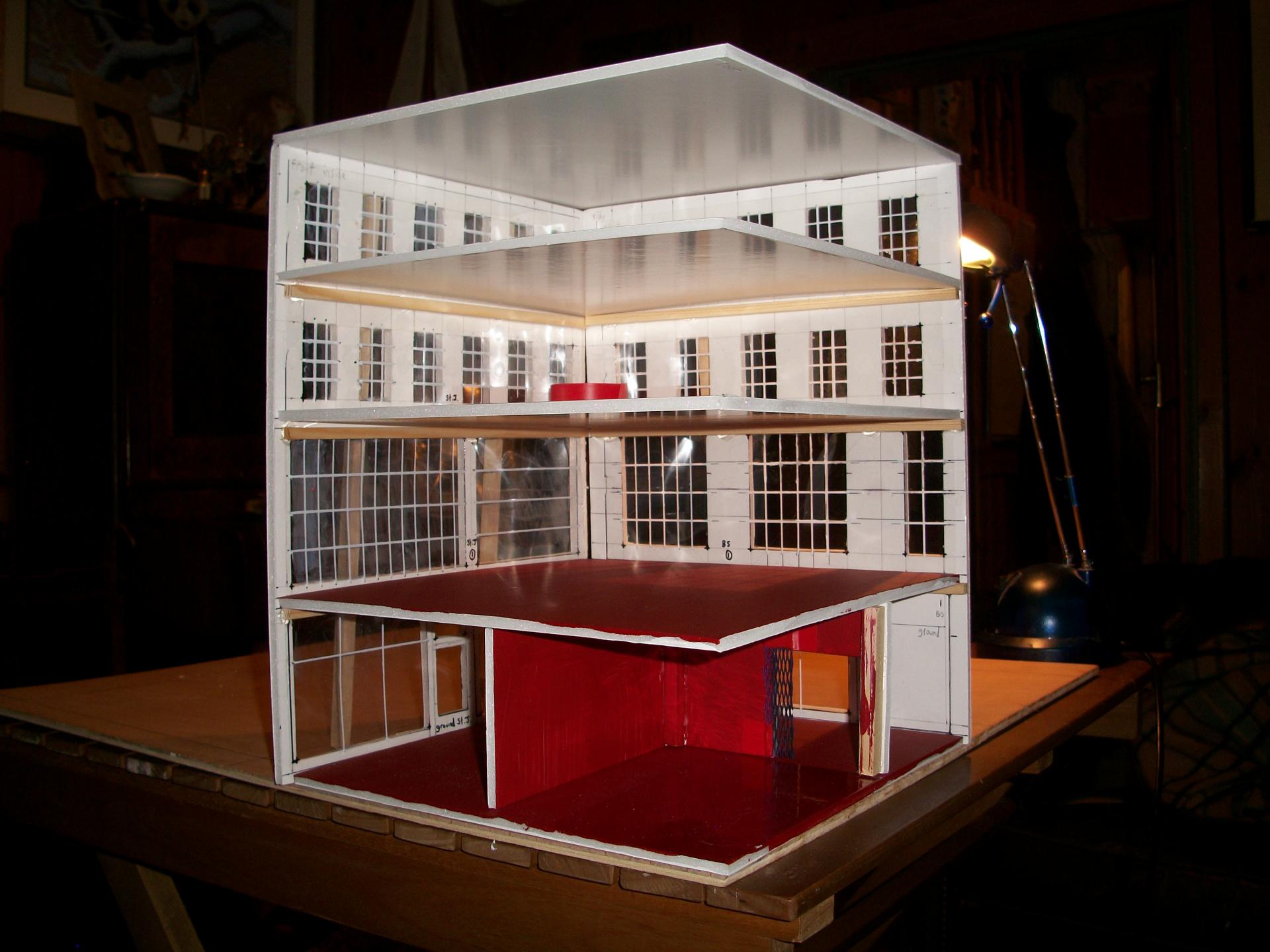

Anglia105E Posted March 5, 2019 Author Posted March 5, 2019 Decided to add six wooden beams to support three of the floors. The ground floor and the roof are supported anyway, so this is to provide some means of support and to add an element of strength to the structure. Began painting the black main front door, also the black vehicle lift door and the opening into the ground floor office. Sign writing and white acrylic Gesso are scheduled to happen over the next couple of days. The following mock-up shows the five floor levels in place but not fixed yet. I think the photo number 4495 does have quite a realistic look to it, considering this is a 1:43 scale diorama model. David
