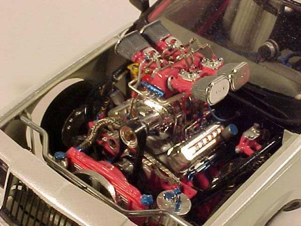

astroracer Posted October 5, 2017 Posted October 5, 2017 And don't just look at models. In order to authentically replicate a race motor of any kind you need to know what the real motors look like. Subscribe to a few car magazines and look on parts sites like Summit and Jegs. The real key to a good model is scale. Getting the parts scaled correctly is 90% of the job. Wires, fittings, hoses and tubing sizes are some of the areas where scale is important. A full size ignition wire is 3/8ths to 1/2" inch in diameter. A model ignition wire that is any bigger then .020 in diameter is too big. I built this BBC in 1989. There is well over 100 hours into building it (just the engine) and there isn't a lot of parts that aren't to scale.
