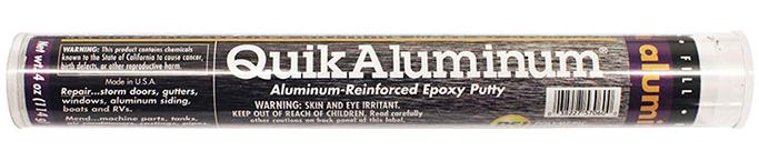

Lunajammer Posted October 4, 2017 Posted October 4, 2017 Not to confuse the subject, but I highly recommend this stuff if you can get it (might have to order online). Quik Aluminum, not be be confused with any other "Quik" epoxies. The 2-part epoxy kneeds together like clay, is easy to work and sculpt with for about 5-minutes and once hard it sands almost exactly like Bondo 2-part putty and feathers well. Water on your finger will smooth it. Wear gloves and avoid the aluminum dust when sanding.
