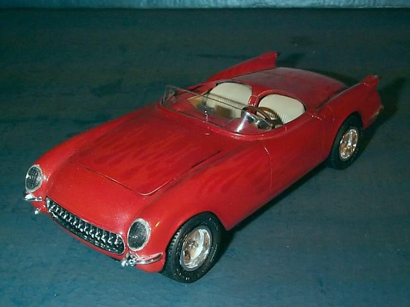

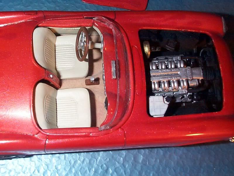

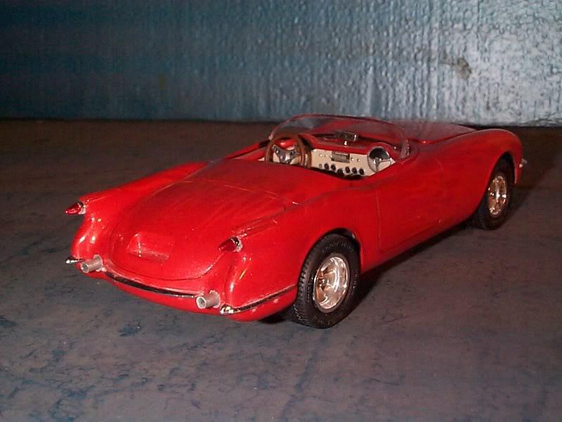

randyc Posted October 6, 2017 Posted October 6, 2017 These are an orange pearl. So not helpful really. But I painted whole car with a few coats. Applied the flame masks. Applied more paint. removed masks. clear. IF I were doing this with solids or opaque colors, I would apply the solid/opaque first, then a negative mask, spray the ghost color, remove masks and clear to smooth. I do have a satin black car I want to eventually put metallic or pearl red ghosts on. Maybe. I don't have access to the sign equipment that I use when I did the vette. Have to go light for hte ghosts. I would like for the vette flames to be a little more pronounced, but can't change it now.
