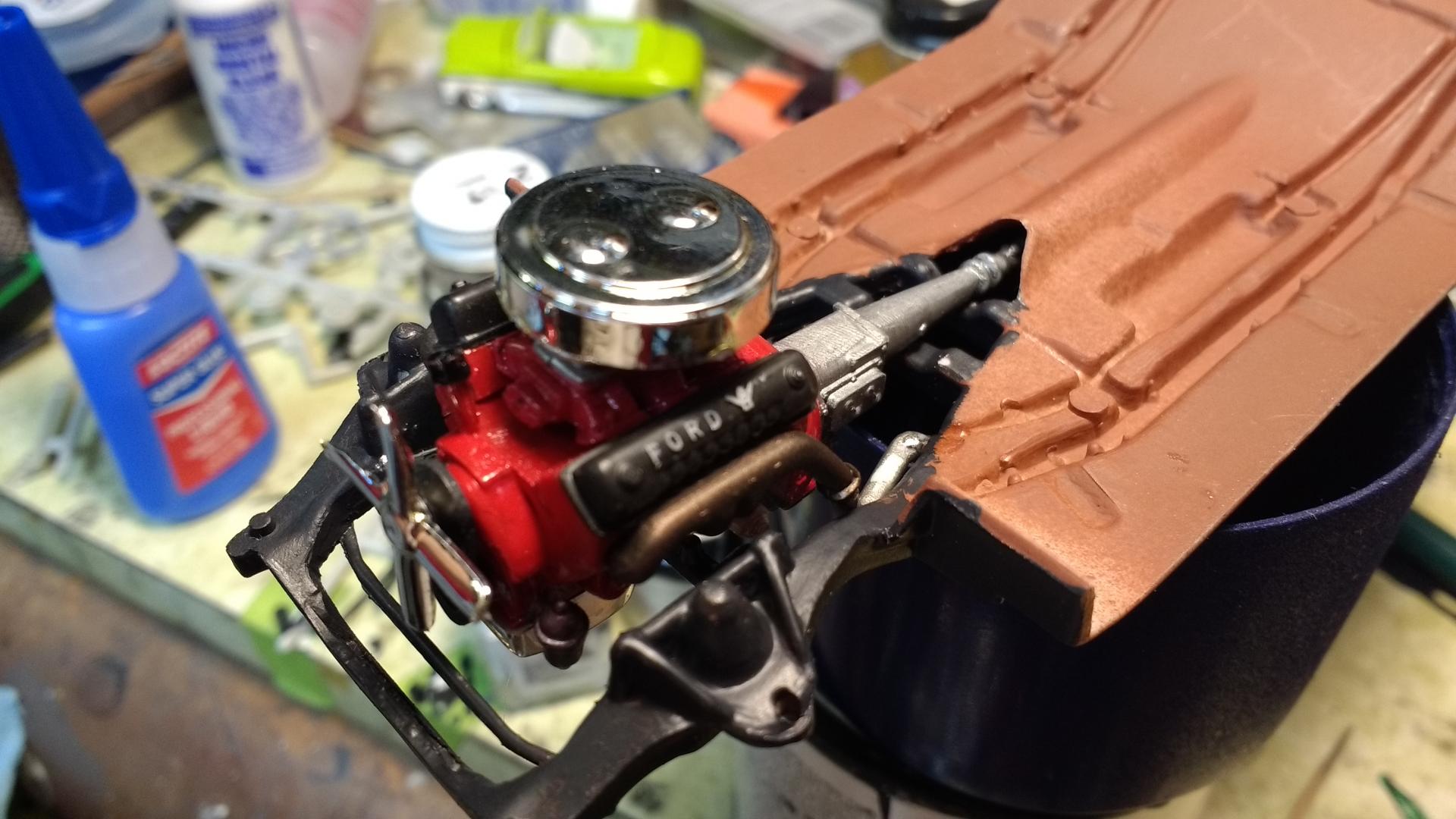

Brutalform Posted October 6, 2017 Posted October 6, 2017 (edited) I don't remember the last time I scraped a plated, or painted part. I use top coat clear in the Model Master glass jar for engine assembly, or CA glue, with accelerator. I even use 5 min epoxy. As long as you are careful with the epoxy, it is undetected and speeds up the building without waiting for parts to dry. I always use regular liquid cement for block halves, oil pans and water pumps if they will be the same color. Edited October 6, 2017 by Brutalform .
